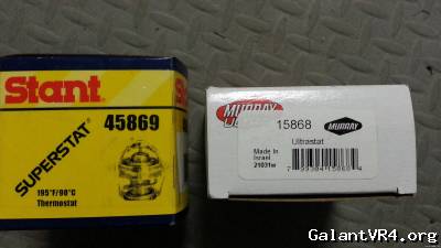

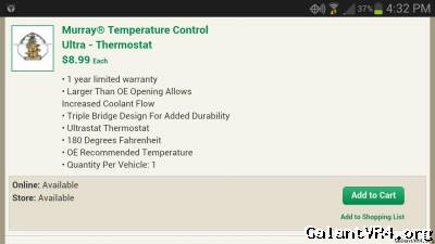

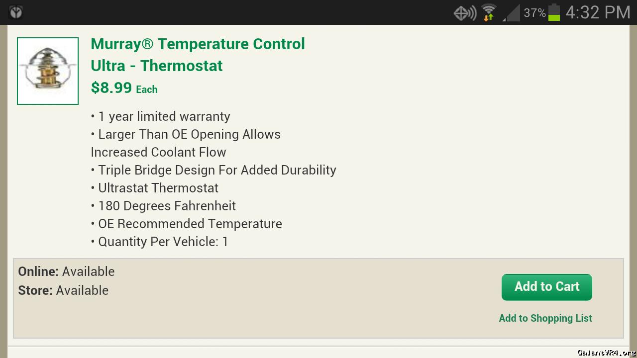

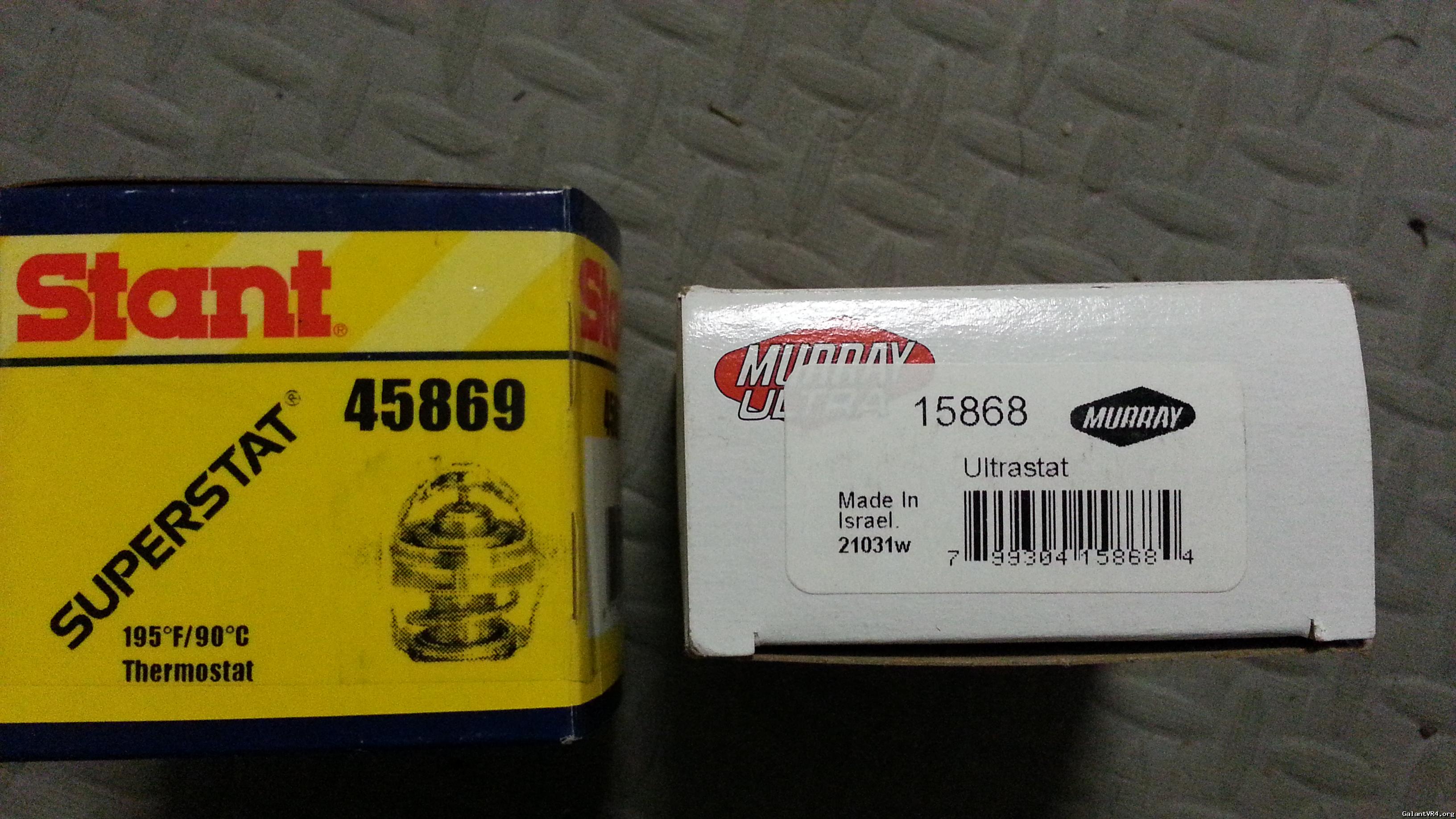

There are 2 stant/Murray models. 1 sh*t and 1 good/better than OEM. You have to ask for it in the stores because their default is to give you the cheapest sh*t. I've ran these and have had NO failure or issues.

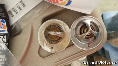

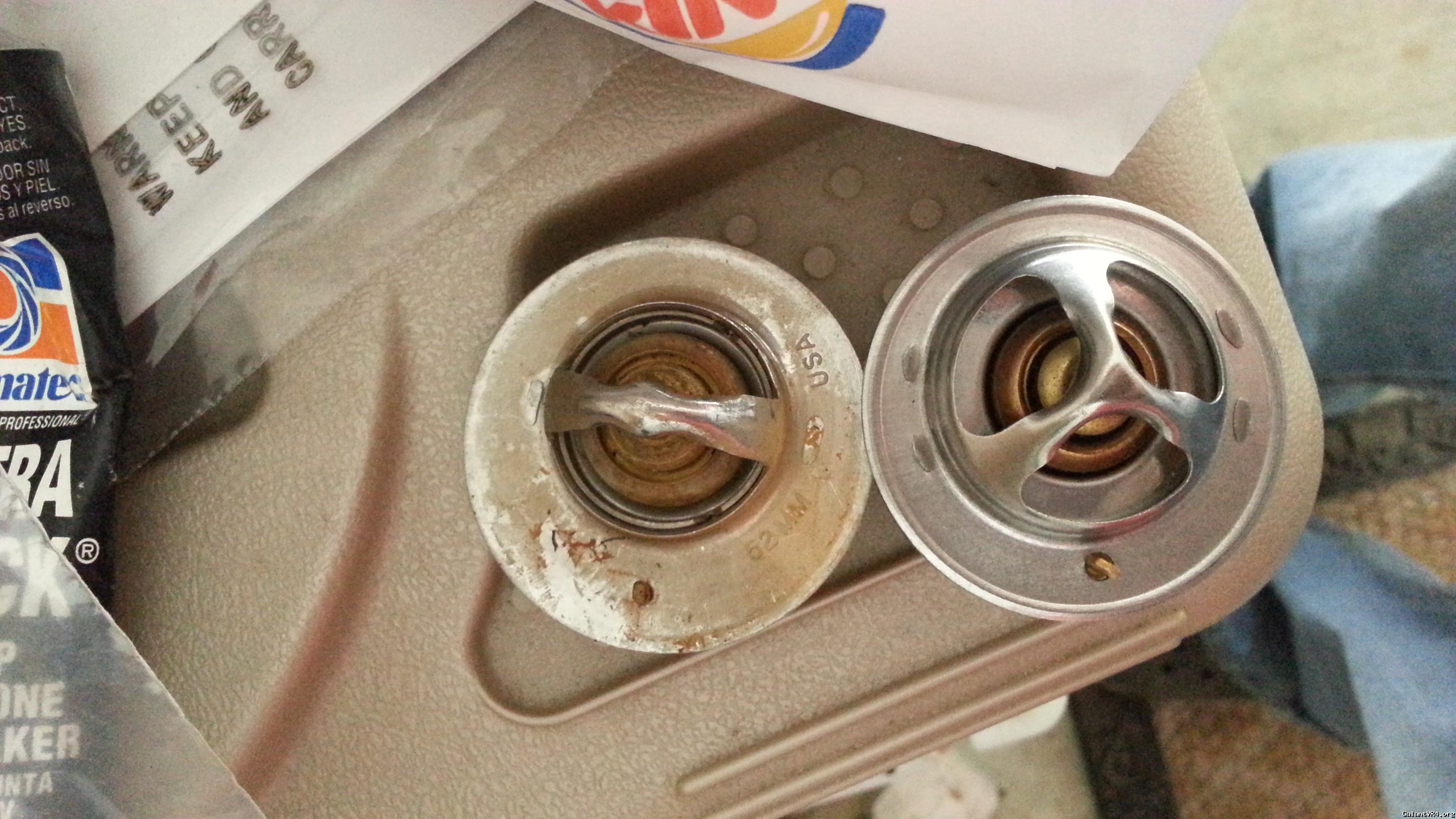

I just pulled a sh*t Stant out of my DSM that was rated for 180* but ran more like 220*. Switched it out with Mitsu part and fixed. The opening is just as small on the Stant as it is all the other sh*t t-stats.
I've had several negative experiences with Stants. It's $17 for a dependable Mitsu t-stat that won't close up on you, no reason to cheap out on it.
I ran into the same issue with the 180 Stant I got from English Racing. No issues since replacing it with an OE 180 tstat, which is what I ran in the IMSCC comp.
Exactly, don't buy the cheap one. Buy the more expensive one and you won't have any problems. This is if you're in a pinch and can't wait for oe.

I have no idea. Could have been the cheaper unit. Lucas says they use them all the time, but the one I got from him sucked. My temps were really inconsistent using it. When I compared it to the OE unit, the OE unit had a much larger opening. The OE unit is much heavier as well. Heavy is good, heavy is reliable. /ubbthreads/images/graemlins/wink.gif
