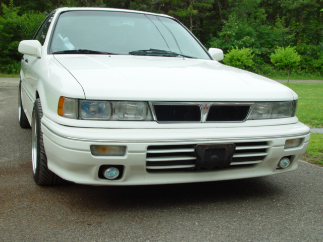

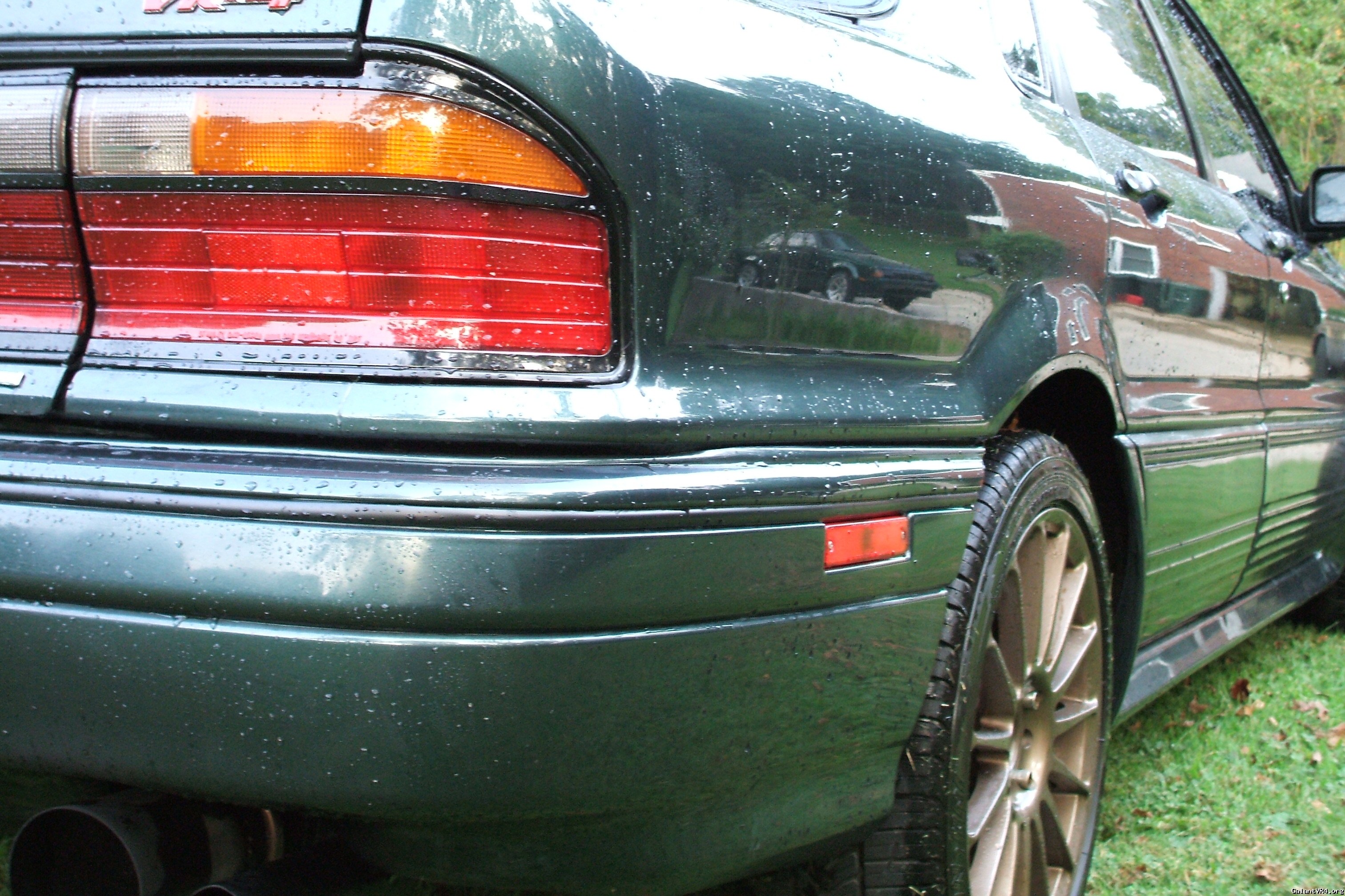

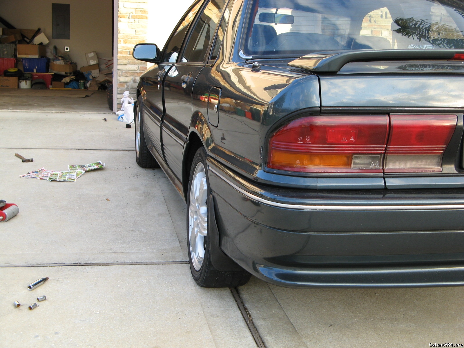

^16x7 35 offset 205/55/16 tire

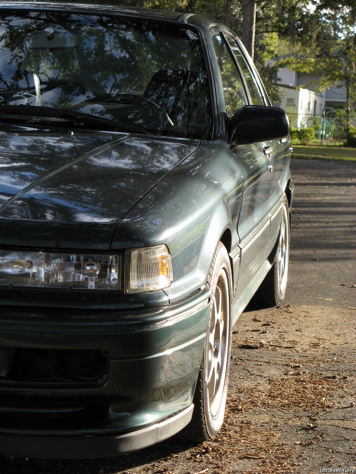

^^17x6.5 43 offset 225/45/17 tire

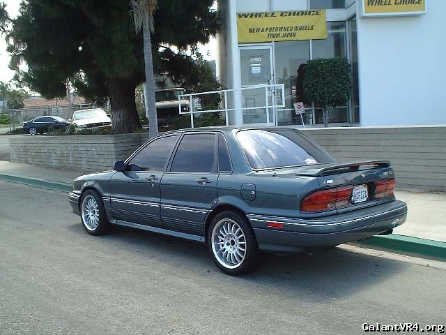

And waaaaaay back with:

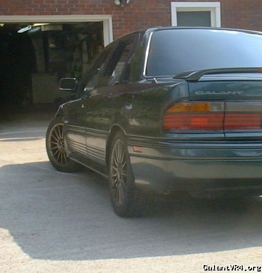

16x8 + 38 with 225s
1/4 in rear spacer
Same with the Volks now as far as size and offset go. I like 8 in wide with +38.

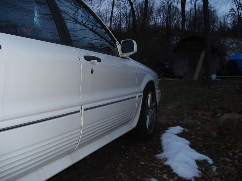

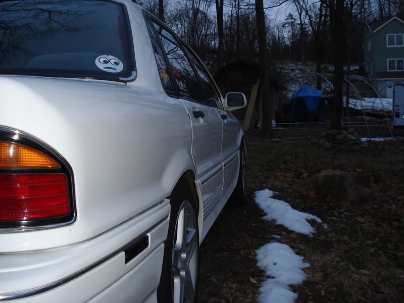

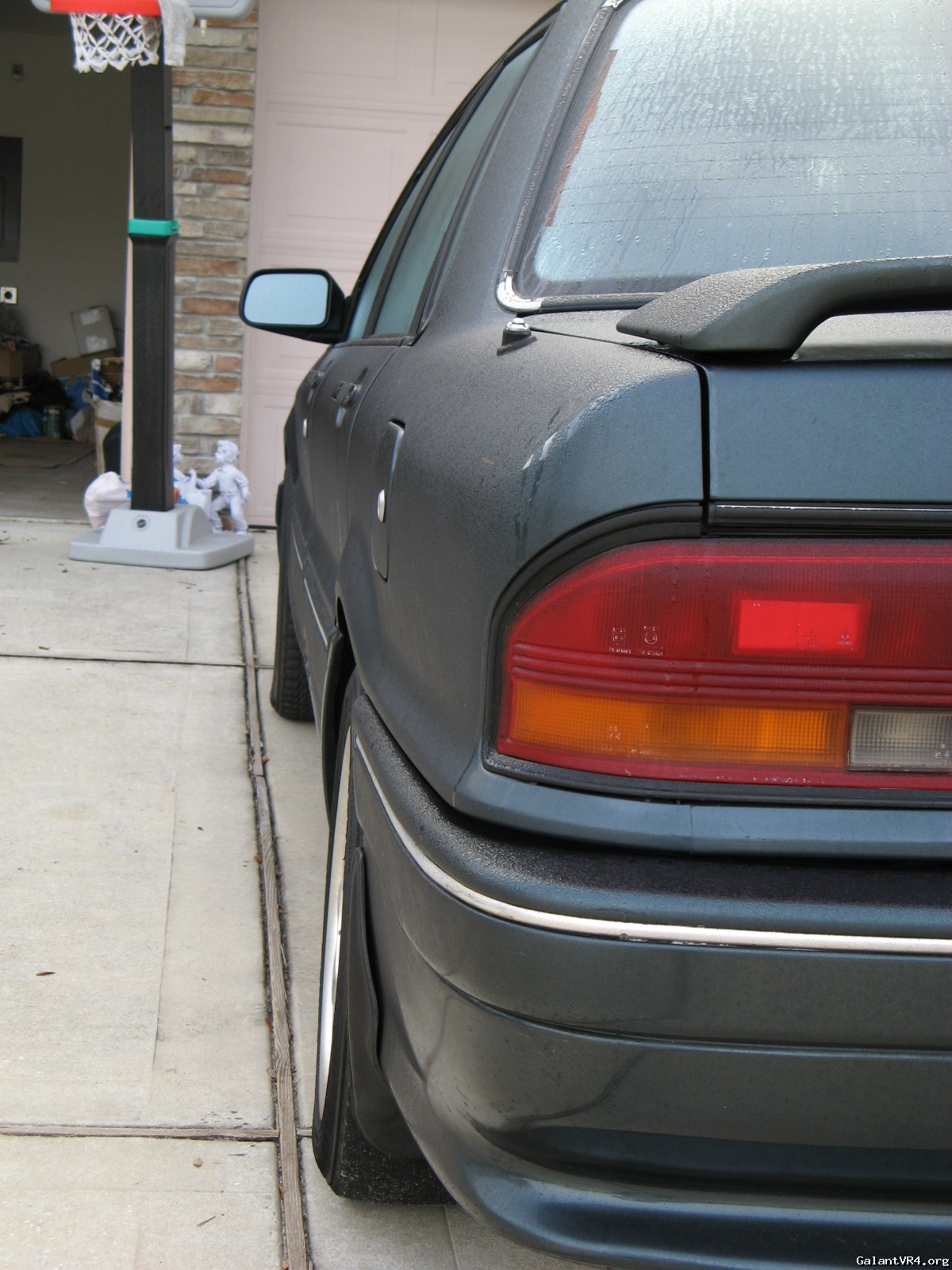

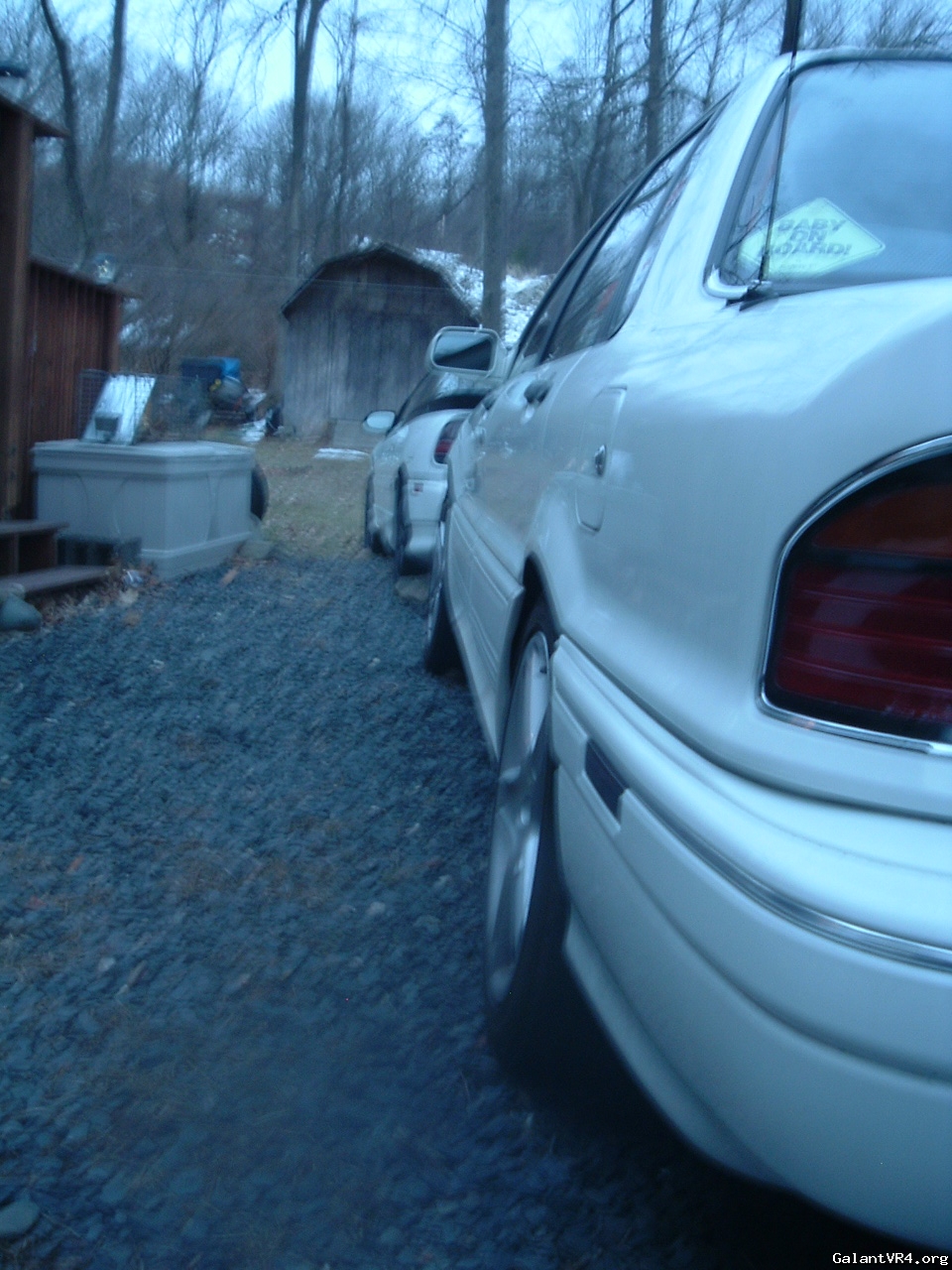

17x8 with +45mm offset with no spacers off of a 2004 Acura TL:
They have 235/45/17's on them.

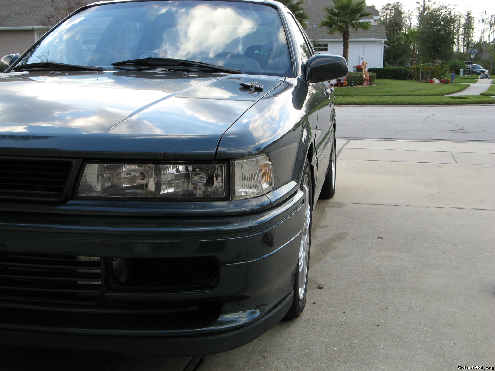

17x8.0J +35mm offset with 225/45-17 tires
The fronts stick out a little but the rears are perfectly matched to the quarter panel.
Using front adjustable camber plates will fix the problem on the fronts or running +40mm offset on the fronts is another option. The wheels I'm using has a big lip so it gives the car a wider look. I'm thinking about lowering the rears a little to even it out.

^ You mean:
Ooops. Fixed. I just wanted to add that they fit and don't rub on anything. The rear comes really close to the trailing arm but it doesn't hit. When I put a set on my cousin's 1G AWD DSM the wheel weights on the inner lip lightly scraped against the trailing arm so we removed them.
can you get pics from back to front or front to back like the rest

John how much does the it stick out of the front/rear fender
Not at all, it tucks 100% under the fenders. It even tucked before I added camber to the front, now it REALLY sits under the fender, it's in at least 1/2" I'd guess. If you want another pic I can try to get one for you tomorrow evening.

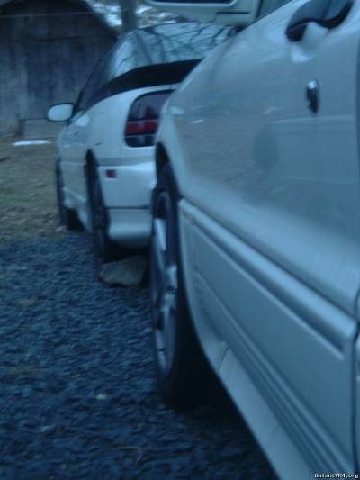

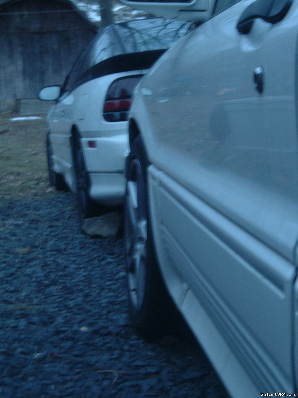

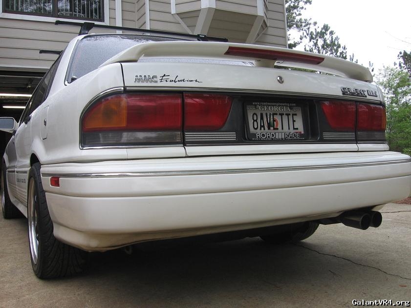

Sorry it took so long but here's a few pics:
They aren't exactly top notch pics but they give you an idea of how the tires tuck. IIRC, Evo8 wheels are 35mm offset so if you've seen a GVR4 with them on it you can just picture it with the wheel moved in 10mm (about 3/8"). Keep in mind that I have 2.5* of camber in the front and 1.5* in the rear and that tucks it too.

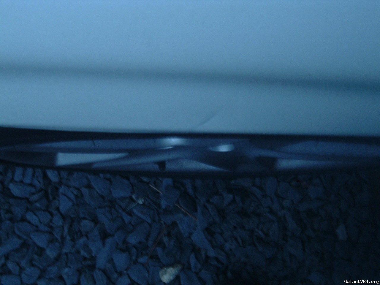

This LINK says they are 50mm offset but it looks like your fronts are out pretty far. Yours should be 5mm more tucked than mine are. FWIW, most wheels have the offset marked on them somewhere. My TL ones say 45mm on them on the back of one of the spokes. Do you have some kind of spacer on the fronts?

i think i was cambered out kinda bad right there, i just had put them on. i had to add a degree or more.
