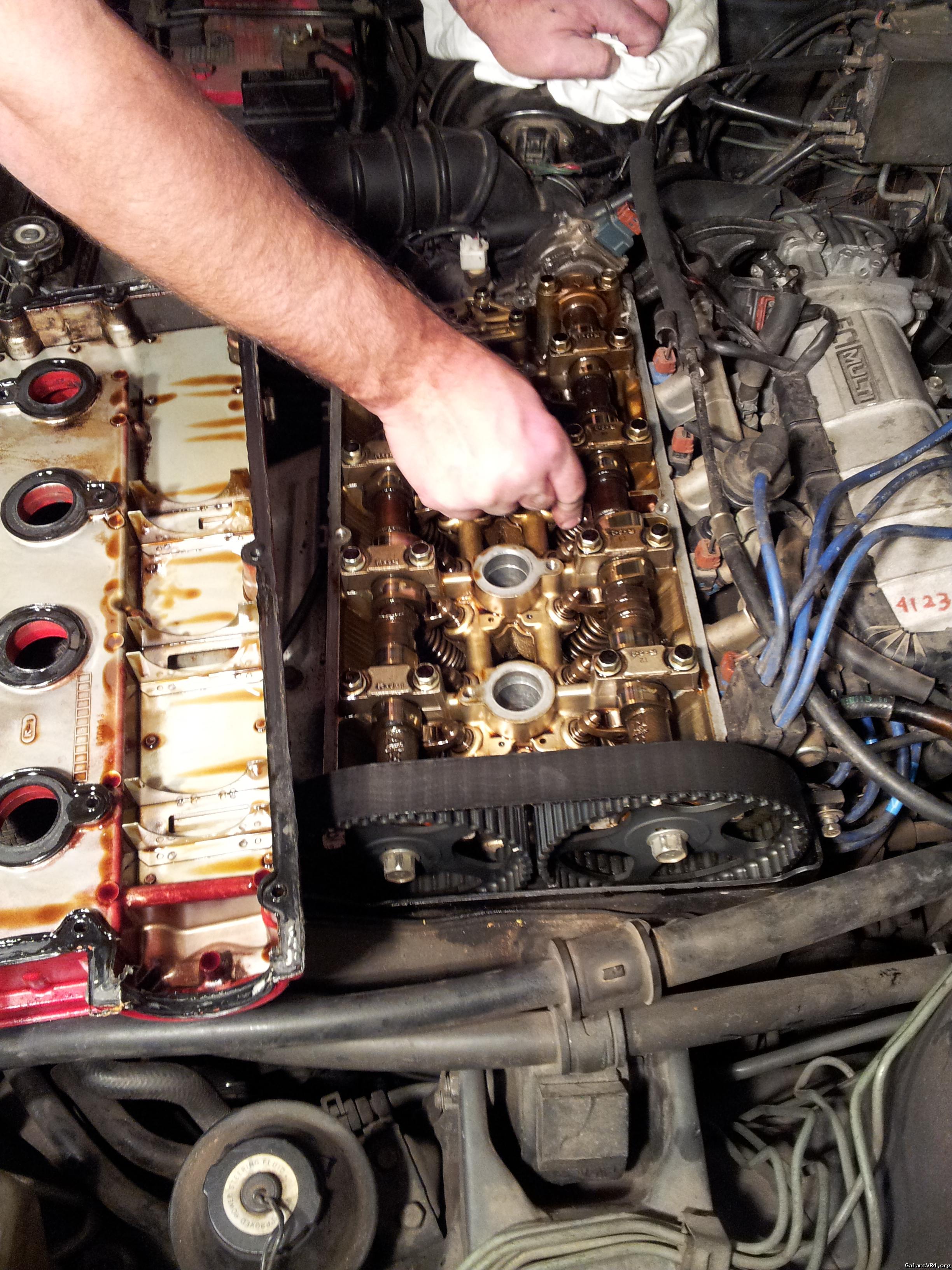

Did some troubleshooting with a buddy tonight. Confirmed spark on all four cylinders, plug wire integrity and installation on all.four cylinders, re-checked compression, and free-spun the engine without plugs. Even pulled the valve cover to be sure we hadn't lost a rocker or something. It only makes this noise when it fires.

We pulled the cover and took a good hard look around. Nothing looked out of place. Spun the engine with the cover off and CAS disconnected to get a good look at things on the move. We even went as far as firing the engine with the cover off - THAR SHE BLOWS! /ubbthreads/images/graemlins/grin.gif
If timing jumped and there was interference, we'd still get the noise in the absence of spark/compression, right? We compression tested it again and got 145-150PSI across all four cylinders. Lack of timing would impact overlap, meaning it would impact timing numbers, too; likewise if I'd bent/broke a valve. It's damn curious. Could it be a collapsed lifter? Would we even be able to spot that without disassembling the head?
The most damning thing about this situation is this: All I did to the engine was disconnect the CAS, pull the plugs, and do a warm compression test. That's it.

I would pull the rockers and the lifters with the head still in the car. That's very easy to do in the car. Let the valve extends all the way and compare the installed height of all 16 valve assemblies. Check all retainer, keys, valve spring, and spring seats. I know you have good compression, but this is an easy check. You can also check the timing belt marks before you pull the engine out of the car.
I've seen similar problem / noise when one of the retainer key jumped (should have 2 per valve assembly).
Did you lose any bolts during the turbo swap? Also why did it sound like a massive air leak? I would be worried that a bolt fell into the timing cover. I have also left a socket on the power steering pump bolts and turned the motor over to encounter a great deal of racket.

Thanks for the continued support and feedback, gents. My day started at 0700 with a blue screen of death on the wife's computer and I've been on that mission all day. Managed to sneak 5 minutes with the Galant just to pop the VC off and give the lifters a push. All 16 felt immovable and looked like matched pairs on each cylinder/side.
I think I'll double check timing tomorrow, ziptie the belt, and loosen the cam retainers to remove the rockers without prying on my cams like some kind of animal. I'll keep an eye out for missing retainer locks, inspect the lifters, and maybe replace them with a set of rev 3s soaking on my bench. Tips for comparative measurement of valve stems? Might have a dial on a base at the shop, but if not, mini trammel bar?

Pulled the cams, all the lifters were rock solid. All the valves had both retainer locks in place to boot.
I didn't have a dial indicator handy, so I could measure the relative height of the completely closed valves, so I decided to re-trace my steps on the turbo swap.
Wouldn't you know it, that one PITA exhaust mani stud behind the PS pump was missing. Such are the risks of starting the victory dance before the chickens are hatched in your basket. I was freaking out because it wouldn't stay running, but DERP! I blocked off the FIAV/ISC a while back - it NEVER stays running when cold.
