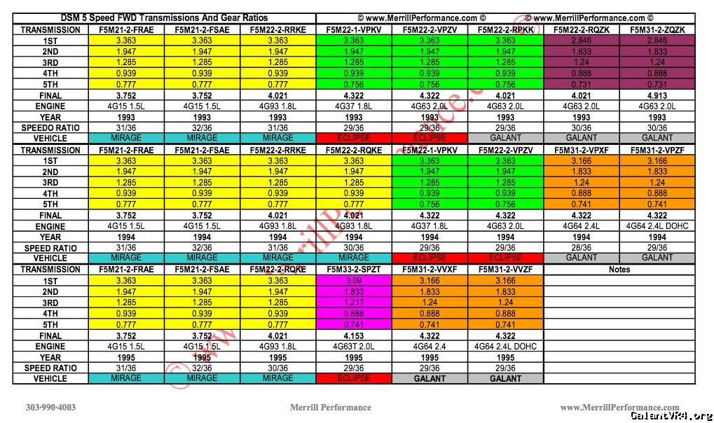

Did some more digging ... look what I found
I wonder if any of these are FWD parts that can be mixed and matched? I haven't even started looking at those 4.3 and 4.9 ratio boxes to see what they came out of ...
Might also be worth seeing if Merrill Performance are still about. I have this as a PDF and will send it on with those Excel files for ya!

Now that's definitely food for thought. I'll have to feed info like that to guys I know who really know these transmissions. Possibly one of my weakest points on cars if I had to say.
thanks!

You're welcome, but it does look as if these are FWD boxes. The problem is going to be the rear ring and pinion gear to match the final ratio in an AWD car. I'm going to have to crack the rear diff I suspect to find out what the story is back there as well.
Edit: I suspect that given the interchangeability of Mitsu parts, there are probably a few unicorn parts about that do work. The 1993-1995 Mitsubishi Galant VR4 had a completely different engine and gearbox to these cars but the rear ring and pinion is a 3.909 ratio which fits the E39A rear diff and works with the 3.909 ratio RS boxes. It wouldn't really surprise me to find out that some later model AWD Galant, Diamante, RVR etc Japan only model has a 4.3 ratio rear ring and pinion that works with some of these parts. But finding it will be a bitch!
