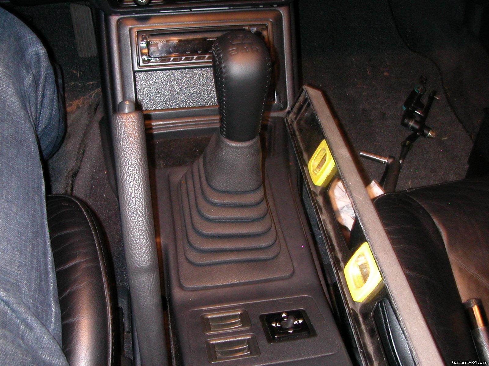

Ok update time. The new shifter is amazing! The shorter height, shorter throw, and weighted shift knob give a really good feel. There was a few more modifications that needed to be done to make everything fit - it was tighter in the VR4 than in my buddy's 1g that I initially fit it in.

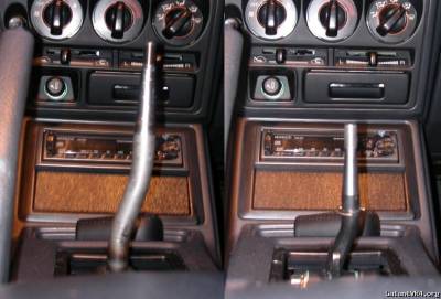

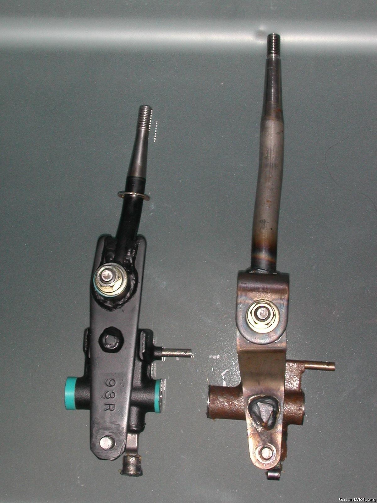

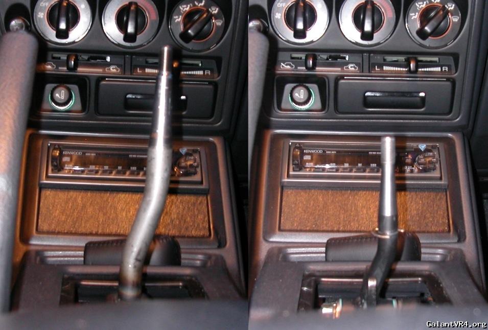

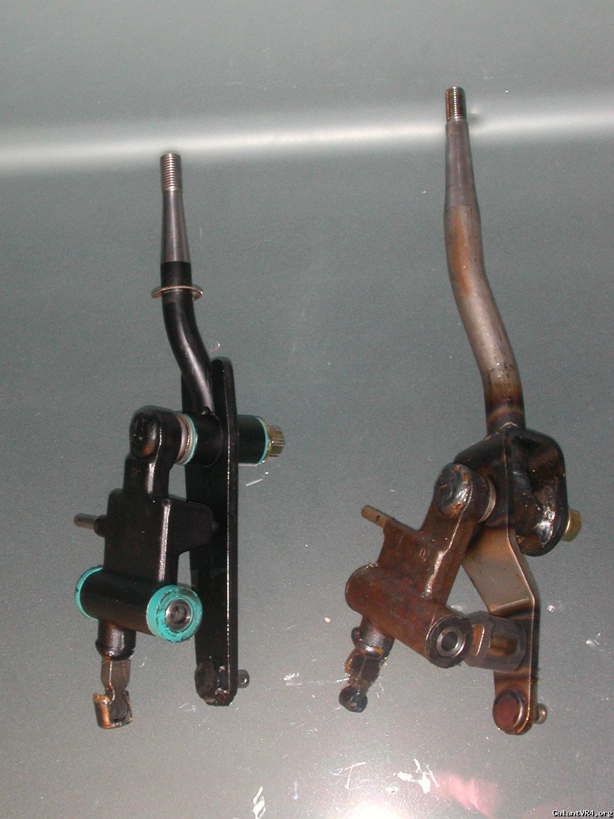

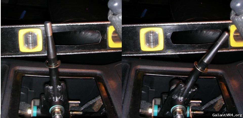

Here's the short shifter next to the stock VR4 piece. The new ratio looks to be around 1:1 as opposed to 2:1 for the stock one.
Sits a lot lower than stock. I like where it sits now
Shorter throw too! Here's the old one.
And the new one.

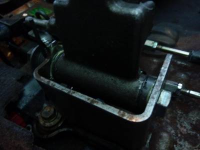

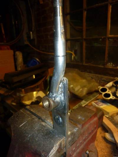

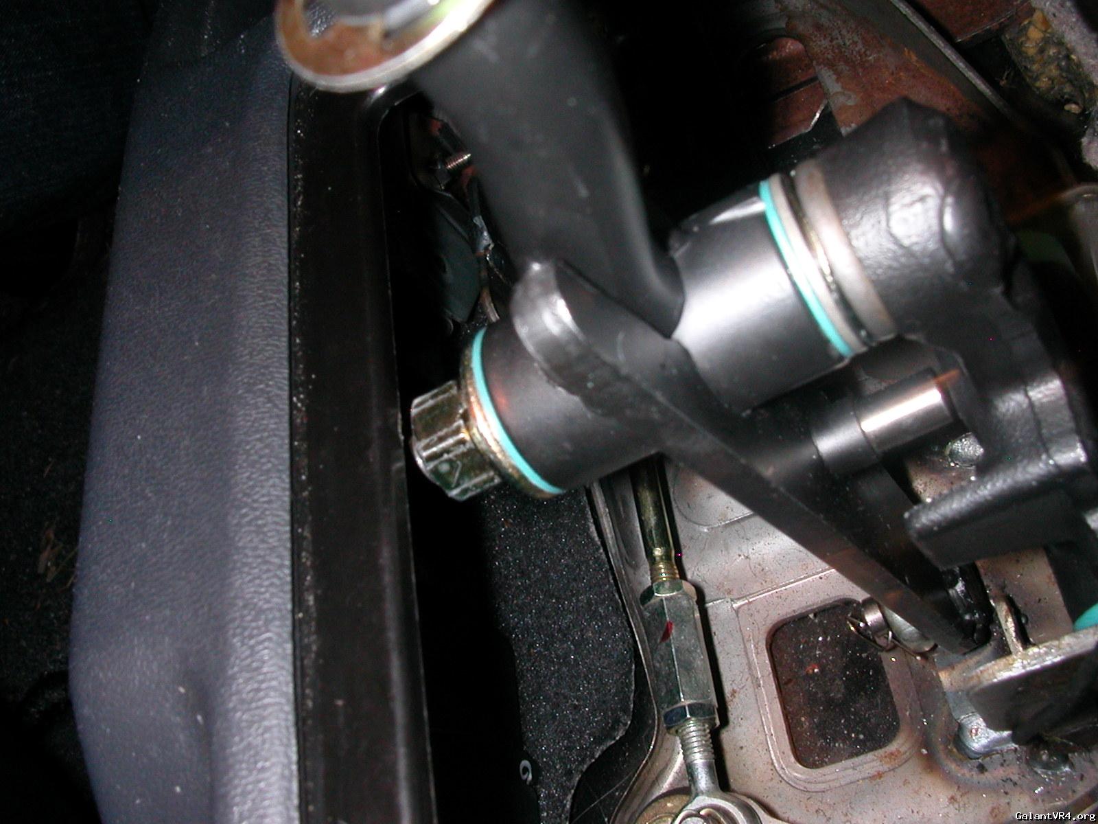

There were a few areas that were tight. The passenger side of the shift arm just barely hit, so I had to grind off a few millimeters of material to clear.
The very bottom of the shift arm hit the left/right shift stop on the base, so a couple millimeters had to be taken off that too.

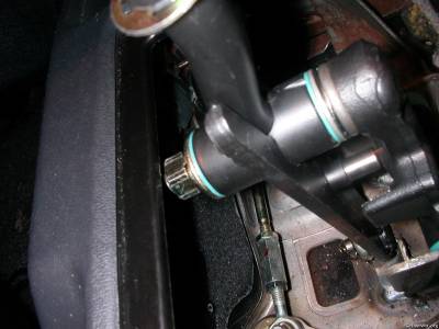

The nut on the driver's side is a tight fit, but only just barely rubs the inside of the shift boot. Im not too worried about it. Note that this pic was taken before the right side was ground down.
I had to adjust the front/back cable in order to center everything up, but it was really pretty simple. I highly suggest this mod to anyone wanting a better shifter.

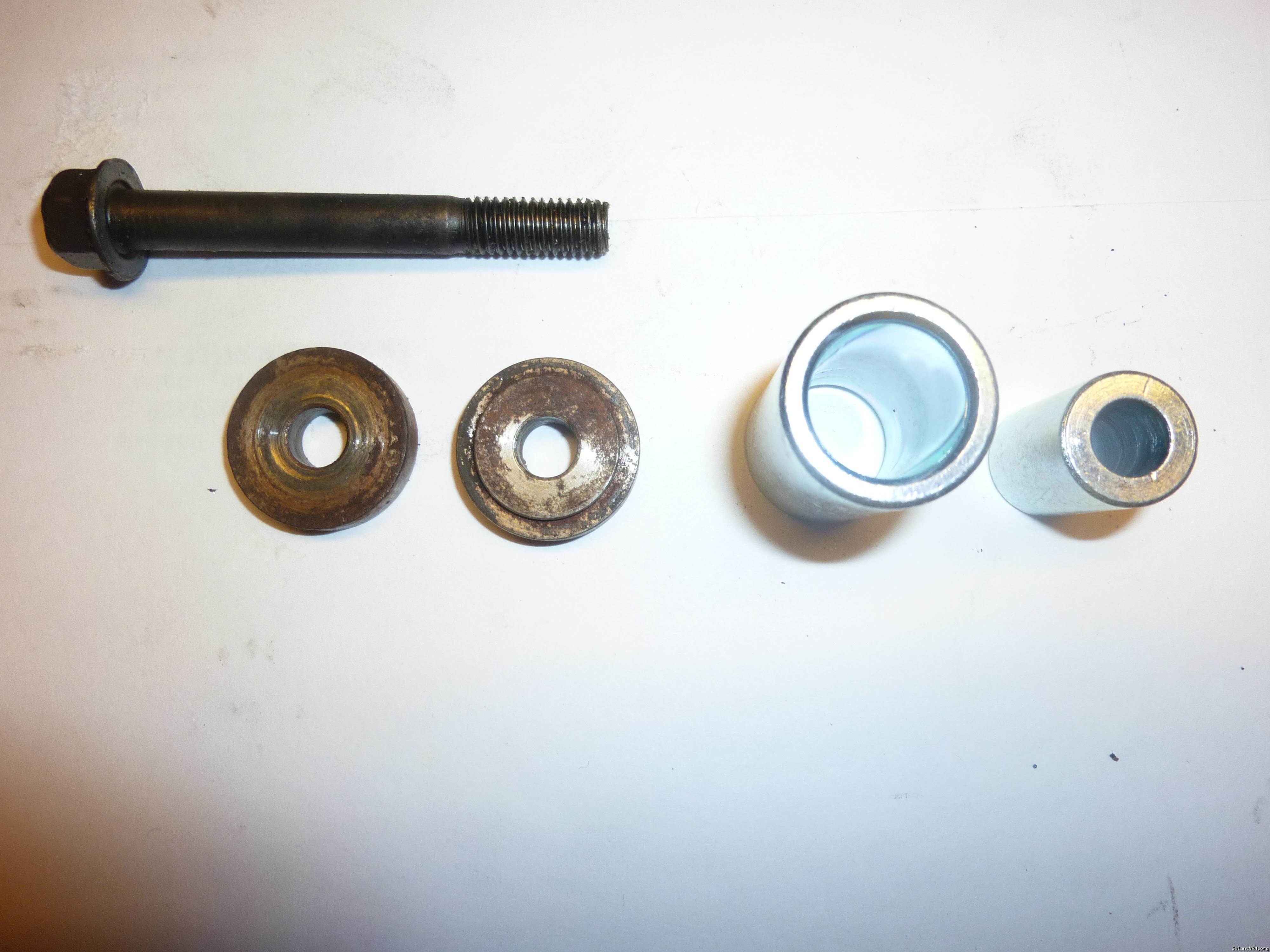

I just got done machining some bushings for my shifter this past weekend, so I'll share my thoughts. I used brass and lots of teflon bicycle grease. I machined the upper-most bushings (oriented left to right) like you did, but left the plastic lower set (oriented front-to-back) in place. Instead I turned down a bolt (~.030 bigger OD than the one it replaced) to make sure there was no slop there. I also machined the one bushing on the "L" shaped arm that controls the cable on the left (best seen in your second-to-last photo). That was my real problem- that plastic bushing had disintegrated. I also machined the little piece that goes on the bottom of the lever that acts like ball and socket joint out of brass. I started with a Mofugas short throw shifter I bought when Mofugas was still around. I have the Symborski shift kit and I machined some polyurethane bushings for the transmission end of the cables. Overall, like you, I'm just trying to remove all the slop from the shifter linkage. I am satisfied with the results and the feel is much better. I still want to weld some brackets on the base to reinforce it so it doesn't flex and maybe put some stops in place to protect the shift forks. The car is my daily driver so I always have to have it buttoned up by Sunday night, so the shifter is back in the car and I took no photos. But the console is not back in place yet so I will try to snap a few pics in the next couple of days.

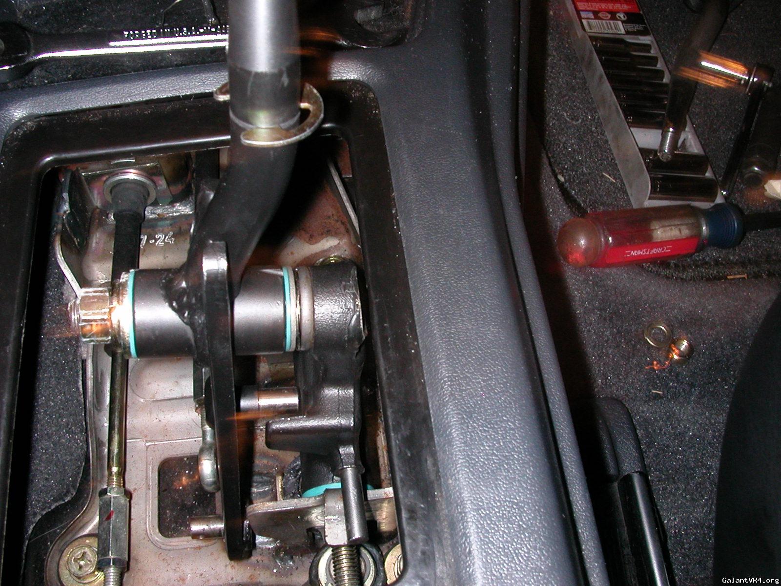

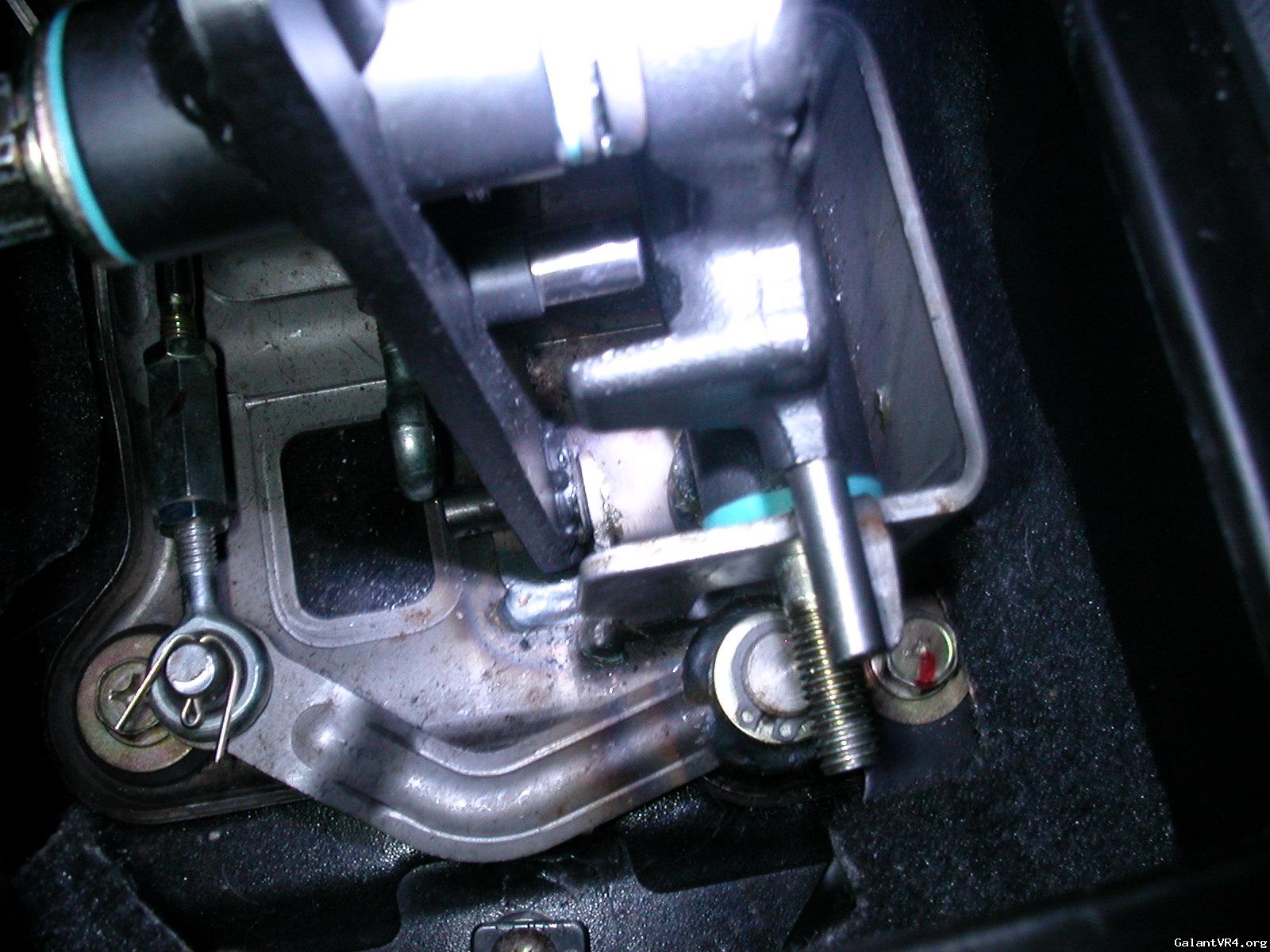

Ok, so I didn't remove the shifter assembly, but I did snap a few pics with it still mounted in the car. I will say mine is not as pretty as yours Whoodoo, but I am justifying it by saying nobody will see it rather than saying I'm lazy. /ubbthreads/images/graemlins/wink.gif

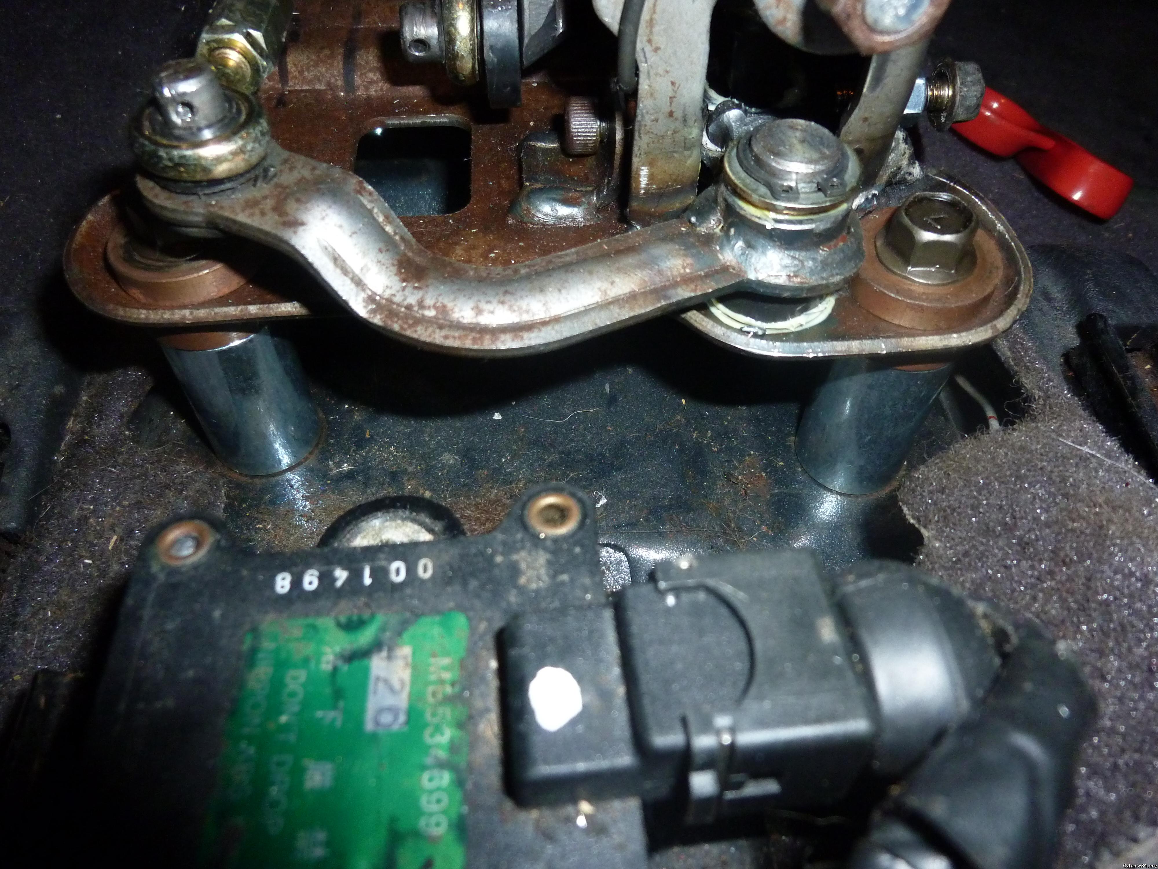

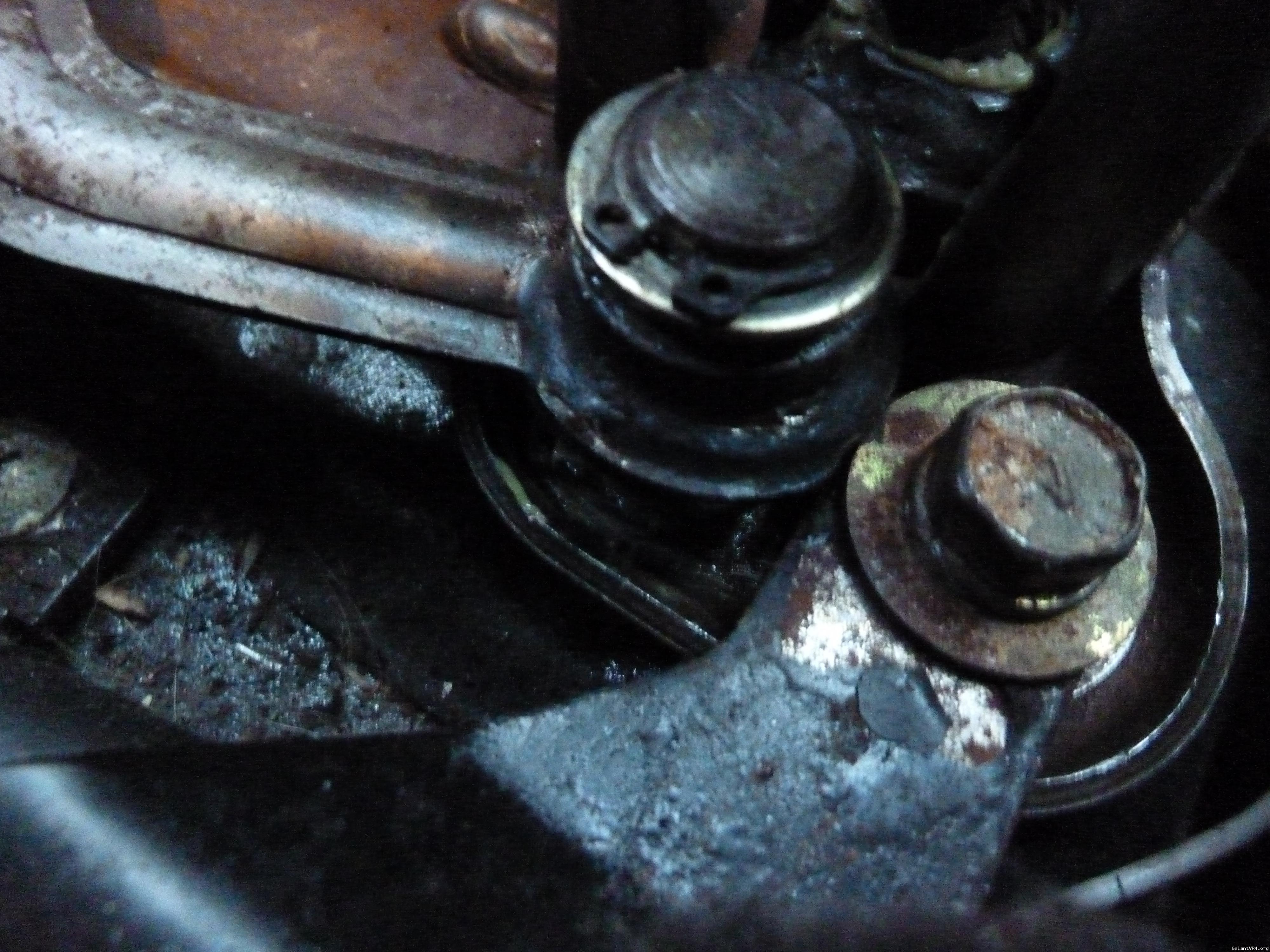

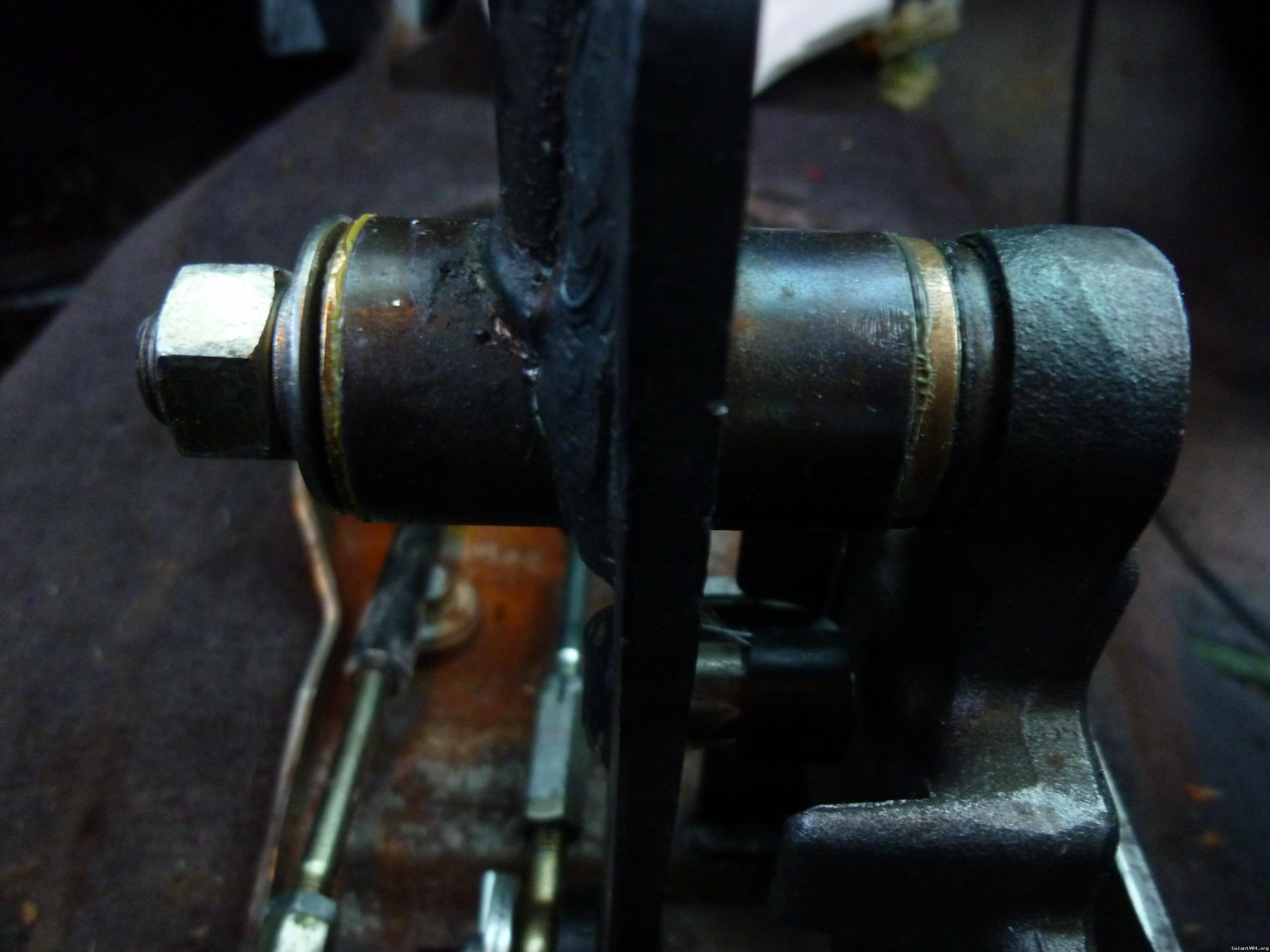

This is the upper-most set of bushings. I made the bushing on the right with a thicker flange to keep the shifter closer to the driver. On the left is a concave flat washer (curving away from the brass bushing) followed by a thick lock washer and a 14mm nut. I managed to get the clearance just right so that when the nut is fully tightened, it takes up all the space, but doesn't put the shifter in a bind.

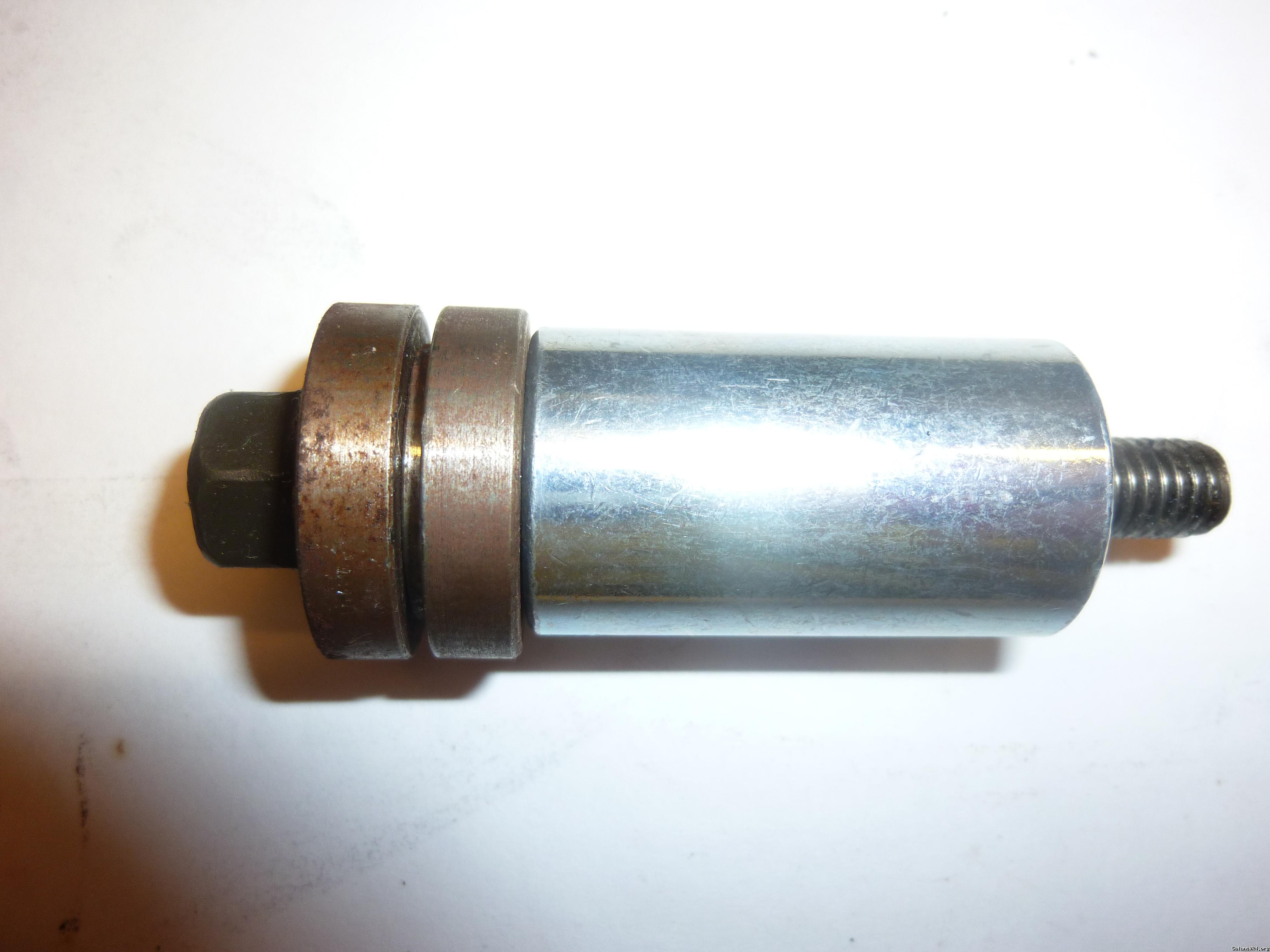

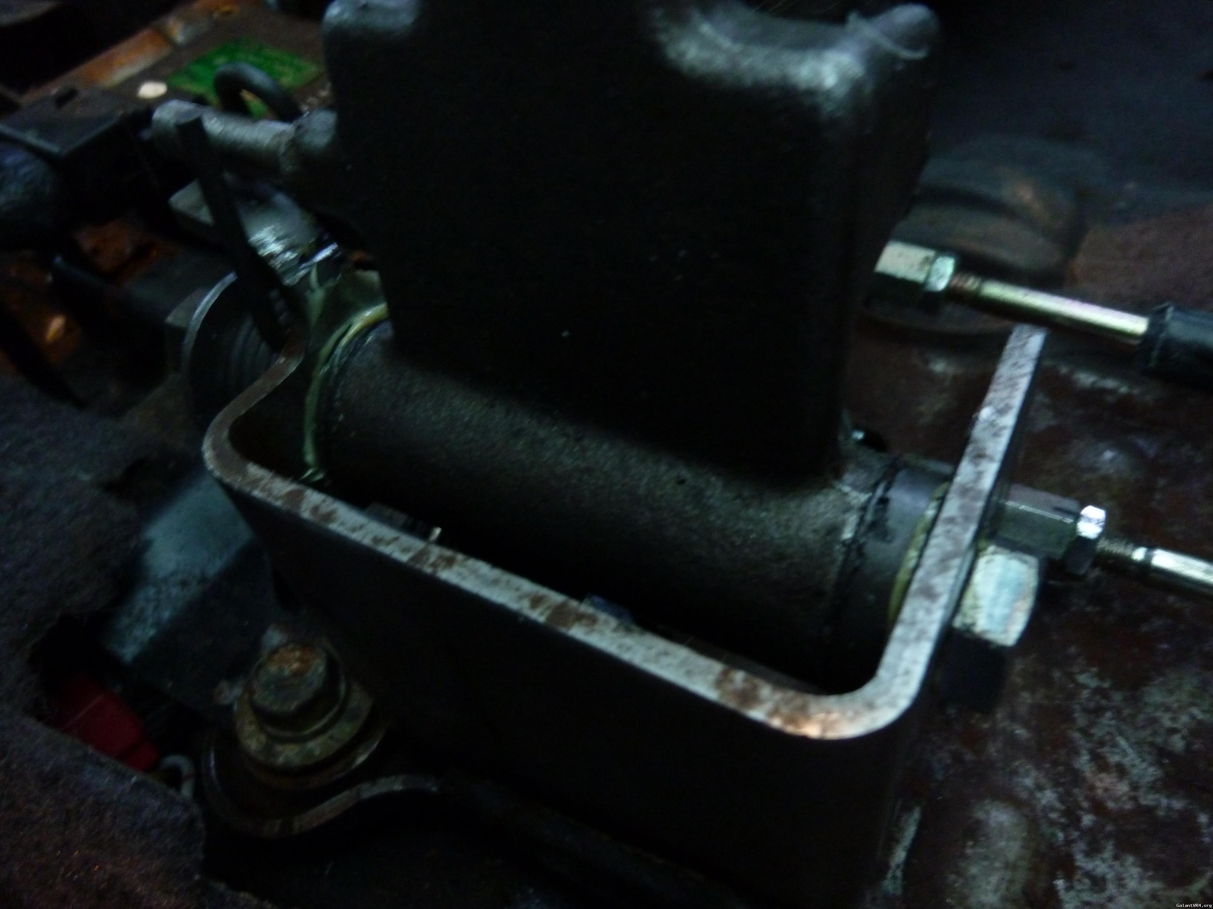

This is the the lower set of bushings that are plastic that I left in place. Instead of machining some brass bushings, I bought a bolt and turned it down. The hole in the steel that the bolt passes through was just a few thousandths bigger than the plastic bushings, so I turned the bolt down so it fit tightly in the steel and forced it through the bushings. Since I turned the threads off the end of the bolt, I used an 8 x 1.25 (IIRC) die and threaded the end of the bolt to accept the same nut as the original bolt.

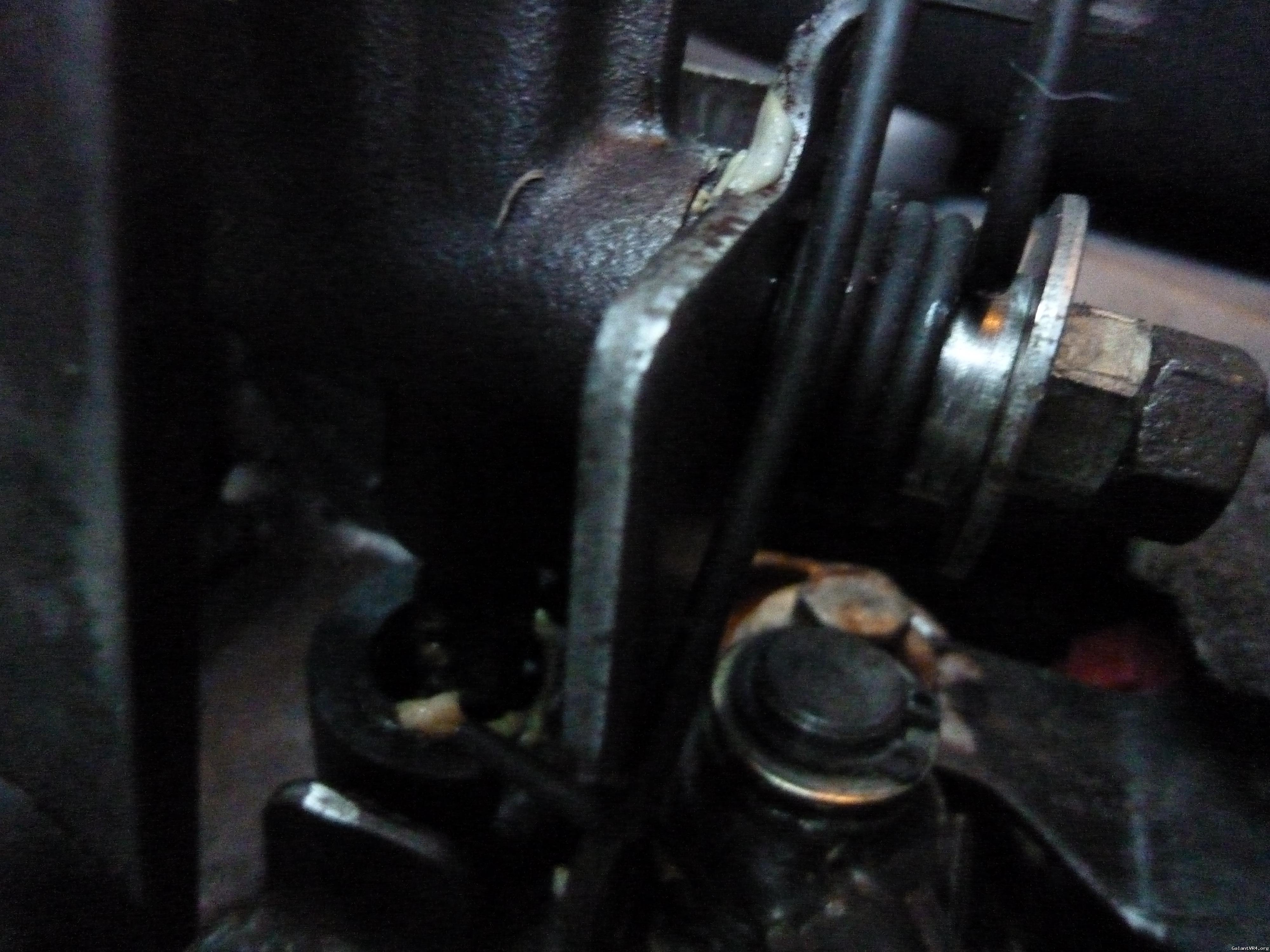

This is the end of the bolt I machined. You can see there is an aluminum spacer (I machined that a few years ago) for the spring and big flat washer. Those take the place of another plastic bushing that allows the spring to function properly. I used two nuts to set the end play on the bolt and, consequently, the friction of the bushings.

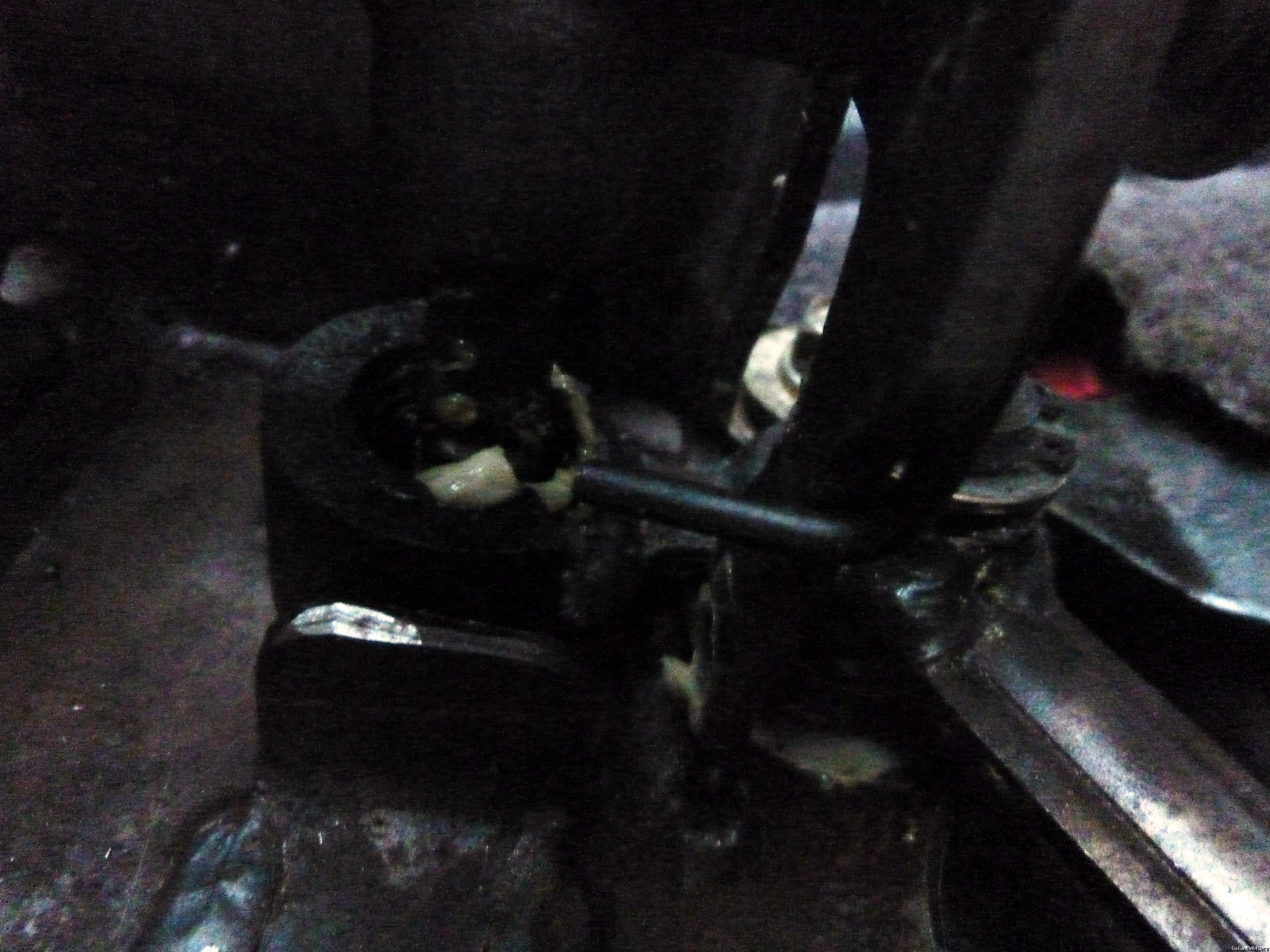

This is the bushing for the pivot point of the L-shaped arm that had disintegrated and was causing the most trouble. I originally machined it so the flange was at the bottom, but I realized I would get better action (that's what she said!) if the L-shaped arm was as low as possible. So I flipped the bushing over so the flange is at the top under the flat washer and snap ring. This put the L-shaped arm in contact with the shifter base, so I made sure I used plenty of grease to reduce the friction. You can't quite see the flange under the steel flat washer in this photo.
This is admittedly a crappy photo, but it is of the ball and socket-type joint at the very bottom of the shifter (with plenty of grease). This is where the shift lever acts on the L-shaped arm. There is a plastic piece from the factory that goes in there that I replaced with a brass piece. I machined this a few years ago too. I realize a photo would be very helpful here, but it would mean removing the shifter from the car (Ok, I am lazy!). It basically looks like the factory piece, but is brass. And greasy.

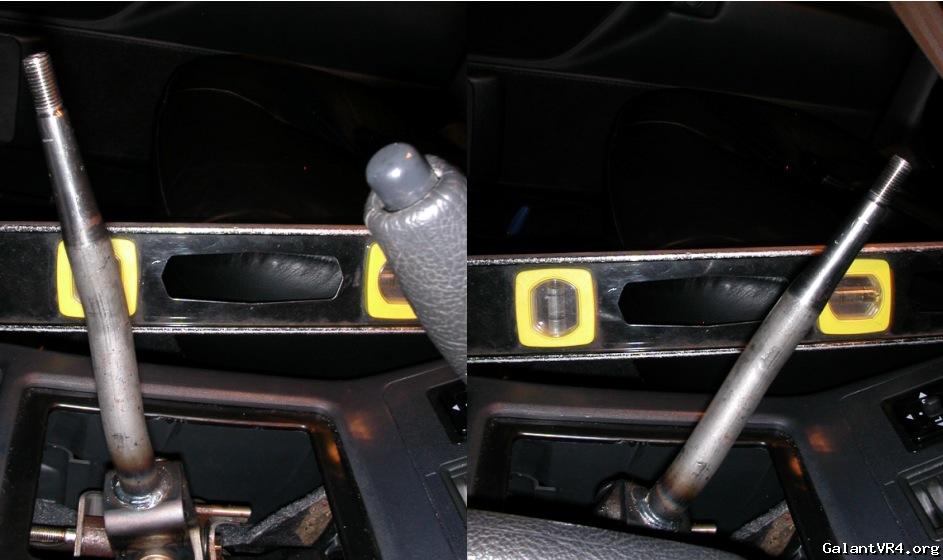

I've been tweaking my shifter and thought I would see if there is any interest in what I've been up to by posting these two pics:
GVR-4
Apr 22, 2002
2,610
Asheville, NC USA

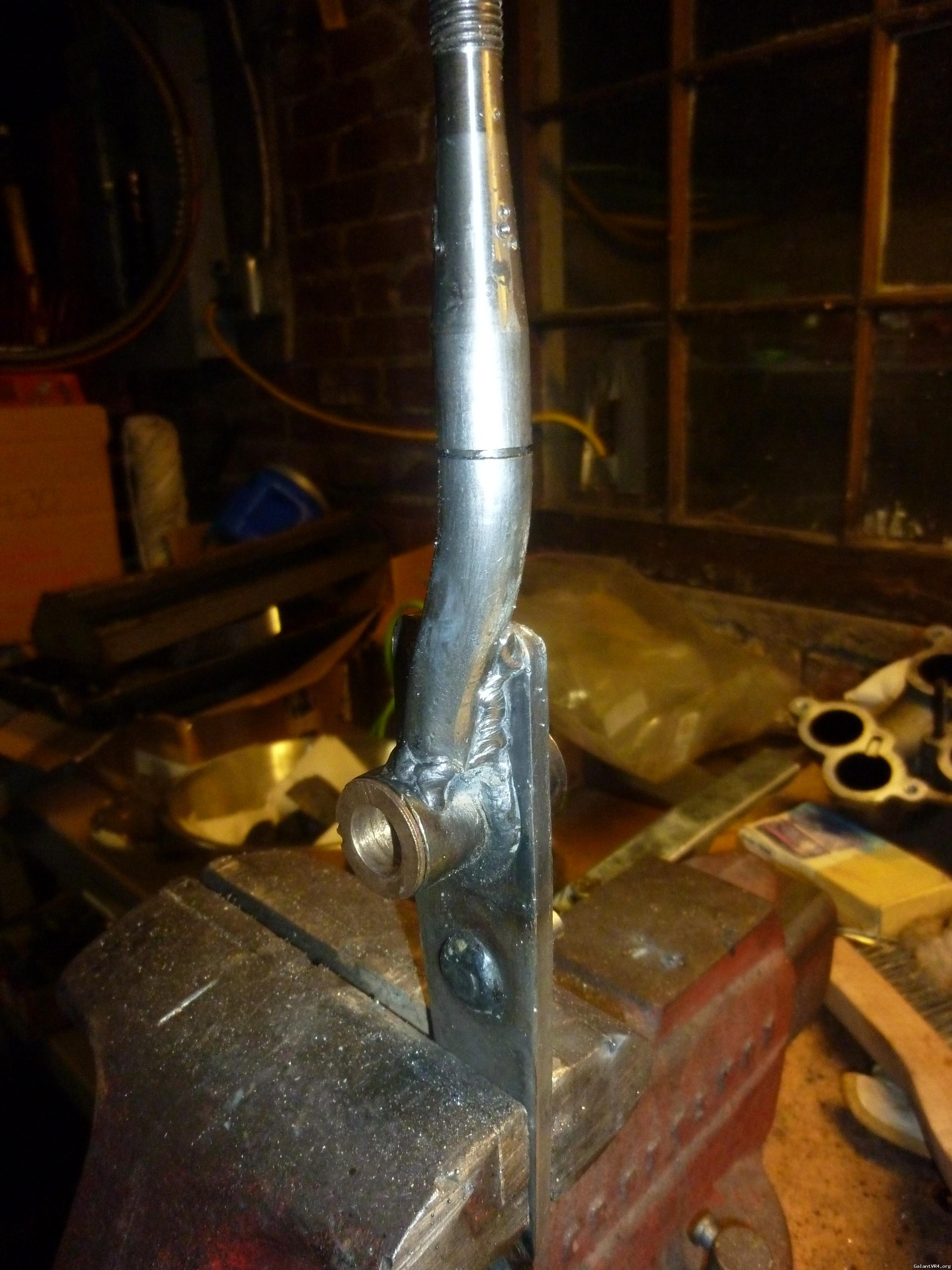

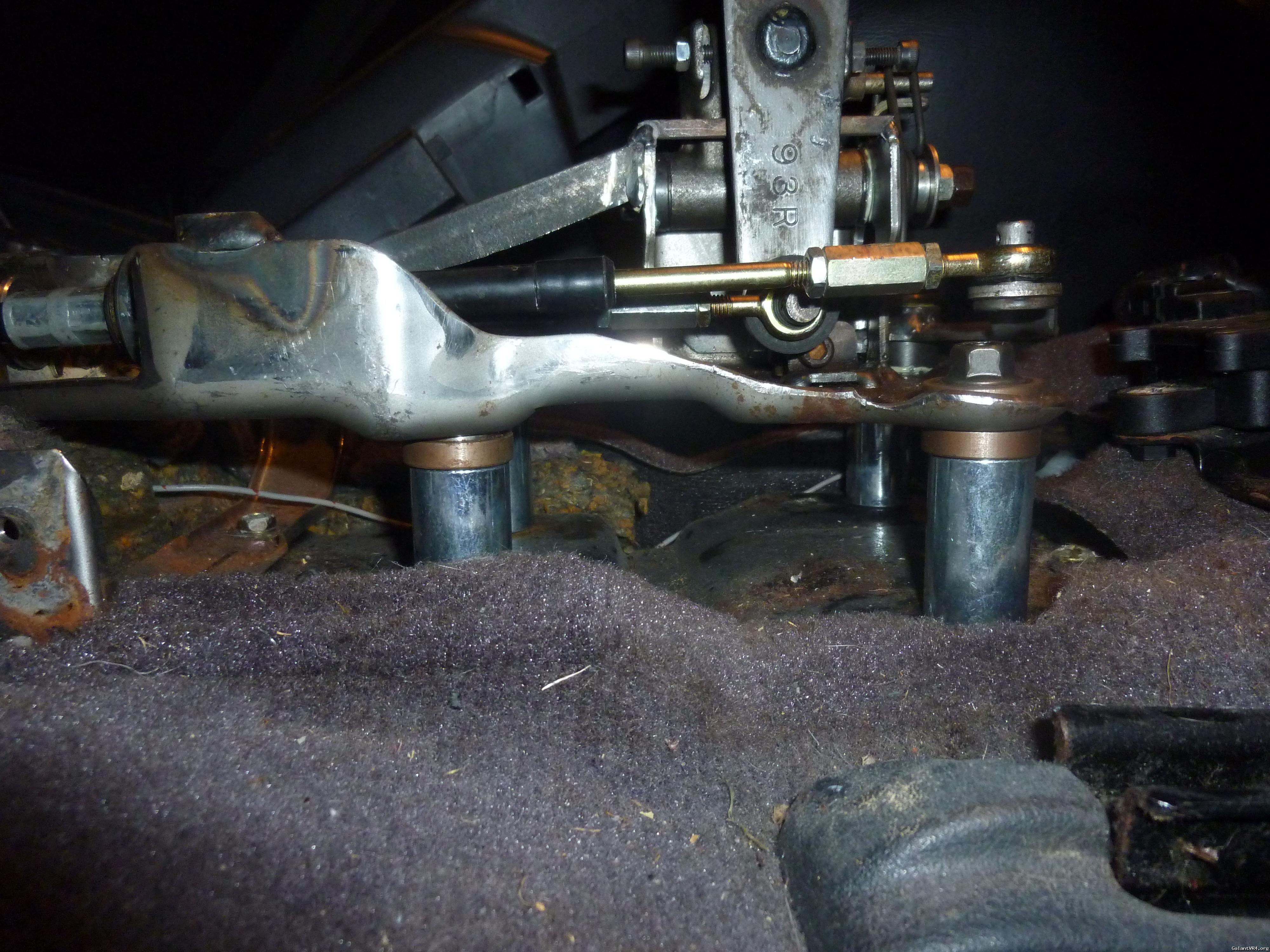

The standoffs are to raise the whole shifter assembly. Then you can cut down the height of the shifter arm...
...and have even shorter throws. I thought about it when I realized race cars with sequential shifters have the base of the shifter mounted really high, but still have a long shifter arm to keep it close to the steering wheel.
The bracing I added because I saw the section that everything mounts to (the vertical sections that are welded to the base) flexing, and I tend to use the shifter to hold on when I (albeit infrequently) drive the car hard. The stops can also keep me from damaging the tranny when I use the shifter as a handle.

Yeah, no problem with fitment so far. But I still have to install the console permanently, so hopefully I won't run into any "gotchas." I measured before I removed the console and as best I could tell it looks like the base can be raised a maximum of 1 7/8". I ended up using 1 3/4" steel spacers:

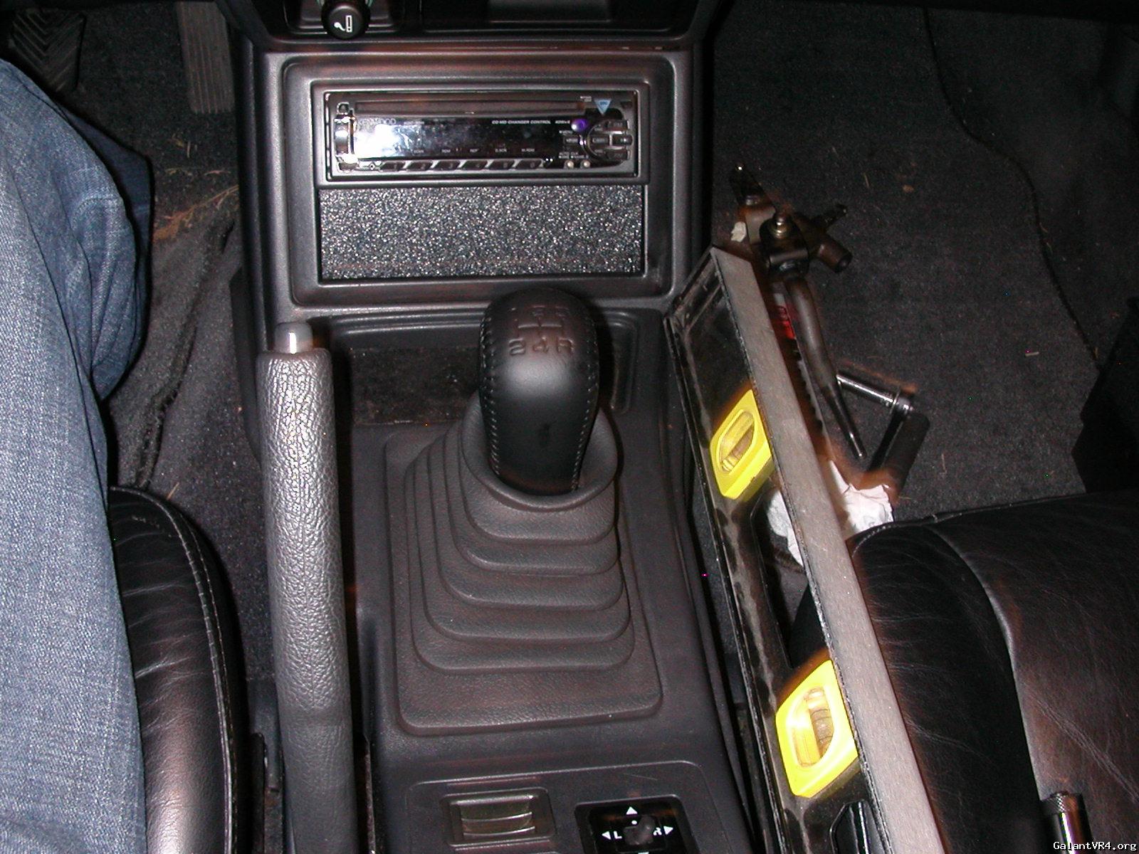

No, but with a leather boot, it's fine. The stock rubber boot probably won't work. I just got back from my first drive and it's definitely shorter. My only complaint is it's really clunky with the metal on metal stops. But the harder you shift it, the better it works. For drag racing this would be the hot setup. I've got some stock rubber bushings coming from JNZ to try. I'll decide whether to keep the Symborski kit or the stock rubber bushings once I've tried both.
