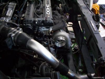

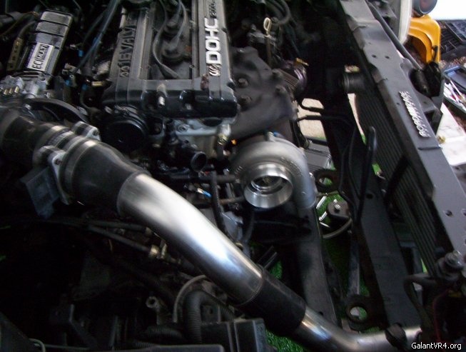

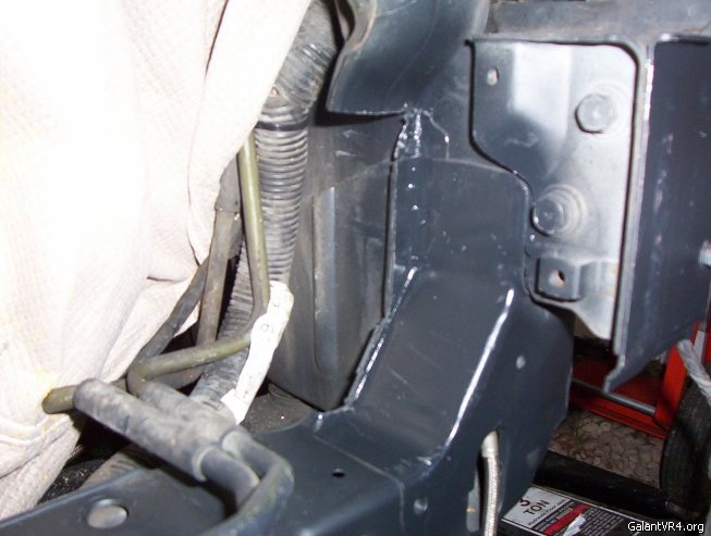

To run the short route 1g piping there is a bit of grinding/cutting involved to make the pipes fit past the passenger side of the radiator. I just did this personally about 2 weeks ago w/ 2.5" pipes.

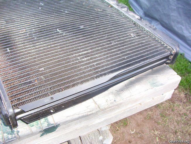

I ground the radiator down:

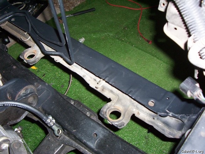

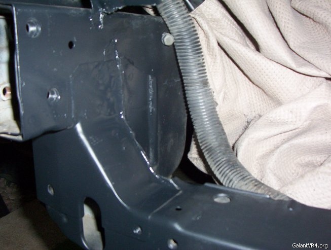

And both side of the core support next to the radiator (the drivers side doesnt need as much cut as the passenger):
I also relocated the big wire loom to run above/behind the radiator (behind the hood latch) instead of under the radiator and in the way of the piping on the passenger side:
The 1g style piping BARELY squeezes in between, but it works out
