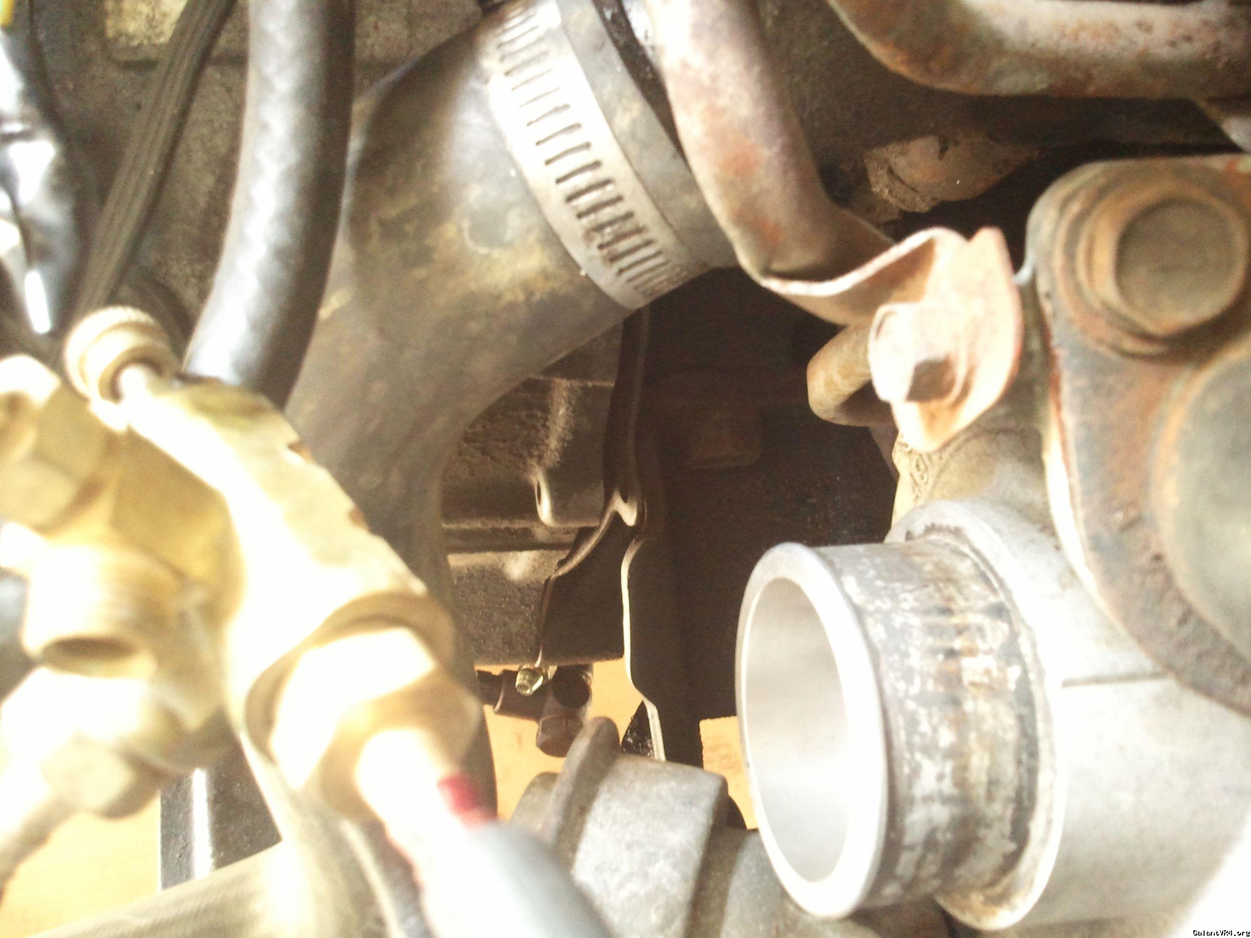

DOUBLE EDIT!: In response to the checking for the transmission to block bolts, is this what you mean??
Also, I was checking my clutch pedal for play and it seems to react instantly between when I push, and when the MC rod moves. My pedal would go down just a tiny bit before I felt the clutch engage and the only play I saw was where that U bracket thing from the MC would wiggle a little.
turbofonz
Sep 27, 2006
475
Granby, MA
That one bolt is nothing. The one above the slave is what we're looking for. 14mm. Also the 2 top 14mm's and the rear 12mm above the tcase (goes in opposite direction)
If they were loose though, you'd see the trans seperate from the block when you press the clutch so I think you're alright there.
