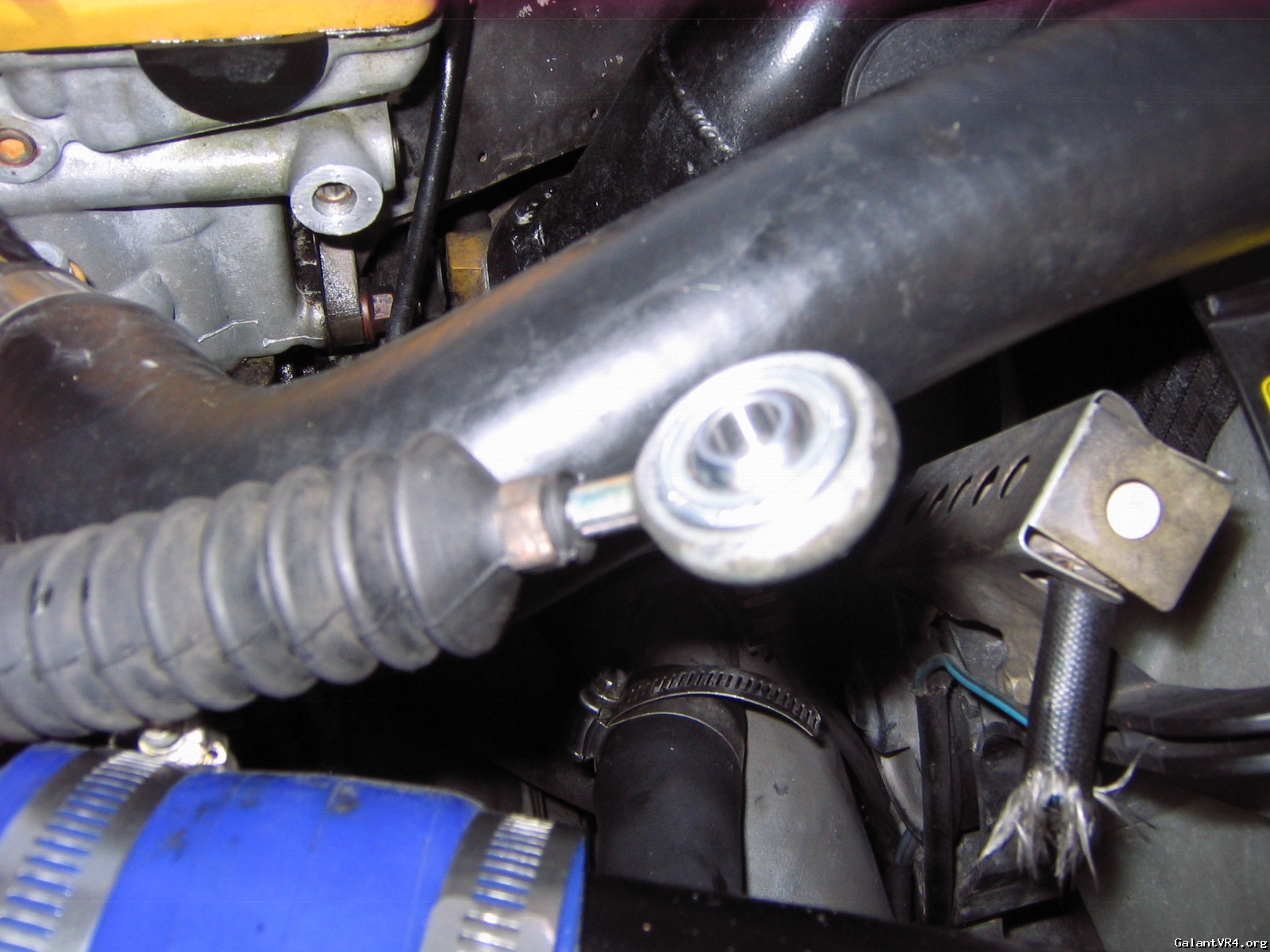

Anyone else that have done the cable bearing "upgrade" and have your front/back stroke bind and actually return to the center position as soon as you let go of the shifter?I adjusted my lever a bit (It was probably bent somewhat)and it works better but still feels tight on the back stroke.I think it is b/c the shift cable and the rotation of the shift lever on the trans are not exactly on the same plane binding it up at the extremes of travel. I did however find a spherical bearing in the proper dimensions Mcmaster part 2995K32(22x8x12 wide)that looks like it will be perfect. I have a couple coming in. I will post my results.
GVR4_1057
Sep 3, 2008
679
Brucetown VA
I got my spherical shift bearings in today. It made a huge improvement over the 608 skateboard bearing upgrade. It is only necessary on the forward and backward cable as this one was prone to bind from my experience. This is the solution to binding shifter bearings.
