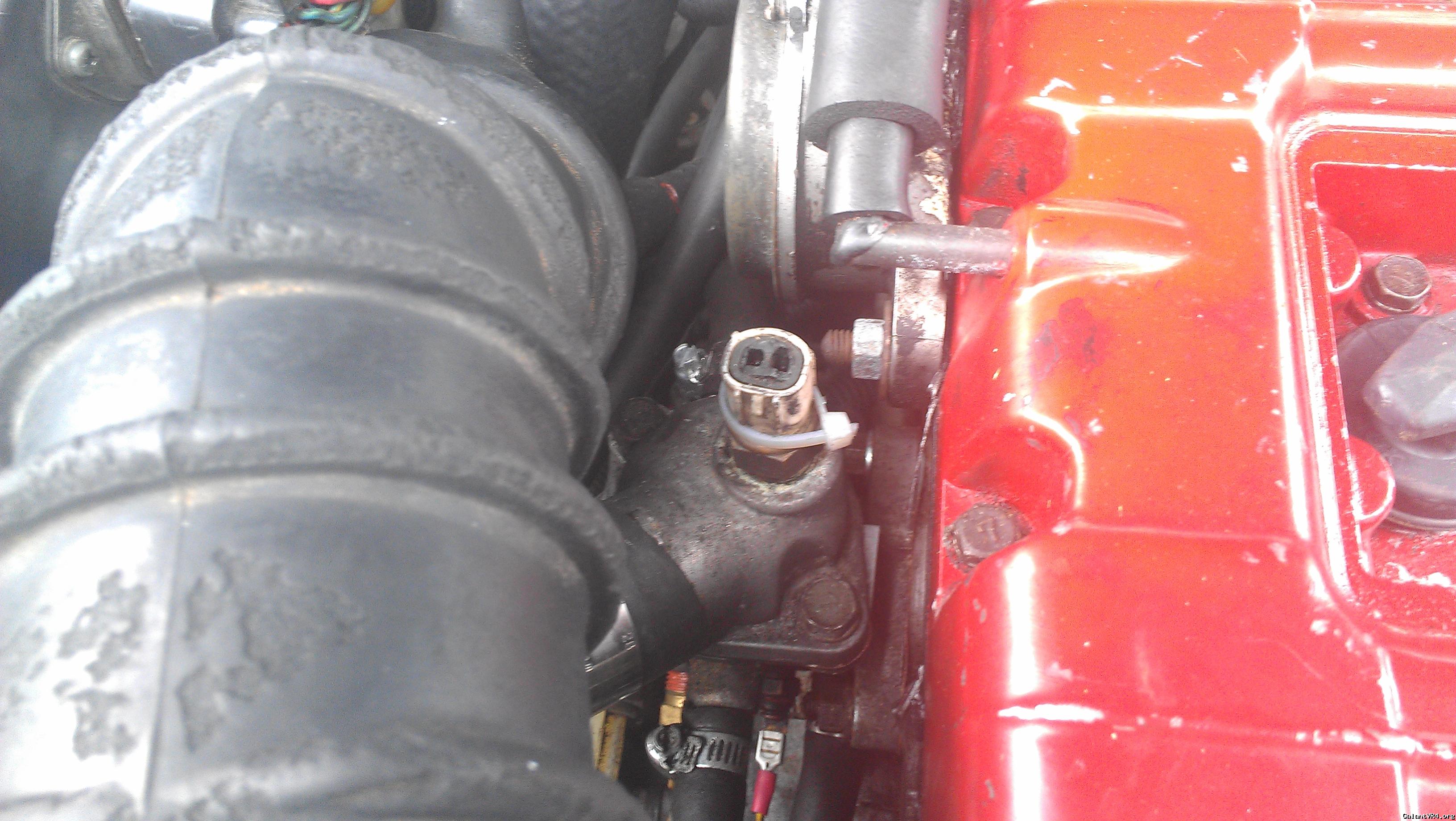

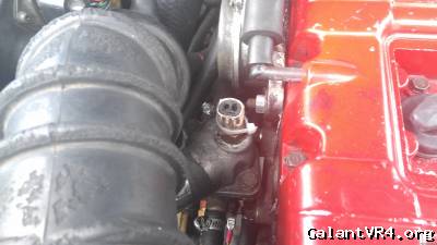

What is this sensor for?
napajs13 Active member Joined Mar 18, 2012 Messages 36 Location Webster, NY Dec 7, 2012 #1 What is this sensor for?

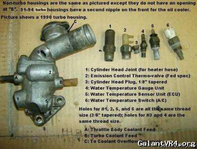

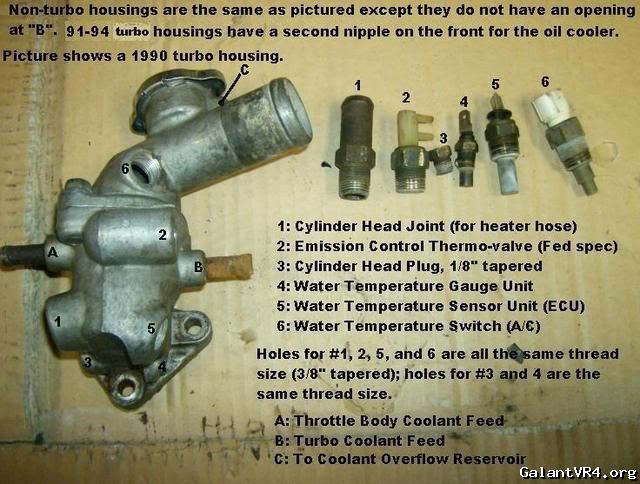

G Staff member Joined Feb 24, 2004 Messages 8,896 Location zompton Dec 7, 2012 #3 I think the colt/ mirage has a nice one that does not have all those sensors.
BpuVR4 Well-known member Joined Jul 11, 2005 Messages 813 Location Chicago Dec 7, 2012 #4 Quoting LIV4PSI: OP got lucky with you posting this so quick. First time i saw it, i had been searching forever for a clear layout.
napajs13 Active member Joined Mar 18, 2012 Messages 36 Location Webster, NY Dec 7, 2012 #5 Sweet thanks! I don't have A/C so that won't be a problem. I'm still trying to figure out why my damn radiator fan isn't kicking on.
