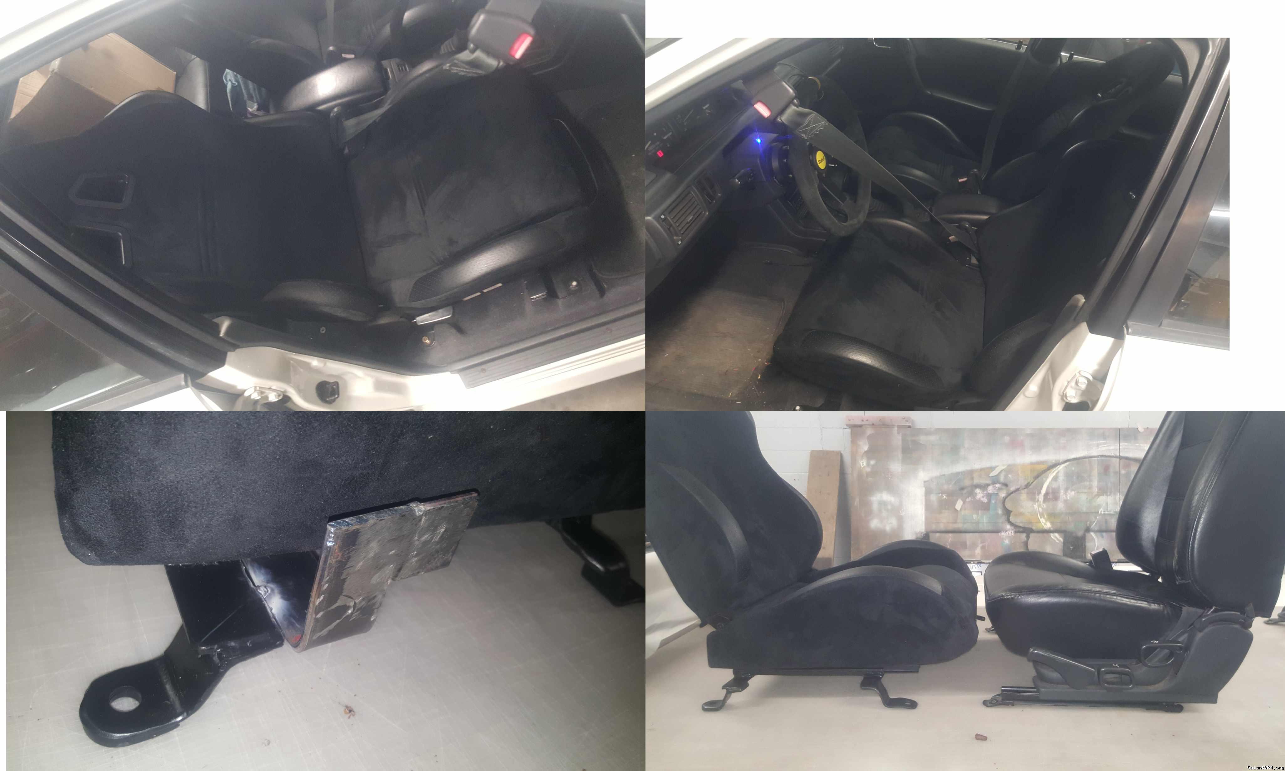

UPDATE:
After a lot of trial and error i successfully made a copy of the bride passenger side bracket for my drivers side. I also adapted the bride passenger rail to my new seats. both using the factory seat belt parts to work like factory. I love the end results, i also ordered the black leather and suede evo 10 rear seats to match.
