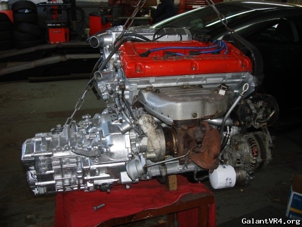

For the most part if its listed here, it means I've replaced it while I have owned the car. This is within the last 11k miles/3 years. Theres about 155,000 on her, I bought her with 144k. Only things with a * in front of them were done by the previous owner.
ENGINE
OEM 1g rods
OEM 2g pistons
ACL Race bearings
balance shafts removed
grind and polish crankshaft
bore&hone block
3 angle valve job
balanced rotating assembly
OEM ITM Oil Pump Assembly
OEM 3g Lifters
Poly mounts on rear, front
OEM mounts on timing belt side, and transmission side
OEM Gates Racing Kevlar Belt
NGK Wires & BPR7ES Plugs
OEM Crank pulley
OEM Timing equipment
ARP L19's
OEM 4 Layer Head Gasket
Magnus Heat Barrier Intake Gasket
