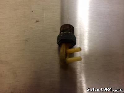

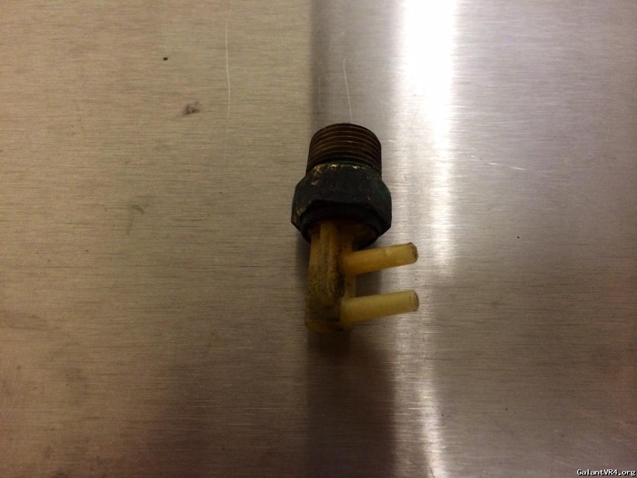

I use the VDO "Vision Black" mechanical engine temperature gauge purchased here:
egauges.com
I removed this little guy, the thermo vacuum switch temp switch located on the water neck to the right of the coolant temperature sensor if I'm not mistaken:
Using the VDO gauge as a replacement for the thermo switch and the accessories that came provided was all I needed to perform the installation. Very stock appearing and complements the galant interior quite nicely to boot while providing a "fairly" accurate coolant temperature reading.
