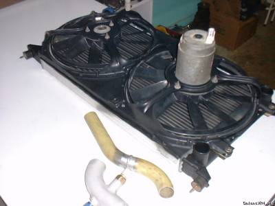

But part of it is the fan I have, its from a passat and is a little long because the passat has the same style radiator just a few inches longer but has a single motor and dual fan driven by a belt system. If you don't mind junkyard parts hit the yard and look for a early 90's passat or audi which has the same thing.
The motor is big and a two speed unit but the corrado motor is shorter in lenght and doesn't stick out in the way as much and bolts to the factory vw shroud.

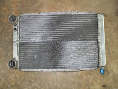

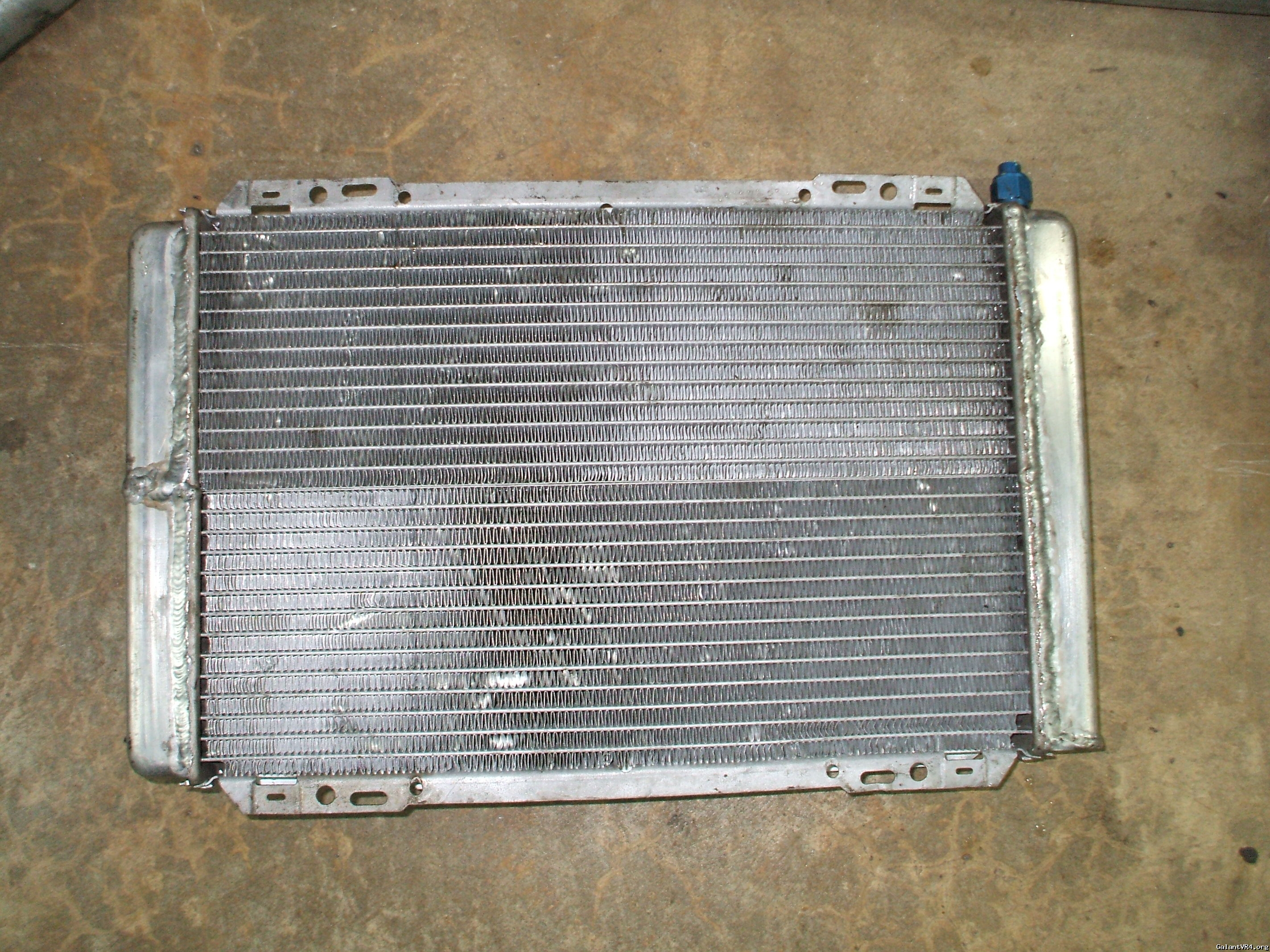

Larry if your interested I remembered I had this in the shop . Its two afco cores welded up in a dual pass design. The tubes need to be finished up and the fitting on top for a vent. Probably 30 mintes to finish I just haven't got to it. Its 21 by 13.5 total size with 2 inch supply and return pipes and the small aluminum piece is there for the factory sender. Theres the normal handling bent fins but noting to stop air flow just isn't gucci racing.
Pm me and well talk price, trade etc.

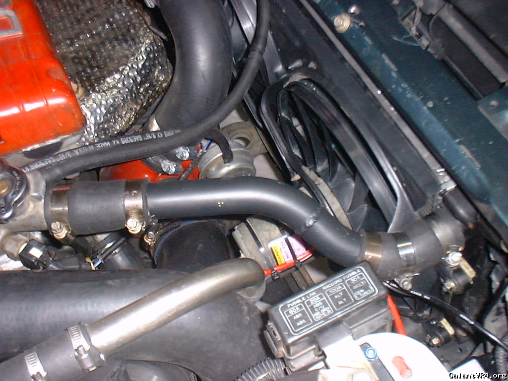

ive been running one close to a year now and im very happy with it. i actually
ran it all winter last year w/o a fan and never came close to overheating
