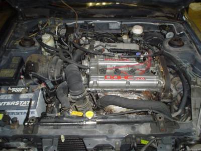

Back in September, I purchased 50/1000. It's a pretty interesting story, but I won't go in to details. Basically the car sat in a crappy dealership lot in the ghetto for at least 5 years. It was a Texas car originally but the original owner brought it up to Kansas at some point. I can't say exactly what order everything hit the fan in, but when I purchased the car, the dealer told me that it had a bad headgasket.
Over the last few months I've done the following and more:
Fixed all of dings.
New Kensington Gray paint.
Used, rebuilt head as all 8 exhaust valves were bent on the original.
New water pump.
New timing belt.
New alternator belt.
New power steering belt.
OEM Fuel pump out of my other car.
OEM MAF out of my other car.
Refinished and sealed the gas tank as the varnish had rusted it.
Installed a cd player because the stock one was stolen.
Removed bubbled, purple tint.
Replaced the viscous coupler because the car was towed on two wheels.
Had the center diff rebuilt because the car was towed on two wheels.
Cleaned and/or painted all black trim.
I had everything off the car for paint including all side panels/molding to make sure there was no rust on the car.
To-do list:
Fix fuel gauge/sender.
Re-install the front and rear window trim.
Wash the carpet.
Install rear spoiler.
Remove balance shafts.
Install new fuel filler hose.
Install new thermostat.
Tint windows.
Install rear dog-legs.
Spray on new undercoating.
Have transfer case recall done.
Install some gvr4.org stickers /ubbthreads/images/graemlins/grin.gif
At this point, I'm not totally sure what I'm going to do with this car. I think I'm going to use it as a daily for a while, as I've been wanting a 4 door AWD car for a while. Or, I may see if I can sell it and find something else. We'll see.

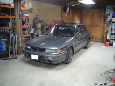

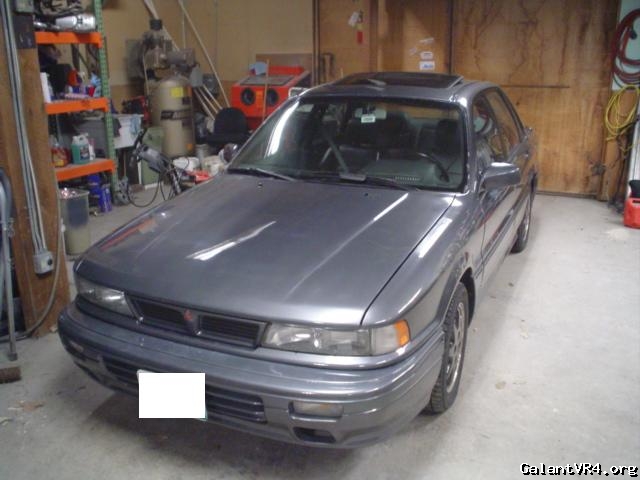

On to the pics (Sorry for the crappy quality!)

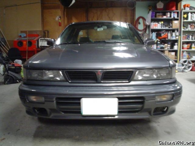

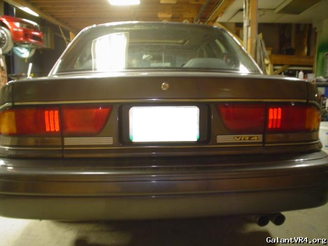

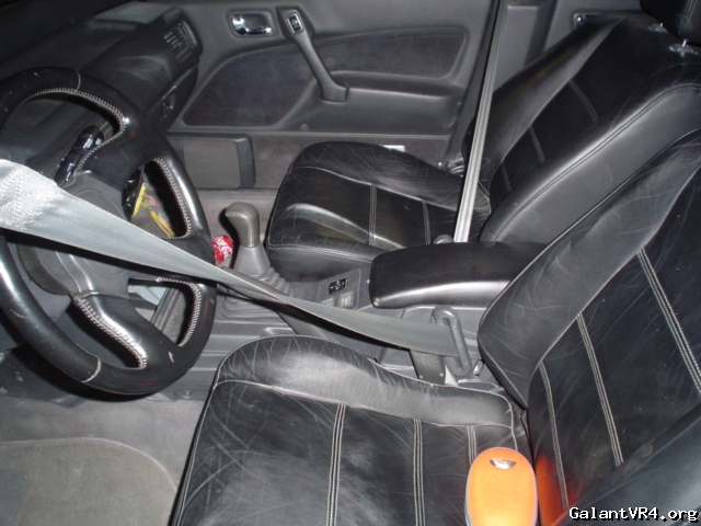

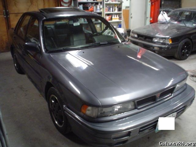

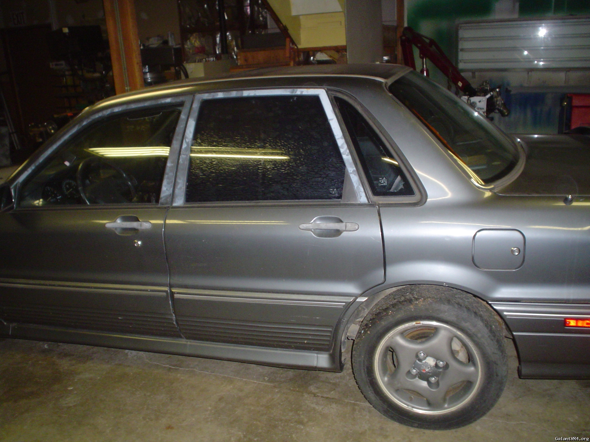

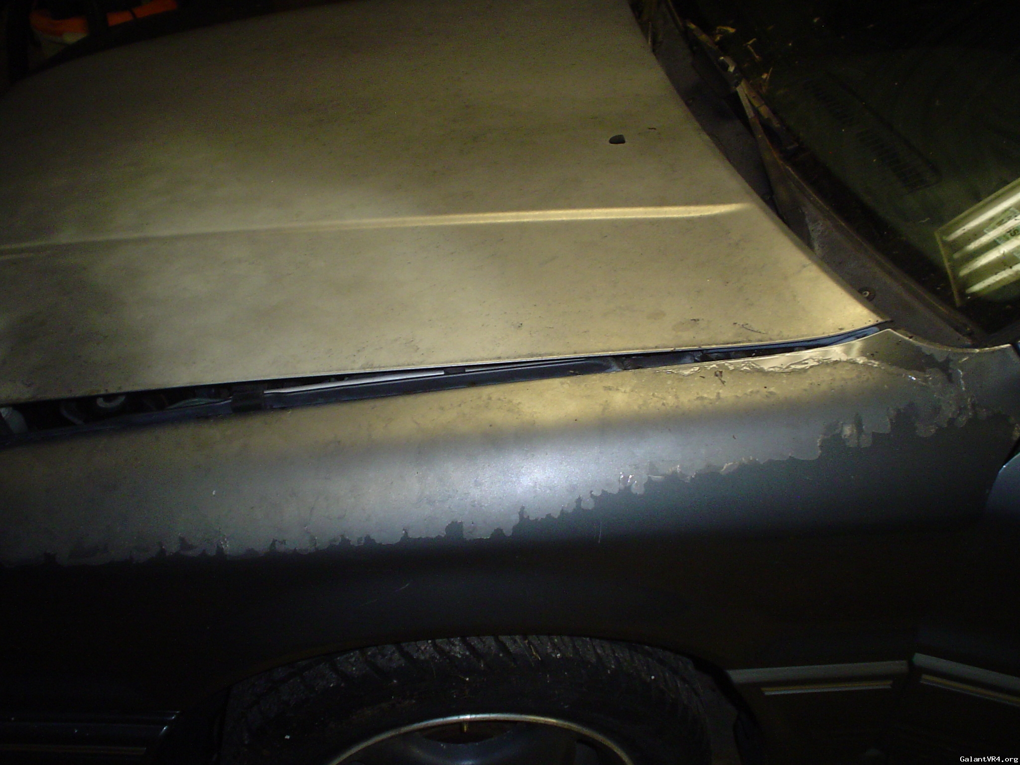

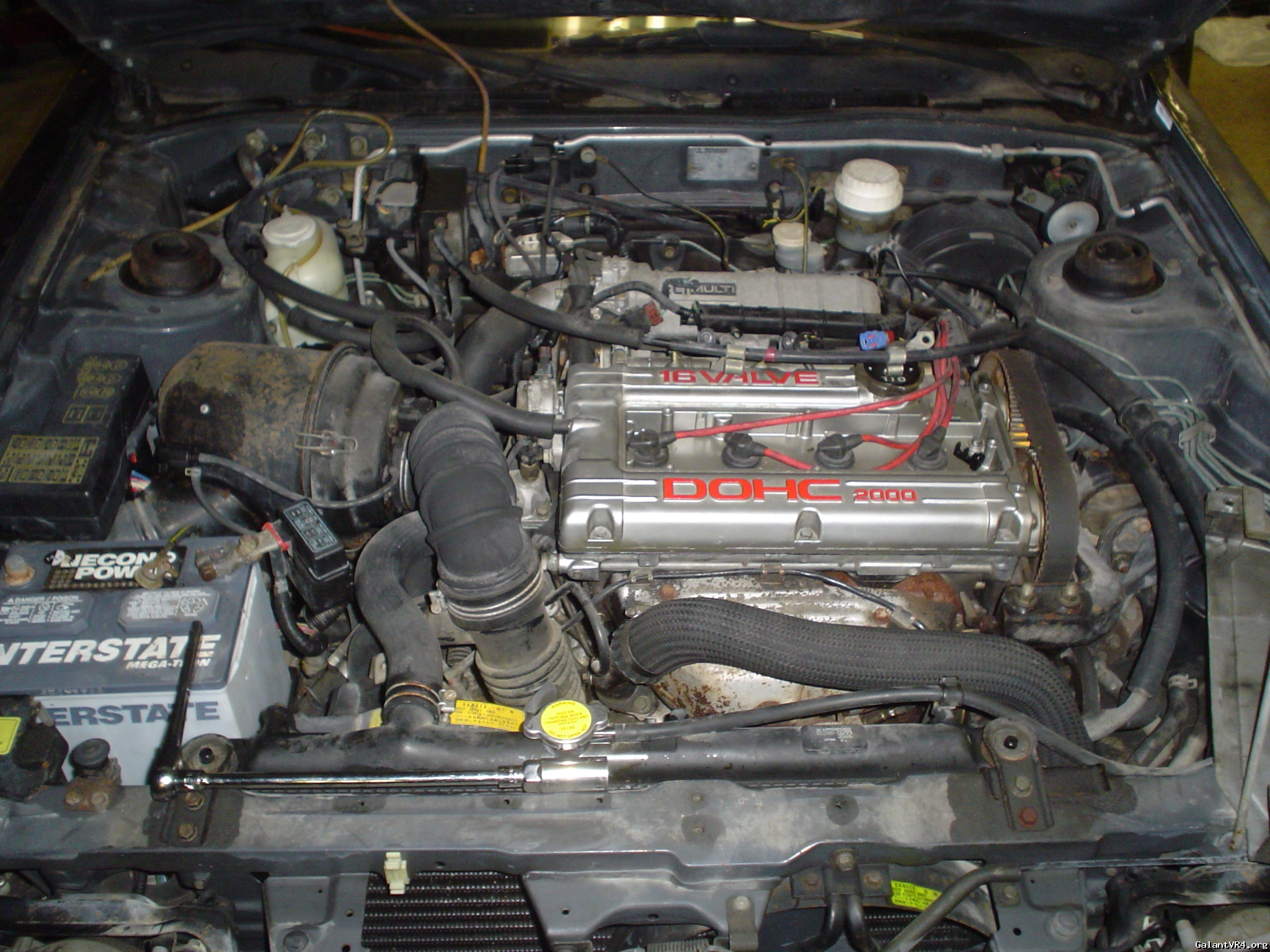

Pics from shortly after I got the car:

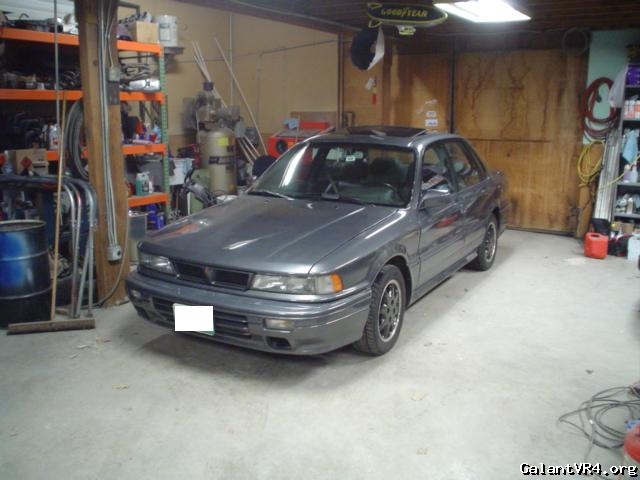

After throwing it back together and preparing for a trip to MN over Christmas:
Fog lights have since been installed:
The best external mod you can do to a vr4:

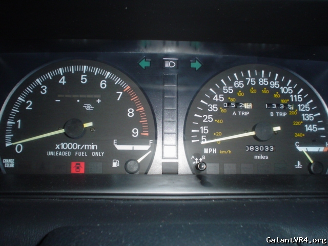

Car had just over 82k on it when I bought it:
Seats have amazingly soft leather:
Restoring a car is a lot of work!

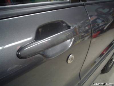

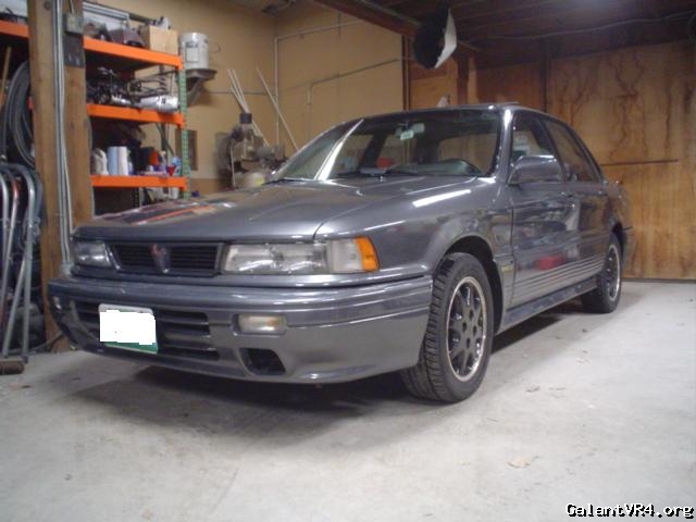

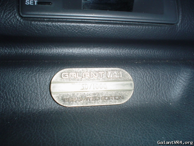

Wow, night and day difference. Bless your heart, that paint looks fantastic. And thanks for including a dash badge pic, I constantly hunt for pics of them to save to a specific folder. /ubbthreads/images/graemlins/laugh.gif

thats piant looks great. How much did it set you back or did you do the work yourself? I still need to go outside and rip off my damn spoiler /ubbthreads/images/graemlins/banghead.gif

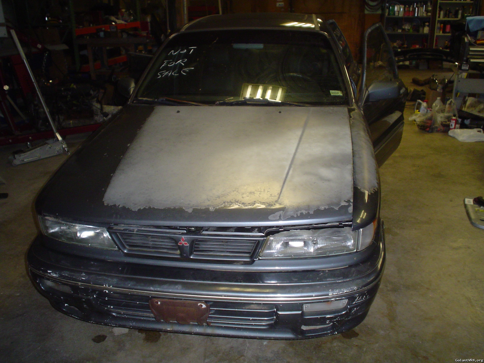

holy jeebus!!! thats sexy. was that actually bare metal on the hood when u bought it? very nice ride bro

The painted door handles do look nice, great job. I applaud your efforts sir, looks good.

Nice car! I agree about painting the handles. That was one of the first "mods" I did to my white car along with painting the badges. Made it look 100 times better.
Did all of the prep and paint work myself, so not nearly as much as it would have cost for someone else to do it. No idea on how many hours I put in to it, and I'm sure I didn't do it all in the most efficient manner, but I spent several weeks on it working most nights during the week and a good chunk of time on the weekends.
It looks like it, but that was actually just the base-coat after the clear was all baked off.
