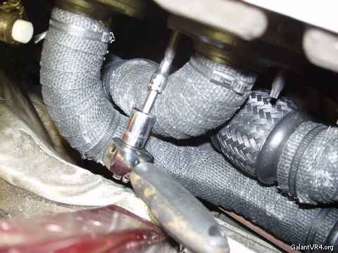

Possible replacement for exhaust manifold studs which will permit you to remove studs for easier exh. mannifold removal: Saturn p/n 11518152 under $10 for a set. The Saturn studs have a male torx head so you can turn them in or out without double nutting. And you don't need the torx wrench cuz a 6mm 6-pt socket does the trick. Or is it 5mm? Middle age is setting in. I hope you can access this photo:
http://forums.rennlist.com/rennforums/attachment.php?attachmentid=126912&stc=1

that sounds pretty nice. they are the correct thread size & pitch? Is there a discussion about it on rennlist? you do have to be registered to see the image though, so here it is
