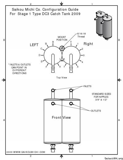

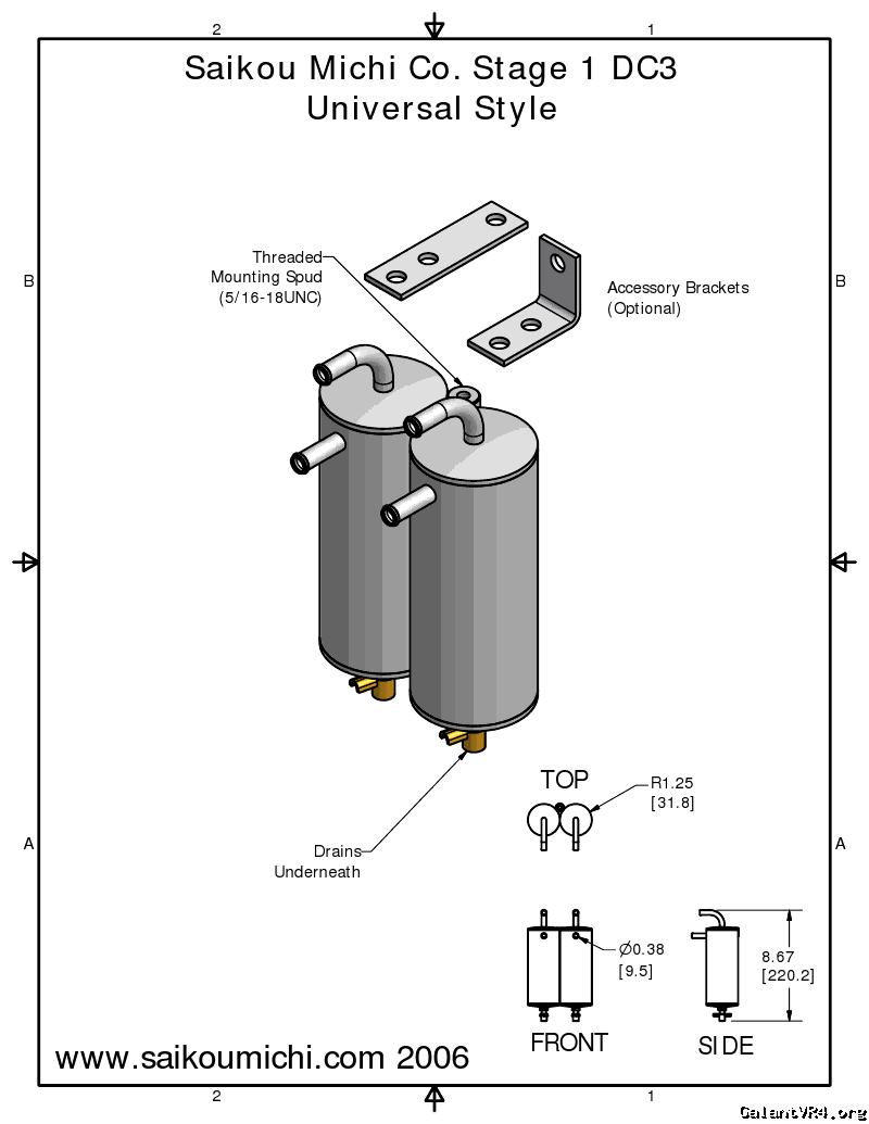

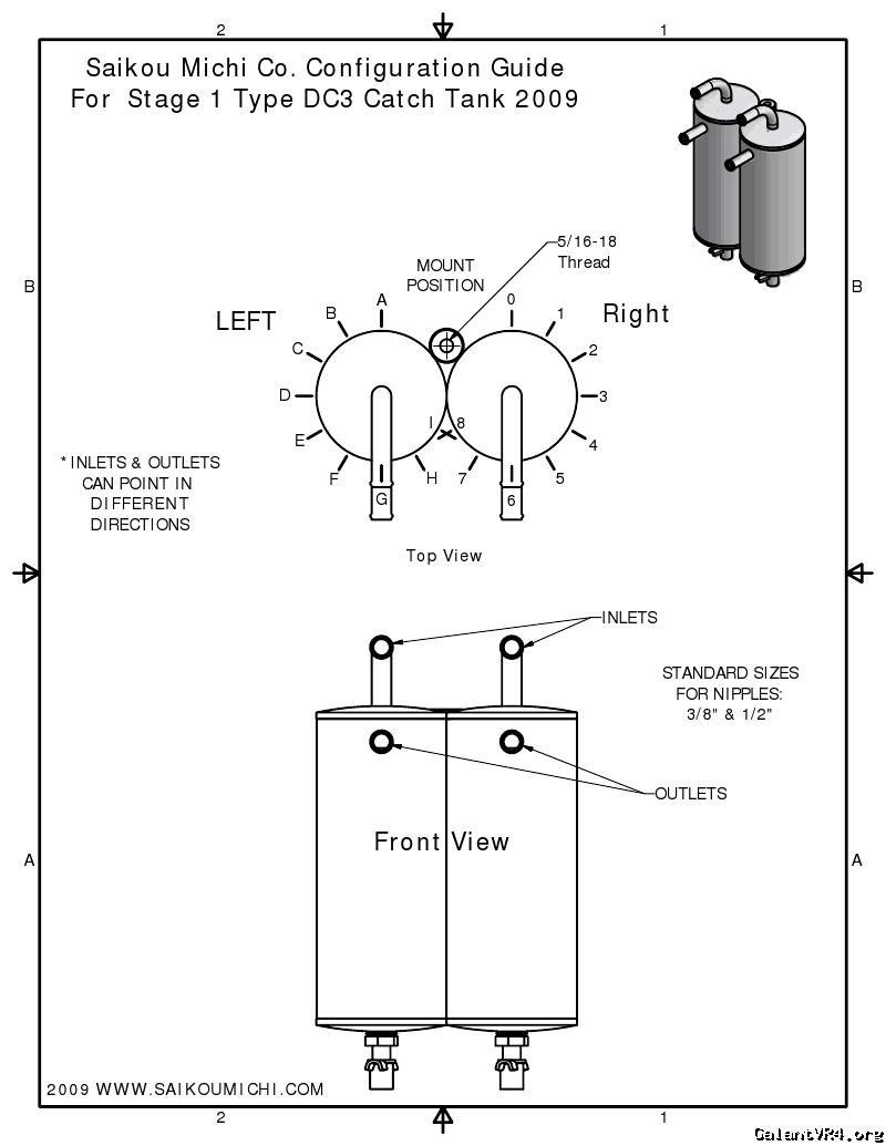

Thinking of ordering one of these bad boys for #261 but there is no standard configuration
for the galant. Below is what he came up with unless I want bigger nipples and a different
orientation for said nipples. I am thinking of putting it where my battery use to be located.
Please tell me what you think, should I stick with this standard setup or go with bigger and
or different orientation of the nipples.
Thanks...

I run the "standard" set up and it works great. No need to change anything. If you checked out saikou michi's website you would of seen that they will build you a custom one for your needs.

Sean thanks for your input but as I stated above they havent done too many vr4's and so
there is no galant specific kit like some of the other applications. The whole point to my
question was to determine if anyone had used a different setup than the one I posted because
they do offer custom setups based on nipple size and orientation.
Thanks again anyways ordered.

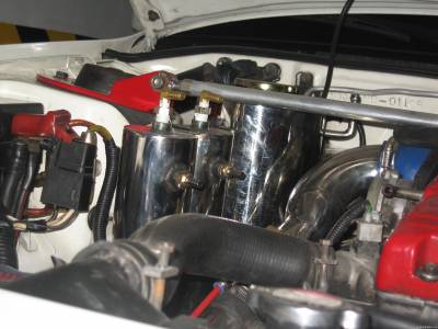

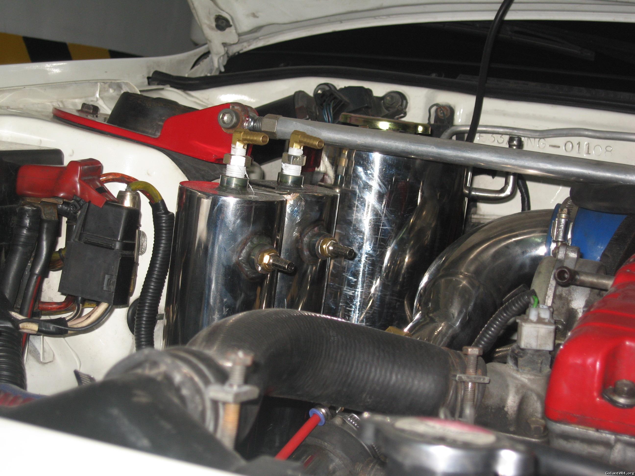

I run the dual one you have a picture of and I just found a place to mount it. I mounted mine down where the charcoal canister would of been. I think alot of the evo guys run the same one.
One can you need to run from the PVC valve to a vacuum source and the other can I ran from the breather on the side of the VC to a barb a have attached to my intake. Don't quote me on how I ran my vacuum lines I have to double check. But it really helps keep oil out of your intercooler piping and intake.
