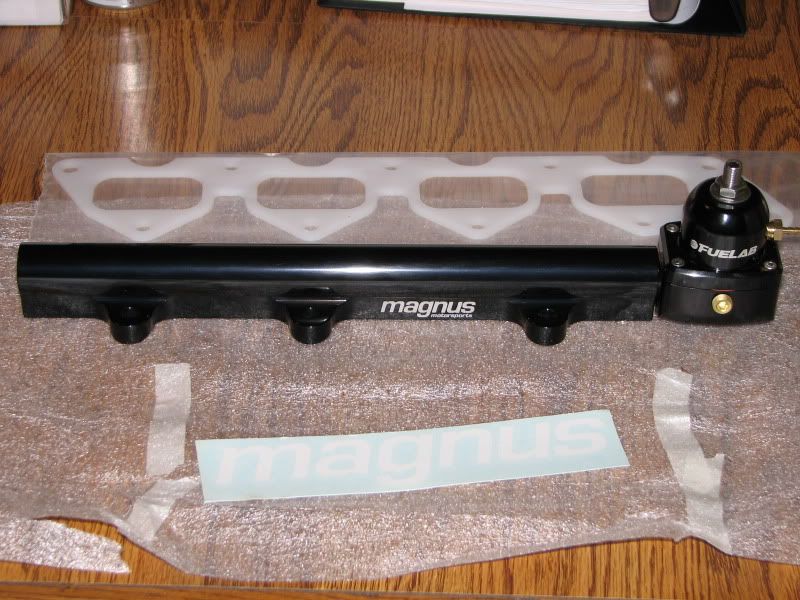

-Magnus Fuel Rail

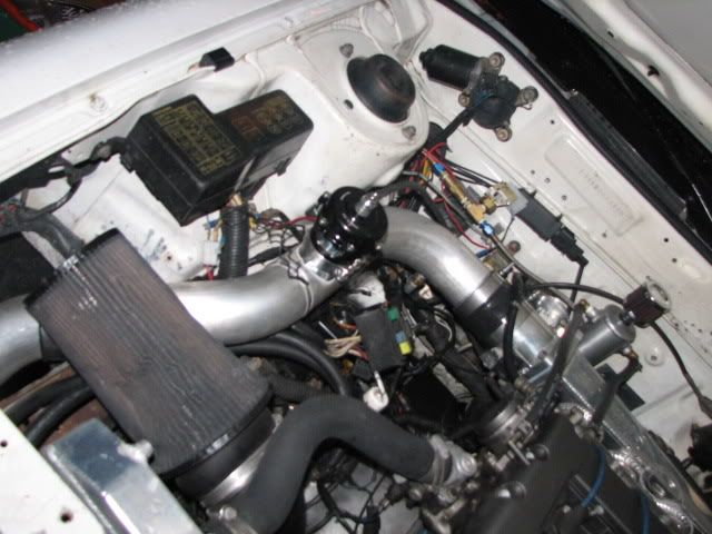

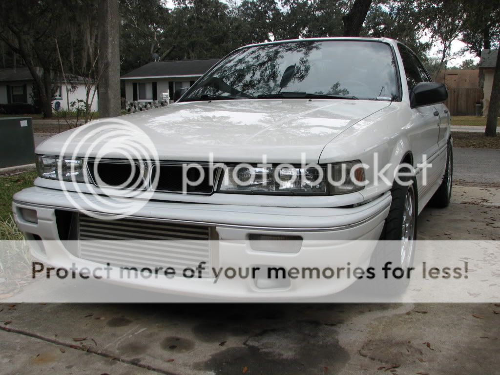

That's actually after my brother cleaned it up a bit and moved everything either down or off of the firewall. The wiring is still very messy. Everything should be cleaned up soon.
Waiting for the Wilson 75mm throttle body to come in to do the custom FMIC

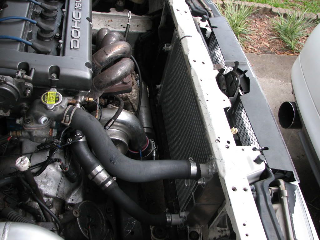

Wondering what kind of radiator you have. Also the installiation of it? I am looking for a half size radiator myself and am interested knowing about your setup.
Thanks in Advance
ZeroCharisma
May 23, 2009
19
Orlando, FL
The radiator is from a 92-00 SOHC honda civic. Mine was an aftermarket one bought on ebay if I remember correctly. When Deanan installed it, looks like he used the stock brackets and trimmed the stock hoses. The car usually runs around 210 when driving in the city. That was when i was having problems burning out electric fans and with no tune on the car. I just ordered another 3000 CFM, finger chopper from perma-cool and going to see if that helps at all. There are a few different write ups on DSM Talk, DSM tuners, etc. We did the same install on my brothers 95 GST and it runs fine with no overheating issues.

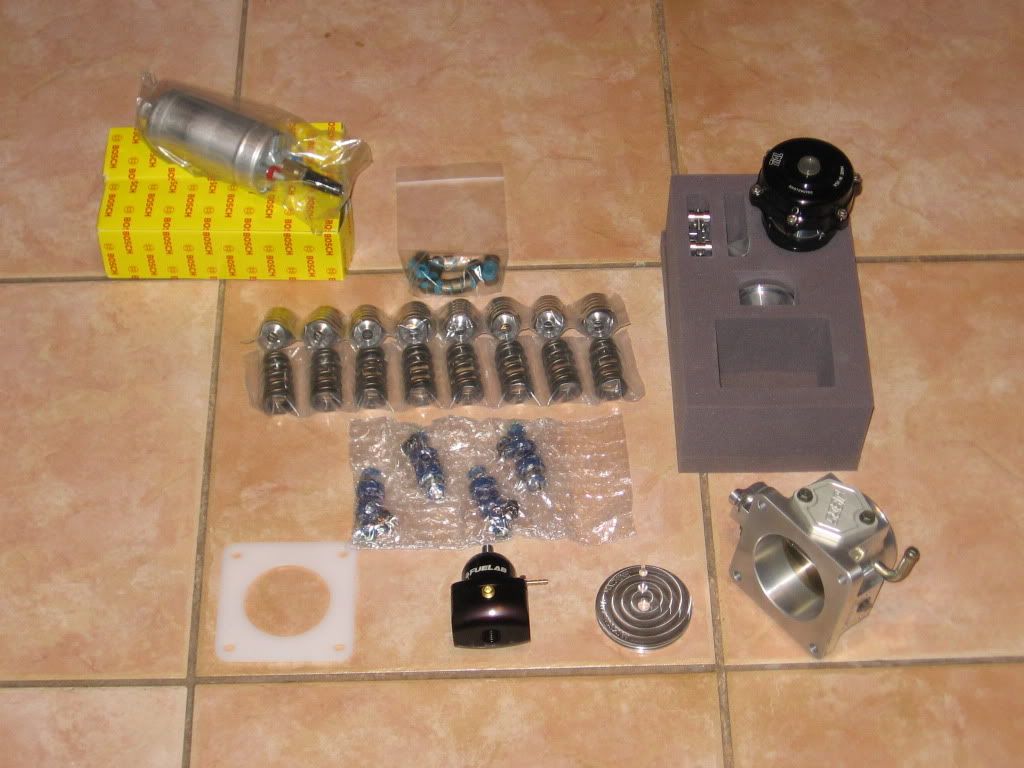

Some new additions:

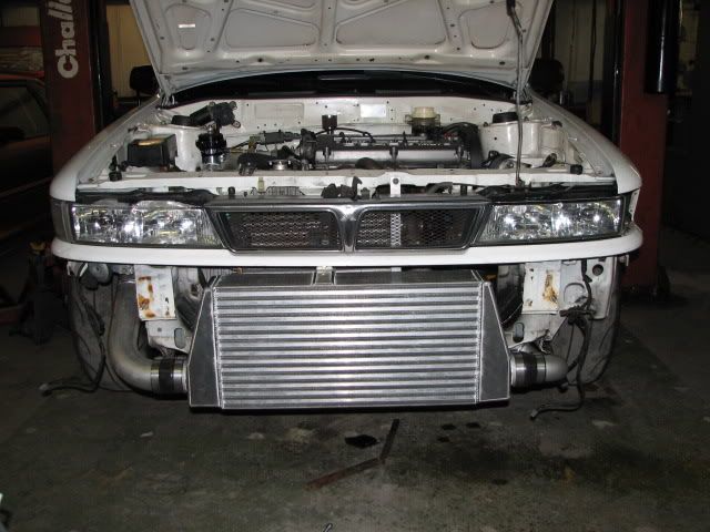

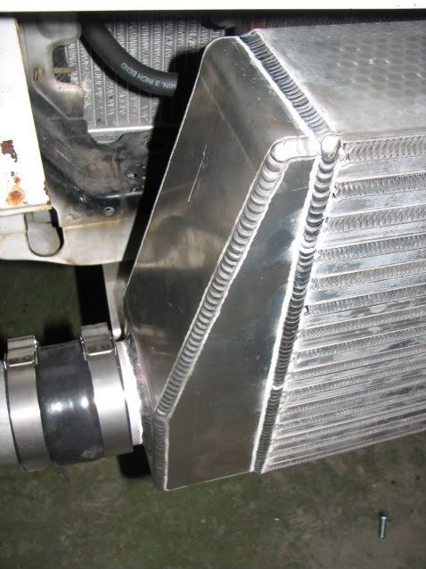

Garret 4.5" core and custom FMIC kit. Built by Mike Vig at RealStreetPerformance here in Orlando. He is also a fabricator at Titan Motorsports.
In these pics...
Tial "Q" BOV
Wilson 75mm Mustang T/B
Jackson auto Machine throttle wheel
Phenolic t/b gasket (bought on the dsmlink forums)
FFWD "bee-mad" beehive springs, Ti retainers, nitrated seats and Manly machined/nitrated locks, "low rider" VSS's
FP inline filter and custom feed line (note: it no longer has the incline as pictured)
Heatsheild Products T3 turbo blanket
BFG KDW-TT street tires
JDM corner lenses
Next:
FIC 2150's
x2 Bosch 044's
fuel cell
wire tuck and custom harness
powder coating the charge pipes, valve cover and catch can

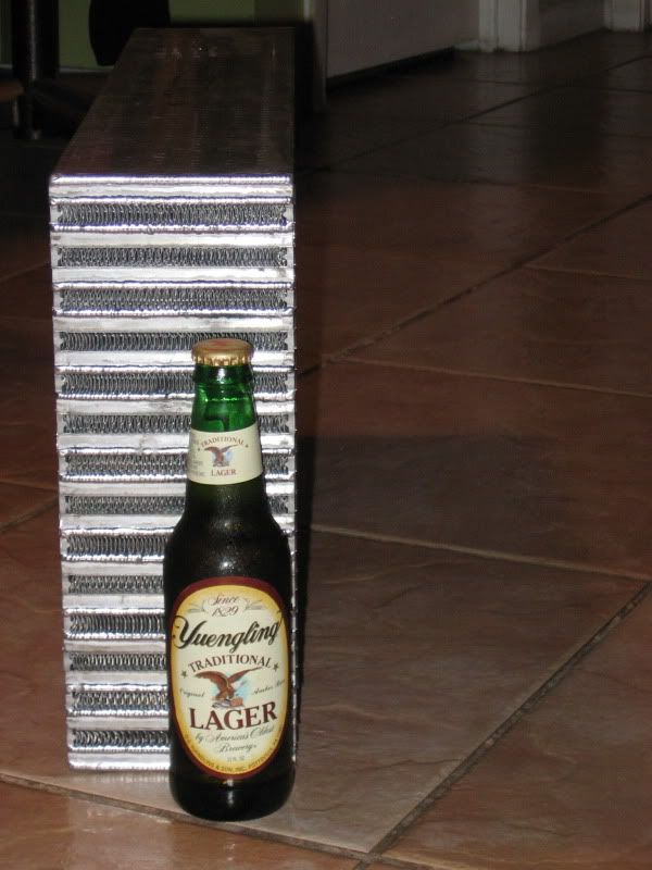

Garrett intercooler core (for reference)
I think the core itself is 24"x 12"x 4.5"

Holy intercooler core Batman! Looks really good man. That fab work looks top notch, its good to see solid work going into these. None of that 'we do it nice cuz we do it twice' junk. Good choice of beer too /ubbthreads/images/graemlins/smile.gif
How much of the bumper support is still there? I've been thinking through an intercooler setup and the way I want to do it will require a fatty core like yours, but I really don't want my bumper to sag at all.
Just plain sick looking car when are you heading to the track to see how fast it goes.
Thanks for the compliments guys! Mike Vig does phenomenal work. He has worked on some of the worlds fastest cars, including Darrin Dichiara's 8second 6spd Supra. (http://www.youtube.com/watch?v=VLHbXGM1lIQ)
Most of the bumper support is gone at this point. There are only two posts that connect the fascia to the car. The need to fabricate a better bumper support is evident. Though, the sides are sagging on this car because they have broken bolt holes where the fascia attaches to the fenders.

-10 feed lines to fuel rail, -6 return
