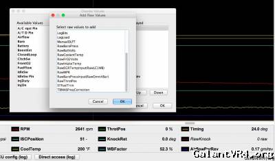

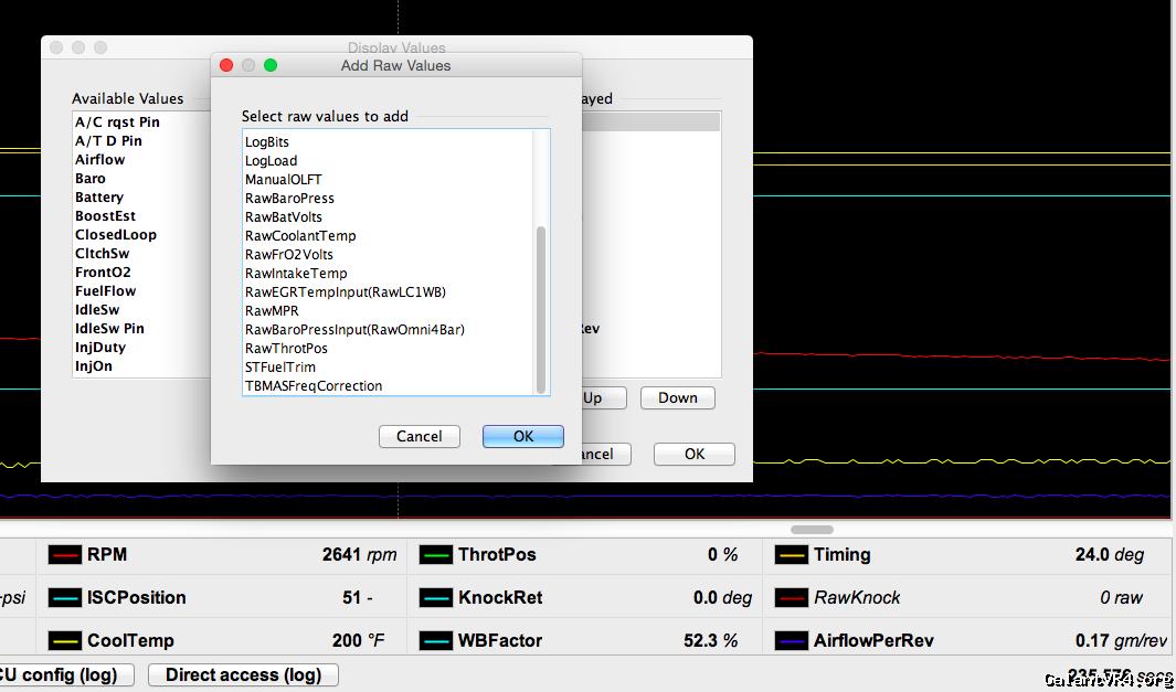

Quoting EfiniX:
oh, and I've had a hell of a time finding that voltage setting in link. Just doesn't seem to be there, but the fact that you can display it leads me to believe I'm nuts?
Oh, and the raw WB value is right there in your screenshot. It's the one that says RawEGRTempInput(RawLC1WB)

*facepalm*
Of course it is, because I've got the WB pinned in on the EGR port. wow... just wow.
Anyway, it's not there anymore. I switched over to LinearWB. I had to bump the minimum voltage up to 0.20, but the WB reading in link is now tracking perfectly with the gauge reading. That along with the adjustments to idle on the VE table, and the adjustments to global fuel... The car seems quite happy. I'll keep logging over the next few days, but I'm in a good place right now. I'll write something up on this process tomorrow so that poor souls searching the same keywords as me can find their way. Heck, I might even knock up a video showing what I was seeing, what I did, and how I got to where I am now. I kept all my configurations and logs, so I can even revert back to the original configuration and show the process.
