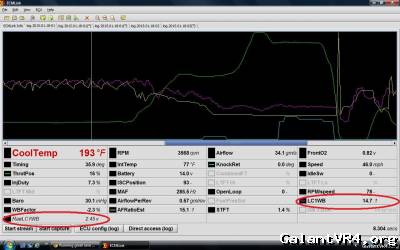

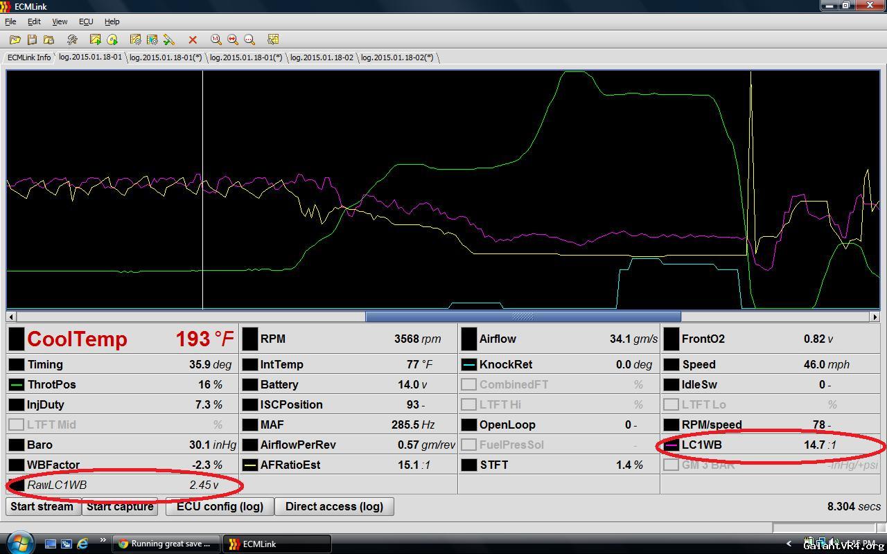

According to your log, ECMlink is reading exactly as it should according to the preconfigured setting for the LC-1 WB:
As you can see from your log, the WB is reading 14.7 and the raw voltage output for the sensor is 2.45v, which is right where it should be. Unless you have reason to believe that 2.44 is not stoich, it's reading right. Since neither of us know what the "delta" output of your gauge is, e.g. what voltage correlates to AFR, it's a moot point. You know ECMlink is reading correctly according to the switch point of the LC-1 sensor. Who cares what the gauge says?
Currently, your AFRs are leaner than what link is seeing. This is verified by your AFRatioEst being significantly richer than your actual AFRs. You could modify the switch point of the sensor, but for what? You already know it's set to where it should be, and unless you have another WB to confirm it's off, IMO it would be silly to make adjustments just so your gauge and ECMlink read the same. Just make a mental note of the difference between the gauge reading and ECMlink, and leave it be. If you screw with the WB switch point, you're asking for trouble.
Make your priority getting your AFRatioEst to line up with your WB by adjusting global fuel. That should be your first and foremost concern.

ECMlink is configured to read AFR based on your wideband's switch point. As long as you haven't modified it, the LC-1's switch point according to ECMlink is preconfigured by the software to 2.44v at stoichiometric (14.7:1). Simply, this means when the sensor sees 2.44v, ECMlink will show 14.7:1 AFR in your datalog. In order to see this, press F9 and look in the "to be displayed column". You should see whatever you named your WB as. Highlight your WB by clicking on it, and then click the Raw value -> button. At this point, you'll see another list of raw values to add. Click on the one that says in parenthesis Raw(whatever you WB is called). So if your WB is called LC1WB, it should say RawLC1WB. Click OK and you should now see the raw voltage value of your WB in the displayed valves of your datalog below the graph.
Once you have the WB value and raw values displayed, capture a log and review it. Find a point in the log where your WB reads 14.7:1, and you should see the raw value reading very close to 2.44v. If it's not, you have a problem. If it is, then the LC-1 and ECM link are working as they should. It may just be that the gauge is off. The only real way to tell if the 2.44v is actually stoich is to verify your AFR with a second WB. Otherwise, you'll just have to assume that when the LC-1 sees 2.44v, it is indeed stoich. I suppose you could also sudo-double check using your factory narrow band if you still had it installed and knew what it typically cycles at.
You can test the DB gauge in real time. Try to run the car and get the LC-1 voltage to stabilize at 2.44v. At that point, look at your gauge reading, which should right around 14.7:1. If it's not, then it's wrong.
