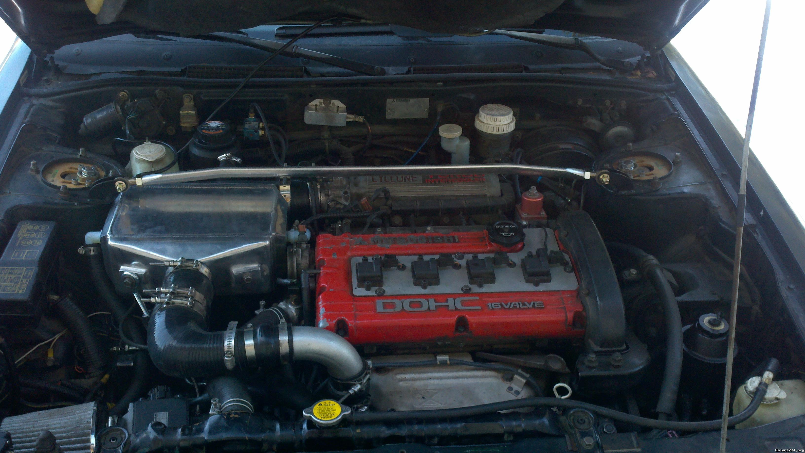

Engine
Stock 120k Bottom End
Rebuilt Head with Evo Valves / Springs / Retainers
Keydiver Stage 3 Chip (the usual with cyclone control)
FIC 650cc Injectors
Evo X Fuel Pump
Buscher Bolt-on AFPR
Cyclone Intake Manifold
Deleted Emissions
N/T Throttle Body
FIAV Bipassed
3g MAF

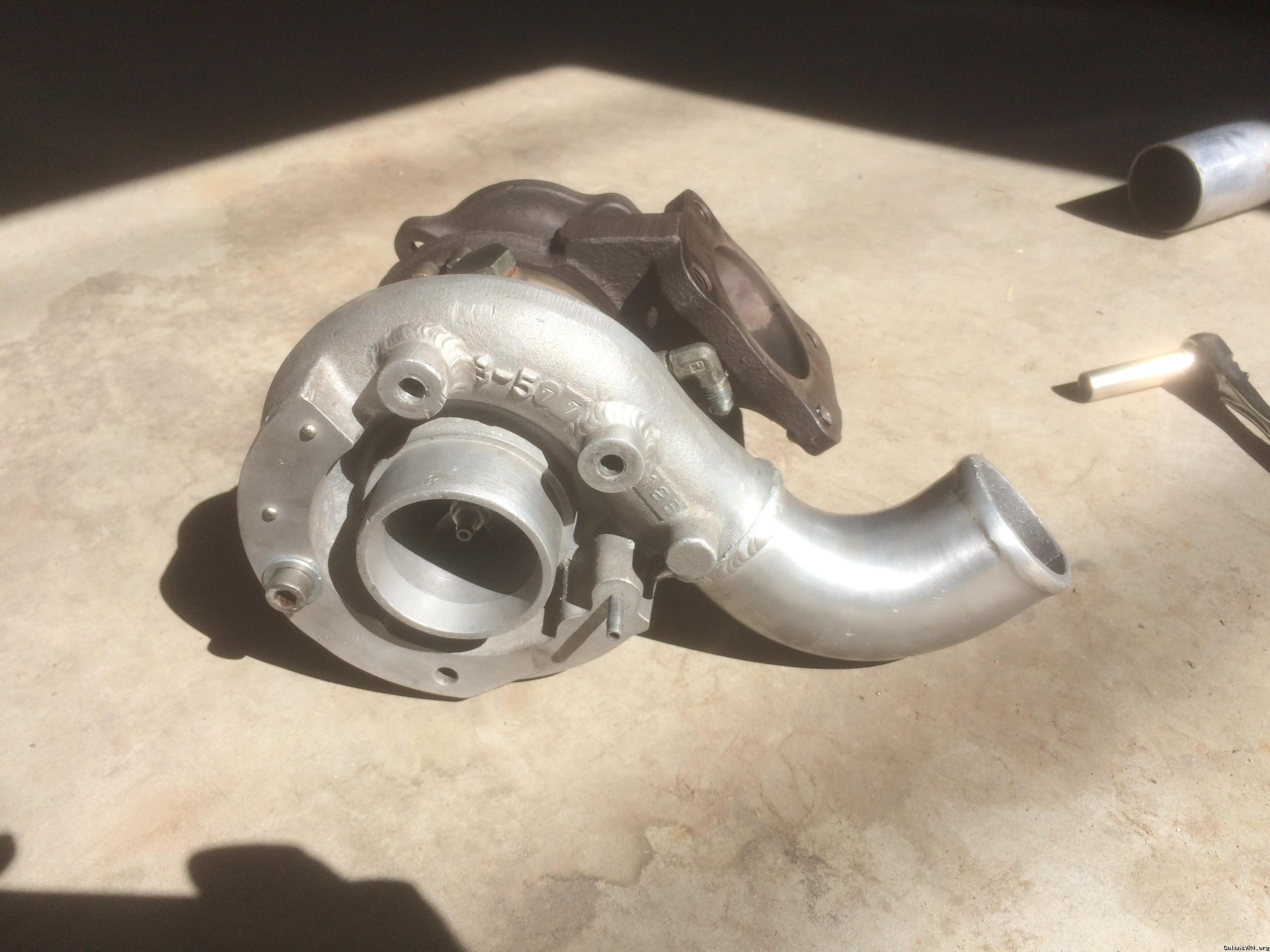

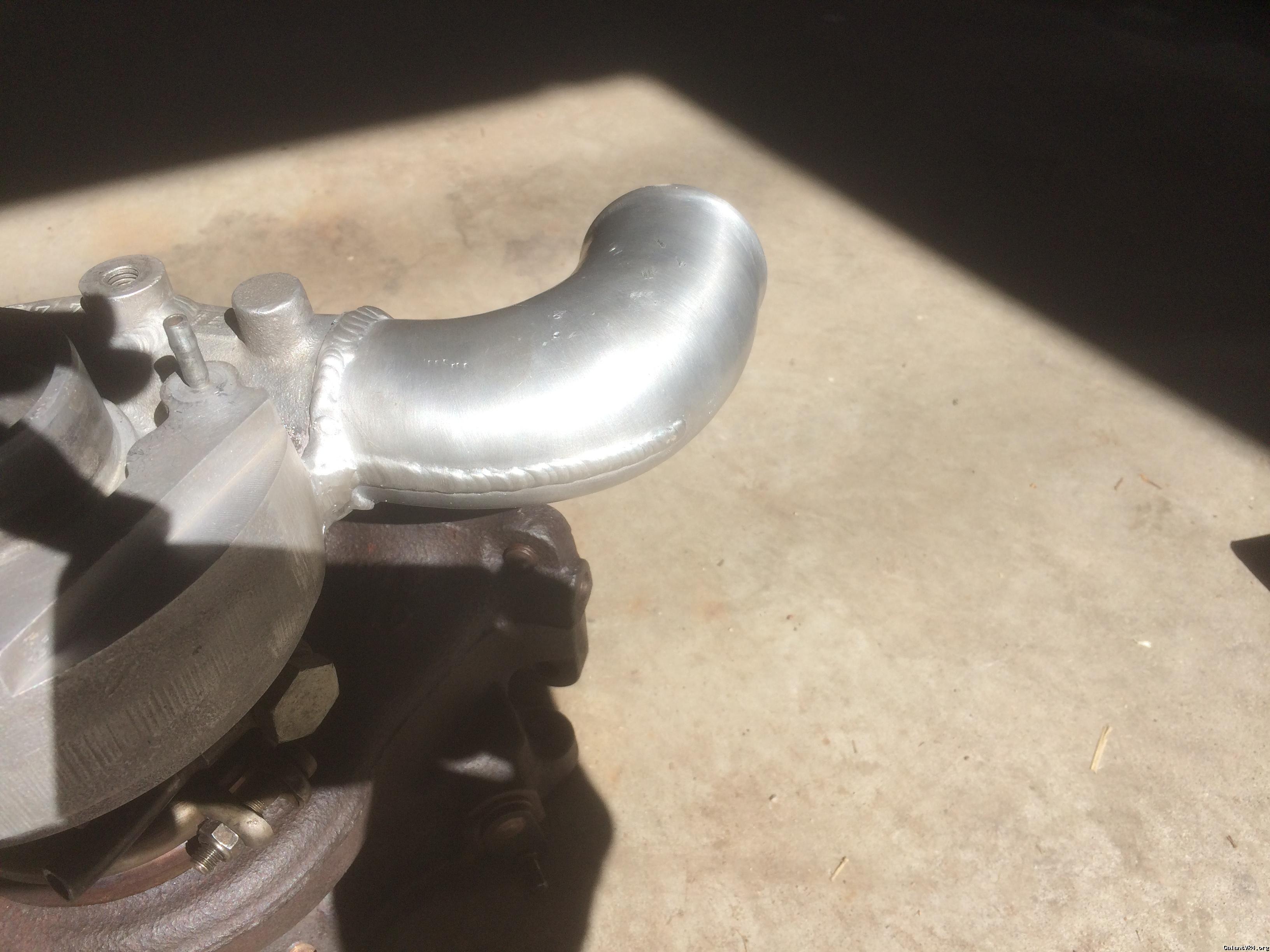

spare: s16g w/ HRC super compressor housing (welded outlet) and E3 hotside (needs work)

Engine
FIC 650cc Injectors
Evo X Fuel Pump
Deleted Emissions
N/T Throttle Body
FIAV Bipassed
3g MAF
Ebay Slim-Fan
