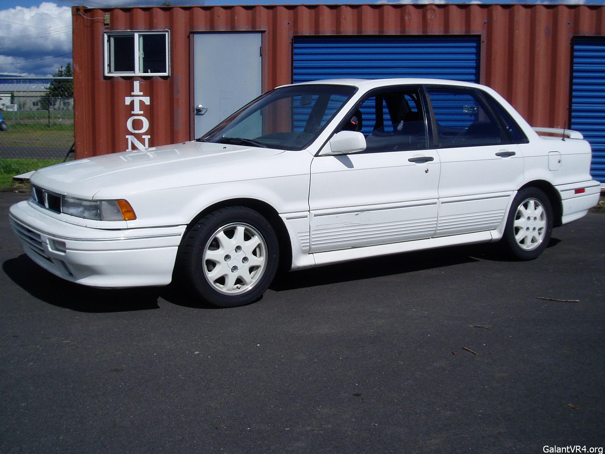

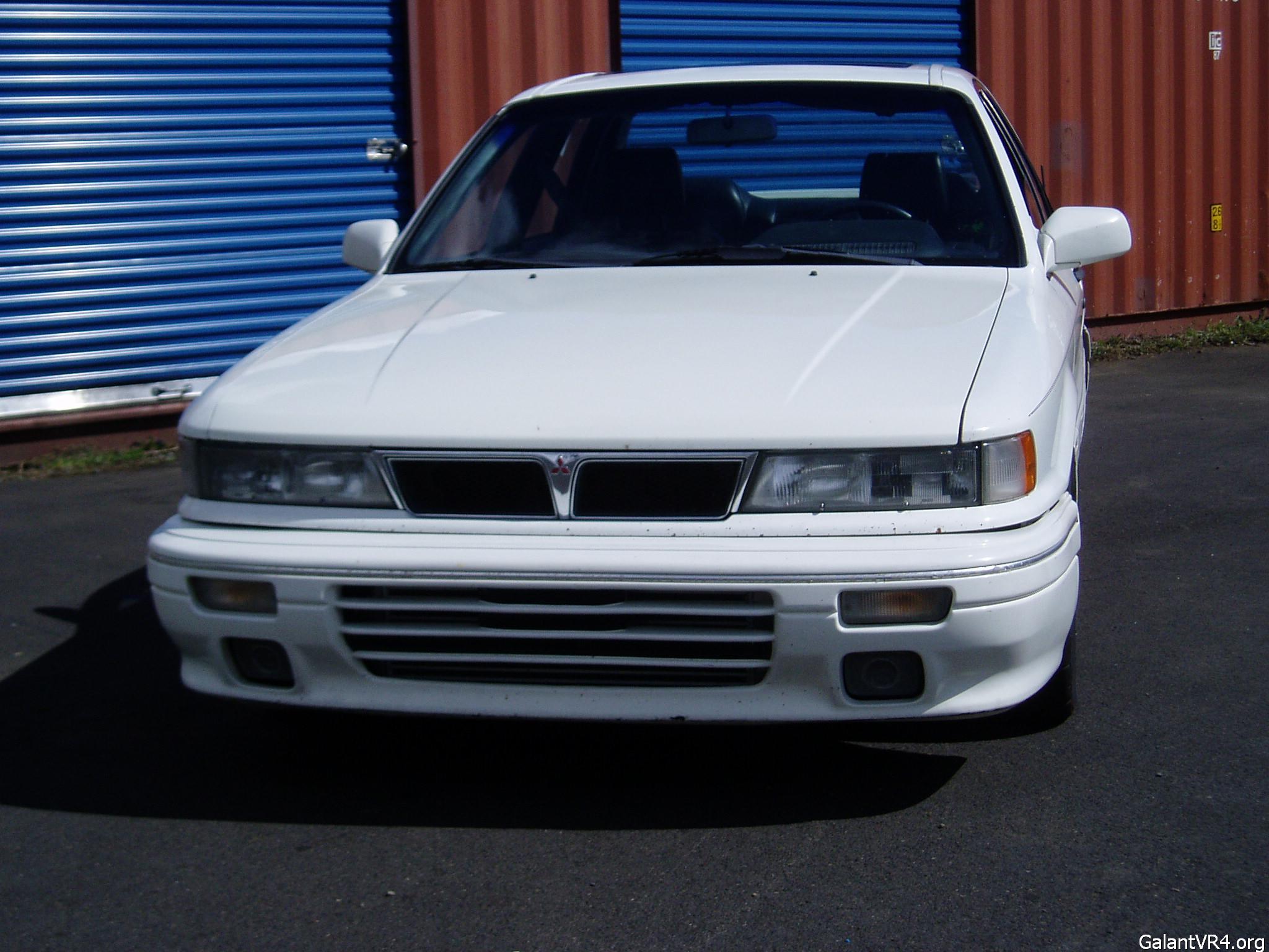

Revolution Motorsport's Galant VR4 #253/2000
1991 Galant VR4 #253/2000
189,500 miles on completely stock long block
Small 16g turbo (ported)
ETS 3" Stainless O2 Housing-Back Exhaust w/AeroTurbine 4040L Muffler
ETS Galant VR4 FMIC Kit w/Stainless Pipes
Denso 660cc Fuel Injectors
Walbro 255 Fuel Pump
FIC AFPF Kit (Aeromotive FPR)
Socketed ECU w/Keydiver Stage 3 Chip
Greddy Profec B Boost Controller
Greddy Turbo Timer
K&N Air Filter
Autometer Boost Gauge
Datalogger
DSG Shift Knob
1G DSM Shifter
DMS Coilovers
Cusco Strut Tower Bars
205/50/15 Falken RT-615's
There are a lot of plans for this car. Right now it's a little tired up top but still has 150psi across the bottom end. Good things are coming soon for the Galant. I'll keep you guys updated!

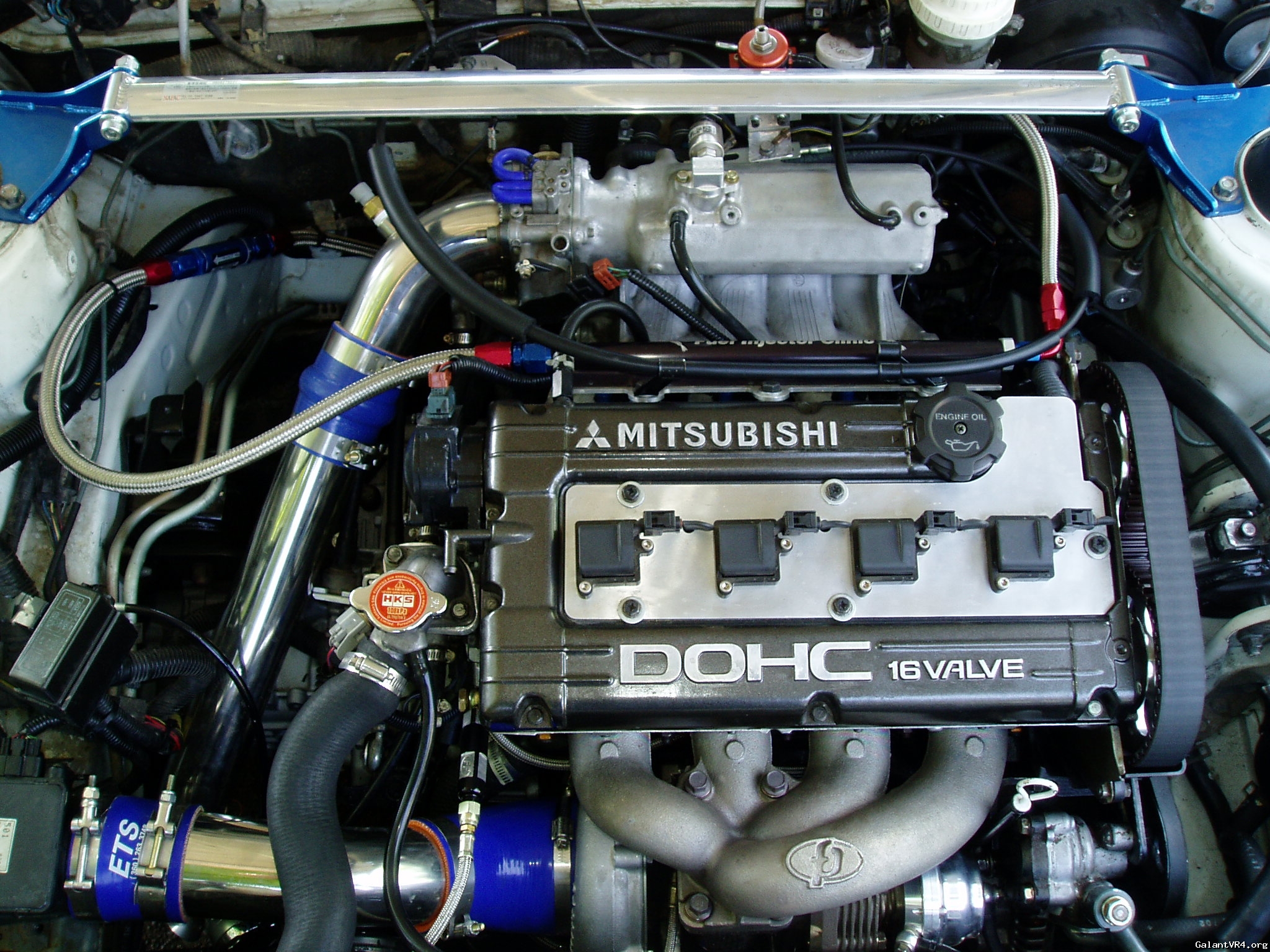

Here's the new setup:
2.3L Stroker
8.8:1 .020 over Wiseco Pistons
Eagle rods w/ARP bolts
Kiggly Main Girdle
Mitsubishi Main and Rod Bearings
O-Ringed Block
Mitsubishi MLS Head Gasket
ARP Head Studs
ARP Main Studs
2G Cylinder Head and Intake Manifold
BC Springs and Titanium Retainers
HKS 272/272 Cams
Unorthodox Racing Cam Gears
COP Ignition
Fluidyne Aluminum Radiator
Spal 12" Fan
FP Race Exhaust Manifold
FP3052 Turbocharger
FP 3" Stainless Steel V-Band O2 Housing
Tial 40mm Wastegate
ETS 3" Stainless Steel V-Band Turbo-Back Exhaust
Stainless Steel Braided Oil and Water Lines
ETS GVR4 Intercooler Kit (3.5" thick) w/Stainless Steel Pipes & Black anodized core
ETS GVR4 3" Stainless Intake Kit
GoFastBits Stealth FX BOV
DSMLink
E85
3G MAS
Zeitronix ZT-2 Wideband w/LCD Display
Zeitronix 3.5 Bar Boost Sensor
HKS 60mm Peak/Hold Fuel Pressure Gauge
SX Fuel Pressure Regulator
FIC Fuel Rail
FIC 1650cc Blue Max Fuel Injectors
Bosch 044 Fuel Pump in-tank
-8AN Fuel Line from Pump to Rail
Greddy Turbo Timer
Shepherd Stage 4 Transmission w/4 Spider Center Diff
Shepherd Transfer Case
ACT Flywheel
ACT 2900 Clutch Kit
Quaife Front LSD
Stainless Steel Clutch Line
4-Bolt Rear LSD
Whiteline Bushings
Rebuilt Drive Shaft
Battery relocated to trunk
