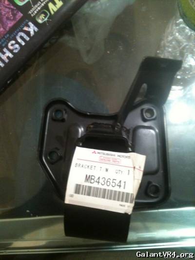

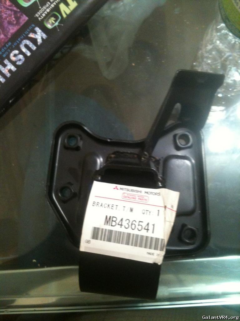

Ok so I received MB436541 from JNZ tuning (they said it was the last one in the country) but my mechanic told me its a different mount. I'm thinking he may have been looking at the rear mount instead of the transmission mount. can anyone confirm this is the proper part number for the transmission mount?
this is the part that I received

I figured it out its the transmission side motor mount.

Yes the mount pictured is for the transmission and bolts to the body.
