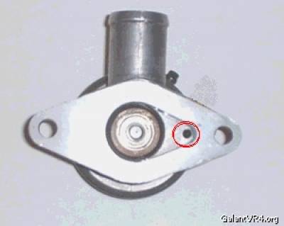

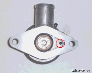

You can prevent the leaking by tapping and plugging the bottom port on the stock BOV:

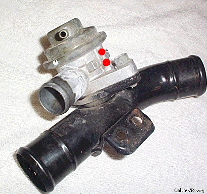

And drilling a hole or two in the chamber that runs up to the diaphragm:
Now, boost won't be introduced to the bottom side of the diaphragm thus causing it to crack open at higher levels. The BOV won't be as quick responding, but this is how almost all aftermarket BOVs are set up. I like it simply because it's cheap and it allows me to retain the stock BOV even at high boost levels.
