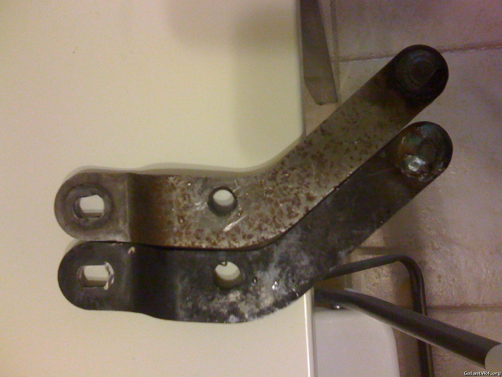

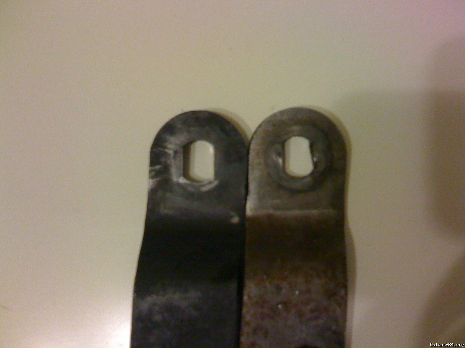

Hello everyone. I finally replaced the worn clutch lever on my pedal assembly. Good news: I didn't have to replace the shaft, which meant I did not have to remove the assembly. Bad news: I bought the shaft and bushings (will be selling).
After much research I found a very old post from someone who had replaced just the lever. This is worth doing, as it does not require removal of the whole assembly and you inspect the components that wear. After removing the lever, you might find that you need to replace the shaft. It was not the case with me, as the shaft end was not worn at all. I believe the shaft is made of harder metal, or maybe it's the fact that it was machined, but it was not worn at all. You can see from the pics that the wear is not much, but this caused about 1.5 to 2" inches of play on the clutch pedal. Everyone should inspect there assembly.
Here are pics of the won lever with the new one for comparison.

what all did u need to do to replace the lever? i just purchased a new lever to replace in my car, but havent really looked at it to much to see what all is involved.
was it hard to do with the dash in the car?
a_santos
Oct 22, 2002
2,057
San Diego, CA, USA
No need to remove the dash at all. Remove the air ducts under the dash and you are ready to go. You will need a 14mm socket and pliers. That's about it really, no specialty tools needed. The hardest part was getting the spring for the assembly back into place. That really sucked, but I finally got it.
