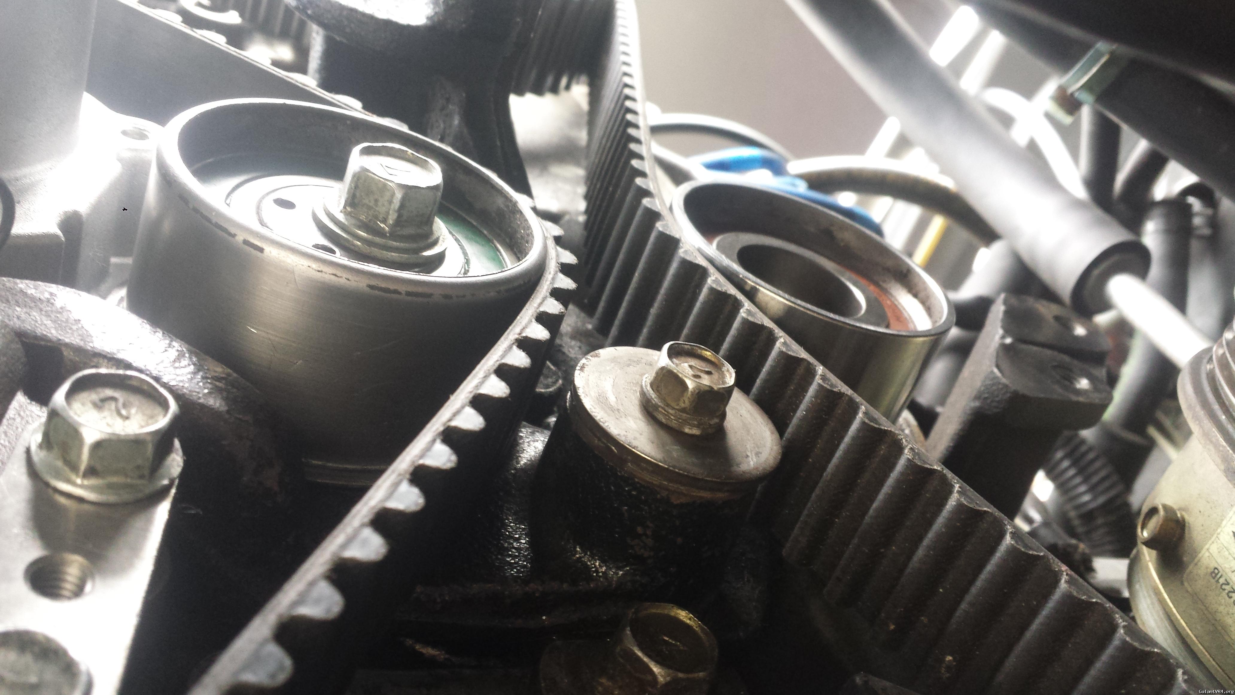

Ok so I need some more help. The tensioner pulley rubs on the water pump in almost every range of its adjustment on the tensioner pulley arm. Is there supposed to be a washer behind it? I am not missing any hardware or put anything back in a wrong spot to my knowlege...
If I tension the belt properly so the grenade pin goes in and out easily, the timing belt rubs against the bolt securing the tensioner pulley arm to the engine mount. It was suggested I tension the bolt CCW even though the 1g guide says go CW. I cannot properly set tension on the belt going CW due to no room for my tensioner tool. What gives?? I am really frustrated, bummed I can't fix my car. Please help
Nothing is tensioned in this picture, I am just showing to show where I am at. Is there supposed to be a washer behind the tensioner pulley to space things out? Sorry I sound like an idiot but I just want to make my car run again.
3,473
The pulley will only rub only when the tensioner is in the wrong position. There is no spacer behind it. If it is rubbing, it's not positioned correctly. I'm not sure what this method of tensioning the belt using the grenade pin is all about. I've never heard of that, and that's probably what's throwing you off. There should be a 3.8-4.5 between the tensioner arm and body. I use a 4mm allen wrench to set the gap when I do my belts. Quit trying to use the grenade pin as a reference for tensioning the belt, and I bet you'll get it right no problem.

The pulley is clocked wrong. it needs to be cw.
I use a method that I found on vfaq using a drill bit to set tension.
Works easy and hasn't failed me with multiple timing belt jobs over the last decade or so!
Below is taken directly from vfaq.
"Here is how I set the tension whether I am using a new tensioner or not:
I do not use an Allen wrench on the tensioner as noted previously, I just let the tensioner expand all the way
Once the belt is installed, I place a .150" drillbit (or the nearest larger size I have) on the top of the tensioner body, and screw in the tensioner tool until it captures the drillbit between the tensioner body and tensioner pulley bracket. When the bracket is close to the drillbit, I start spinning the drillbit, and stop screwing in the tool as soon as the bracket stops it from spinning. In other words, I stop when the pulley bracket is just snug against the bit.
I place a flatblade screwdriver between the engine and tensioner pulley, and lightly pry up on the pulley
I torque the pulley down
I back off the tensioner tool several turns, and immediately check the tensioner gap - if it has gotten too small or too large right away, I redo the steps above, changing the pressure used on the screwdriver. If the gap looks OK, I spin the engine 6 turns and wait 15 minutes and check the gap again.
