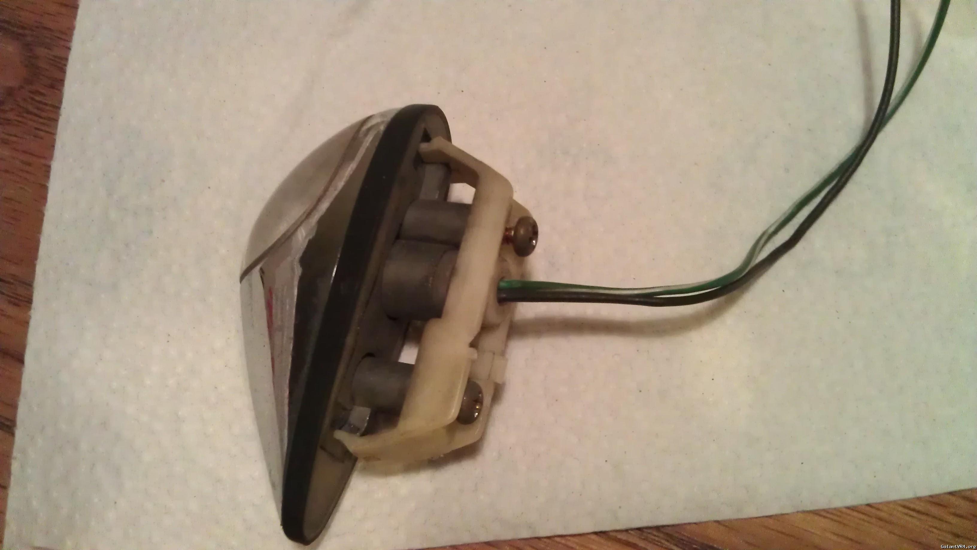

Remove marker from fender.
*Step 2*

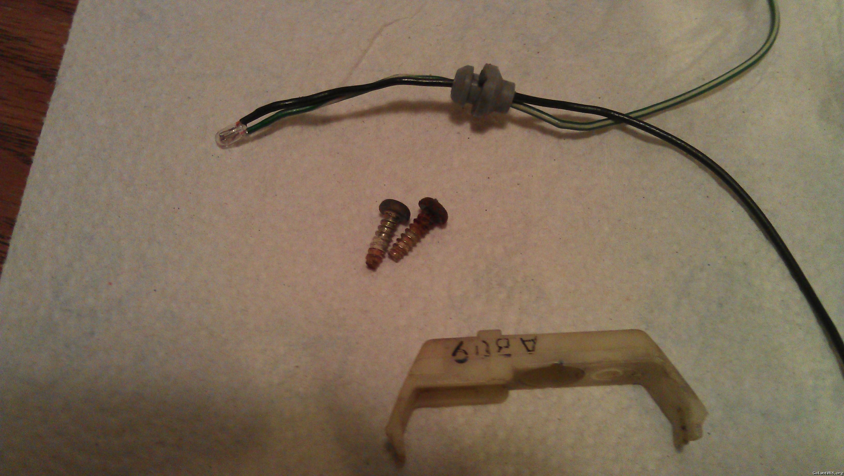

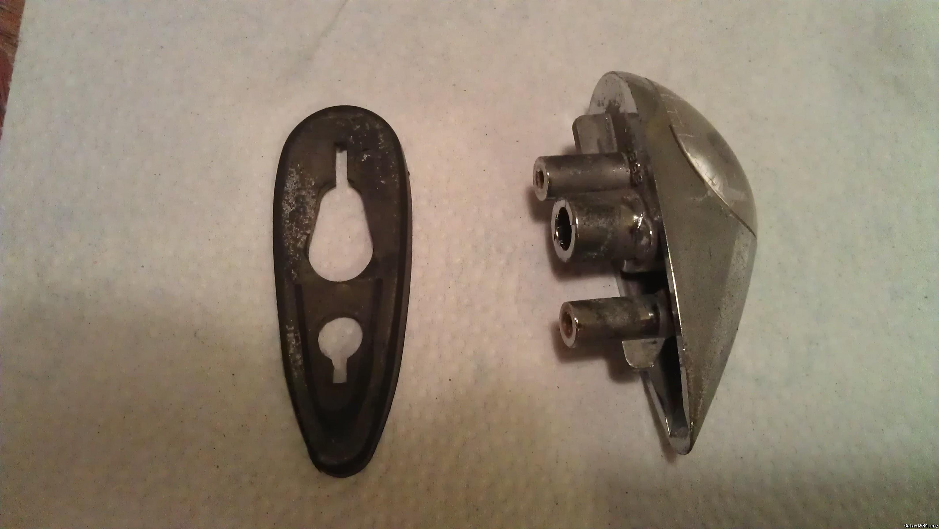

Unscrew plastic backing with your screwdriver and, remove the rubber piece surrounding the bulb and the
rubber spacer.
The rubber piece surrounding the bulb can be tricky but it does pull out of the assembly with the bulb.

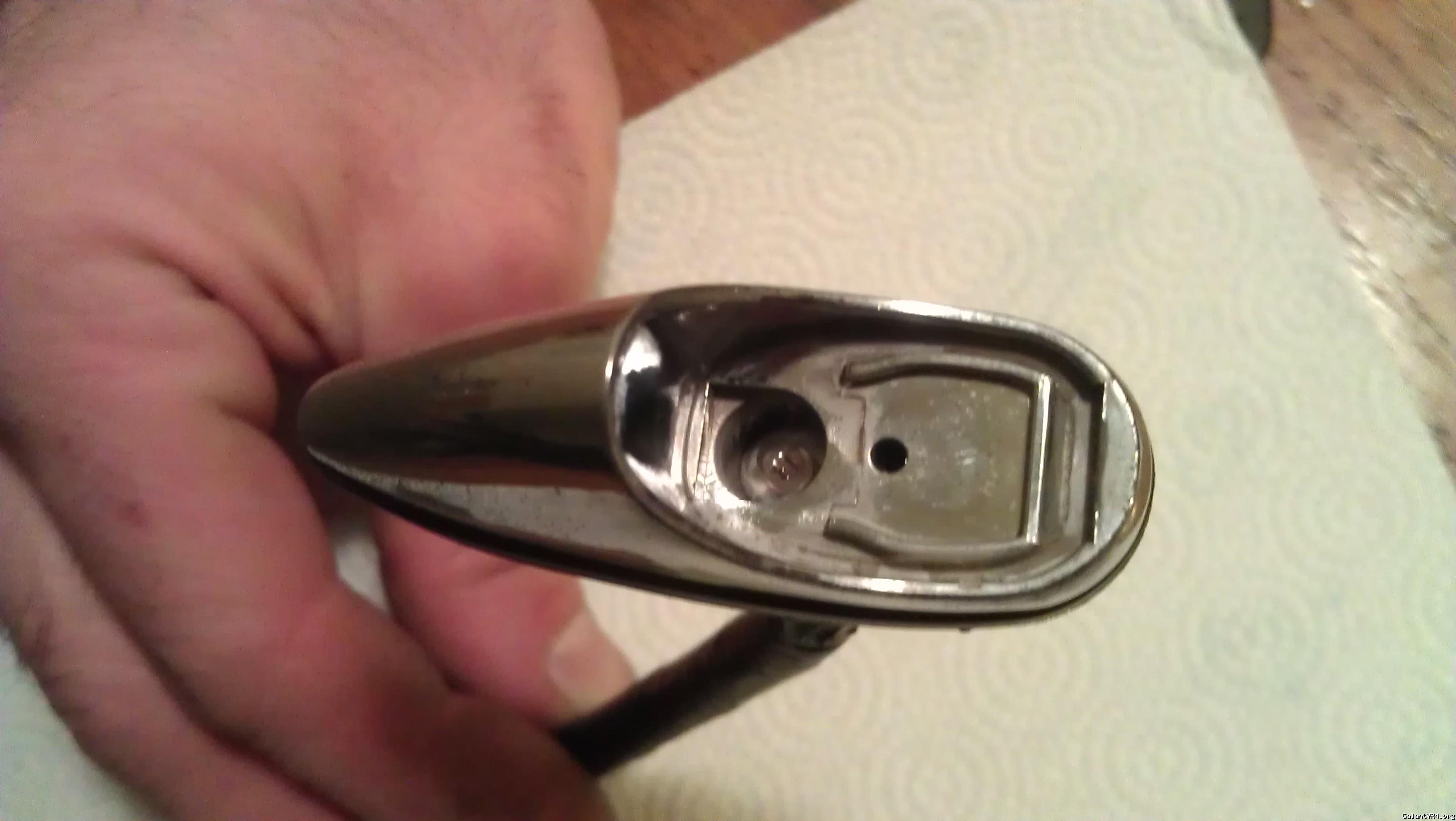

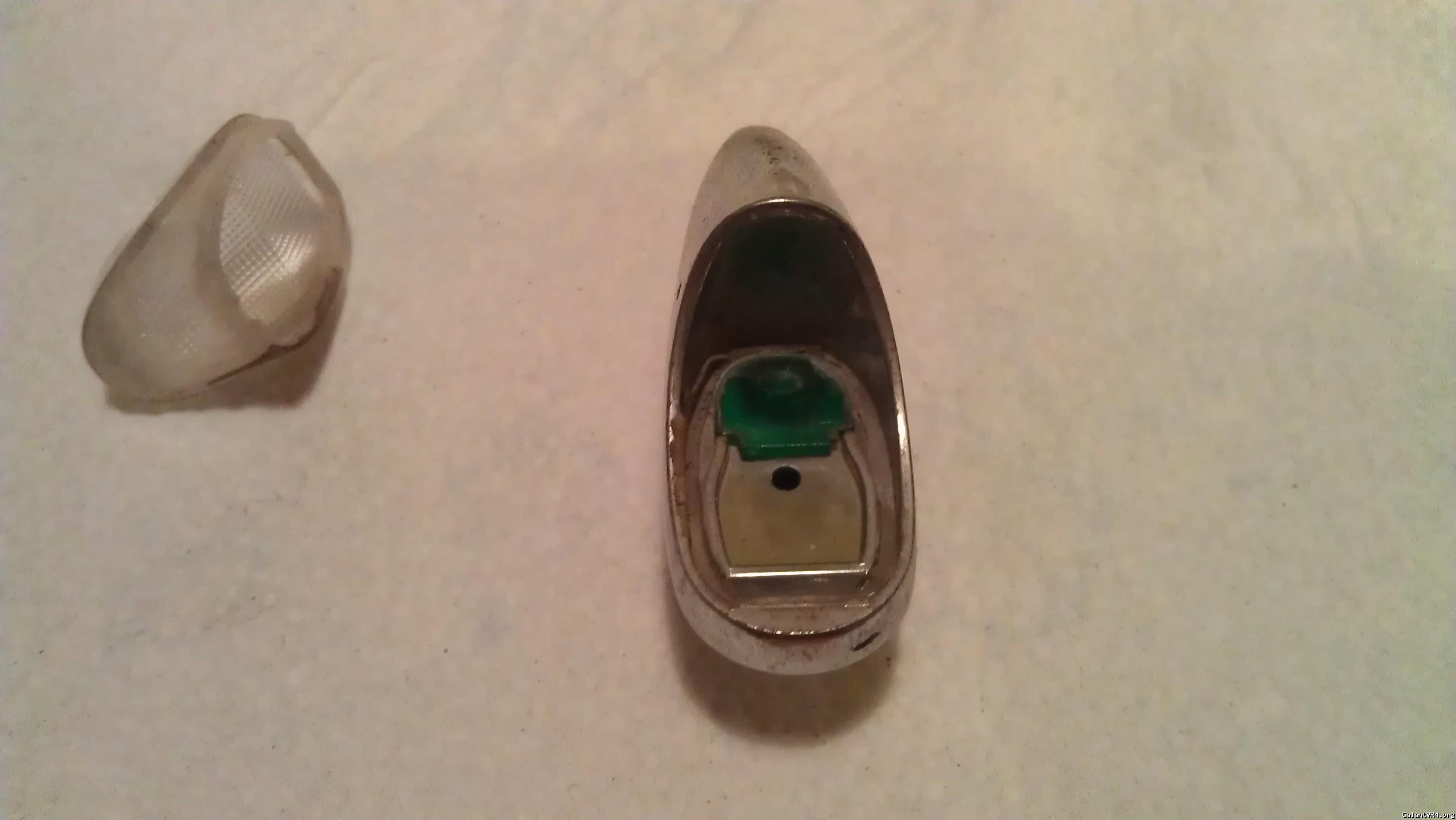

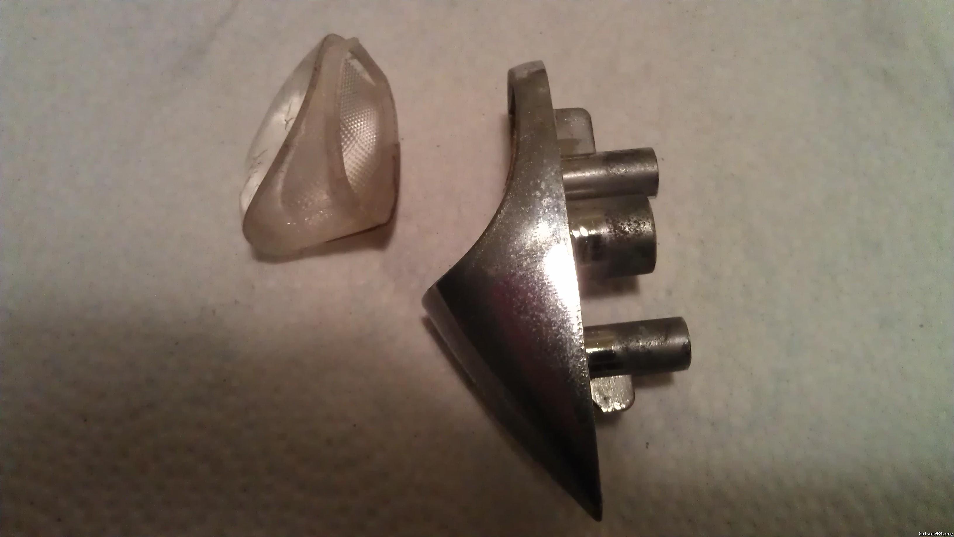

Remove lens from marker assembly.
Both my lens had some kind of glue around the edge of the lens but,
the lens did come out fairly easy.

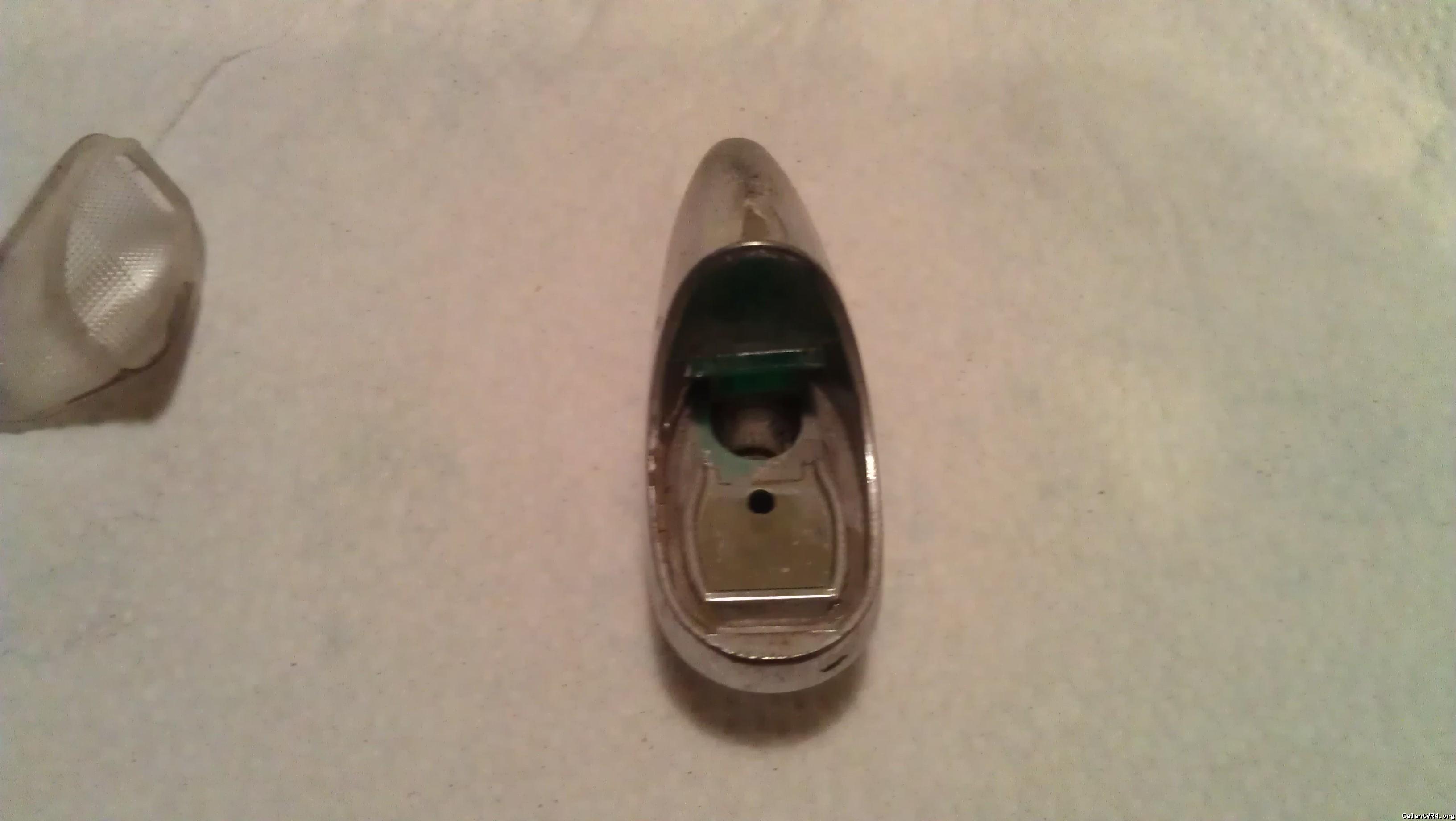

*Step 4*

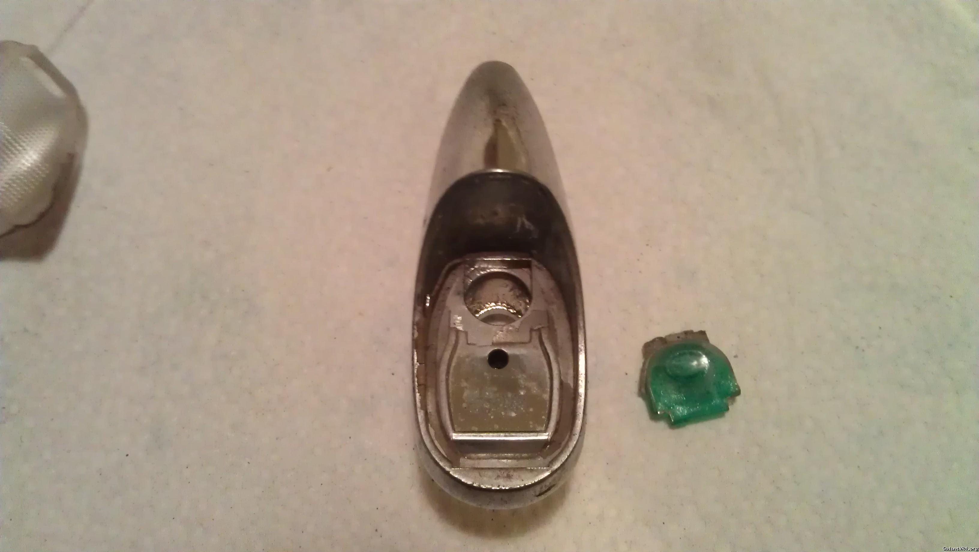

Once the lens is off you can see the small green plastic piece that covers the bulb.
Remove this by prying it from the housing.
Again mine had a bunch of glue that looked like it was excessively added.
The green plastic piece came out pretty easily also.
Be careful not to scratch any chrome off.

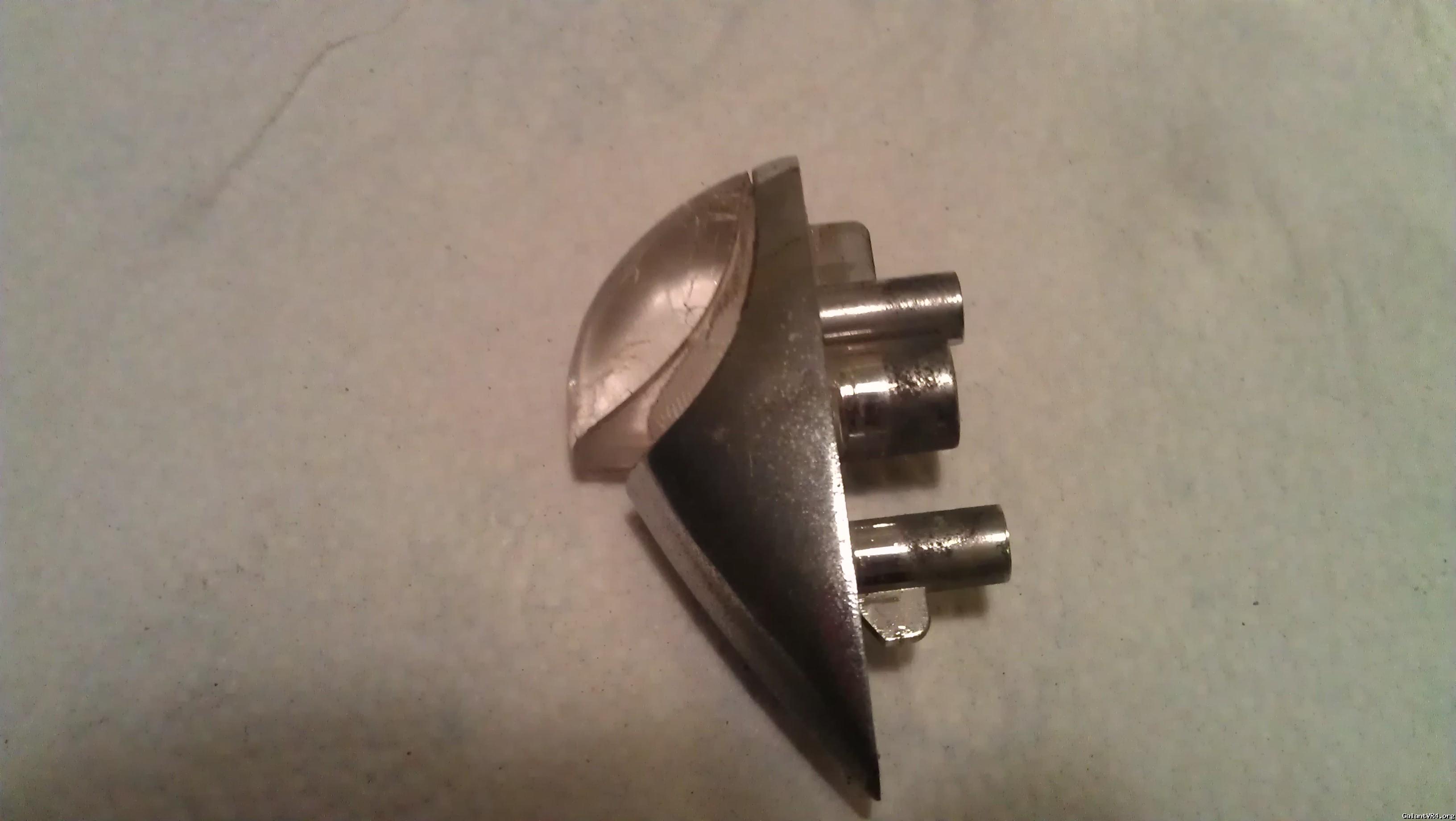

*Step 7*
Re-glue the lens back into the housing.
**Test the color before re-gluing anything permanently**
