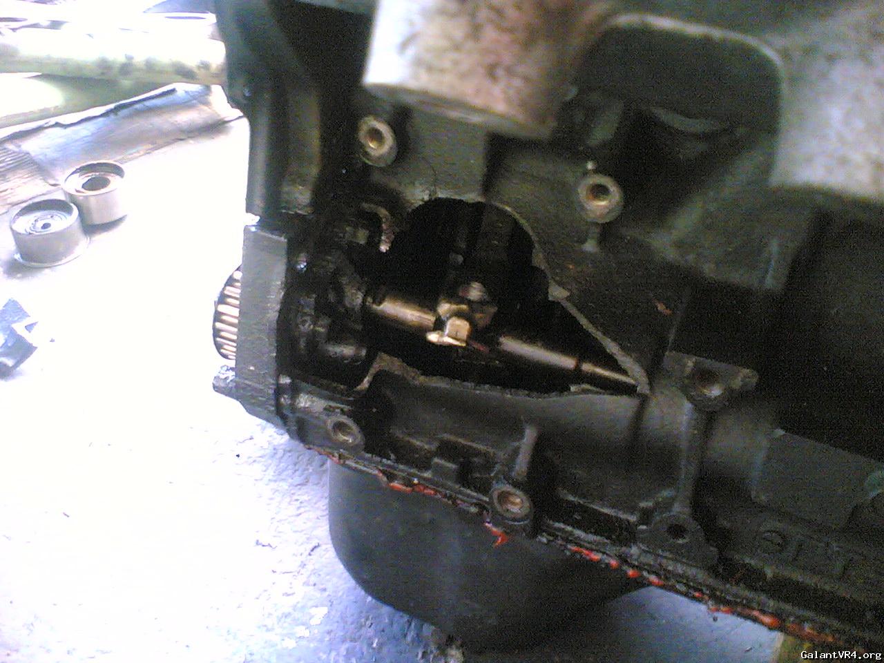

Well after lifting out the engine, I was in for a surprise. The engine looks like it tossed a rod! Bored a nice hole into the block and blew out the piston into pieces. Looks like it bent 2 exhaust valves and 2 intake vales in the process.
Already called up a friend and he has a spare block and head that both have been rebuilt less than 1000 miles ago. Block has 2G pistons and 1G rods and I will be dropping in 3G lifters and 272 Webb camshafts into the head /ubbthreads/images/graemlins/smile.gif

I will get some more pictures of the damage to the piston or whats left of it /ubbthreads/images/graemlins/rofl.gif
