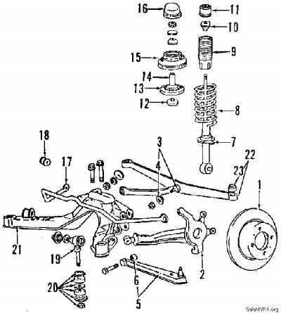

Ive got a 1g rear someframe that i want to put in my car.but before i do that i want to pretty much get all the bushings and what ever else i can replace.I was going to do the 5 bolt swap because i have all the parts but decided against it since my car has new wheel bearings all around and i dont have any 5 lug wheels.Im definately getting a sway bar and ingalls rear camber kit.heres a pic let me know what else.
How are the ball joints? Part # MB241883 is a perfect fit even tho it's not listed for our car it's the one actually used OEM. (Mitsu wants to sell you the whole arm)
Also pancake bushings for rear subframe and mustache brace.

I'd get all 3 bushings trailing arm, upper control arm, lower control arm. None of the bushings cambered.
(RvlutionMtrsport is who I got mine from, was quick)
The camber bolts I got mine OEM. part # MB515167 (41393 in pic) $ 3.87 each from MitsubishiParts
Sub frame pancake stopper OEM part # MB584140 (41051 in pic)
Mustache Brace stopper OEM part # MB515154 (34228 in pic)
