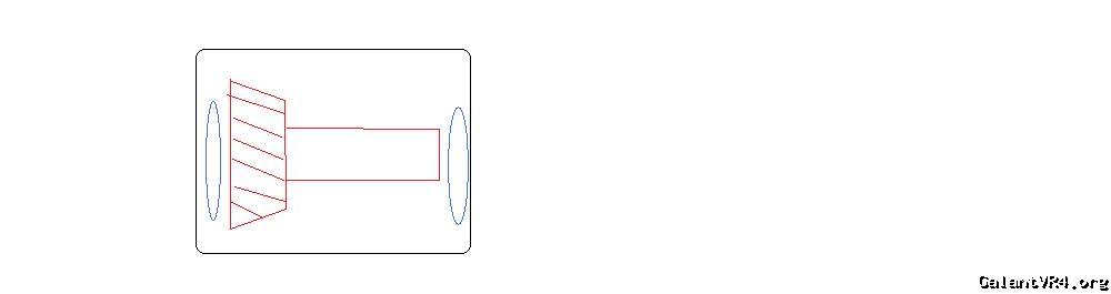

My 4-bolt is in a bad way (I think) but before I pull the trigger on a new one I'd like to make sure and determine whether it can be rebuilt.
Is it possible to just pull the rear cover off of a 4-bolt and visually inspect the gears / shims to determine their condition? Could somebody give some pointers on what to look for and where? Maybe a picture with one of those fancy red circles indicated where the shims are inside the housing?

Horrible picture, but it gives you an idea. Imagine the rear diff with the rear cover off. The center gear section (Don't know the technical term) is sandwiched between the shims on either side (blue) .
When you are shimming the rear diff, you are moving the center section either left or right, in order to make more or less contact with the pinion. Moving it left, makes more lash.
Rebuilding the diff pretty much involves replacing the bearings and re-shimming (assuming all internals are good). On a mitsubishi diff, everything comes out the back.
