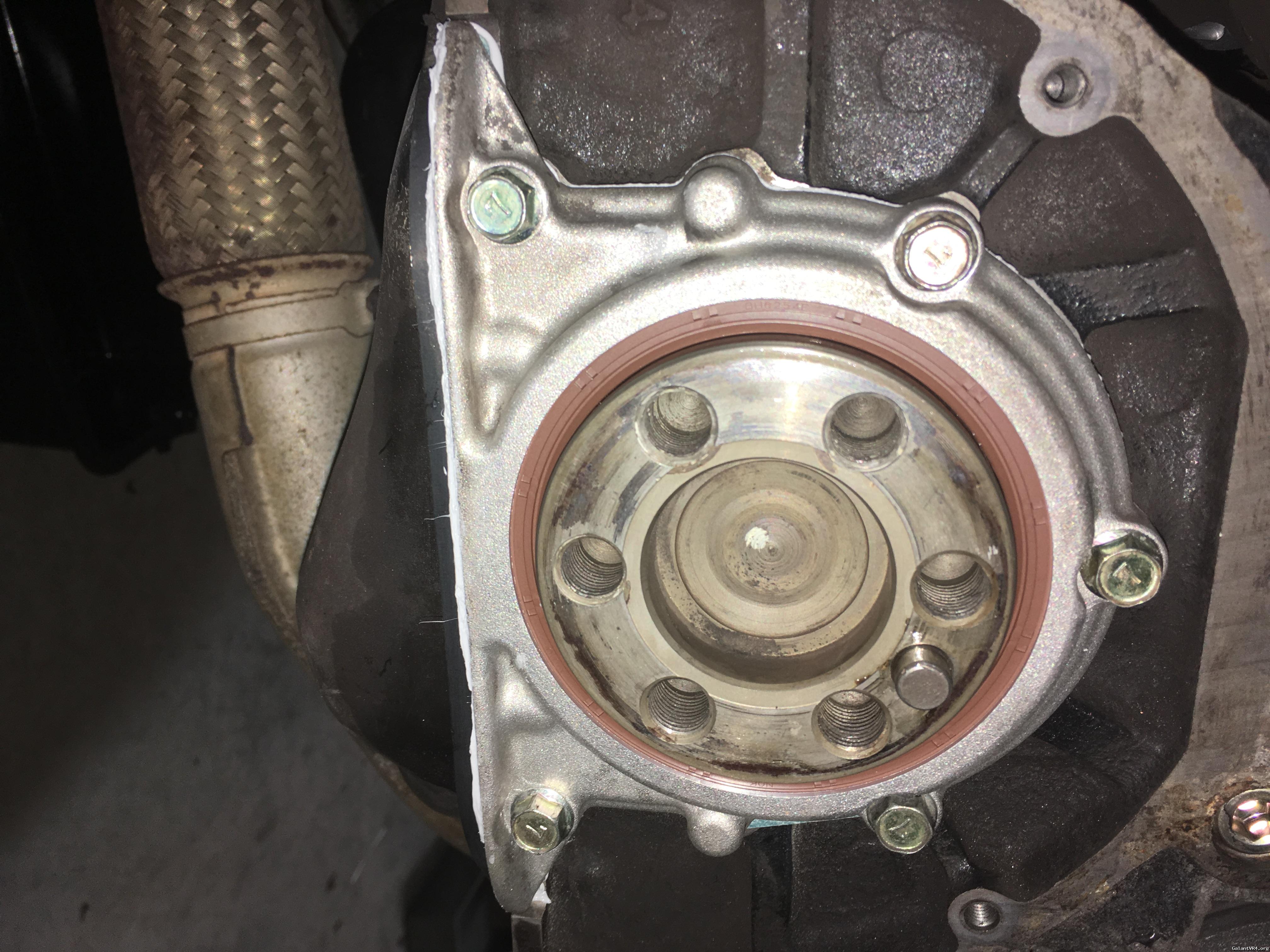

Just for anyone interested. It seems like there was some confusion in the above comments.
On a 6 Bolt motor the rear main crank seal is pressed into the back side of its own aluminium housing and cannot be removed without removing the housing from the motor.
The housing shares two oil pan bolts and seals against the block and the oil pan. I have read that some poeple have had trouble sealing against the pan after removing and re-installing the housing because it no longer has a continuous bead of sealant around the oil pan.
Well I gave it a go.
After removing the seal housing I removed all RTV that could be seen and cleaned the block and oil pan meticulously and gave it a light scrub with a scotchbrite pad.
Using my finger I applied a 1-2mm thick layer of RTV to the pan and block surfaces at the bottom edge of the seal housing. It has its own gasket to seal against the block. I didnt want to put too much here as it may get puched into the engine when installing the seal housing. Its a very small gap between the pan and the housing.
I installed the new oil seal into the housing by tapping it in evenly with a large socket. Attached the housing gasket with a couple of dabs of rtv to hold it in place, oiled the seal and crank and slid it on. Buttoned up all the bolts being very careful not to over torque the oil pan bolts (7 ft/lb) as this can distort the pan and cause a leak.
The Results...NO LEAKS.
I have put a few hundred miles on it since install and I have had a good look around the area after removing the inspection plate and its dry as a bone.
Surface prep and having a good think about how much and where to put the RTV is the key. Sorry didn't take pictures along the way but here is the finished product. You'll get the idea.
