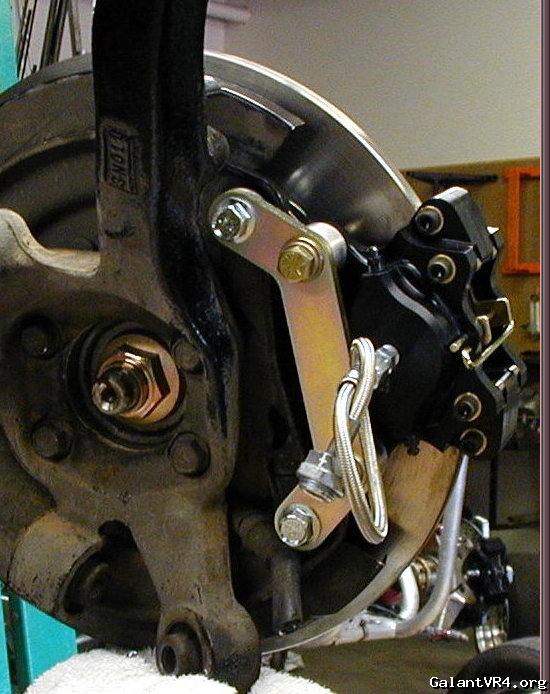

Can you inform us what a "real" brake kit upgrade is. I assume you are basically knocking TCE's kits and would like to know why.
Also, that picture doesn't really look relevant to what is being discussed...doesn't look like the rear hub of our car to me/ Please explain your opinion more so I can understand your POV/attitude towards TCE a bit better.

+1
That is a 4 link rear from something. Obvoiusly not RWD even....And judging by the thickness of the rotor, (from what I can see) a small car at that. The backing plate that it's bolted to does not seem to be much, if any, thicker that the bracket, so I doubt that it is an issue in that application. /ubbthreads/images/graemlins/dunno.gif

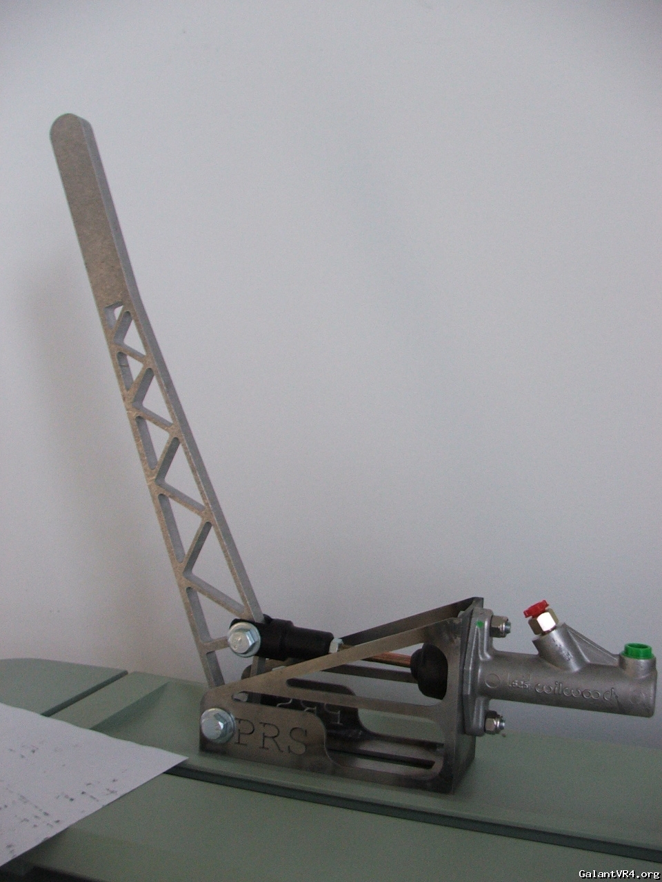

2. I dont care about and e-brake, but I have a Hydro hand brake as of now... SEE

The picture title is the 2g 12.2 rear upgrade kit.
Yes I am knocking their brackets cause I personally think they are a joke. It's one flat piece of metal, with two rods cut to length then bolts and washers. So you have 7 pieces of metal in your brake bracket setup. Also if you look at that the bolt goes in from the back and the nut goes on the front.
Its far from what I would call a "solid" brake "bracket". I purchased one of their front kits a long time ago and I got what pretty much looked like picture and I was far from pleased. Hence why I make my own brackets now which are a full solid one piece design. It's what I would call a "real" brake bracket, not some 1/4" piece of metal with cut tubing thrown together. IMO
