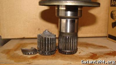

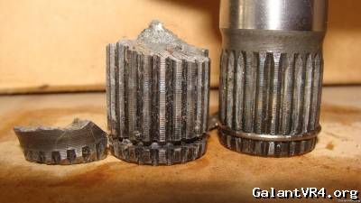

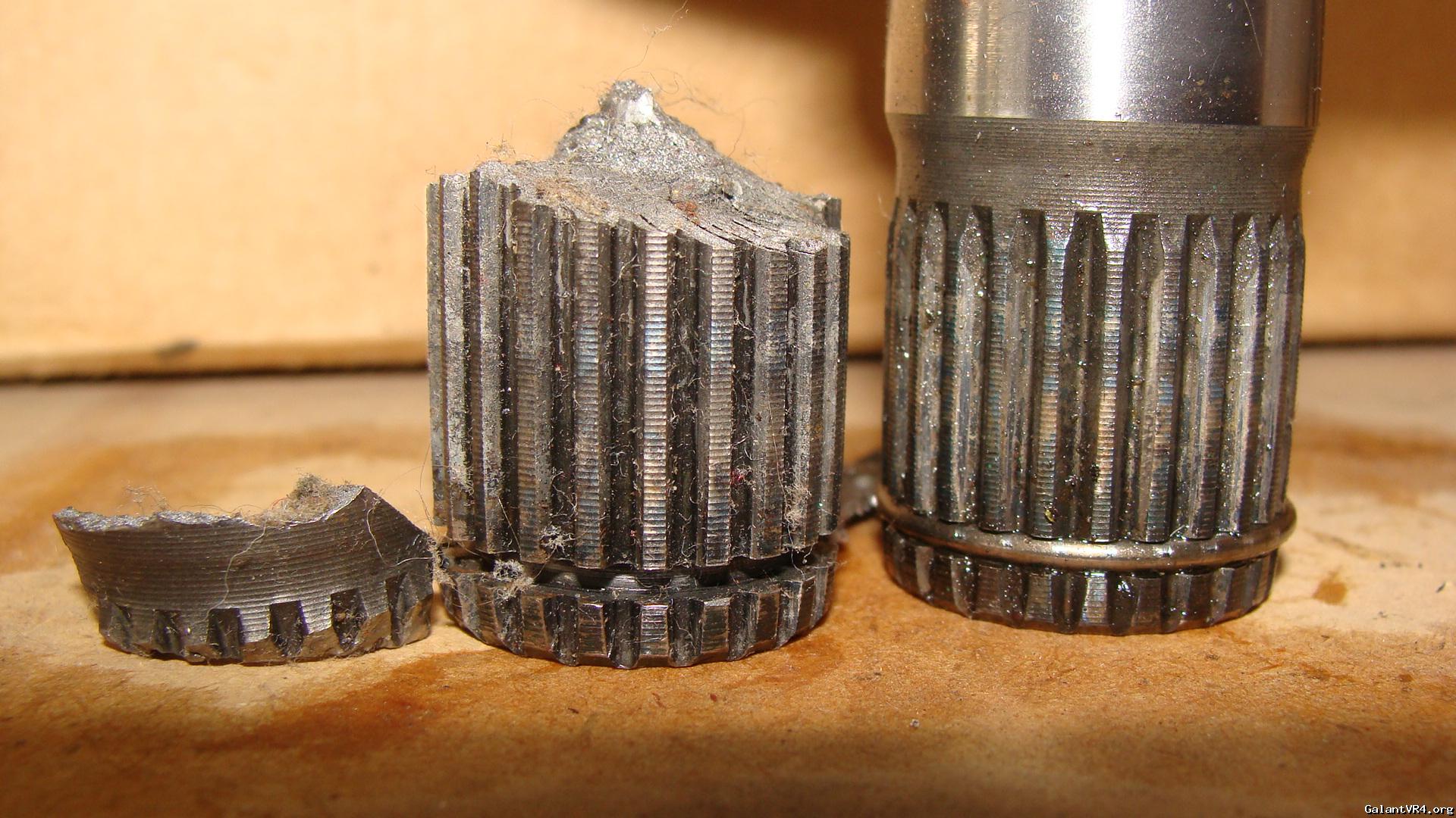

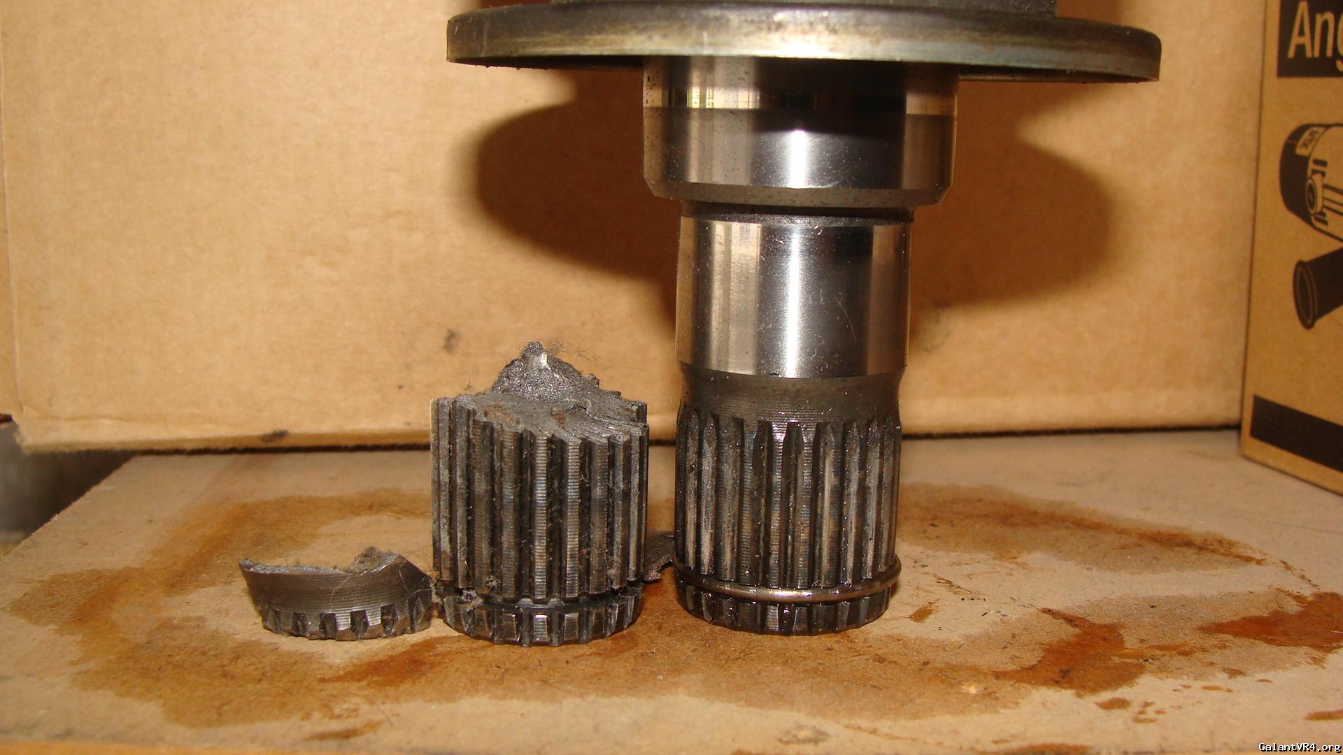

Bad rear axle? Well, when a 3 bolt axle fails it makes a really loud bang/crack noise and shatters just inside the diff. It starts to vibrate and clunk a lot and eventually may start to slip out of the diff and sag. Generally you will know something is up pretty quickly.
3 bolt and 4 bolt, but hey, watcha gonna do? /ubbthreads/images/graemlins/dunno.gif
