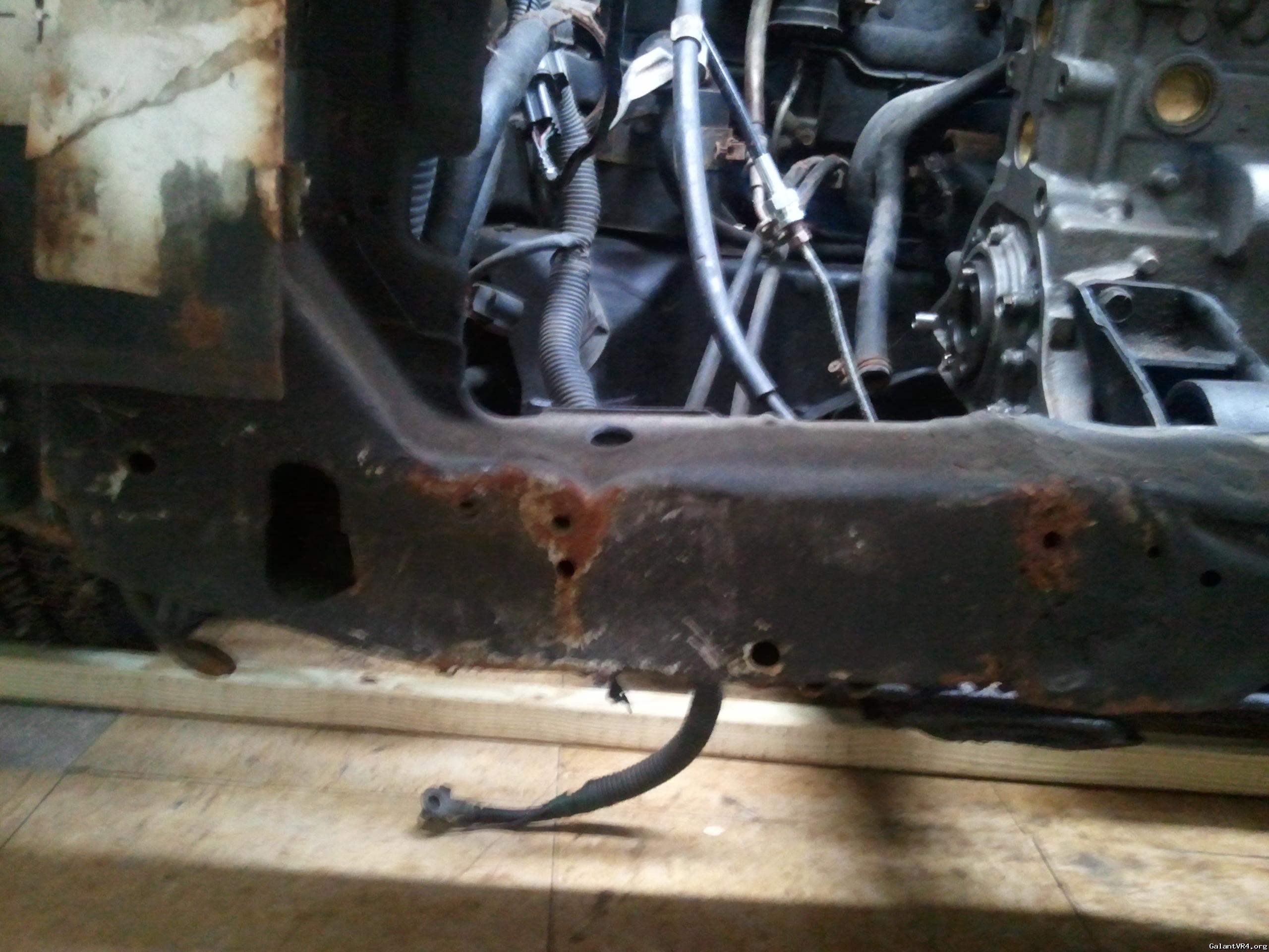

Its kind of a little more then just surface rust. But who ever redid it was just awful. Ill take a picture this weekend and post it up. I just dont feel safe with it.

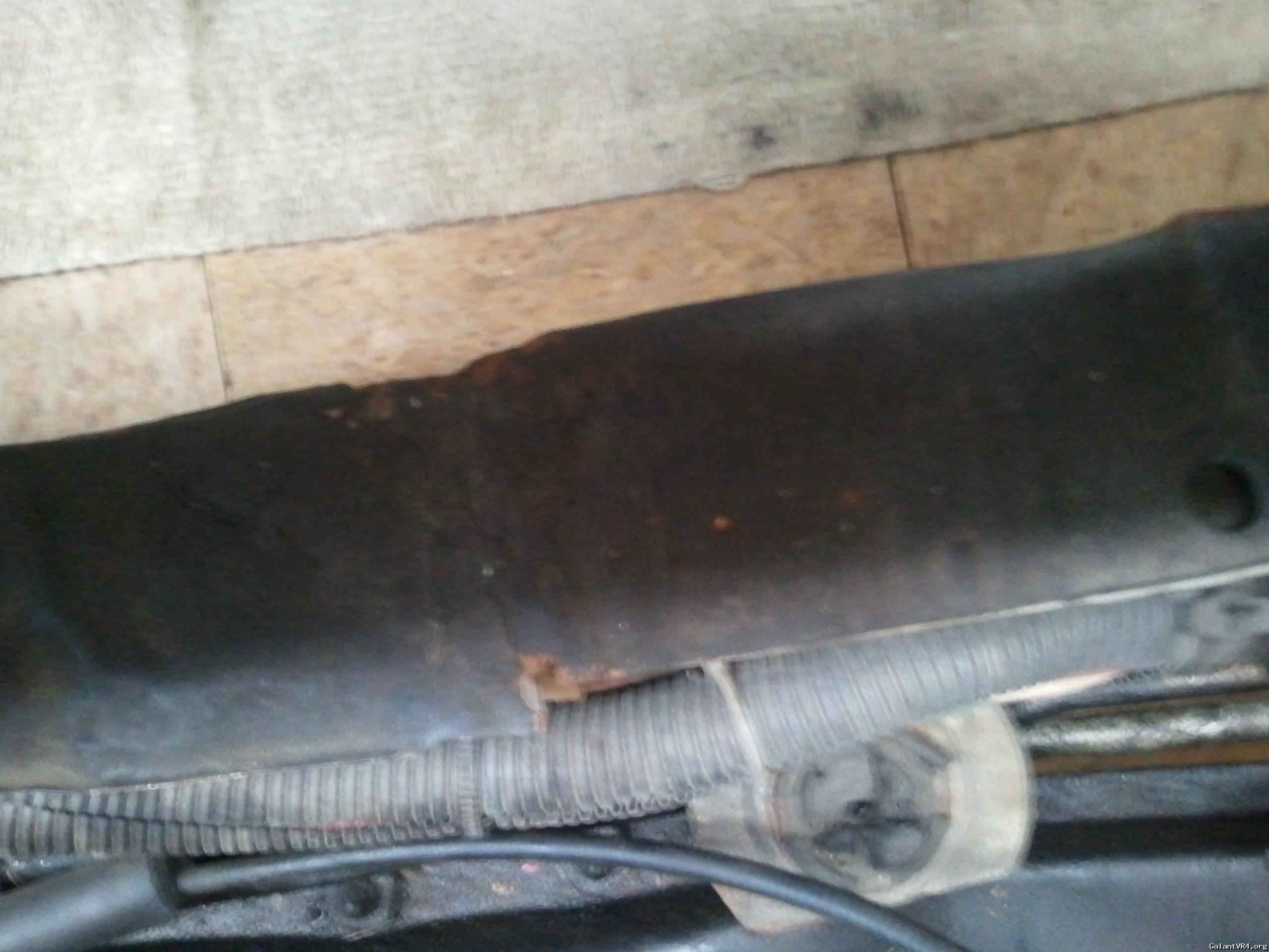

Here are the pictures of my radiator support. As you can see it looks like it was damage and maybe cut and welded along with a welded hood latch support.

Yeah that's some crappy work. Hope you can find a good one. If you do have one shipped to you ask them to cut it at the frame rail just behind were you need it. This way you can drill out the spot welds yourself and make sure it is done correctly! Good luck
