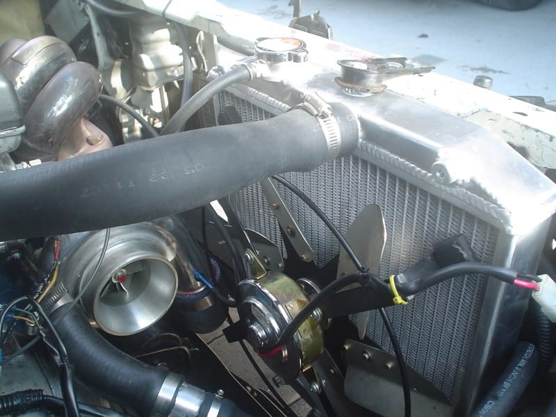

I have a honda radiator and a permacool 14" fan. Not a problem at all so far.

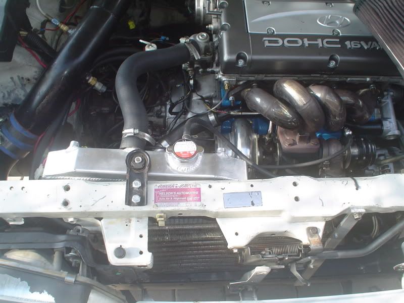

Just curious...OEM or aftermarket (aluminum)?
It's the small aluminum one. Something along the lines of (or quite possibly exactly) the one linked.
I'm fairly certain all of the half-sized civic ones are the same. Not sure, I bought it from digit. He probably knows more about it.
Install wasn't bad. Had to make a bracket for the bottom of the radiator, then used the stock pass. side rubber mount and moved the top mount. Stock upper hose works fine, and I had to do a little fiddling with the lower hose. I'll snap a few pictures if you'd like.
That fan will remove limbs.

I have a civic radiator too with a 14" Spal puller mounted on it. So far no problems/issues.
Here's the thread I made about it after I installed it click me
That was the original thread that got me turned onto the civic radiators. A suggestion to anyone purchasing a fan for a civic radiator or even oem is to use perma cool over spal or slim line.
