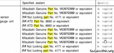

Morning all... In this episode of "That friggin Rallycar needs fixin AGAIN......"
I need to adjust the play in the Rack, Hence I need to remove the preload Plugbolt, Check the spring, and retorque. ( and steal bits from other racks lying about...)
So the manual says to use 3M ADT to seal the nut.....WHAT THE HECK IS THAT? Google comes up with a blank... Can I just use silastic or loctite?

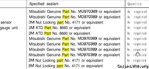

Actually, I think it's "ATD" listed in the manual, and there should be 3m product code following it, like here:
Here is a place that sells 3M items: 3M Sealant/stuff
Get the number and look through the list. If you find it, buy something "equivalent" (the manual says its ok)
(for instance, 3M ATD 8660 is a Silicone Sealer, like RTV)
