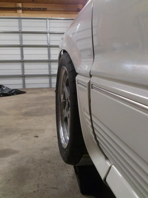

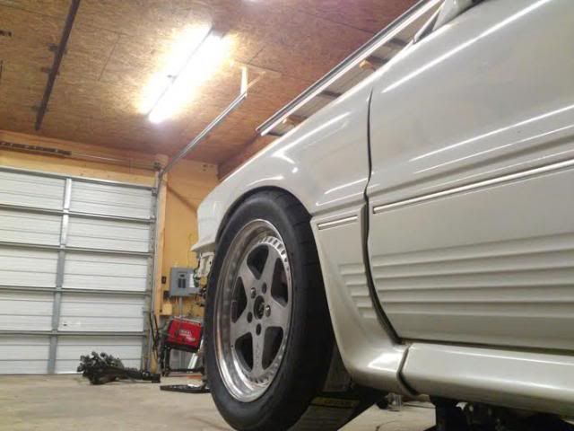

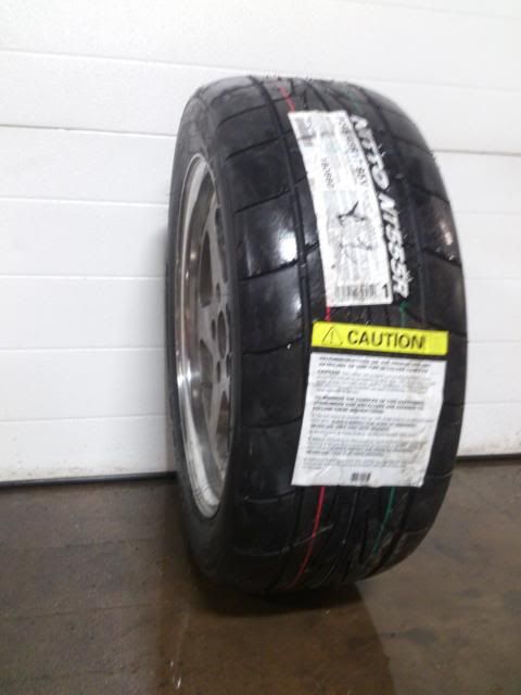

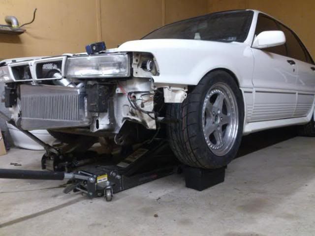

I will come back and update this later, when I get pictures and everything else organized. For now, I wanted to show my wheel and tire fitment I FINALLY fitted up tonight.
It's taken far too long for this, but I LOVE it!

Kind of look like my Work Equips, but the angle of the lip where they are bolted together looks deferent.
G
Feb 24, 2004
8,896
zompton

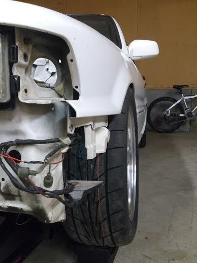

Looks good, I think that sidewall is too tall though. Will probably rub.

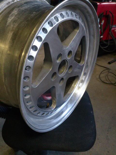

They're old Stern wheels. They came on early Saleen Mustangs. The lips are redrilled HRE pieces. RUB? Yeah, I'll keep an eye out /ubbthreads/images/graemlins/smirk.gif

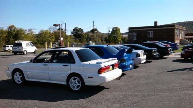

T
The last time it was driven with all my close buddies

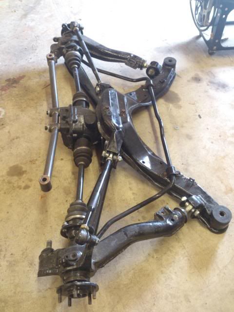

It's really hard for me to make a proper build thread. Once I get working I don't stop for much. Got some done over the weekend, including welding jackstands to dollies. Now I'm super JSB. Able to remove the subframes and still move the car around the shop:)

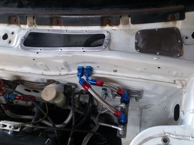

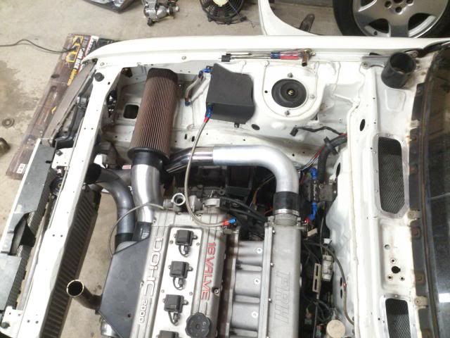

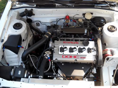

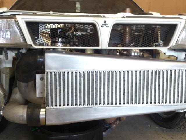

Some neat stuff going on here, keep posting whatever snippets of this. Brake fluid reservoir in the cowl?
15psi88
Aug 19, 2009
101
State College, PA
The brake fluid reservoir is actually built into the bottom of the steel plate, and it mounts strictly by the stainless hardware seen around the perimeter. The top plate still needs the flush mount cap welded in, but it will be painless to fill it. Been fighting with myself to powder coat the fabricated pieces wrinkle black, or paint them white when I do the bay. Whatever I do, I'll wish I did the opposite.

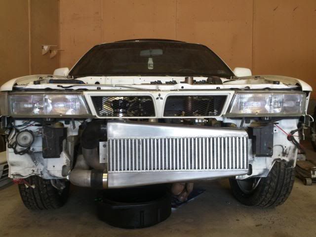

The intercooler is a Treadstone piece. Can be found here
I'm hoping to have the radiator mounted and have the left side of the intercooler finally bolted to something.
If I can produce something half as cool as what I have planned out in my minds eye I'll be stoked. Stay tuned..

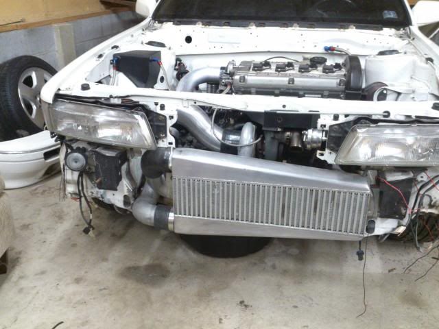

As always, two steps forward 4 steps back.

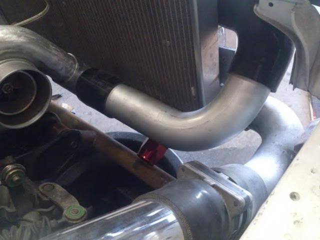

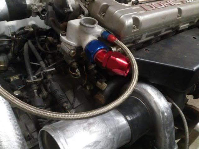

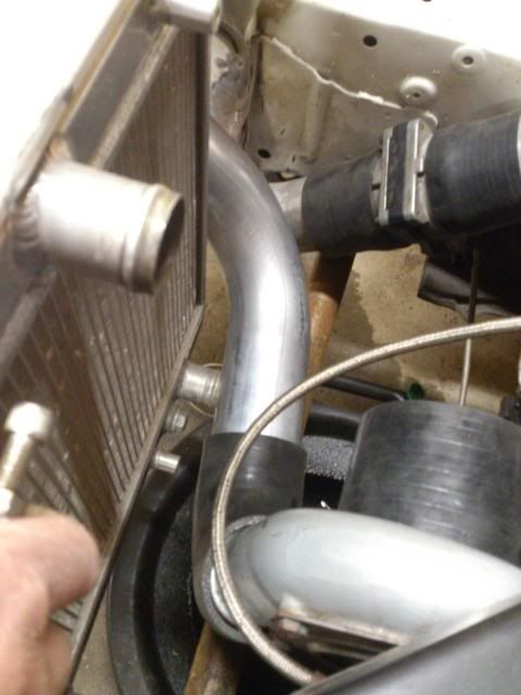

Getting things sorted to mount the radiator.

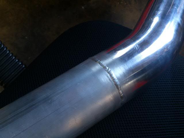

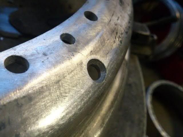

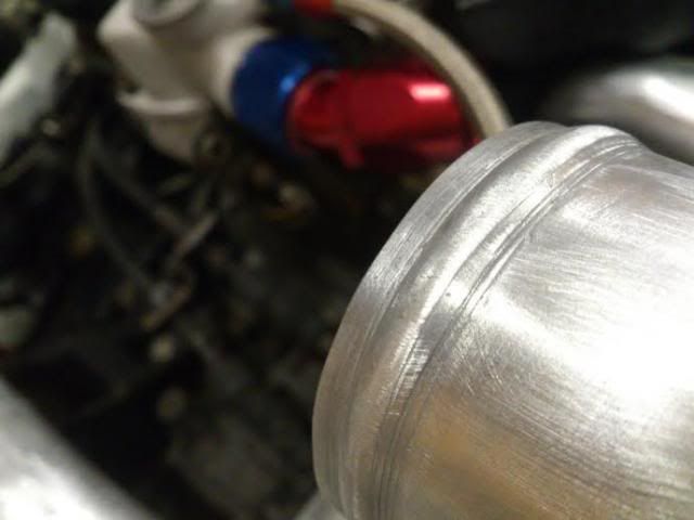

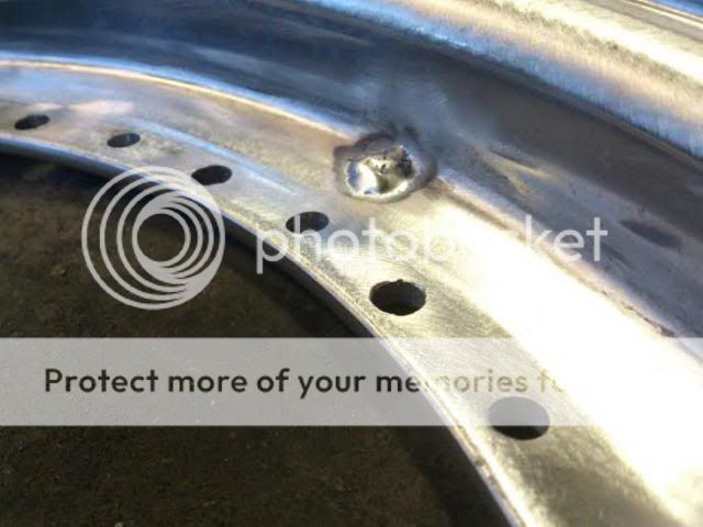

Turns out I can't fit a -20 fitting between the hot pipe and the front cross member. Never was a big fan of running a silicone coupler off the turbo, but at the time it suited my needs. Something I knew was going to need updated in the future...Well the future is, now. I've now got a 2.5" cast elbow to weld on the compressor housing and will be using 2.5" tubing rather than 3".

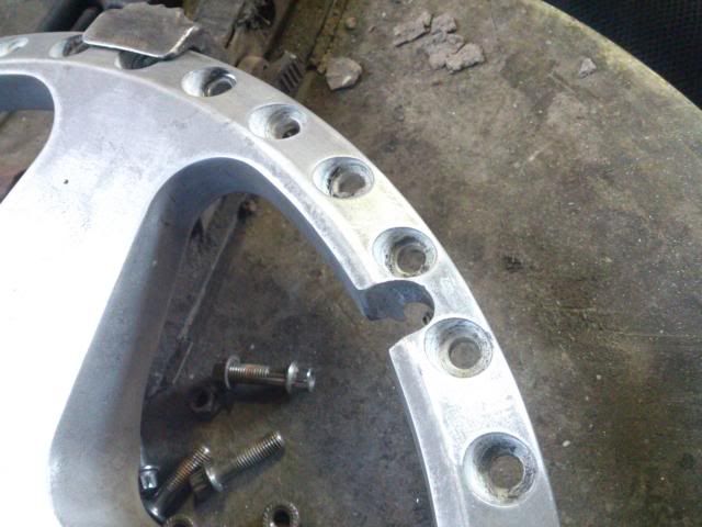

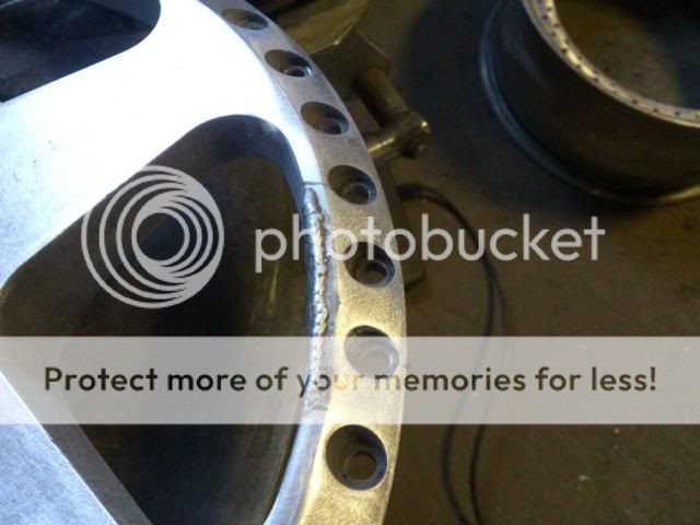

I think with the tighter radius of the weld on elbow, and using a smaller diameter tubing I can sneak the big ass fitting past. Time will tell. Ran out of argon welding up my wheels over the weekend so progress stopped.

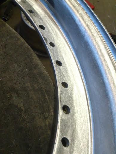

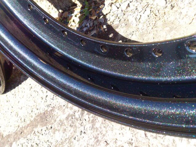

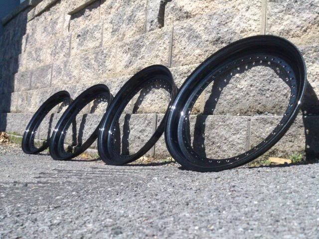

The wheels used to have a stainless 90* valve stem that came out through the face of the wheel. My OCD radar did not approve. So, now I have completely hidden valve stems. When I finally assemble the wheels I will orient a spoke to cover the valve stem.

Did you build them to those specs?
I looked for Sterns or reverse mount sterns for a while and could never find a square set. They were always staggered.
15psi88
Aug 19, 2009
101
State College, PA
Yeah, I bought them staggered. Built them to spec. Honestly, the most frustrating task I've taken on this whole project. Safe to say, I'll be buried with them.
