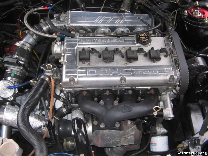

sleepyvr4
Dec 25, 2003
2,359
Key West
Got the car running (again) today. Torquey with the 2g head and intake manifold - however it falls on its face at 5500. Boost comes on very quickly - no boost leaks after check today. 255hp rewired and keydiver chip set to run 11.0 and with a splash of race gas. 20-25psi on 14b is a pretty good start - wideband says its at 11.8 through 3rd/4th. Tomorrow new lifters and 264's go back in - evo8 valvetrain also if it arrives tonight.
