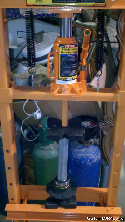

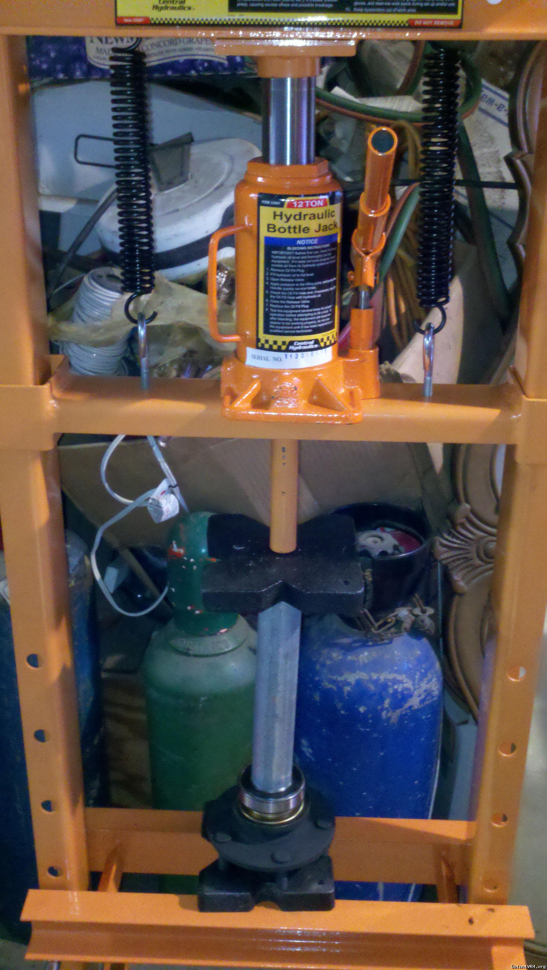

pressing them on:
Always press on the friction side of a bearing race. The rears, you press the inner race. The fronts, you press the outer race. (meant for readers thinking about doing this)
