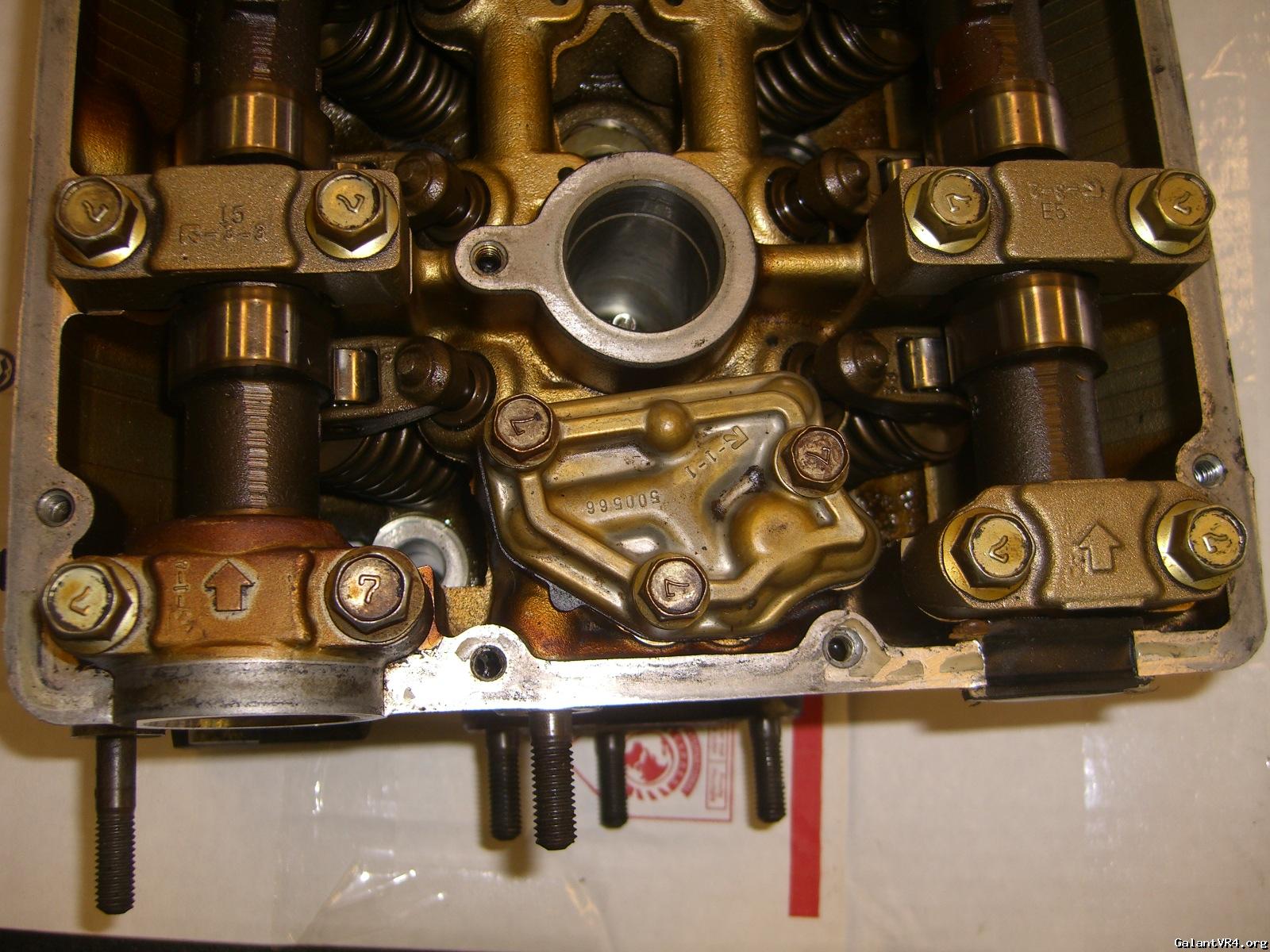

In my opinion the factory service manual isn't really clear on this. I know each cap is labeled I and E for intake and exhaust and the middle ones are labeled 2-5 for their location but that still doesn't tell you which direction they bolt on. I also noticed that there are little arrows on them. What do they mean? Should they all point in the same direction, towards the cam gears? Should I be able to read the letters and numbers stamped on the caps all from the same direction? When I install them like this the little arrows point in different directions on some of the caps.

I guess my main question is, what are the little arrows for? They point in opposite directions.
I'm assuming when looking at the cam caps from the side where the cam sensor goes, all of the letters and numbers on the cam caps should be facing the same way?

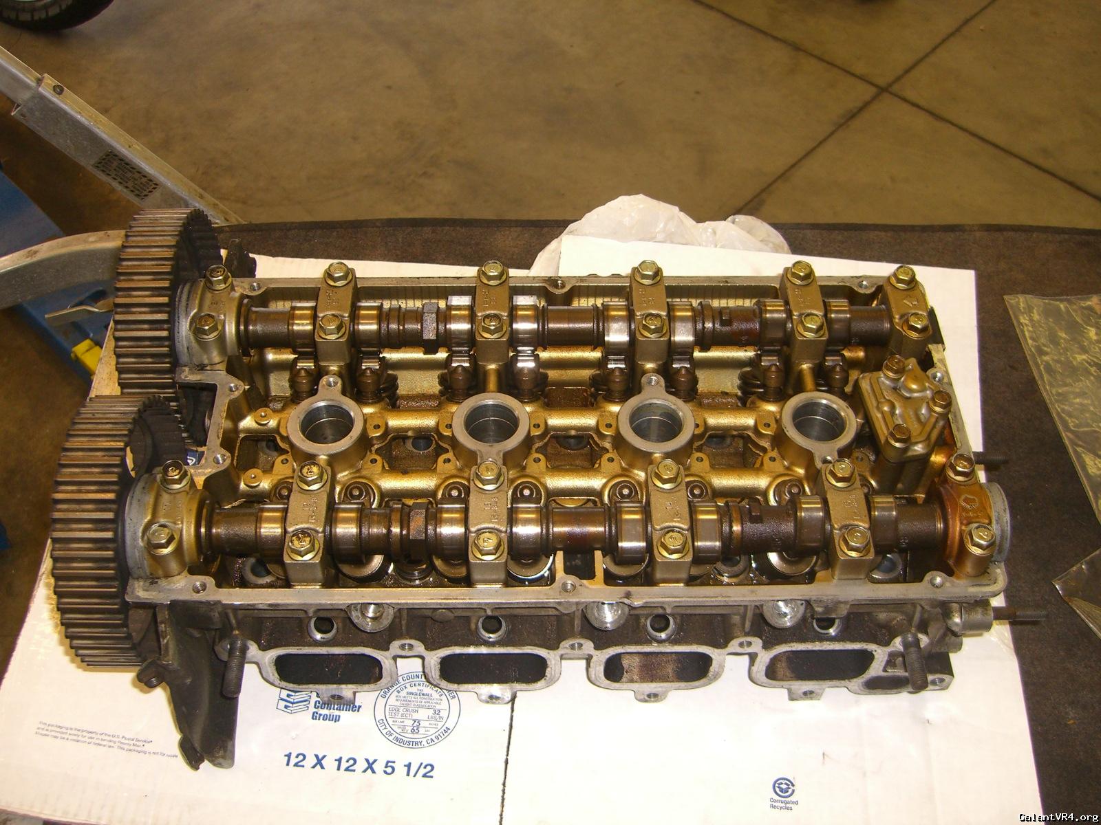

^^^^You would think thats how it should be but it isn't. If you face all of the arrows the same way on the exhaust side the letters and numbers will be upside down on a few of them. This makes me think you just go by the stamped letters and not worry about the arrows like someone mentioned above.

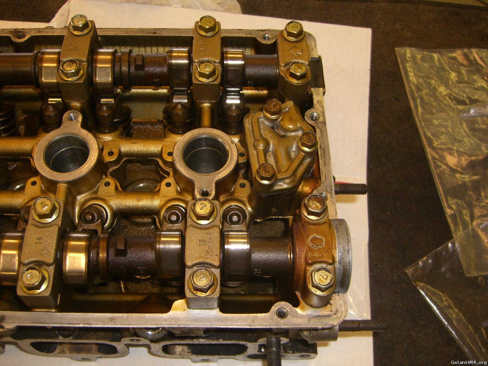

^^^That is the way I had it installed and thought it was right, I was just questioning the arrows. If you look at the two outer caps in that pic they have big arrows pointing towards the timing belt. But then the cap that goes beside the CAS has a small arrow pointing in the opposite direction if you look closely. Then the one marked "I5" right beside of it, the arrow is going the other way.
So now I know how they go, I just want someone to explain what the small arrows are there for. /ubbthreads/images/graemlins/grin.gif I would think there has to be a reason.

Honestly I'm starting to think it has someting to do with the casting process when they were made. If you look at the thing in the middle being held down by 3 bolts (not sure what its called) it has a small arrow on it too.
