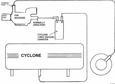

just bought a 91 galant vr4 with a jdm cyclone intake manifold. the previous owner had a dsm chip that controlled the output of the purge solenoid to properly control the cyclone actuator. right now, this is how it is setup:
the cyclone had three vacuum ports. the first port is hooked up to the output of my afpr. the second port is connected to what i think is the vacuum canister, which in turn is connected to one of the ports of the purge solenoid. the other port on the purge solenoid is hooked up to the cyclone actuator. the third port is simply hooked up to the blow off valve.
this is the solenoid that is connected to the vacuum canister. is this the purge solenoid?

that's what i thought, however, i believe the purge solenoid is being utilized instead. should i switch over to the fpr solenoid? i know the chip currently installed has it so the "purge" actuates at 4100rpm.
