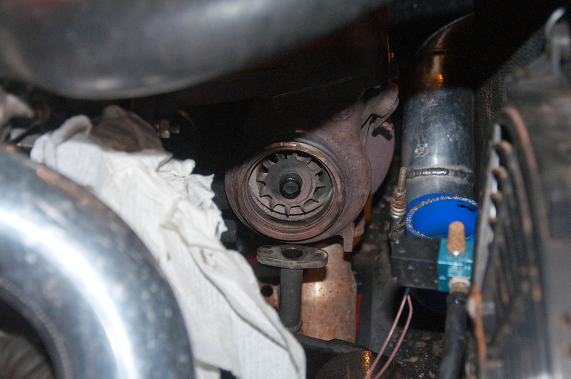

Pulled the poor overworked and under-paid 14b off tonight to find this:

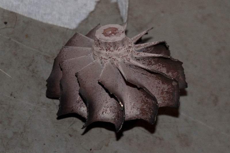

Snapped off TDO5H turbine wheel. notice the chips, it's all beat up from contacting the turbine housing.

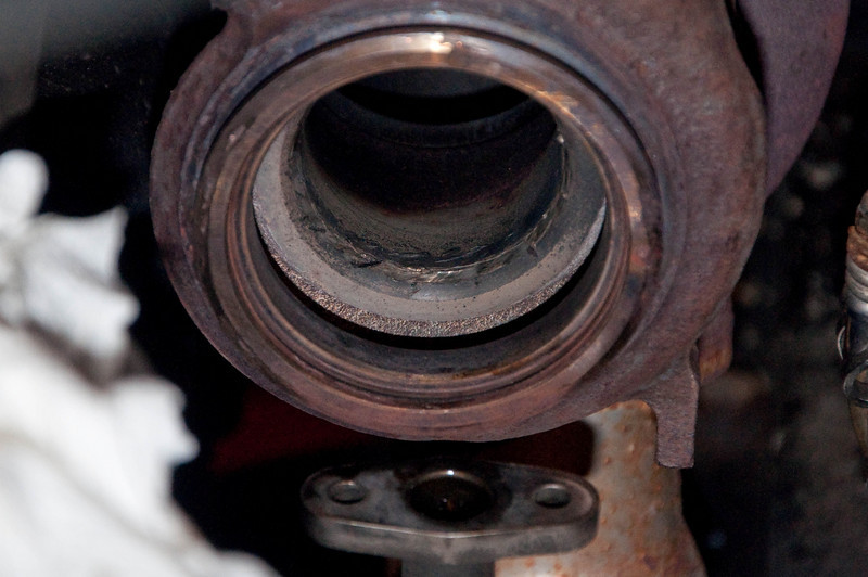

The results of the wheel/housing contact: Im going to have to grab the dremel and some sandpaper flap wheels and try to get rid of the burrs so the next cartridge spins free. Sucks, as this was a nicely ported E3 7cm housing. I would have had it put together tonight if not for these burrs.

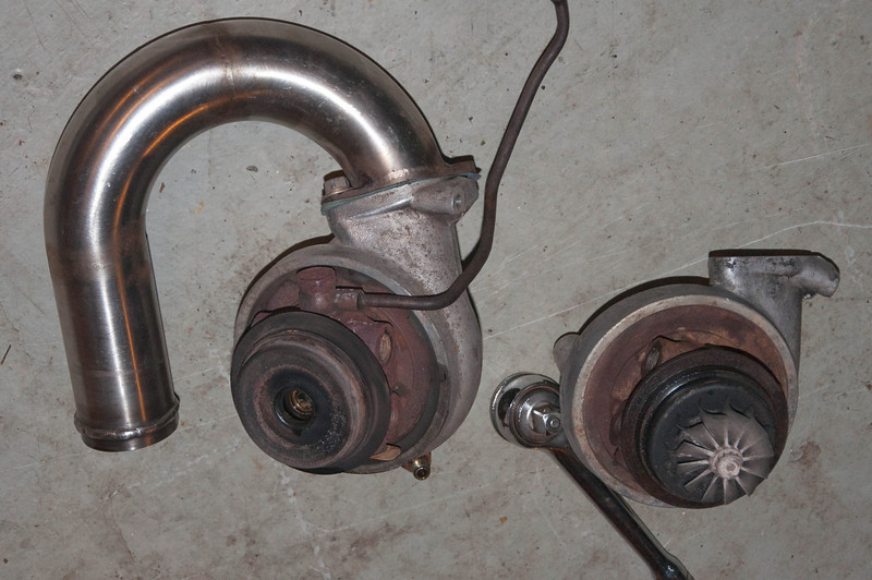

Oh...I see what's missing! I'v got a used small 16g that Im going to slap on tomorrow after smoothing out the turbine housing without removing it from the car. Should be interesting to see what the 16g compressor wheel is worth compared to the 14b with no other changes.

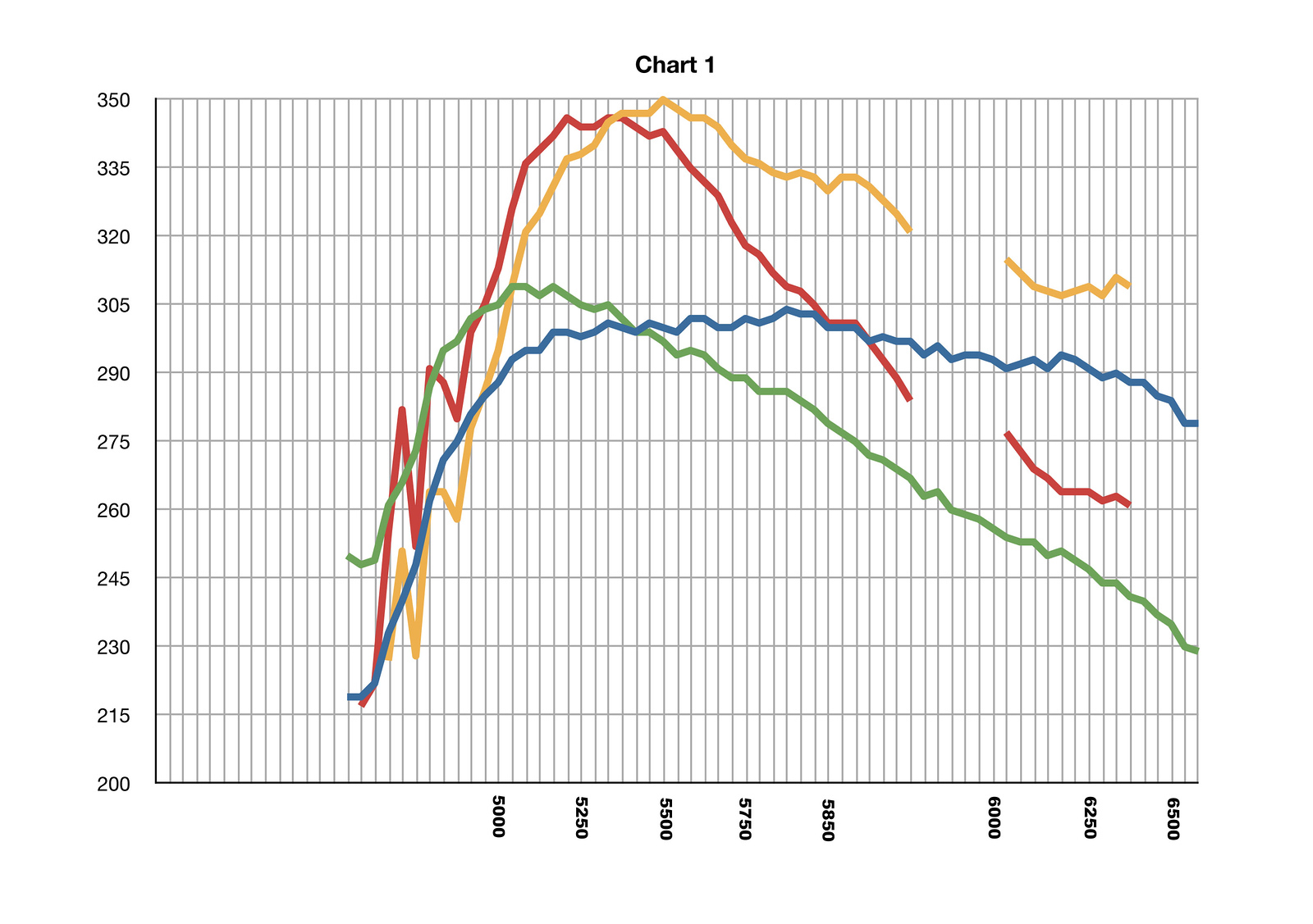

Screwing around trying to figure out how to overlay charts exported from link logs. This is the best pumpgas vs the best E85 run in 3rd gear. Ideally to make a "dyno chart", I would get better info doing a full pull to redline in 3rd gear but all I'v got is dragstrip logs. so...it illustrates the point that the E85 tune/boost/fuel makes significantly more area under the curve, hence the mph gain. The E85 made way more power in the area that boost spiked up higher, but the power difference tappers off with rpm since I'm at the limit of the turbo. With a turbo that could hold boost to redline, you would see that difference in power held out the whole way. Taking that theory out....the larger the turbocharger, the more there is to gain from better fuel.

Exceed mechanical limits much? /ubbthreads/images/graemlins/wink.gif Wonder what shaft speed you were running around?
