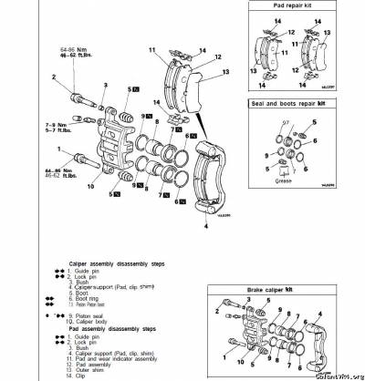

Jerking to any direction while braking is a brake issue.
More than likely the caliper pins are hanging up not letting the caliper float.
Dust boots ripped is most likely the culprit.
Terry Posten
Dec 16, 2003
9,009
Davenport, Iowa USA

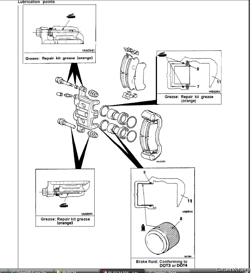

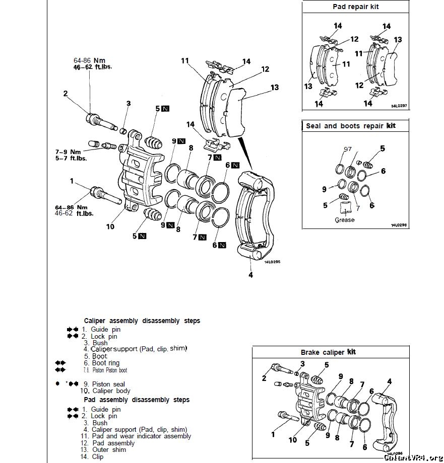

The bolt/pins are sealed inside rubber boots to keep them floating.
Take the front brakes apart and you will see what I am talking about. When you put everything back, clean everything really well and use a little grease on the bolts.

just for that pic this almost belongs in how to. i will most definitely be using that soon. my front brakes are acting funny as well.
