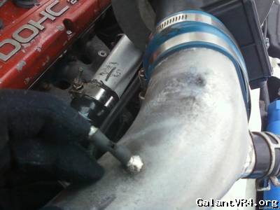

As of the past two days 1471 has been pulling only 15in of vac while idling and 20in while in gear with the throttle closed. I've only own 1471 for just a little bit over a month and a half, but in that time I have only seen my car pull 20in of vac at all times if the throttle is closed. What could be causing this? At this point I am completely clueless I dont know what else the problem could be.

If you haven't done it yet, Boost Leak Test. But loss of vacuum would be on the intakes side of the TB.

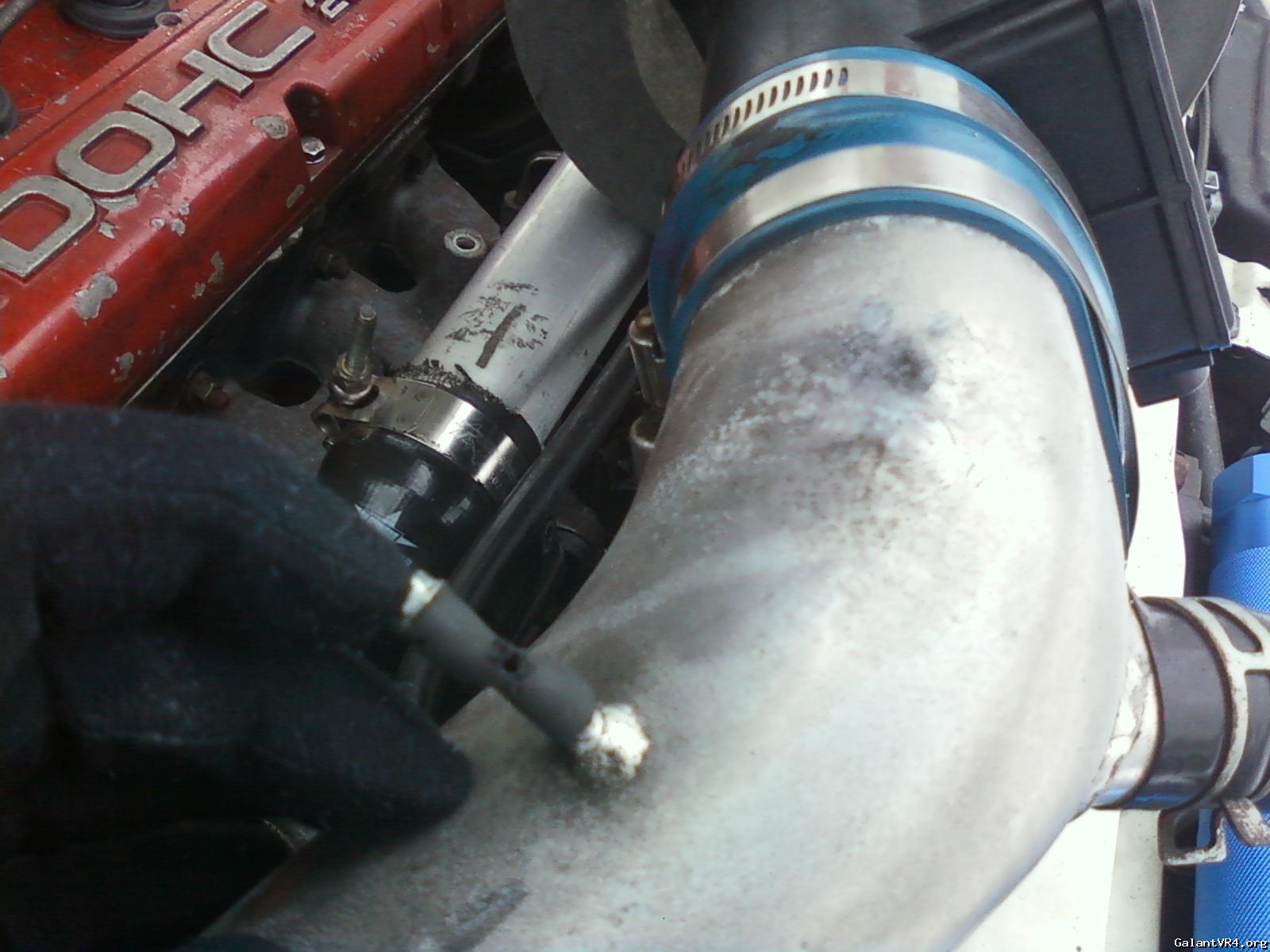

To me it really sounds like you have a bad section of vacuum hose. If any of your vacuum lines look questionable, replace them ALL. And I see from your pic of the torn one, you do.
If that line thats before the turbo goes to the wastegate then thats your problem. Hole in the line aside, that will never see boost.
Replace all your vacuum hoses.

Ok I'll look into replacing those lines and I'll take a closer look at the lines on the intake

TrendSetter, I'm not sure I understand what you mean. The hose that is pictured, that my thumb is holding straight is nothing but a hose with a screw in it that someone put on the car to close the small port on the intake
