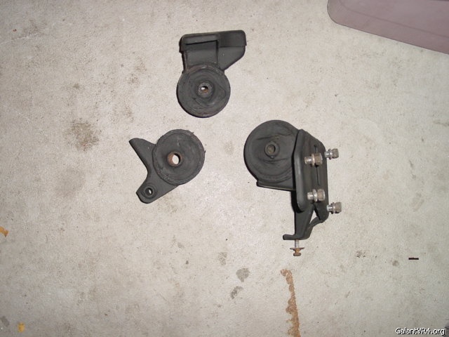

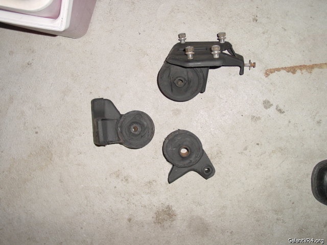

Here are some tips of the prothane motor mount install. I installed the complete kit. The motor mounts are both complete replacements, meaning timing belt and tranny mounts. The rear roll stop is a complete replacement and the front is an insert. The complete inserts are 3 pieces, 2 poly and one metal sleeve. The insert for the front is 2 pieces and is harder material than the other 3 mounts.
First a few notes about removing the inner "sleeve" on the complete replacement mounts. If you don't have a vice, good luck. It's pretty much a necessity. Once in a vice, be very careful not to squish the mount out of round, I took a sawzall and carefully cut out the majority of the rubber. Doesn't have to be all of it, just most of it. Then take the sawzall and very very carefully cut through the metal sleeve. When it's cut all the way though the sleeve will loosen and fall out. However in order to not cut into the mount at all I had to cut 2 slits almost all the way through. Then I used a screwdriver and folded the sleeve towards the center, cutting the finally 1/16" through the sleeve once it was higher than the mount. Now it will fall right out. Just grease up the new poly bushings and push them right in. Before I installed my bushings I sandblasted and repainted all the mounts. No more bubbling paint and surface rust.

Every single mount on my car was torn through so i'm sure this is much much better. Engine is in there solid now and it vibrates. I still have BS on this engine and I haven't driven it much yet. But it's going to buzz and now the motor will stay much more in place. Worth $100 to me and the install time even with the motor in the car. Would be even easier with the motor out. Hopefully wheelhop in the groove will be reduced. BTW I really dig the black and it's very stealth mod.

....saved to the harddrive. Nice Chris, did you rattle can the mounts as well when you had them off? They look fantastic. Is the additional vibration annoying?
I sandblasted and rattle canned all the mounts when they were out. Nice to have a free sandblaster thing at work. I could have powdercoated them but the paint was in not that bad shape after 14 years so I think krylon is enough. I'm sure the sandblast and multiple coats help plus I wanted the rust gone.
