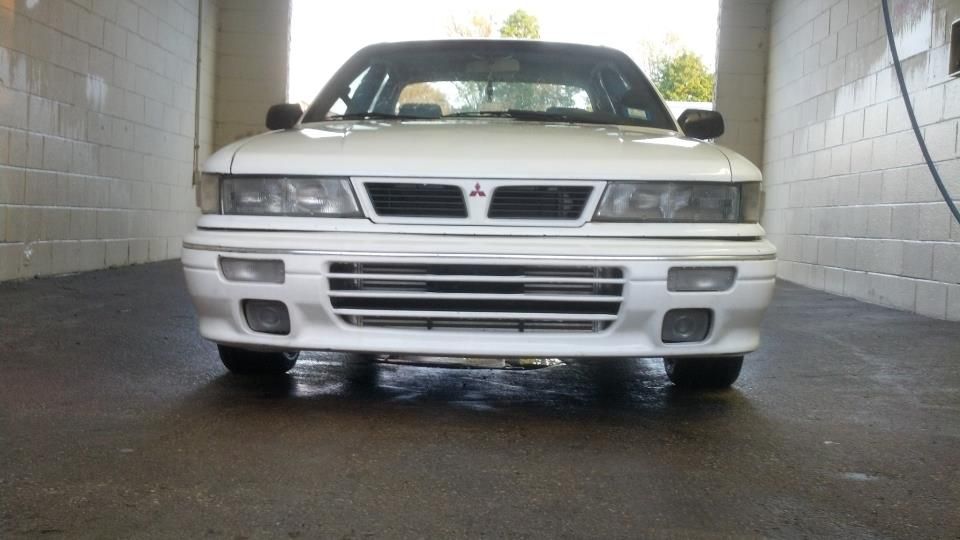

Got the front bumper on today! Barely had to cut anything! Love how sleeper it looks
