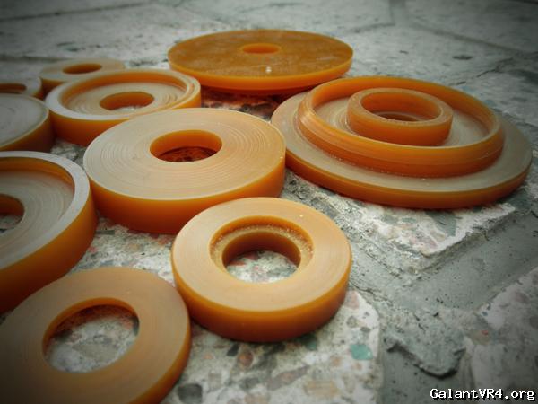

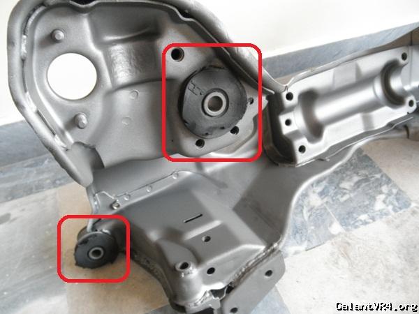

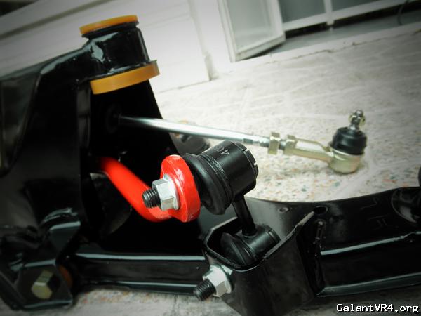

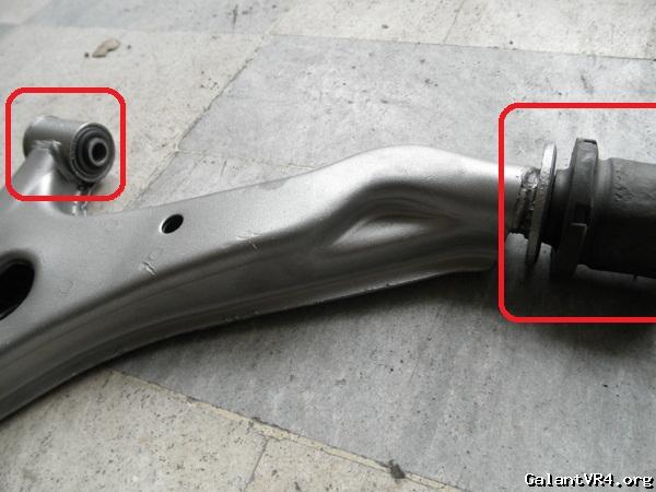

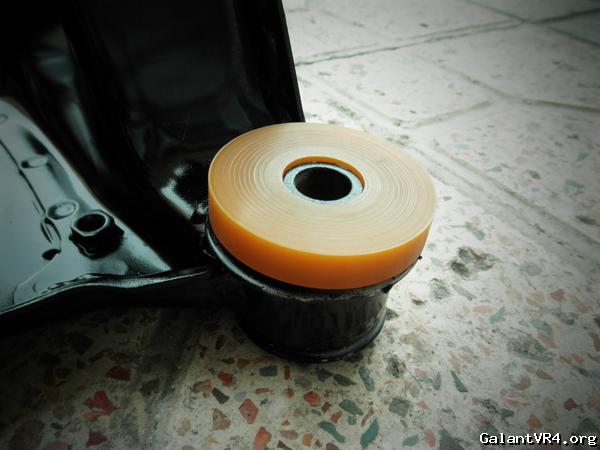

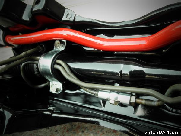

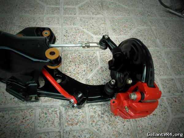

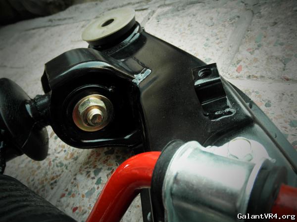

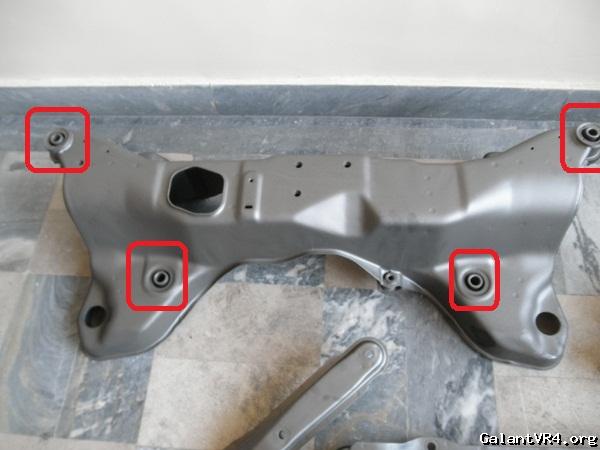

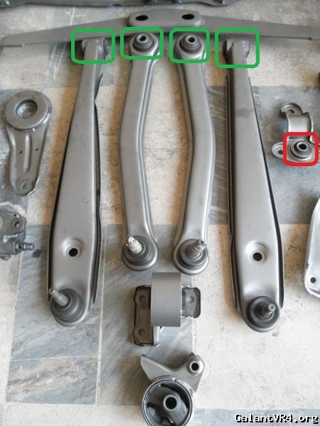

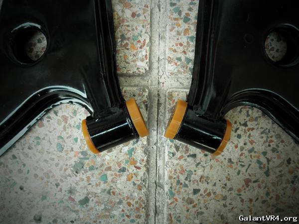

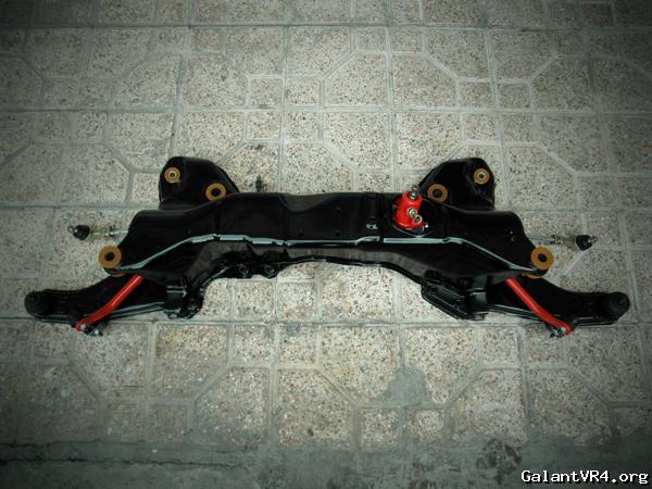

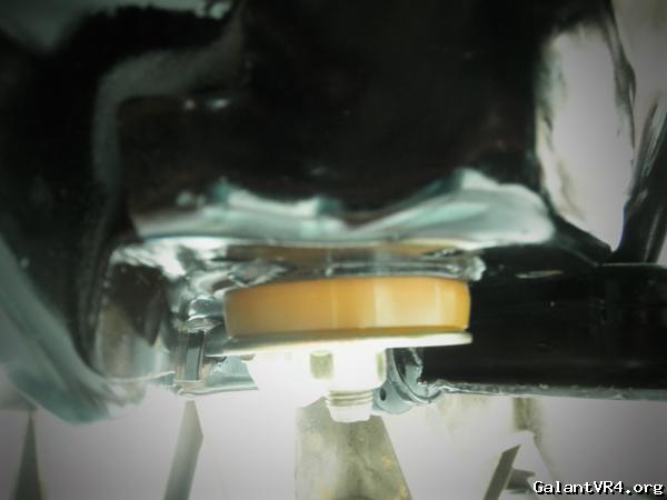

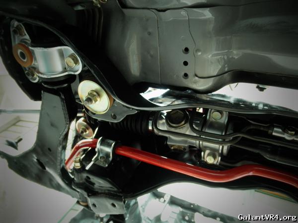

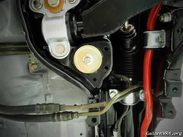

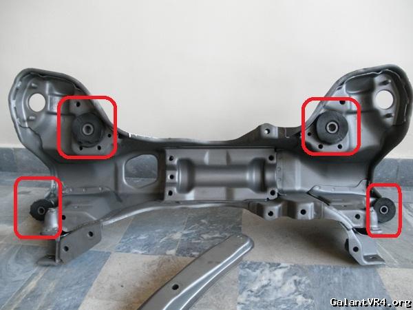

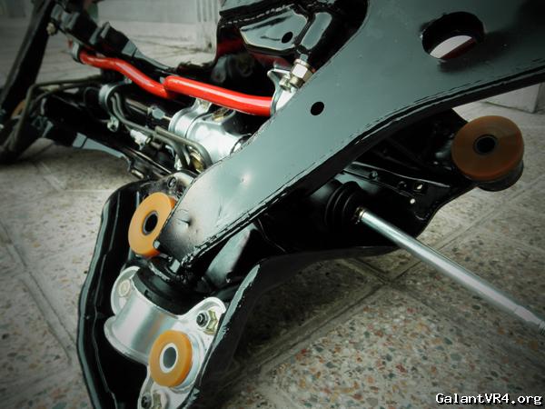

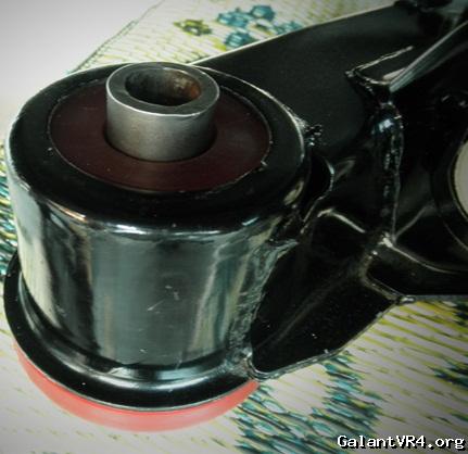

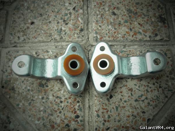

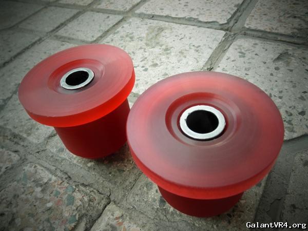

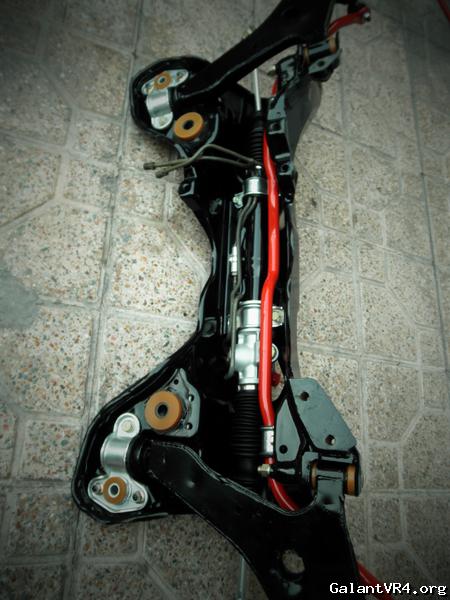

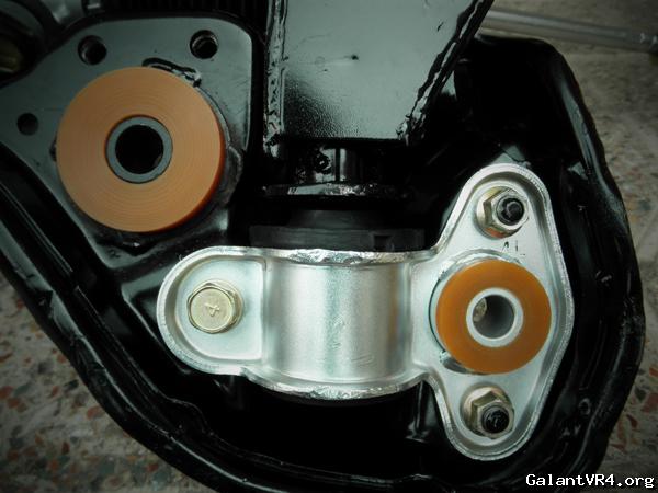

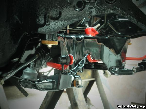

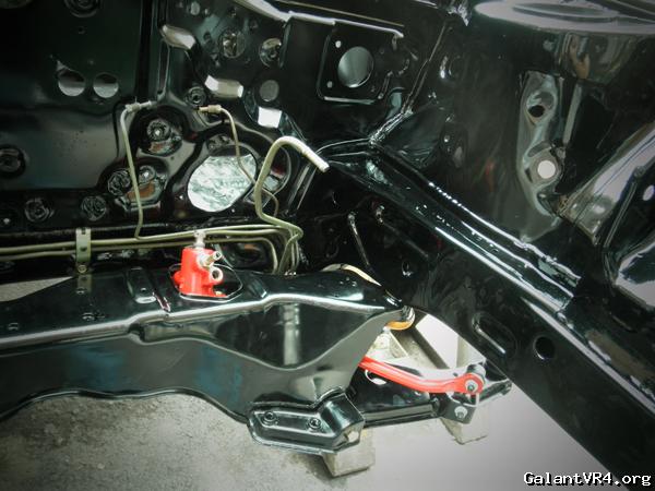

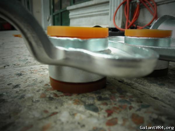

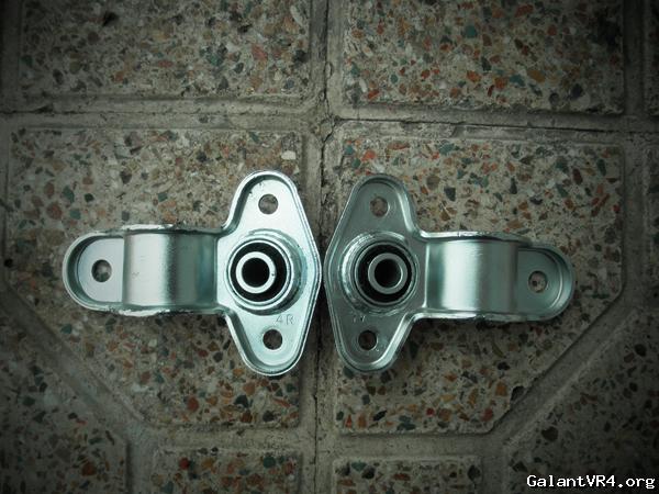

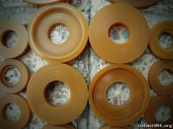

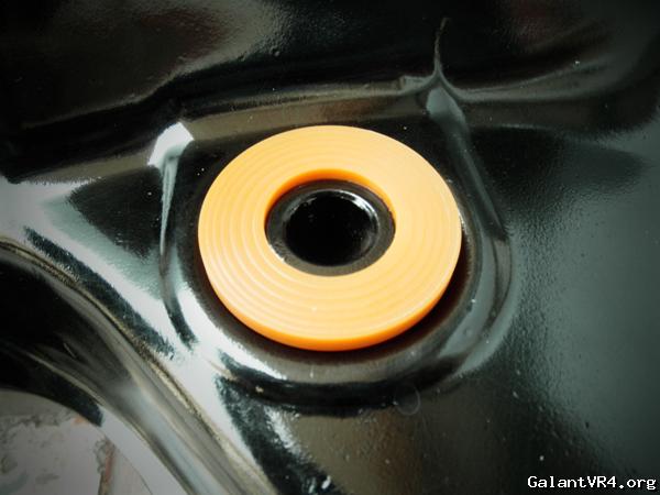

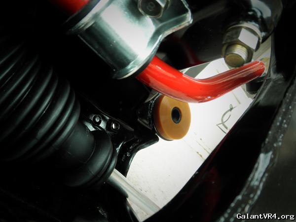

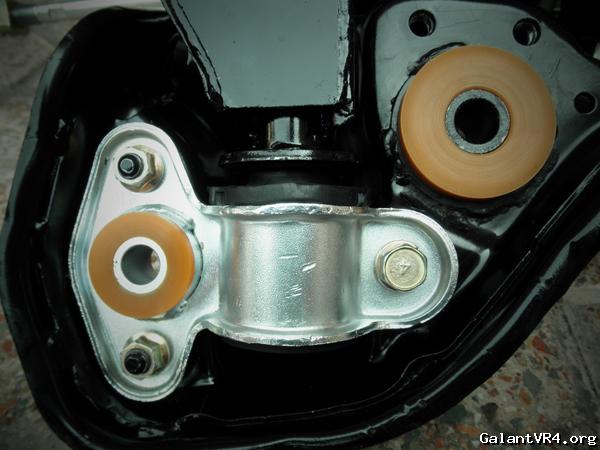

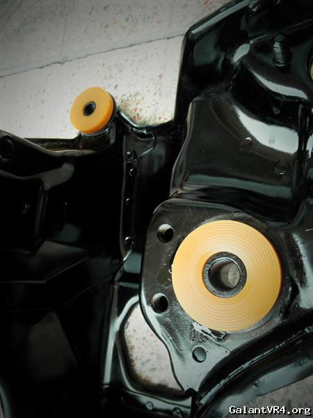

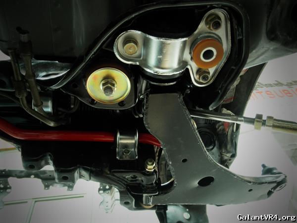

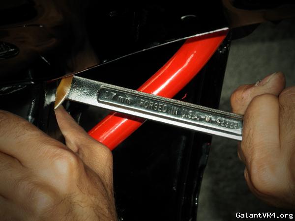

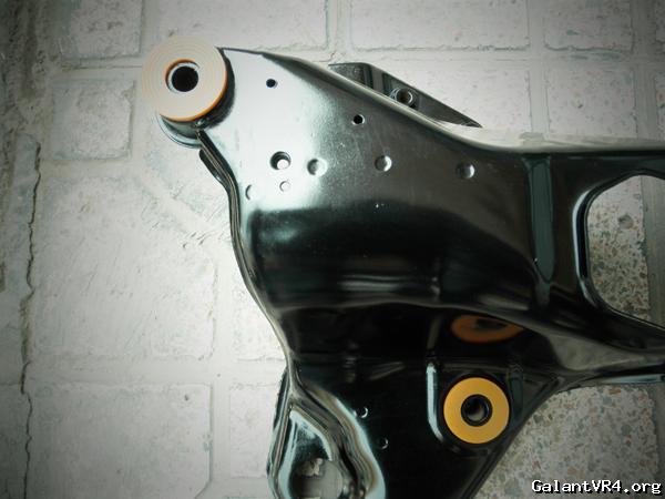

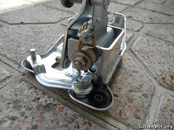

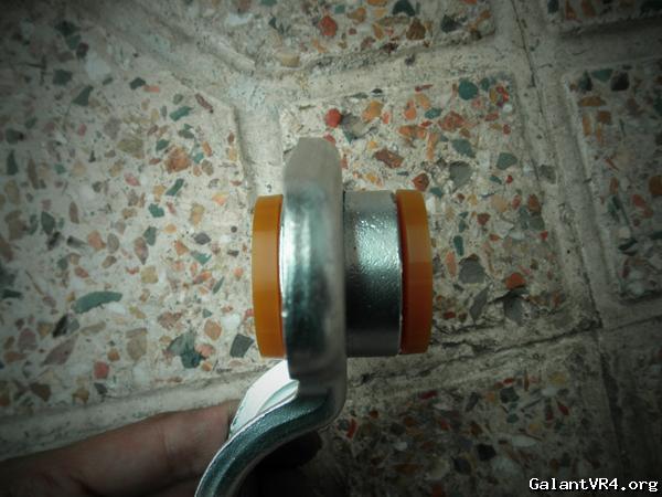

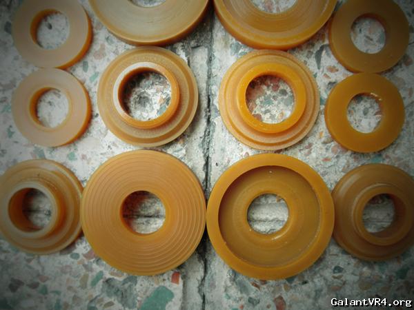

now i go to checkup the bushing
Red square : it means the rubber is not good (Just rubber the outer edges of the damaged) The interior rubber are quite healthy
green square : it means rubber is good
please see these pictures

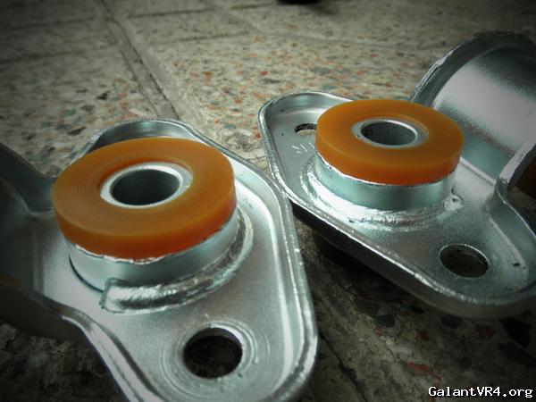

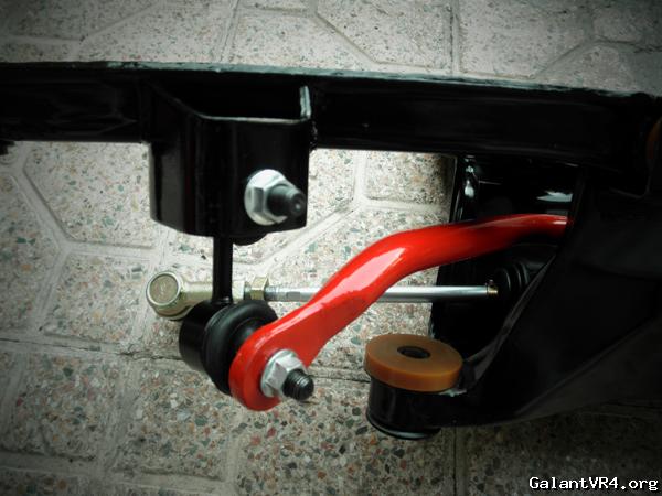

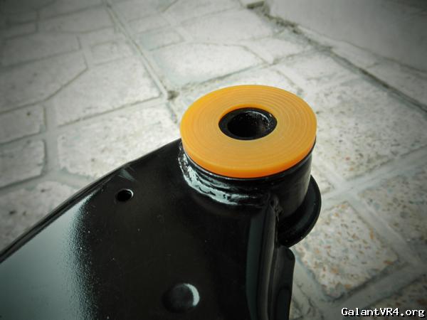

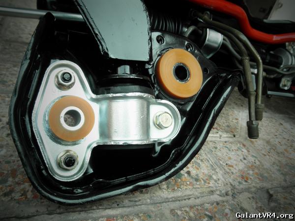

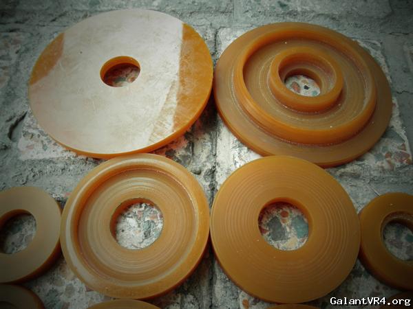

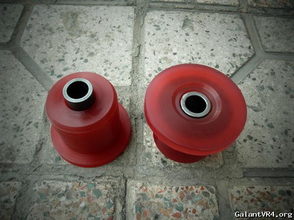

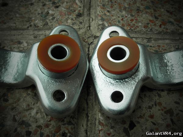

now we go to make the polyurethane bushing....

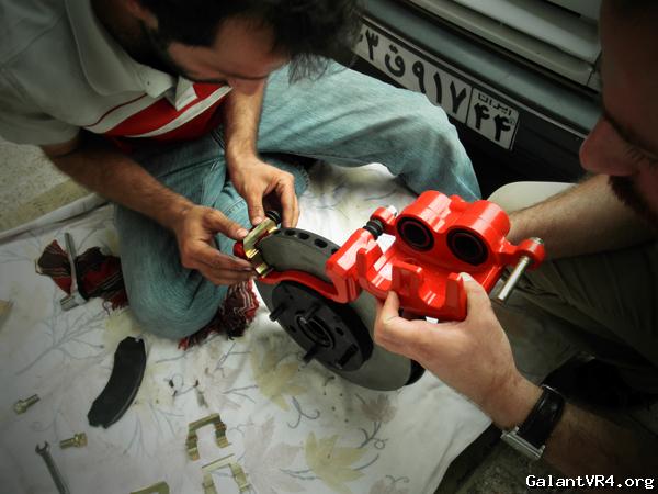

Quoting benjamin:

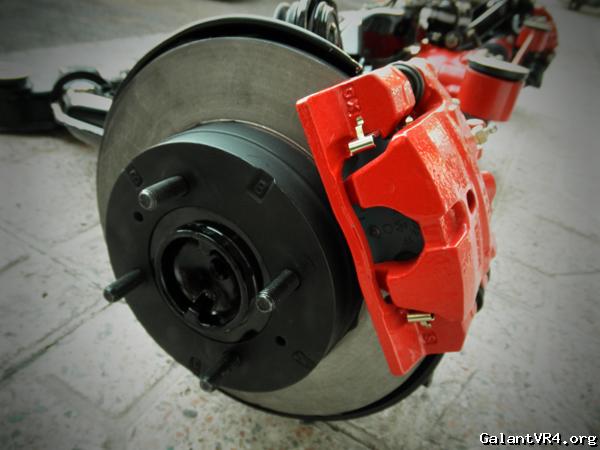

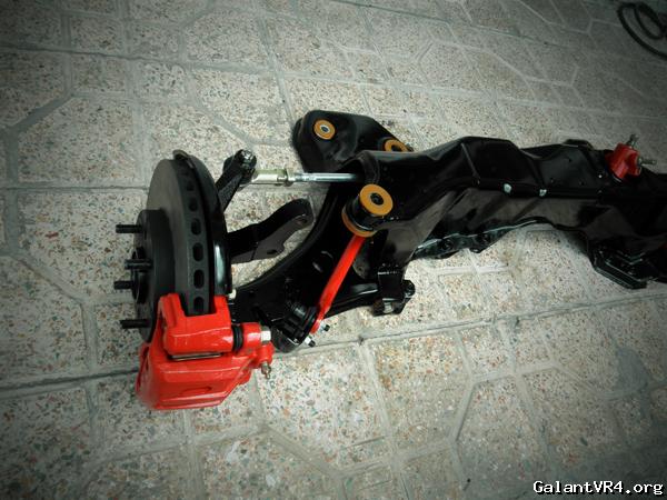

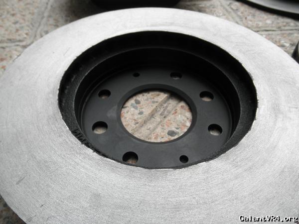

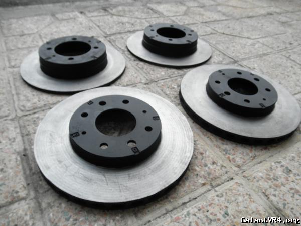

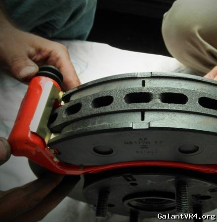

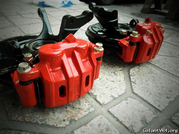

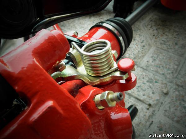

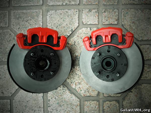

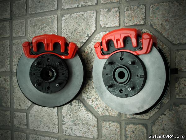

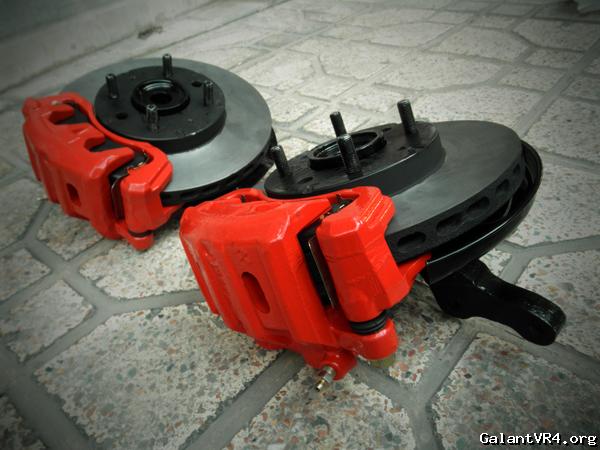

brake rotor ....
Hi Benjamin, question for you.
Were those rotors sanded with an appropriate grit sandpaper as a final pass after the cutters were used?
Reason I ask, is because the rotor needs to achieve a non-directional surface finish and holding sandpaper to it and making an up and down oscillating motion with appropriate speed, will achieve this.
If they don't get finished this way, the surface the cutters left, will pull the pads outward as they pass over, resulting in a click or clunk noise/shudder. I only ask if these rotors are for permanent road use, or if they are temporary.
Love the build regardless, so keep those photos coming along!
benjamin
Active member
Dec 21, 2015
25
hello sir thanks for your reply my topic
sir These rotor are temporary
The braking system will completely change in the near future
dont worry i know the original brake system not strong and i want to change it
