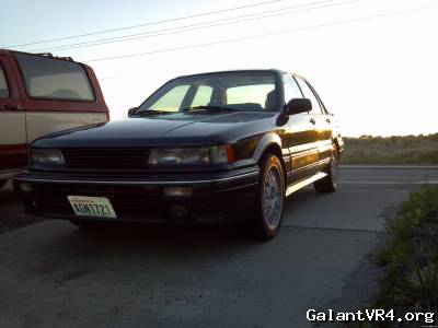

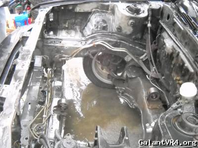

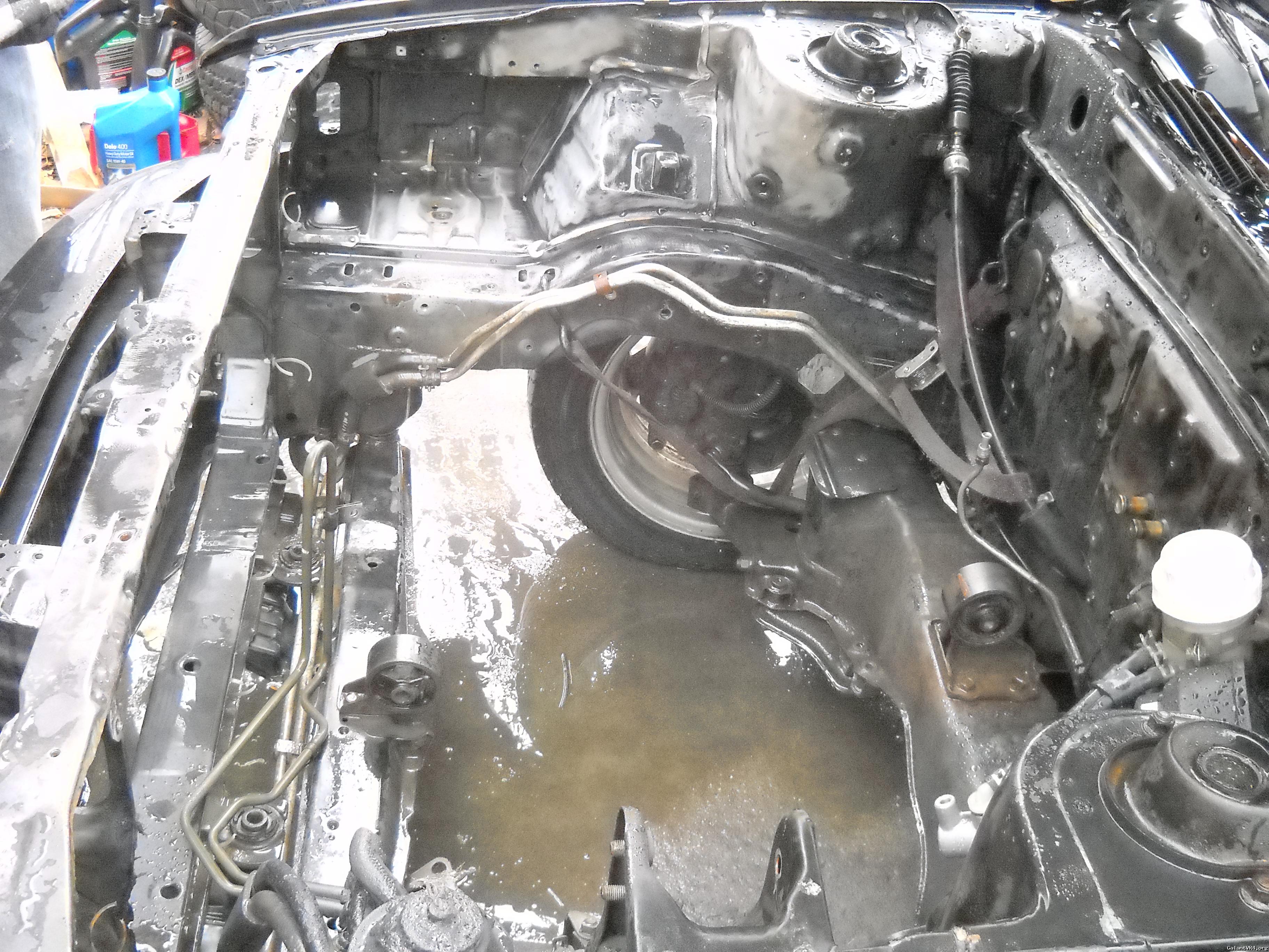

I want to start by introducing myself, My name is Kris Wildman. I live in West Richland,WA and I am a first time Galant owner. I bought the car in rough shape it was a victim of an engine fire. The car was barely a rolling chassis with a truck load of parts, a huge project but a fun one! Here it is, 837/2000!

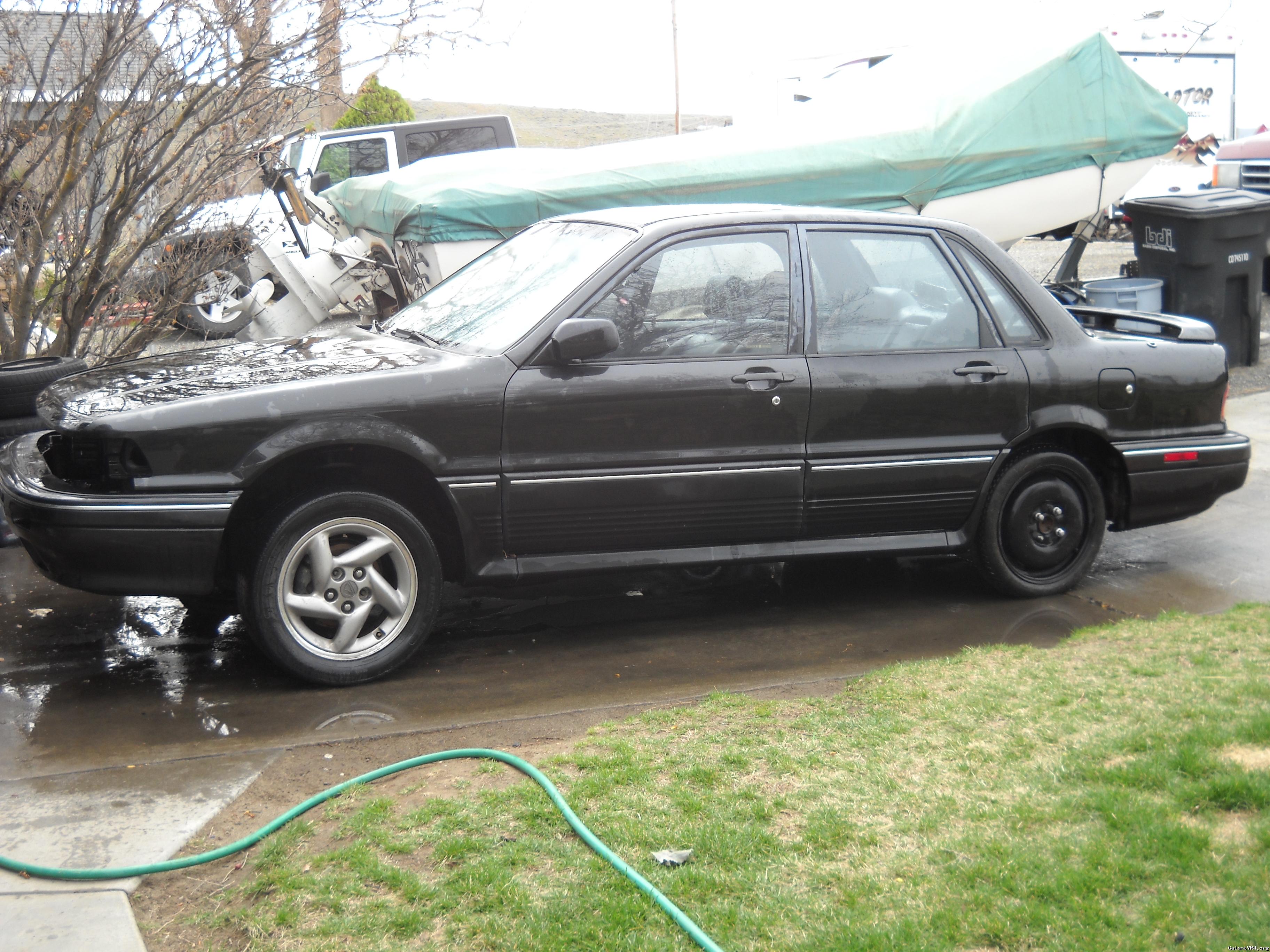

This is what she looked like when I got it home. After a bath of course!

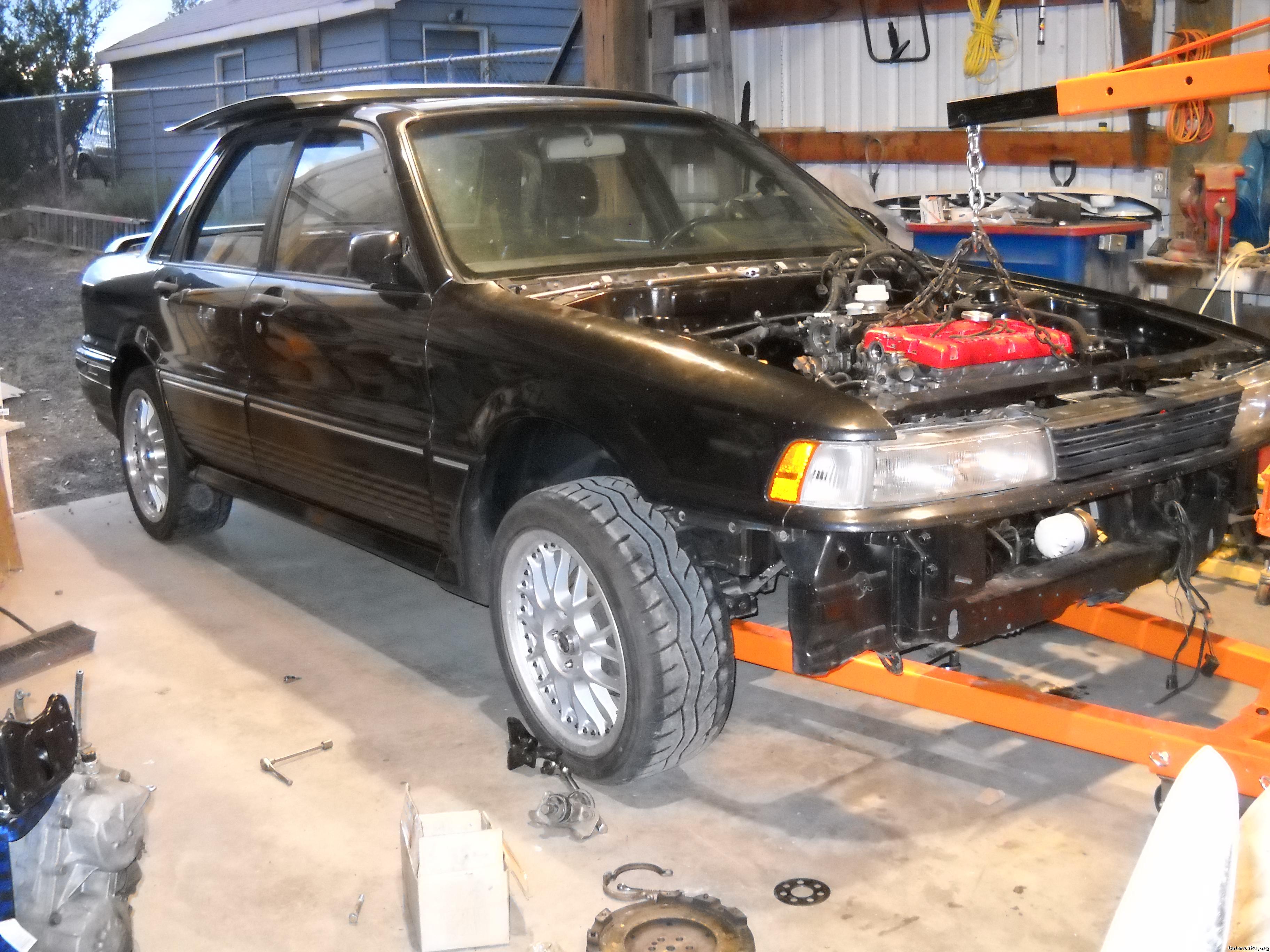

As of day four...

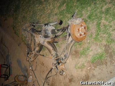

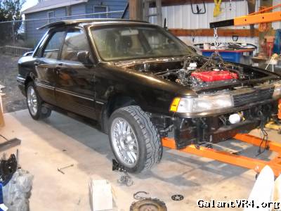

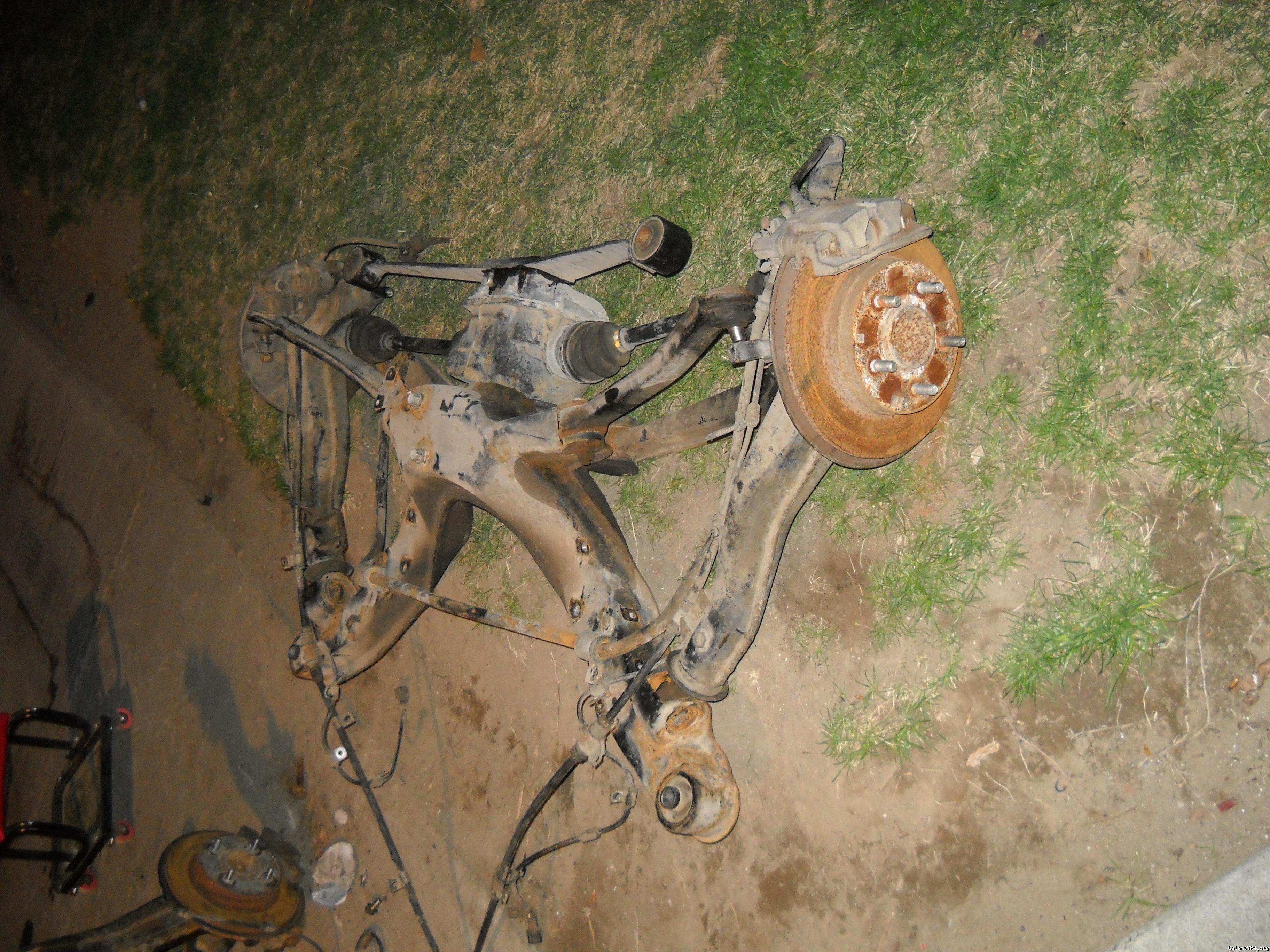

Five lug conversion, Rear steering delete, and a LSD!

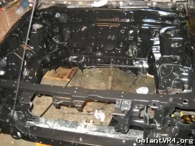

Stripped, sanded, cleaned and painted!

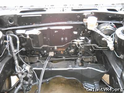

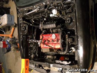

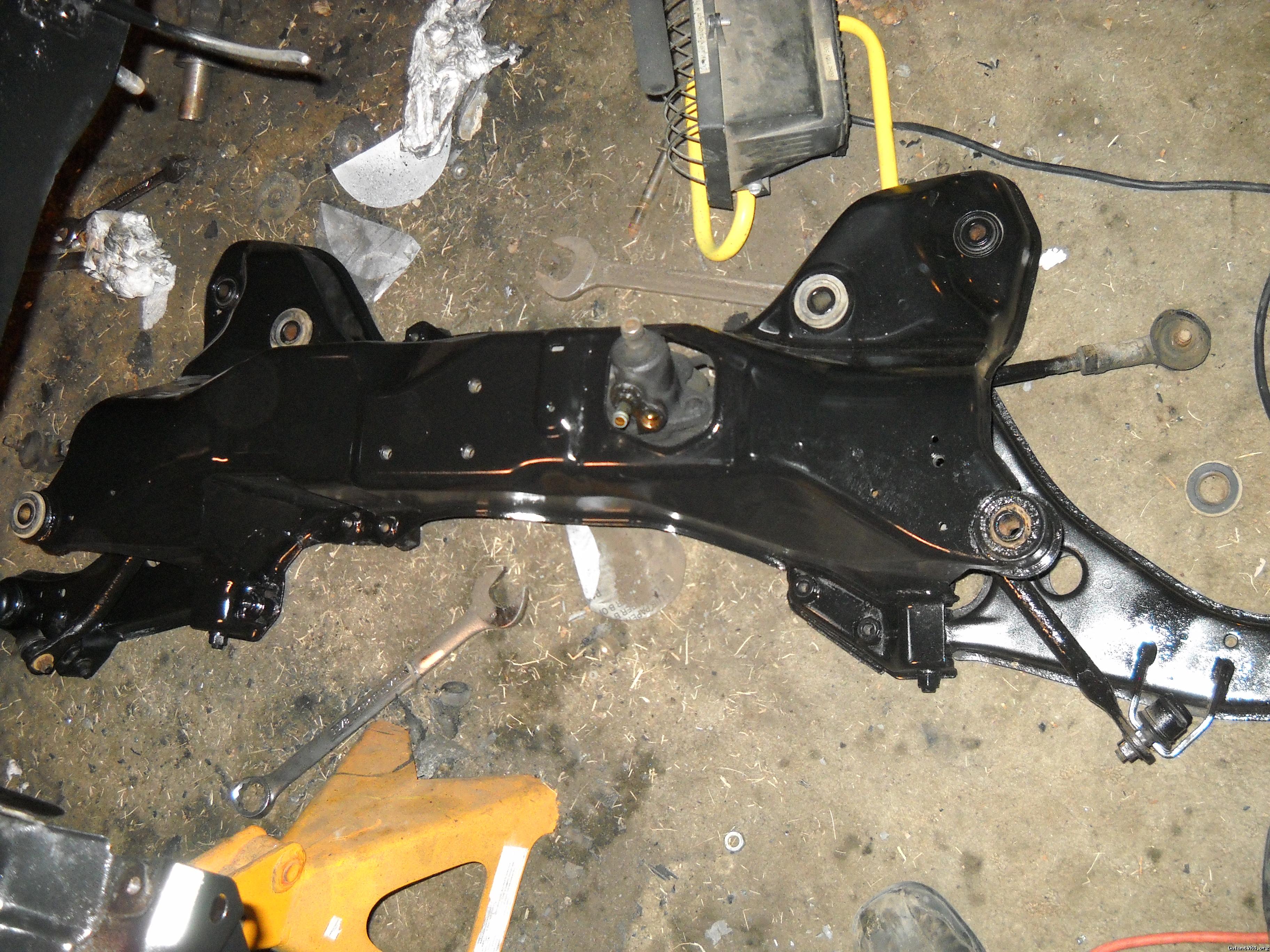

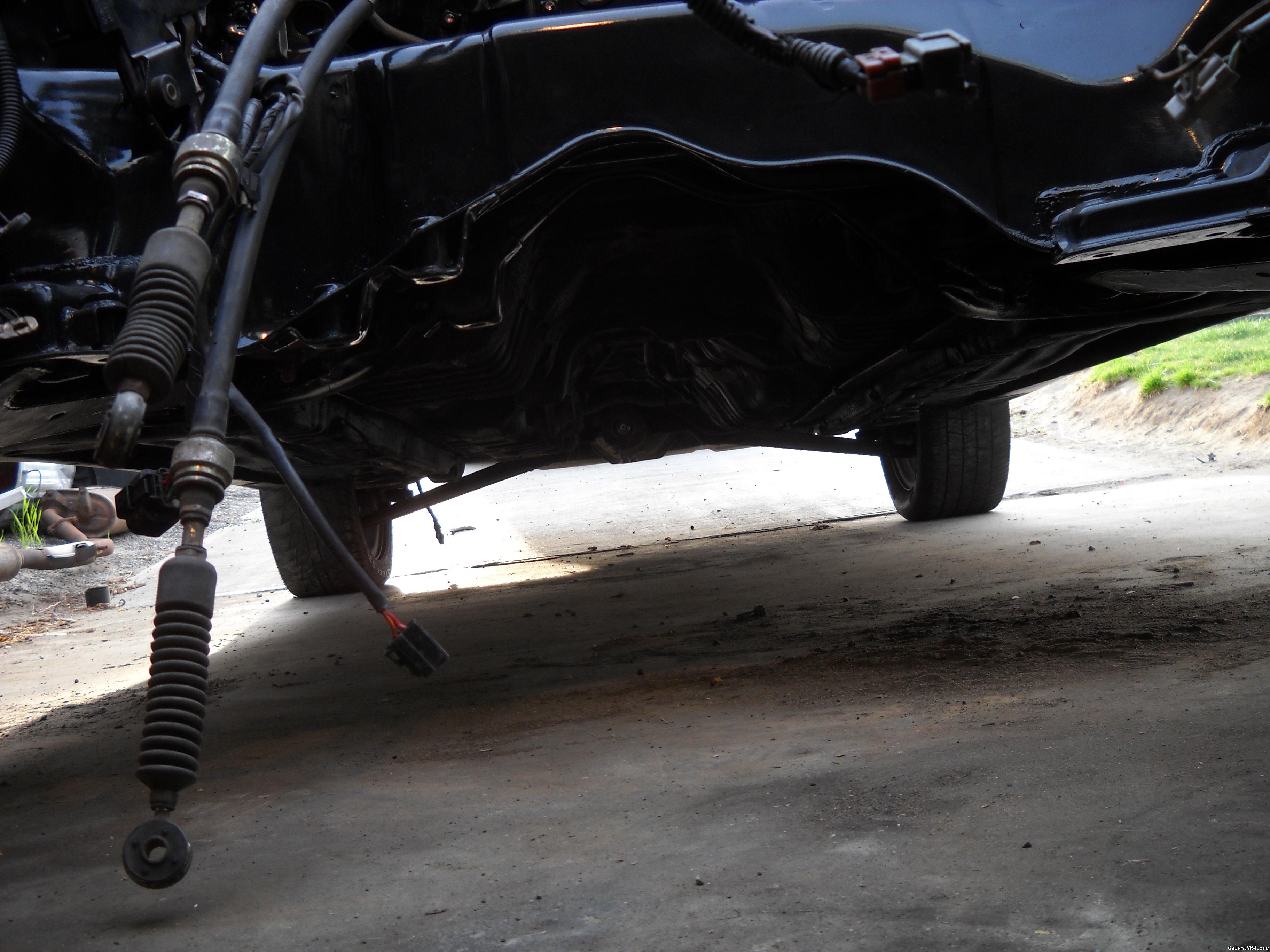

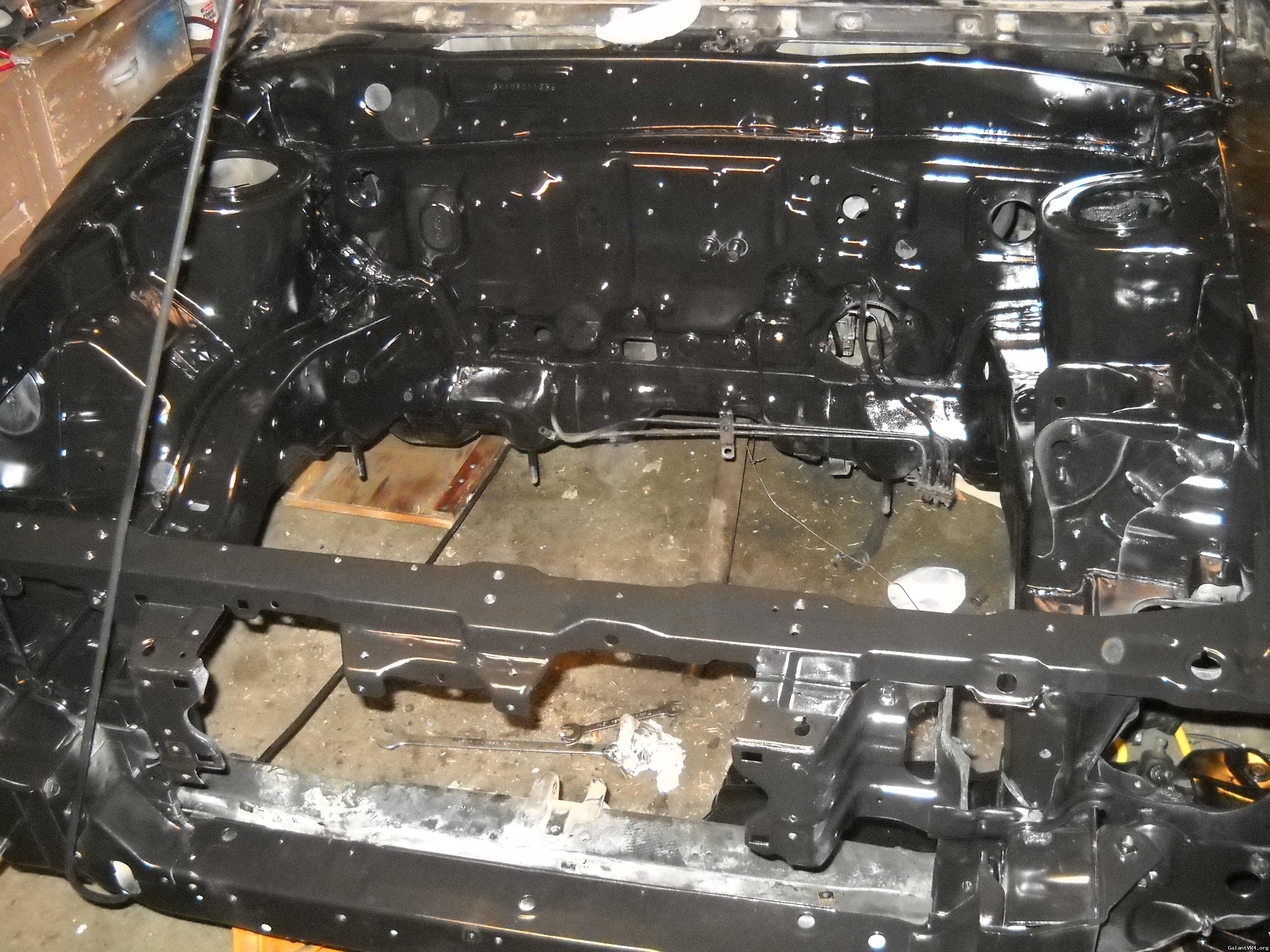

another productive day.. the reconstruction has begun. wiring harnesses are back in, cleaned and undercoated the entire underneath tomorrow the rear sub frame will go back in and she will be back on the ground! /ubbthreads/images/graemlins/grin.gif

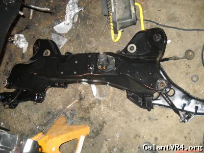

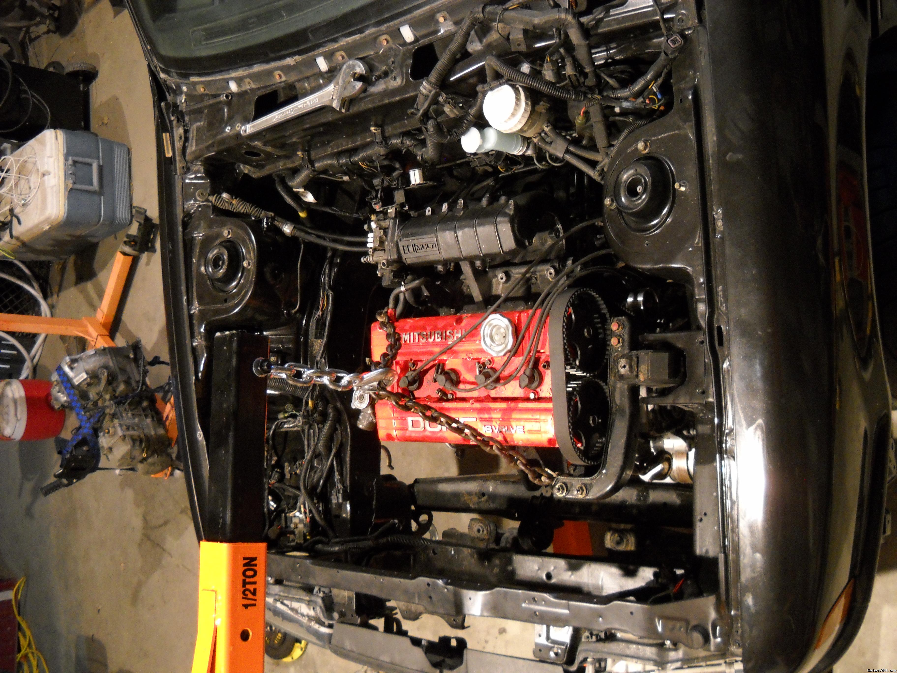

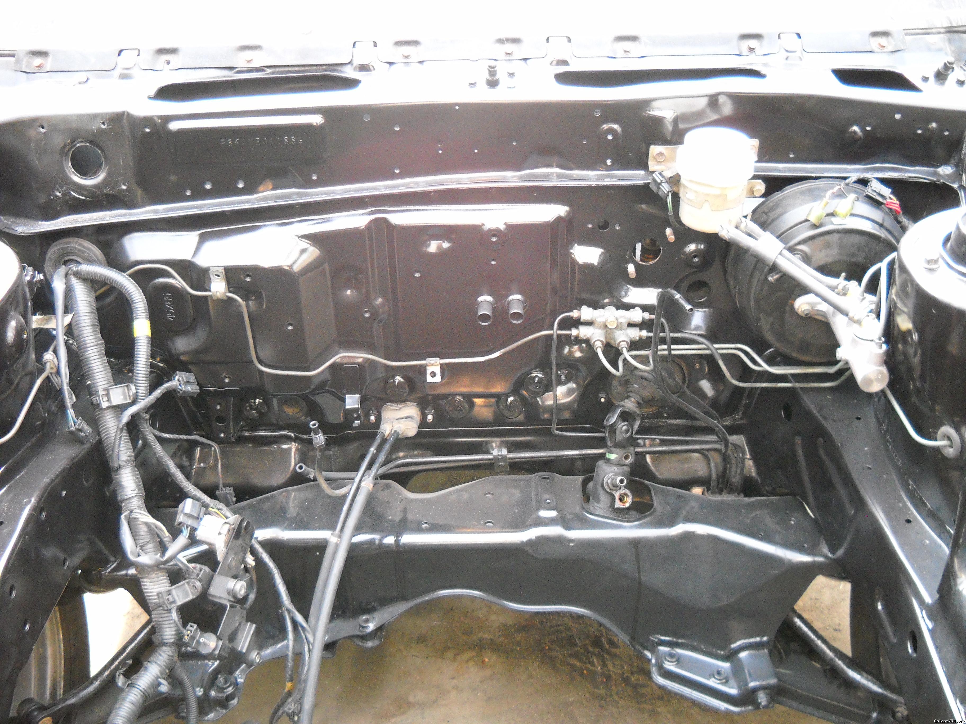

abs delete done master cylinder and brake booster installed along with the rear sub frame basically ready for the engine and tranny!
amazing what 2 weeks will do to a car!
Do you not plan on putting the cloth stuff in for the firewall to help prevent it from having another fire?
But great work so far! I want my engine bay that clean!!!!
11,982
How would that stuff help prevent a fire? The original fire on this car started at the fuel rail.

Engine bay looks good, factory Nile Black I assume? And your electrical looks to be in good shape too for having been in a fire

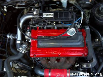

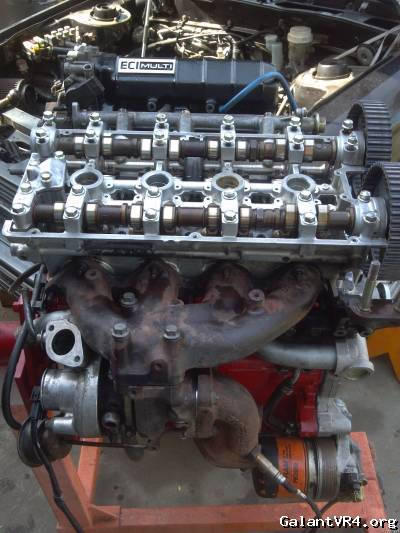

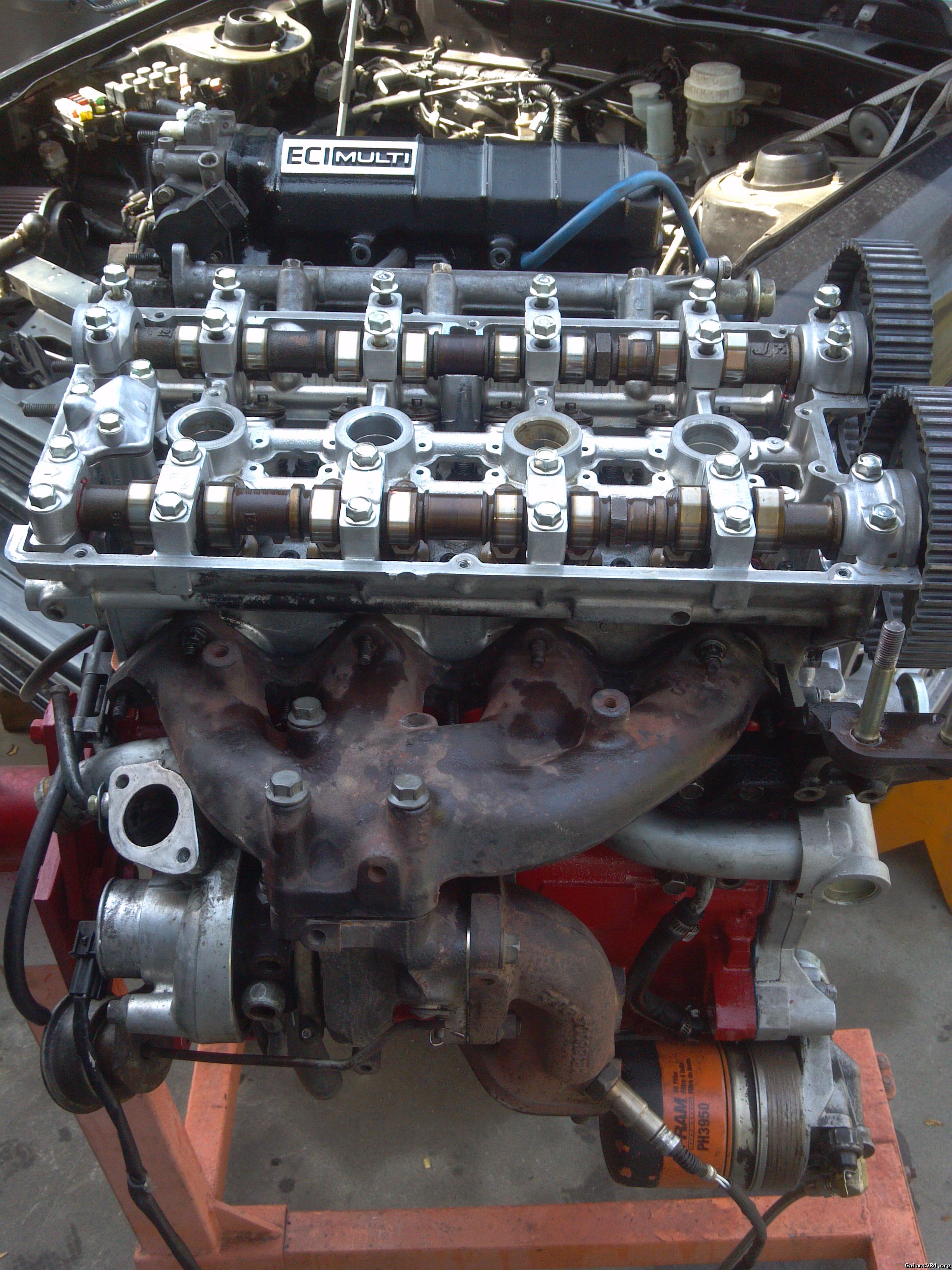

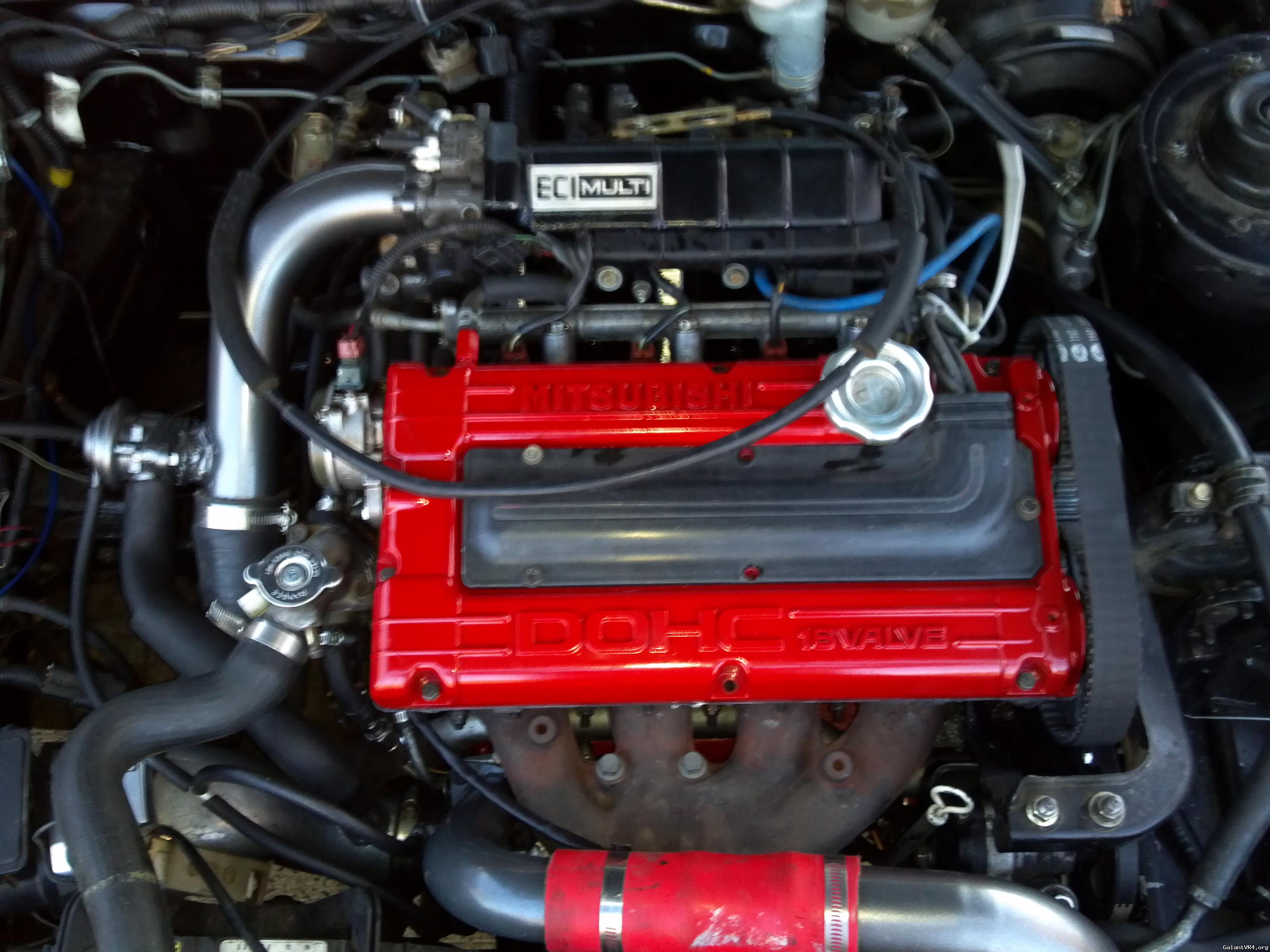

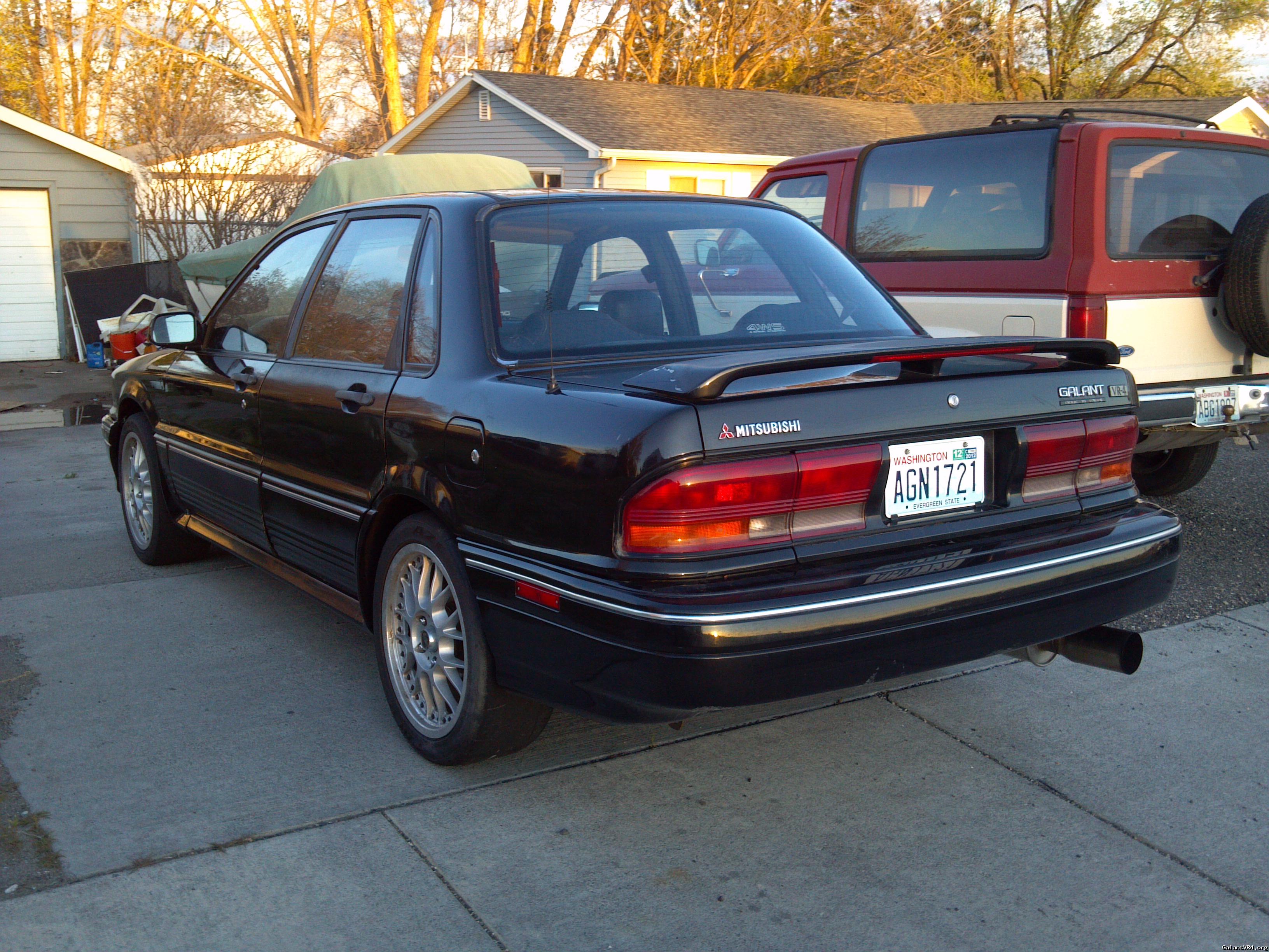

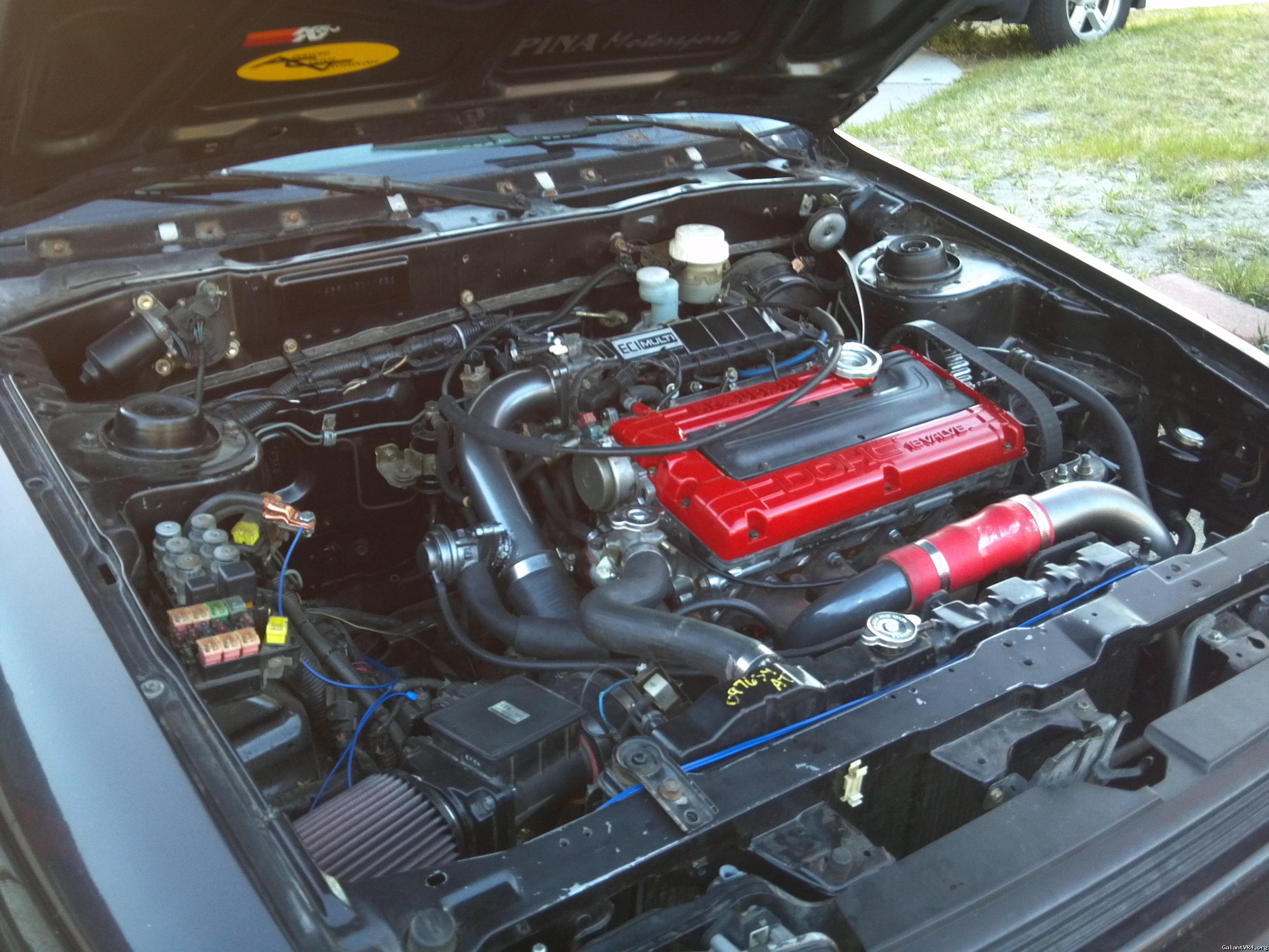

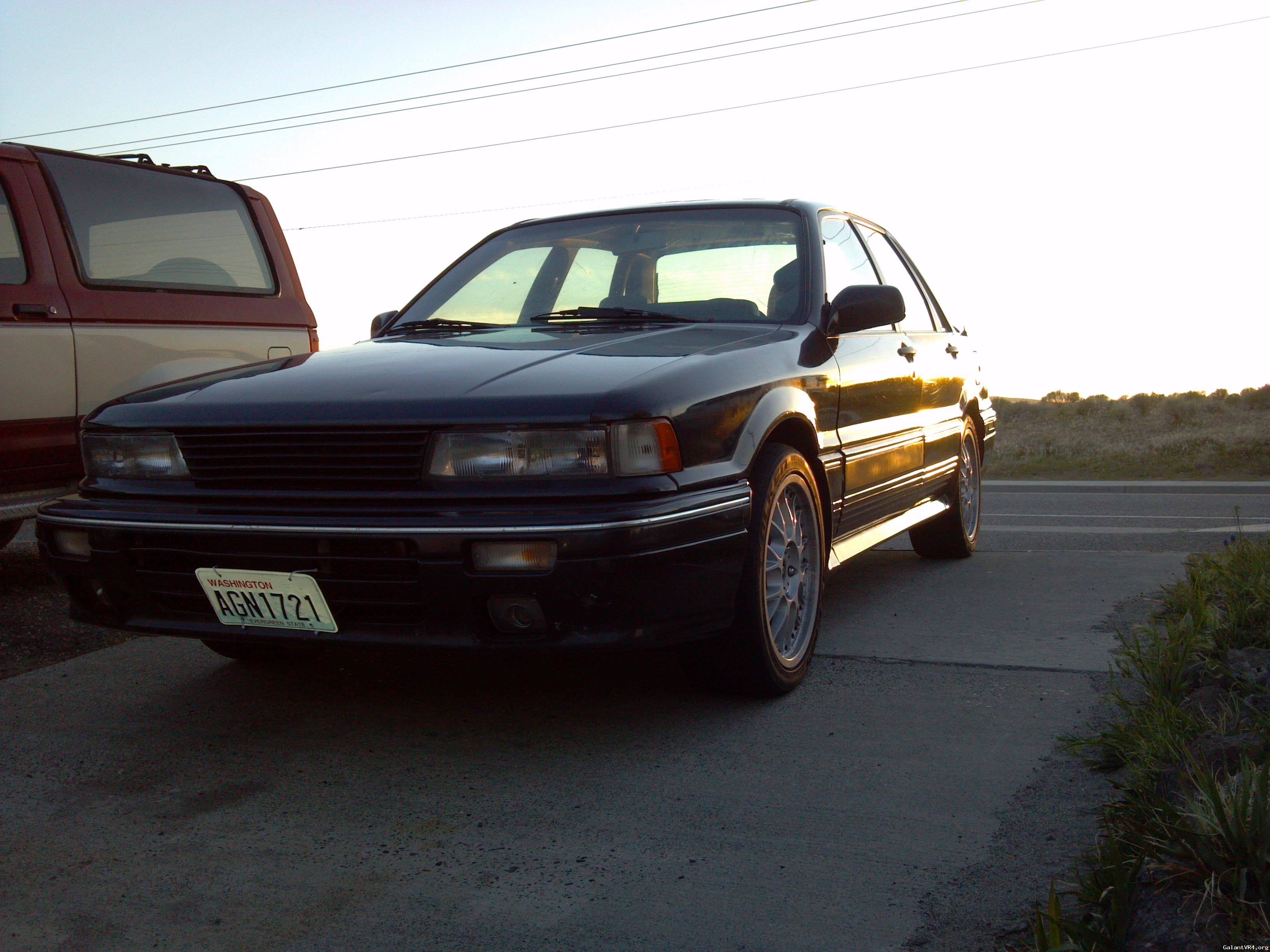

As of today 837 is finally back on the road! With a fresh 6 bolt bored .020 over balance shaft eliminator kit, arp head studs, rod and flywheel bolts. fidanza flywheel with act 2100. Small 16g, 550cc injectors, 2g maf, jdm intercooler with custom piping and 3 in downpipe and full 3 in exhaust. the car also has a abs delete and 3 bolt lsd rear diff along with a 5 lug swap
