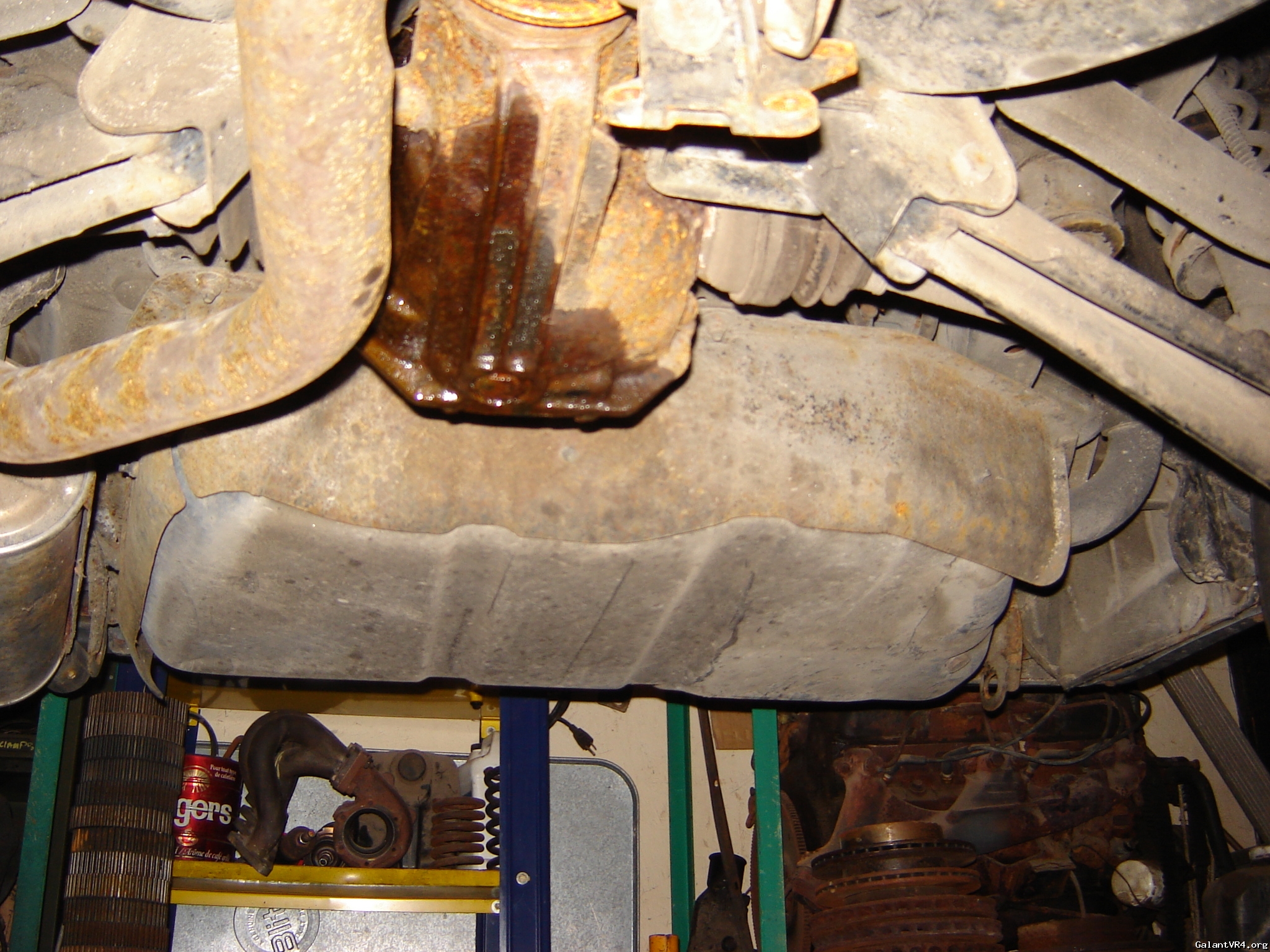

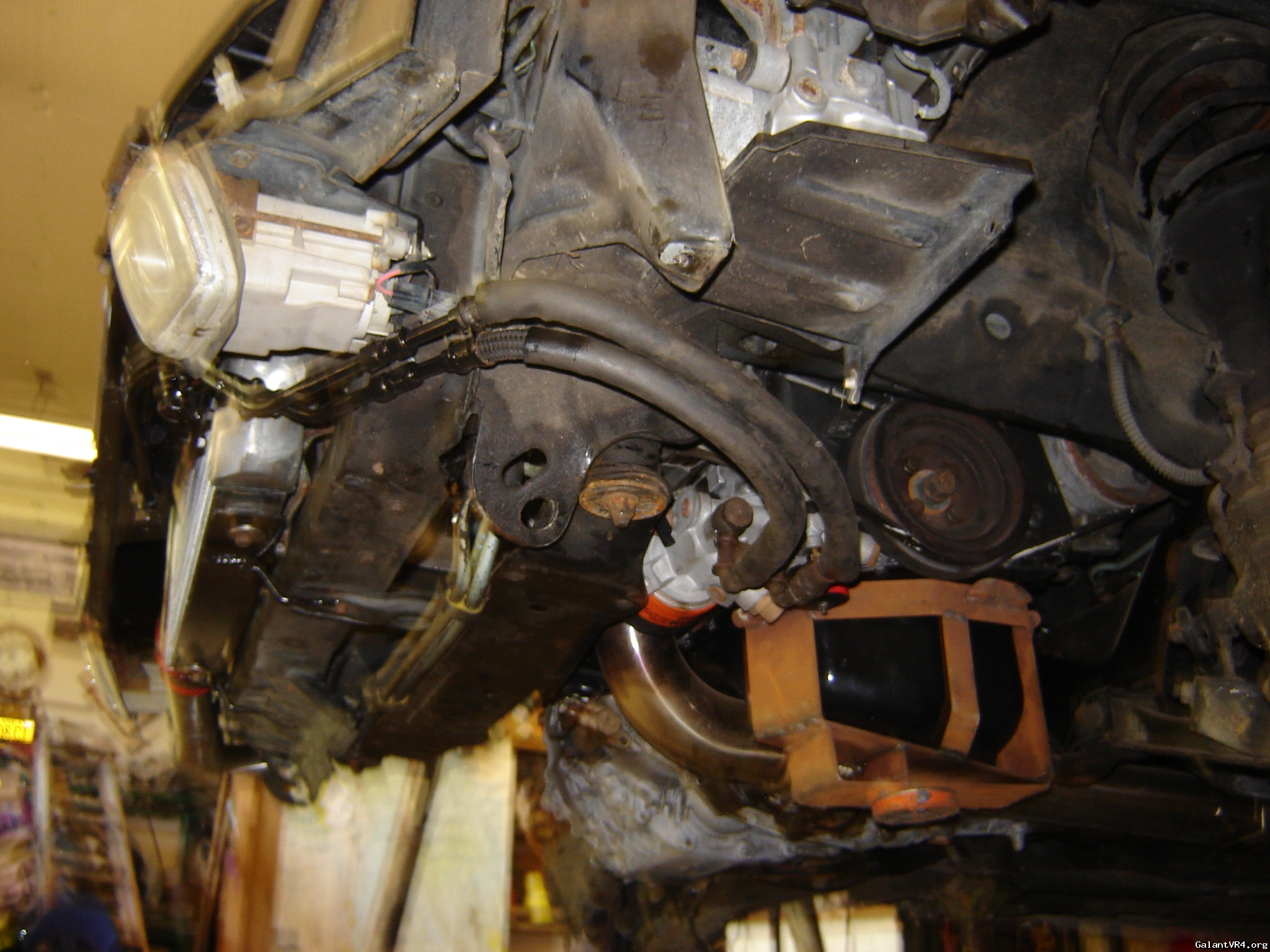

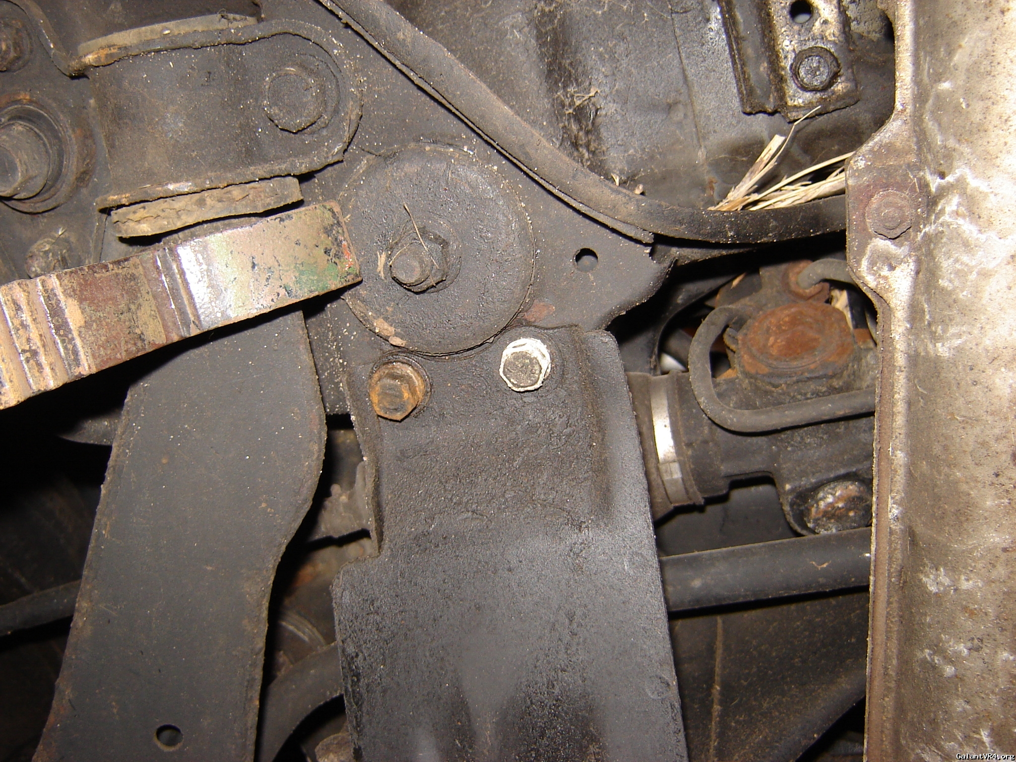

Although I was planning on keeping this pretty much bone stock because it is an un-molested body. But after a 2 hour inspection of all that I could see, I had to crawl out from under it and re-think. I know that bushings are good to be replaced, but I think its gonna have to be sooner than I had expected. They are all SHOT!!
Then to top it off, the 4WS is leaking (just like all the rest) But I want to keep it.

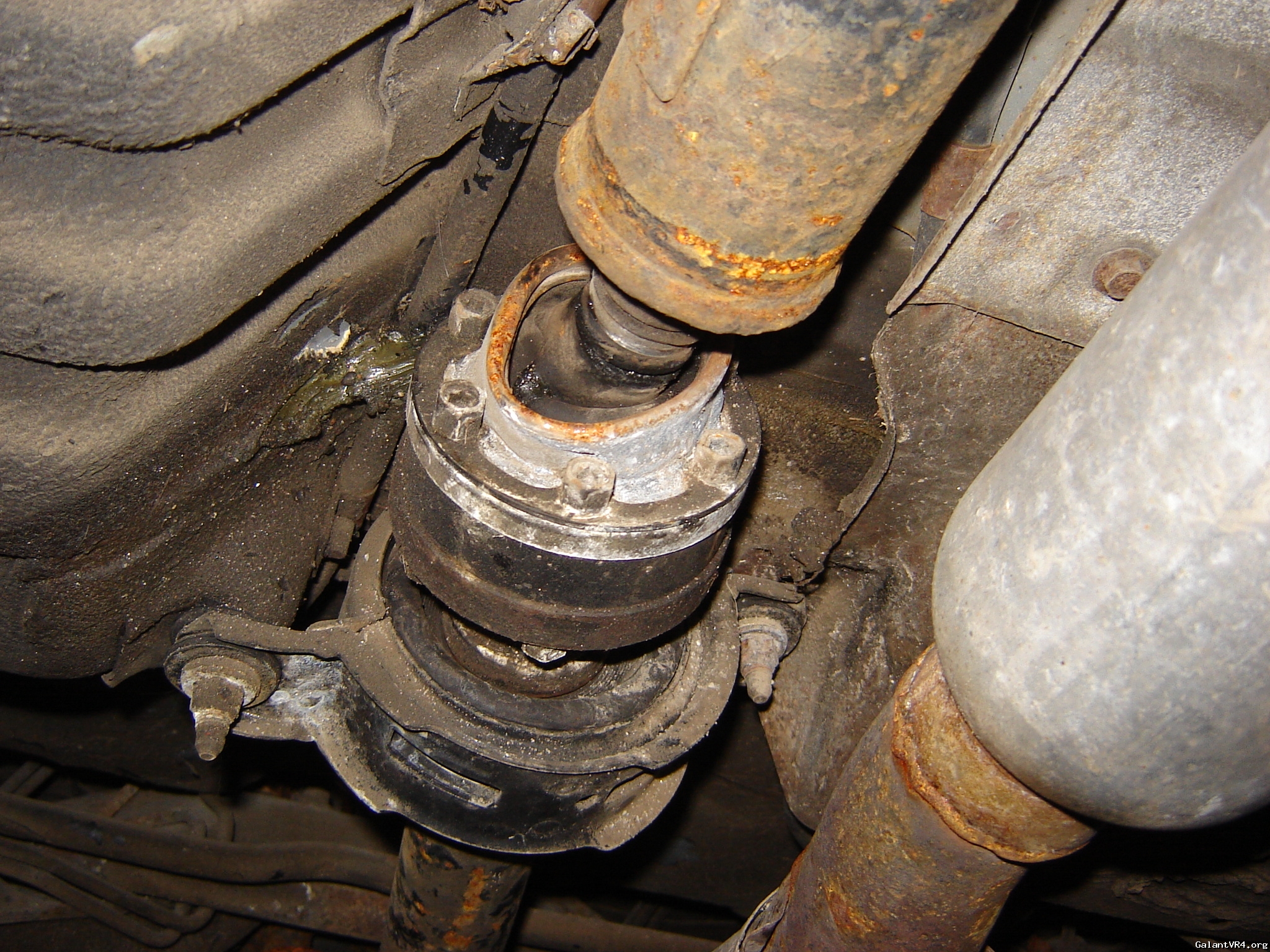

The guy that I got it from unhooked the driveline to dolly it, and bent the hell out of the drive shaft.. /ubbthreads/images/graemlins/banghead.gif

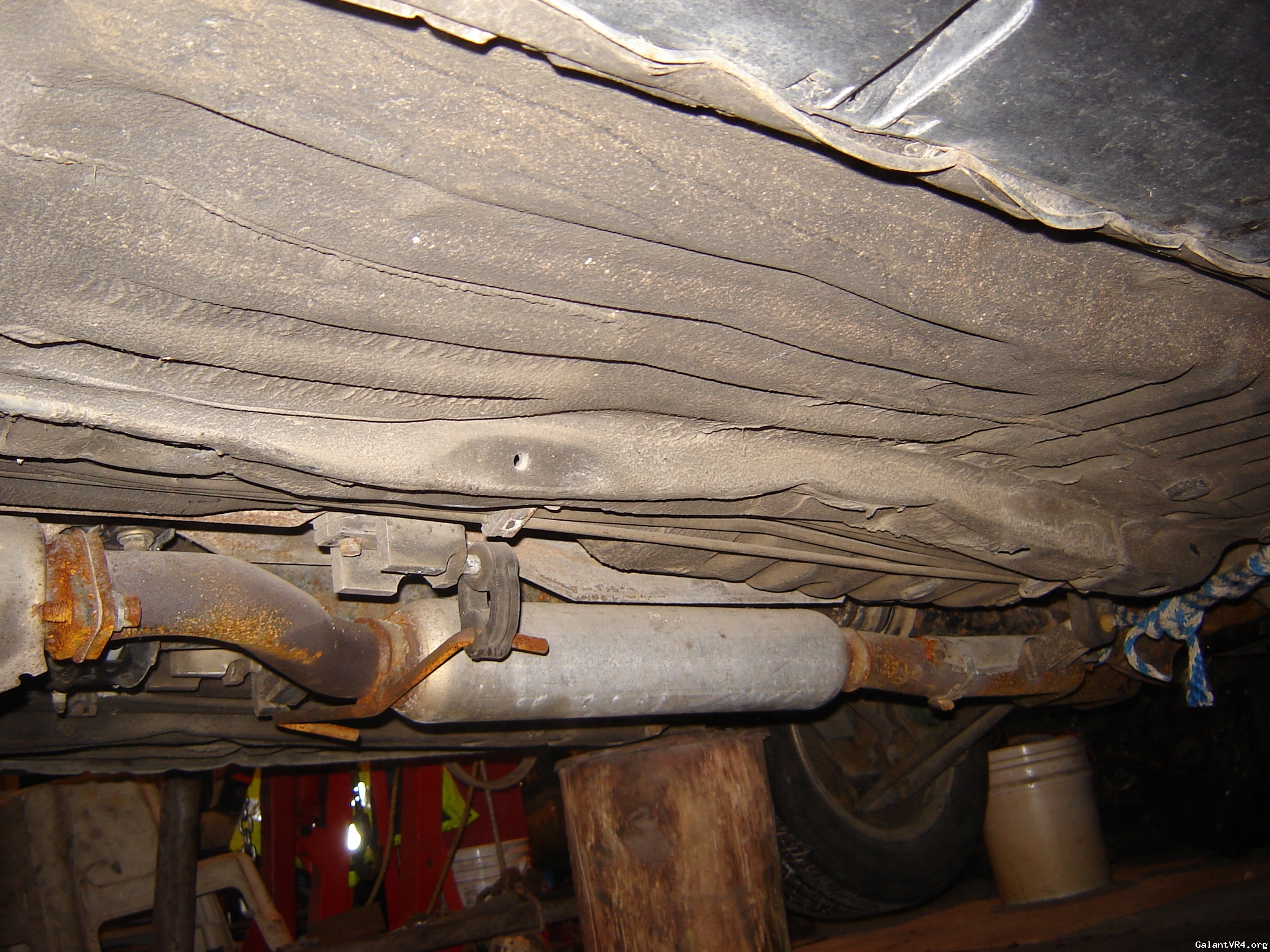

Who ever had this when it was drivable, must not have been able to judge the distance from the curb.. The uni-rails are squashed!!

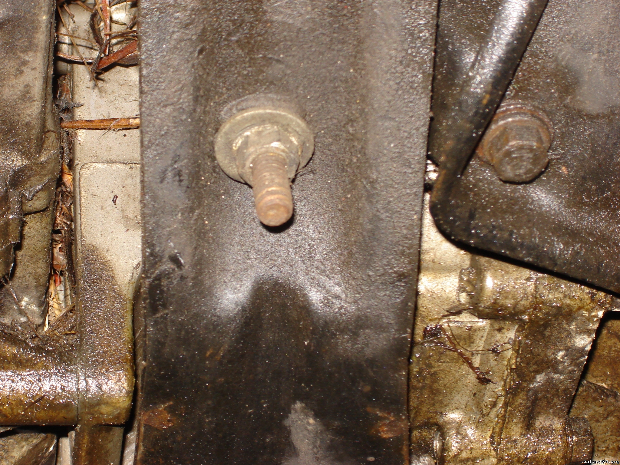

Oh and when you lose the original bolts... improvise!!! /ubbthreads/images/graemlins/worthy.gif
Sadly, I can guarantee there will be more disapointments. /ubbthreads/images/graemlins/bawling.gif /ubbthreads/images/graemlins/rofl.gif /ubbthreads/images/graemlins/bawling.gif /ubbthreads/images/graemlins/uhh.gif

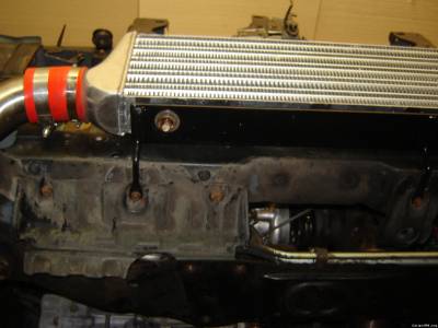

Well I see that Its time to revise the thread since I already started it...

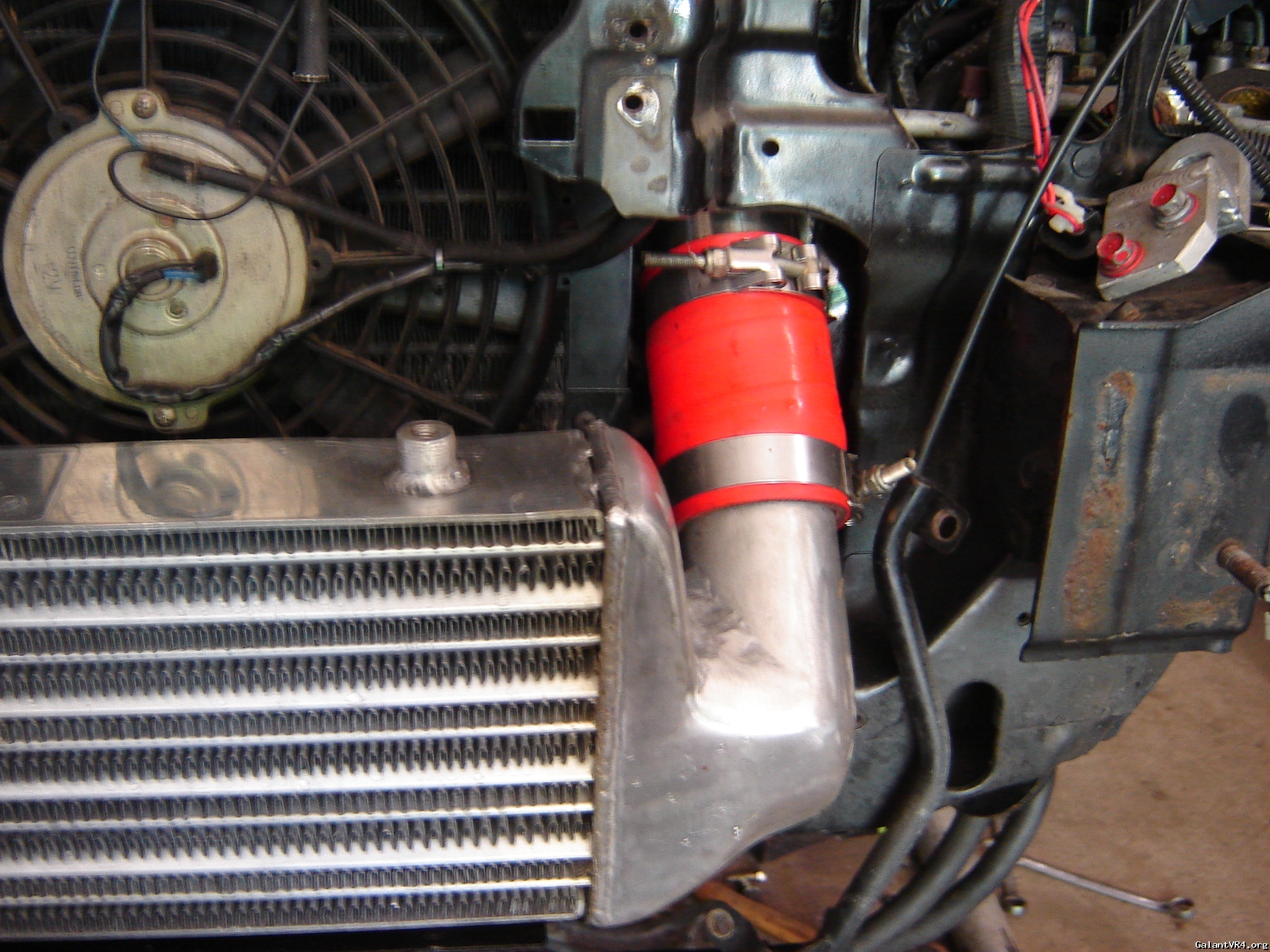

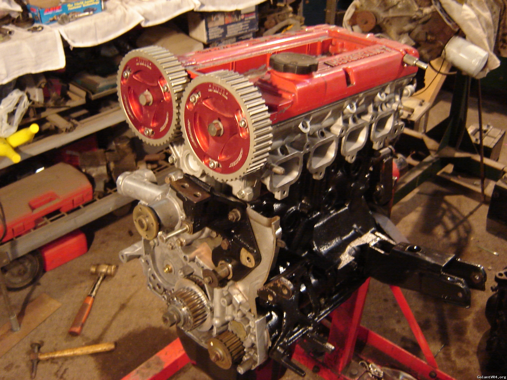

The motor is built and installed. It has a pretty mild build on it. All I had done was the machine work to the block for the decking, and had it punched to .020 over with a set of stock replacement pistons. I did some mild porting work on the head and threw in a set of "Street Grind" Web cams. I also upgraded the valve springs to a set of EVO 8 springs and retainers, and put in a set of 3mm 3g lifters.
I haven't been able to fire it yet, but i hope I did all my calculatiopns correctly on the Arospeed Adj. camgears I installed. Other than that there is a full 3" SS exhaust I built starting off from a Megan D.P. which is hooked up to a S.S. tubular o2 housing. And I am working on the I/C pipeing now. They will be built out of 2 1/2" stainless.
I think that pretty much sums up what it is so far, hopefully in the next week or so, I'll have it out of the JSBc.
I sholud point out, that I suck at documenting things with pictures.. /ubbthreads/images/graemlins/grin.gif
fivestardsm
Sep 8, 2006
1,699
Middle, Michigan

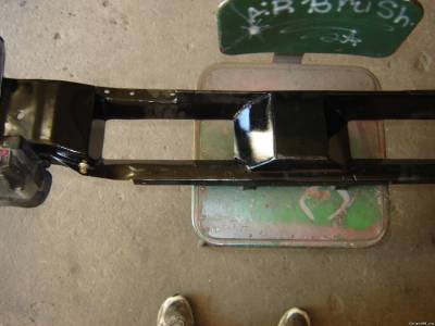

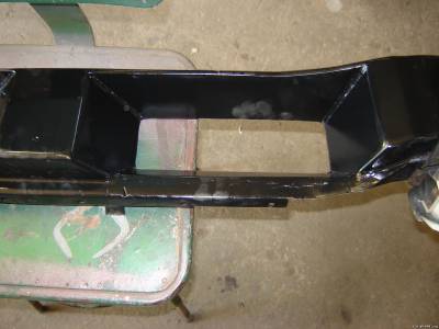

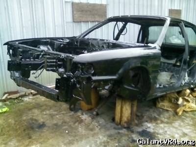

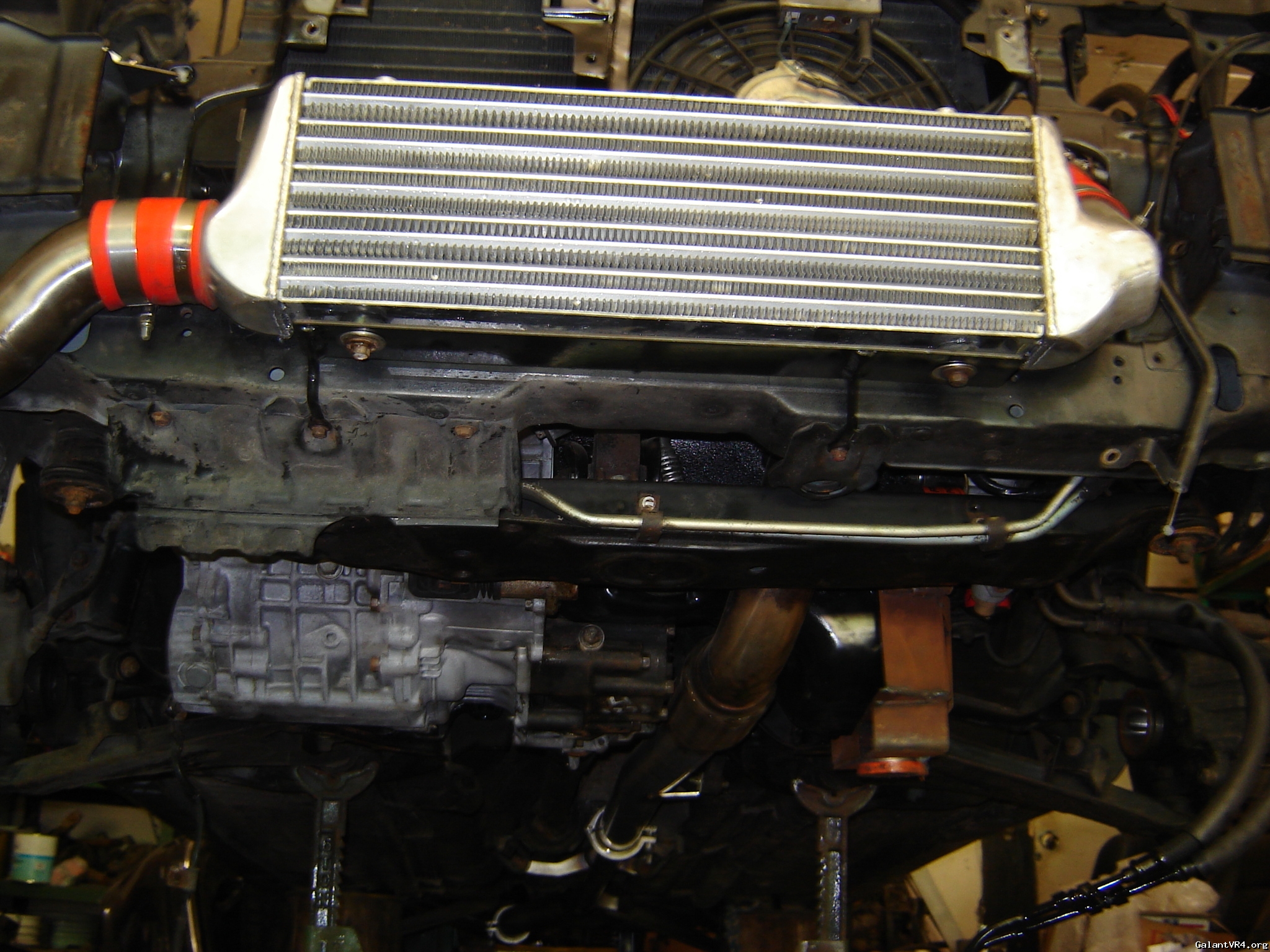

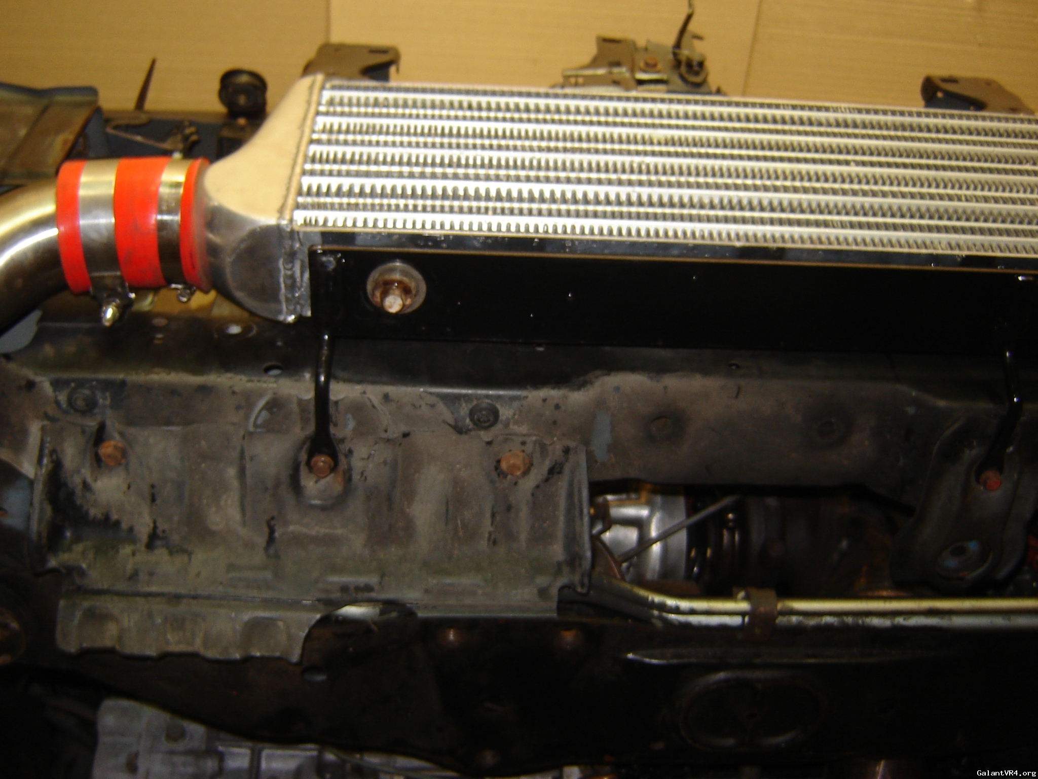

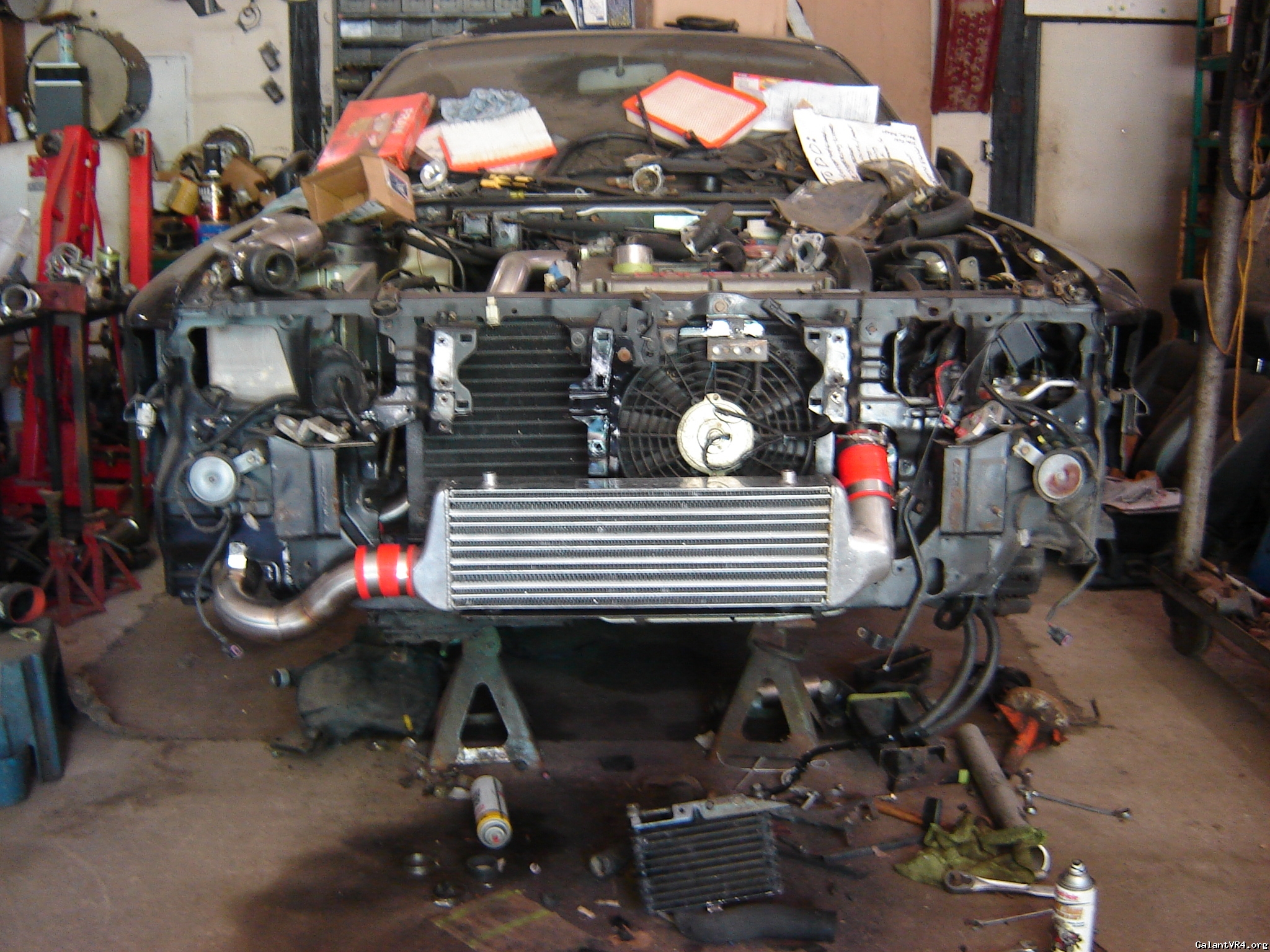

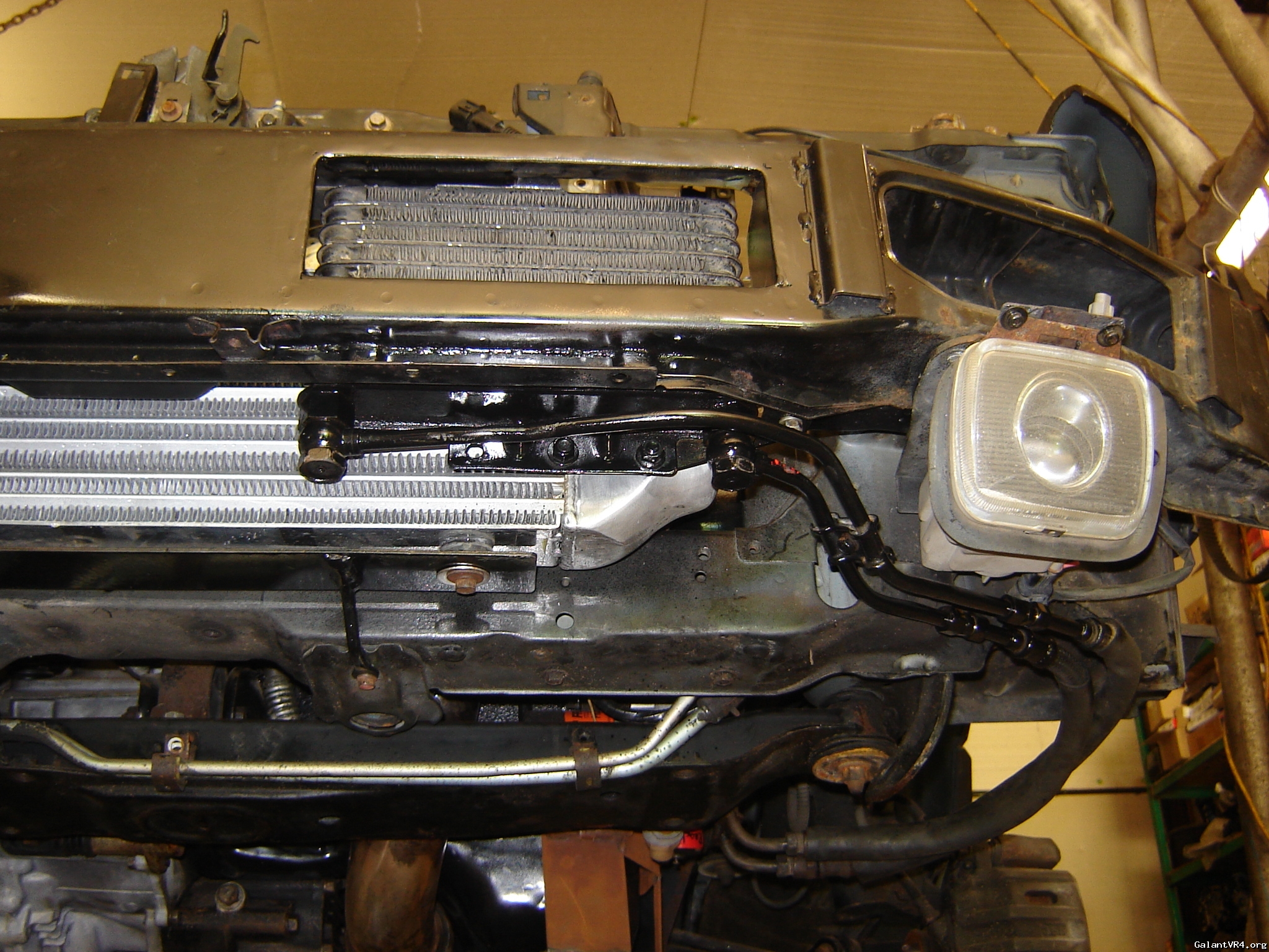

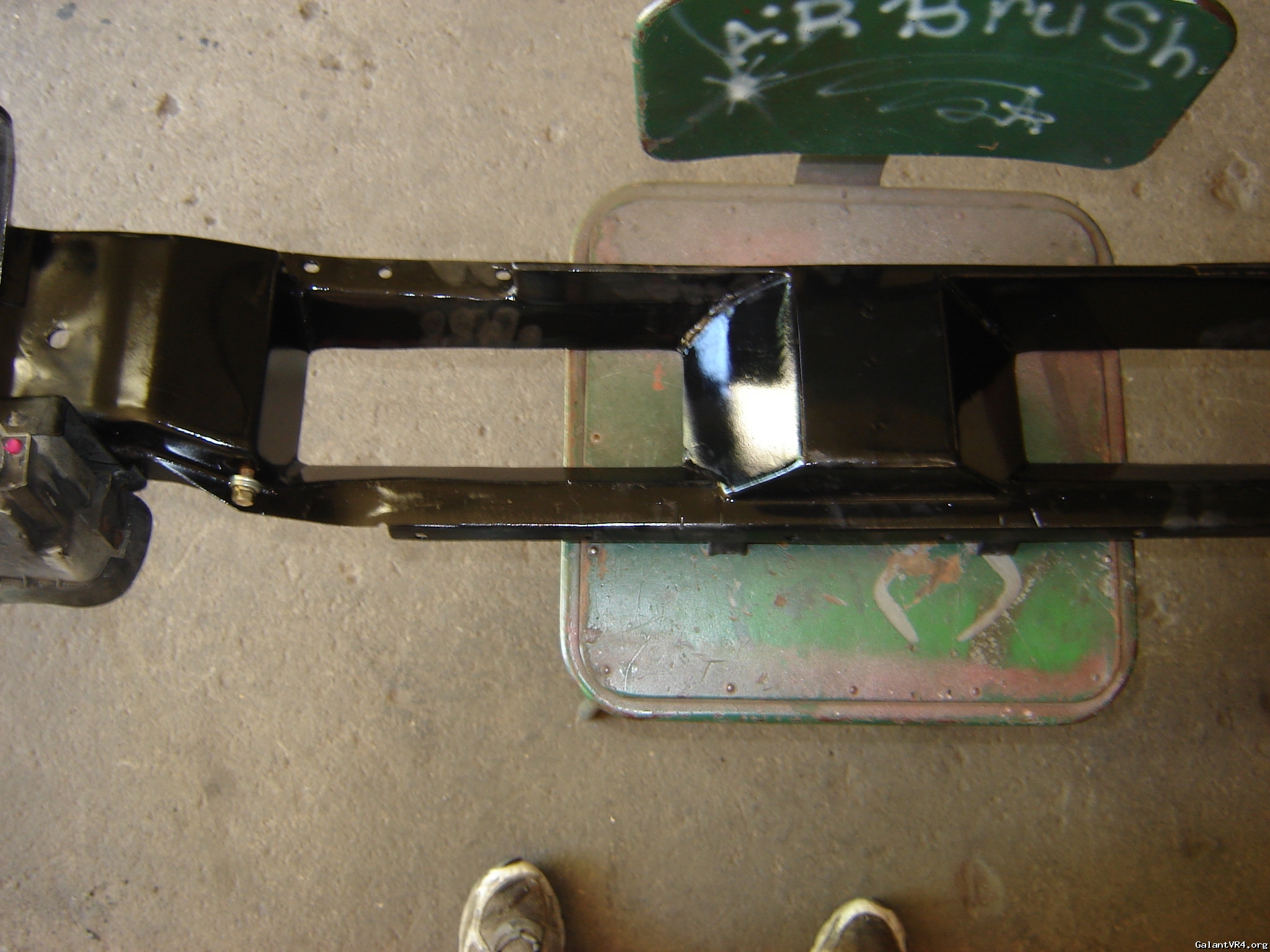

Wow.. I really suck at keeping stuff updated.
Well, i've got it 95% complete. I just need to tie up a few lose ends like my guages and a few minor tweaks.

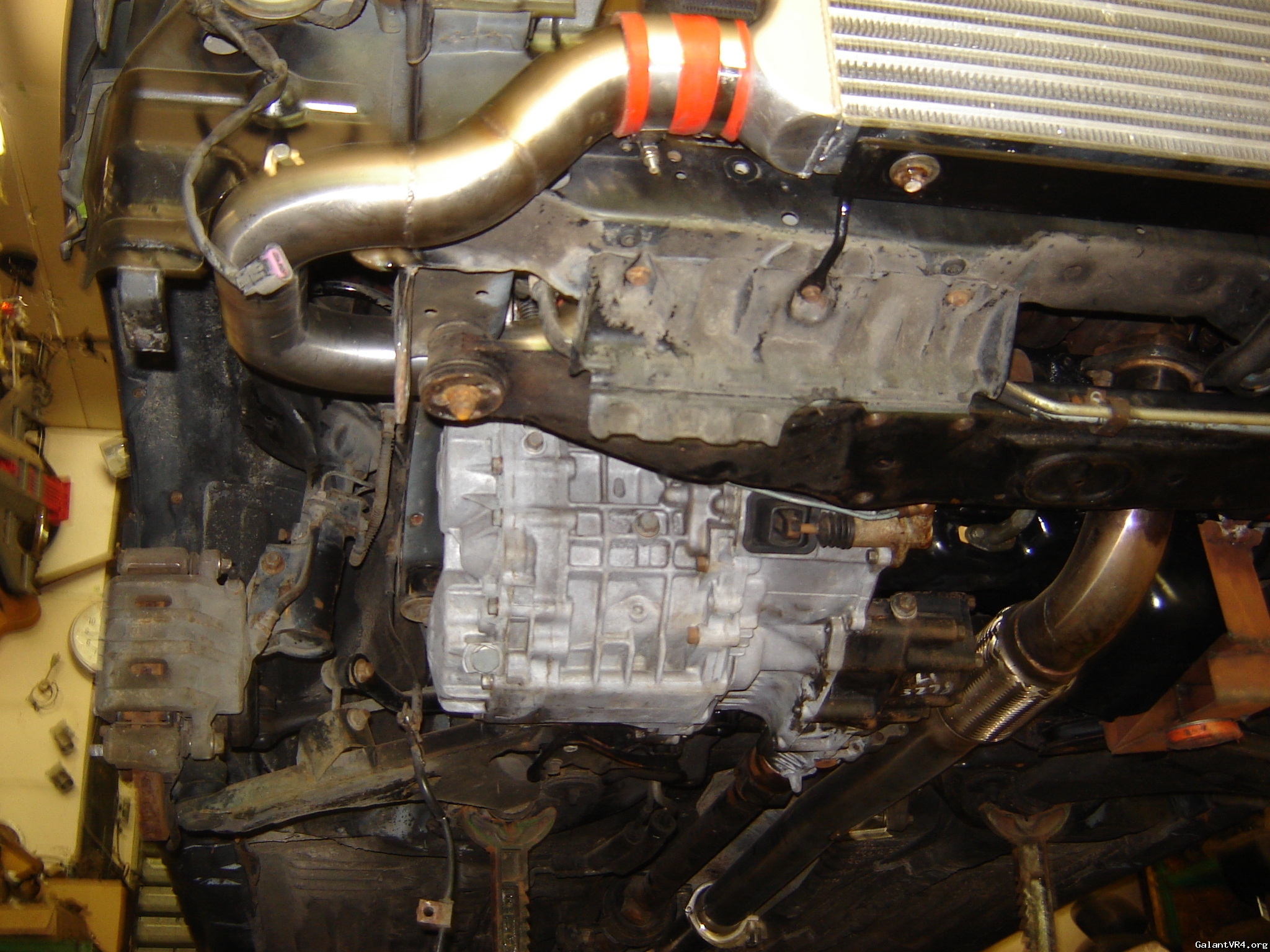

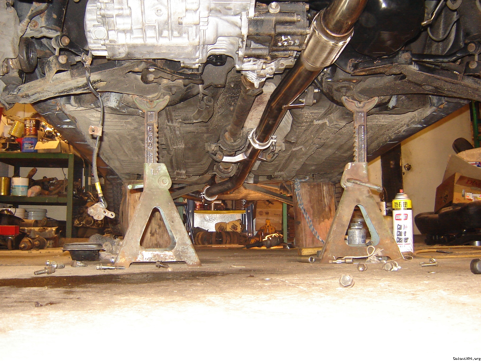

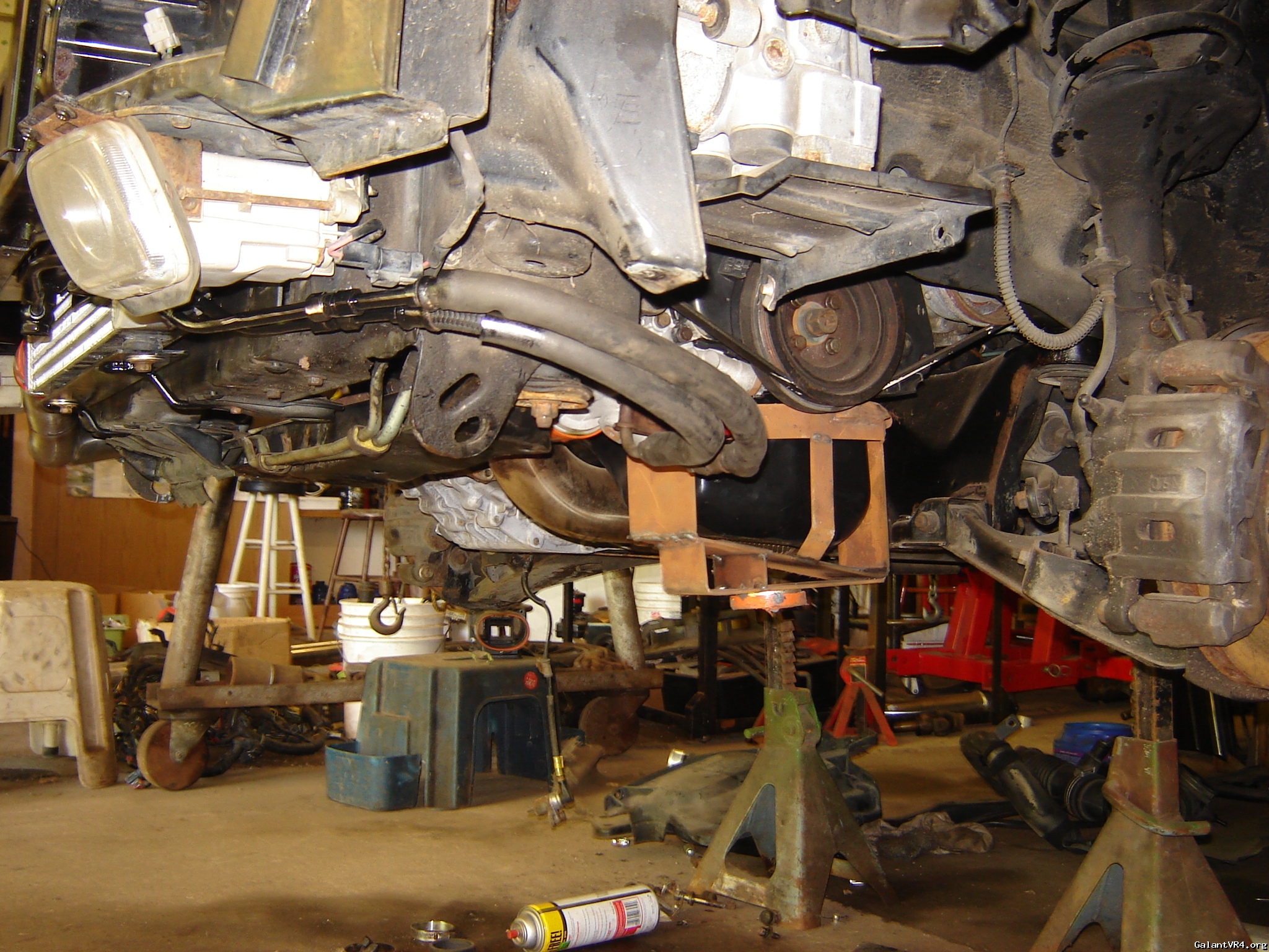

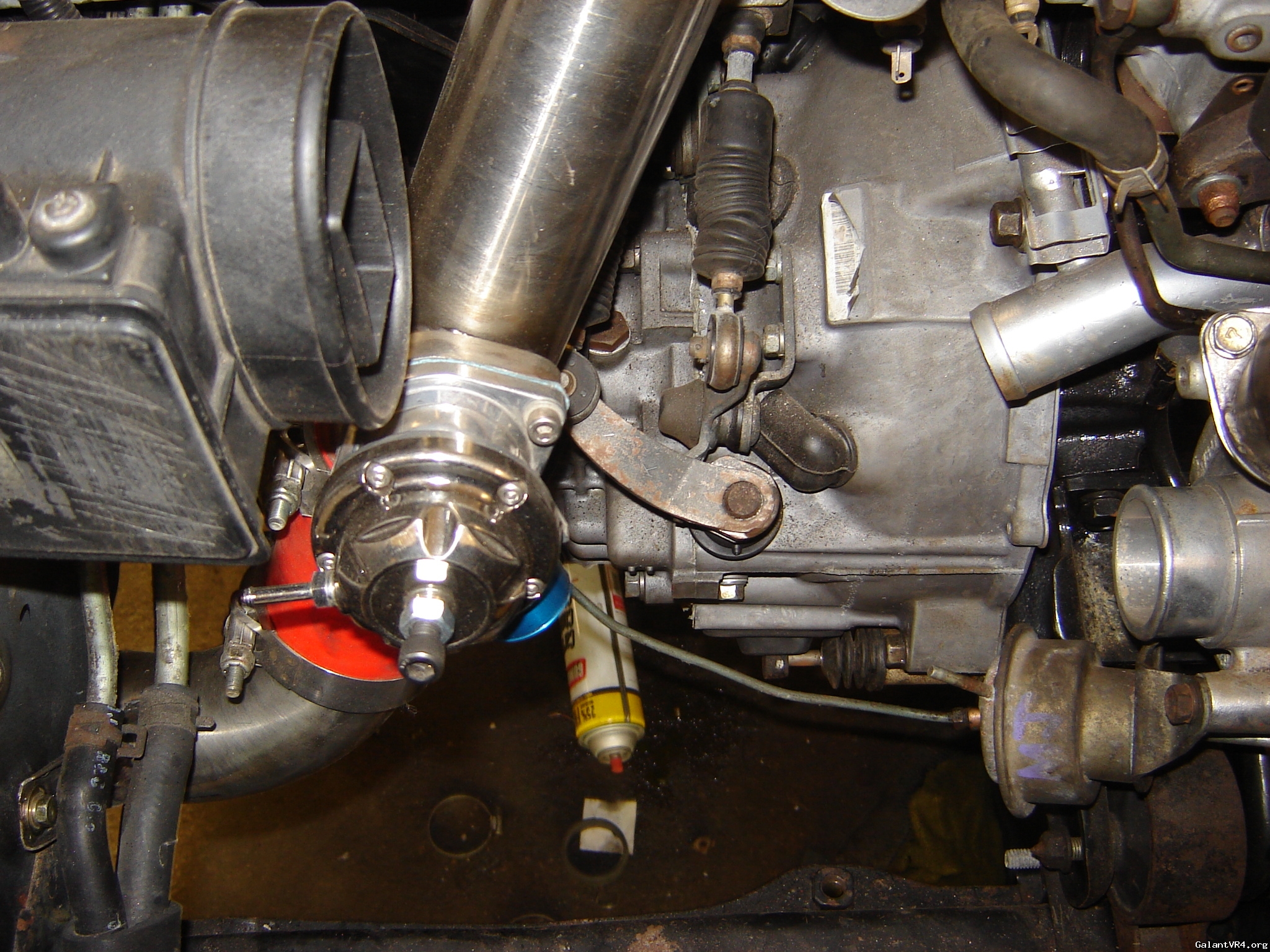

Here are a few pictures that show the progress through the last 4 months or so. Granted, some of you might have already seen a few of these in some of my "help" post.
Anyway, here they are..
id=93842&width=400">
