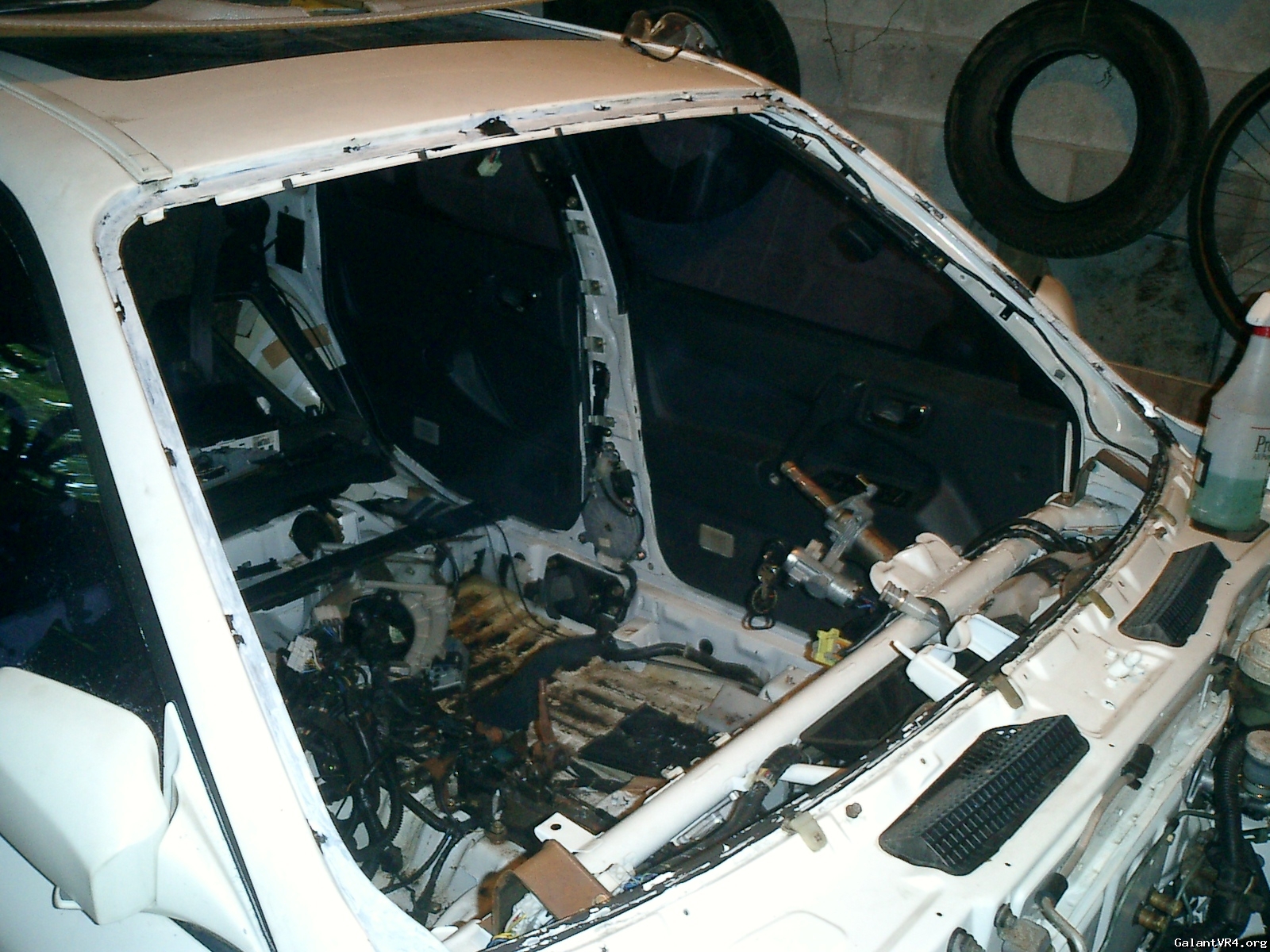

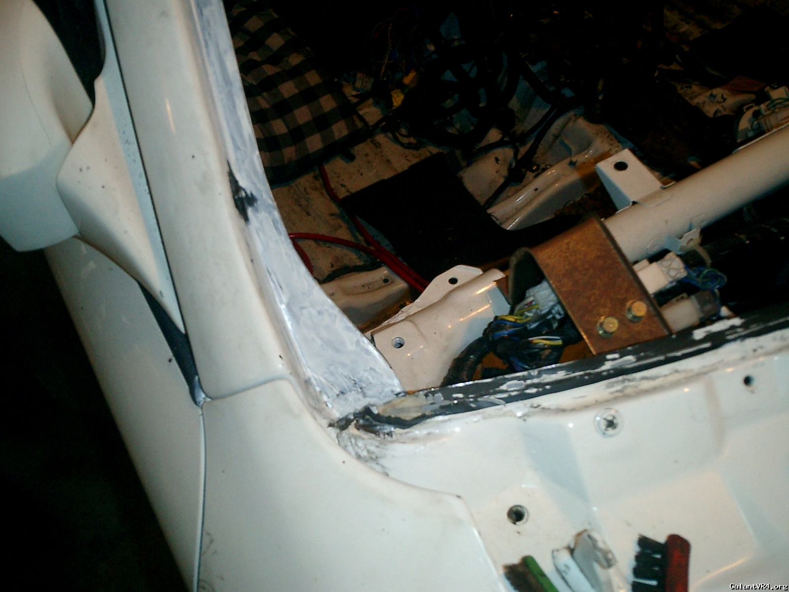

Actually I did Nate. I put another sunroof in it. Water on the floor under the drivers seat was caused by the windshield leaking. So I removed it, stripped all the sealant off and POR 15'd it. The water on the floor in the back was a combo of the windshield and sunroof.
The whole starting problem, believe it or not I think it was a loose connection on the back of the key cylinder. I saw a real long screw about ready to fall out one night drinkin beers in the garage with Chris (BoostedAWD91). The plug was about to fall out too. But I discovered this AFTER I had replaced the entire engine wiring harness. 992 never had starting problems so I used that one. The only thing I have left to do really is have the dent fixed in the back so water doesn't leakin into the trunk anymore.

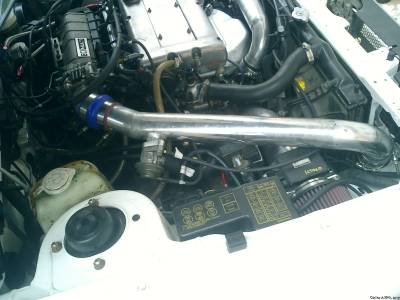

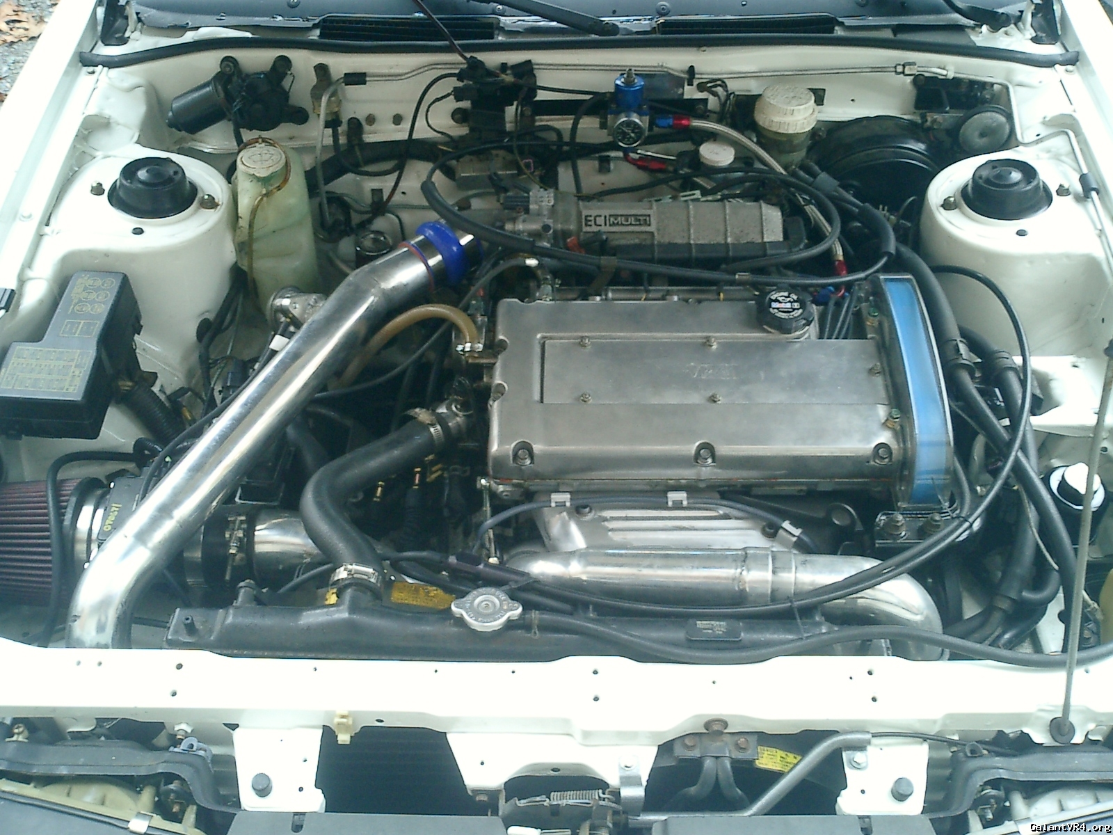

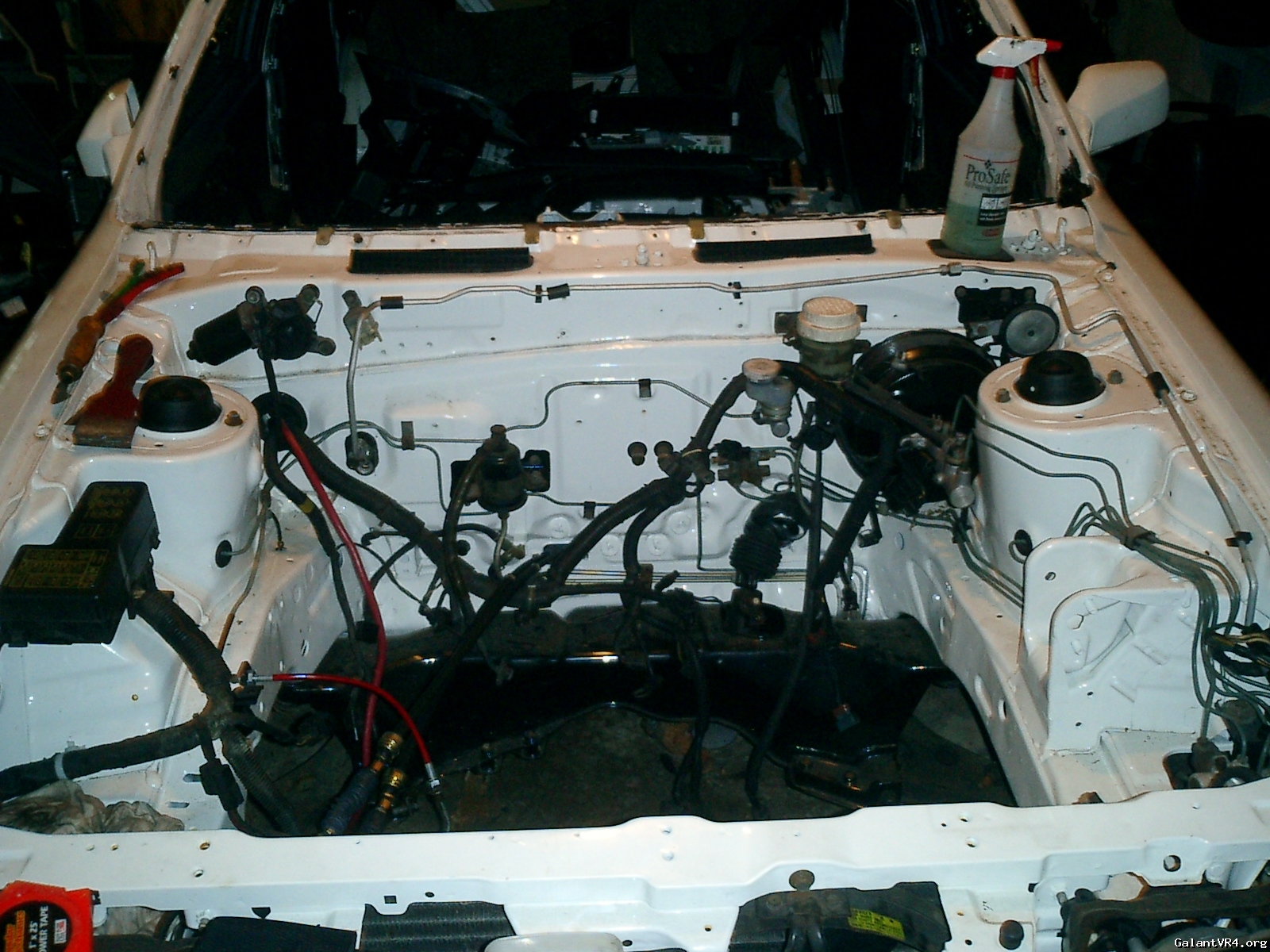

Ok so I just went on vacation in SC, drove the car all the way down and back with out any problems. I was in Port Royal, Beaufort that area. I forgot my camera and then my buddies took a sh*t so i'll post what I have.
Hill made me feel bad for not posting.

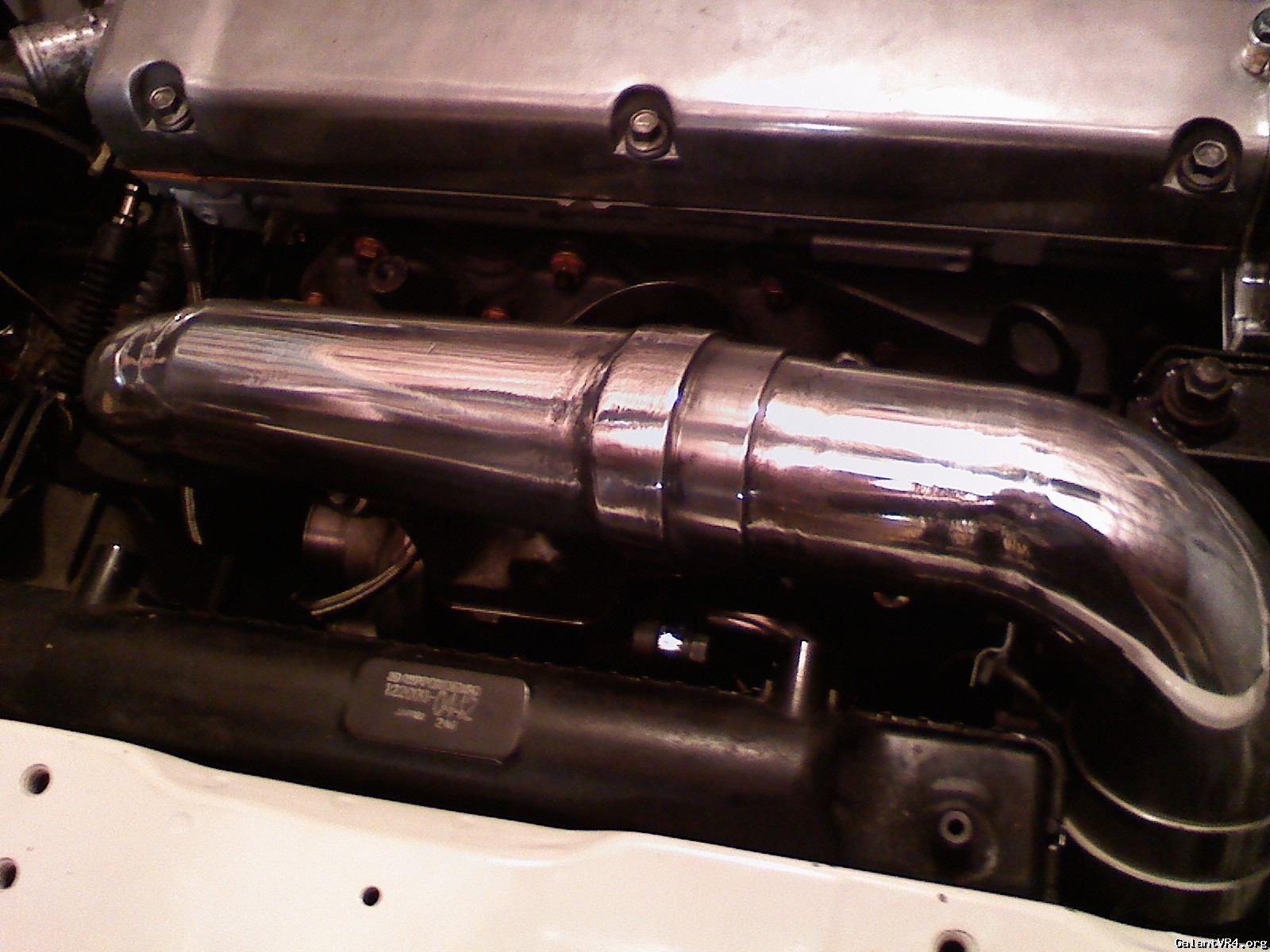

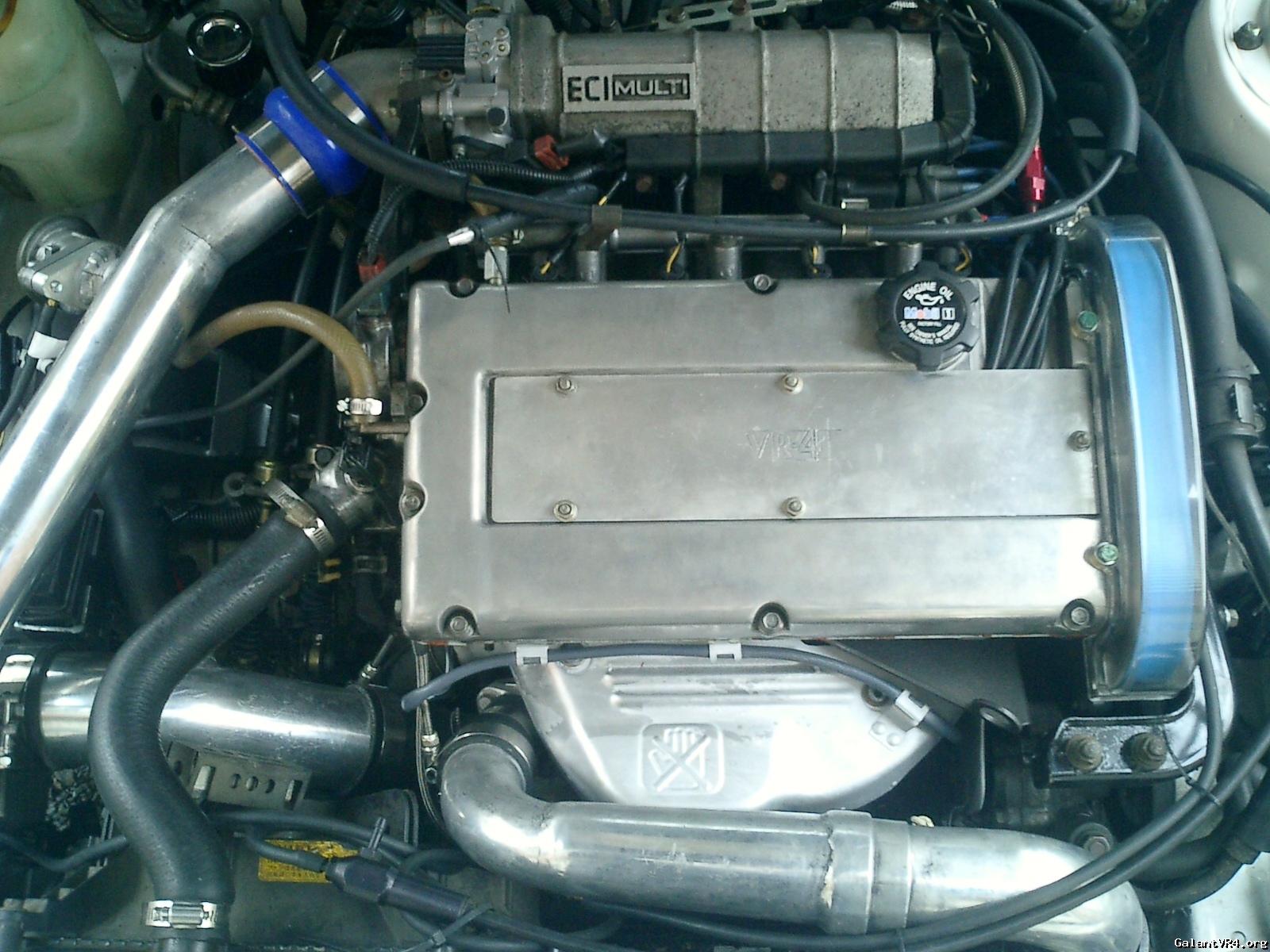

Huge thanks to Hill (1941Galant), Chris (BoostedTT91), and Curtis for all their help. Curtis was nice enough to do my VC, hotside of my intercooler piping, and my gauge bezel.

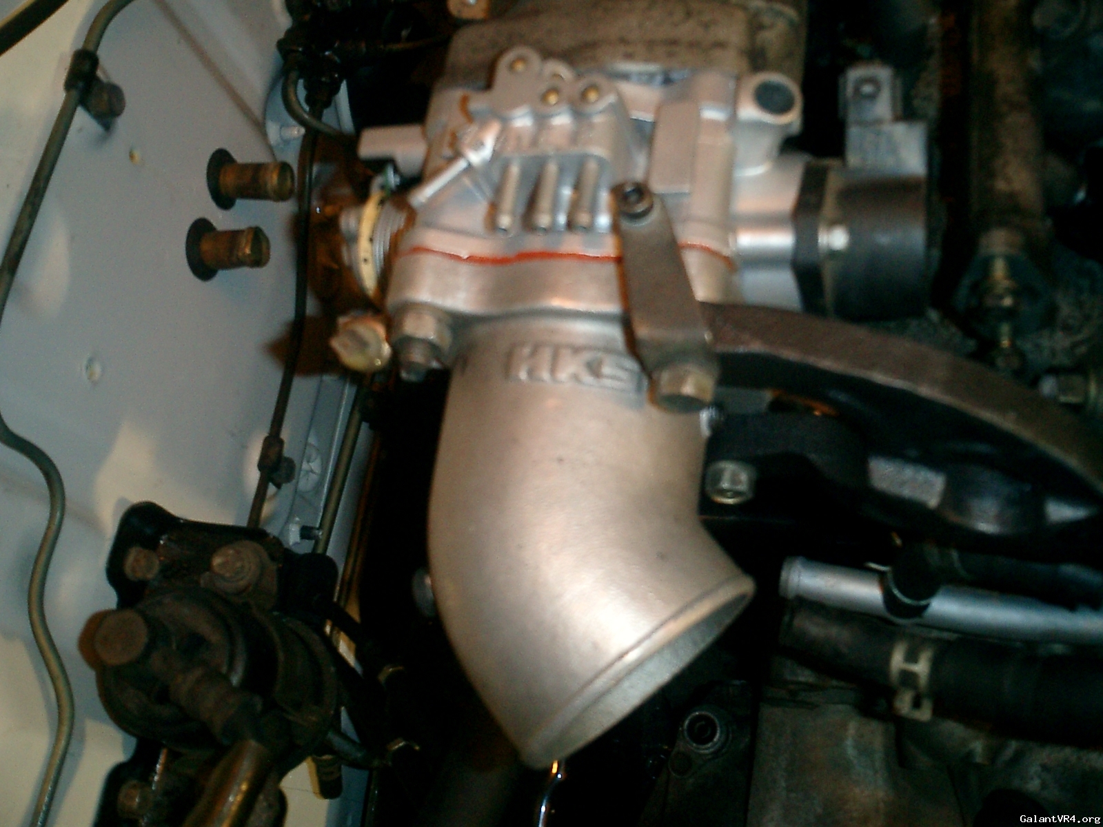

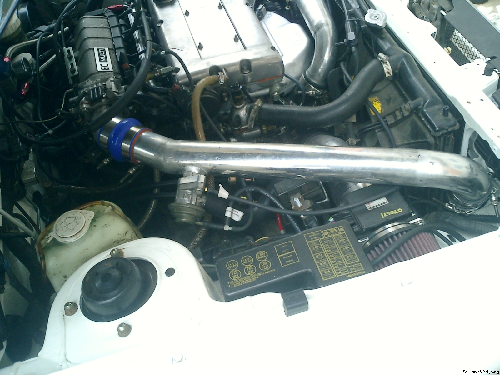

Whats wrong with this pic? And no the car is not running.
Yeah I know there is a barb connecting two vacuum lines and the clear hose is not a good idea for the VC to catch can lines. Its all temporary.

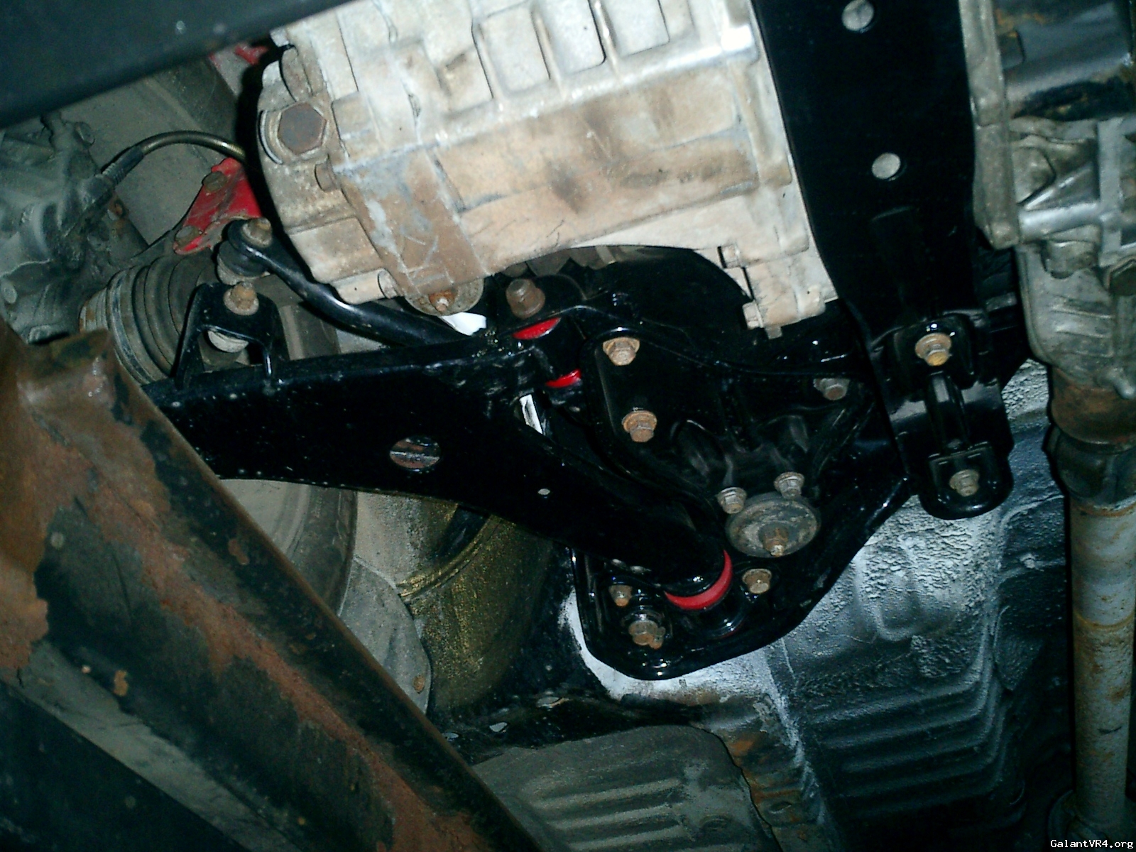

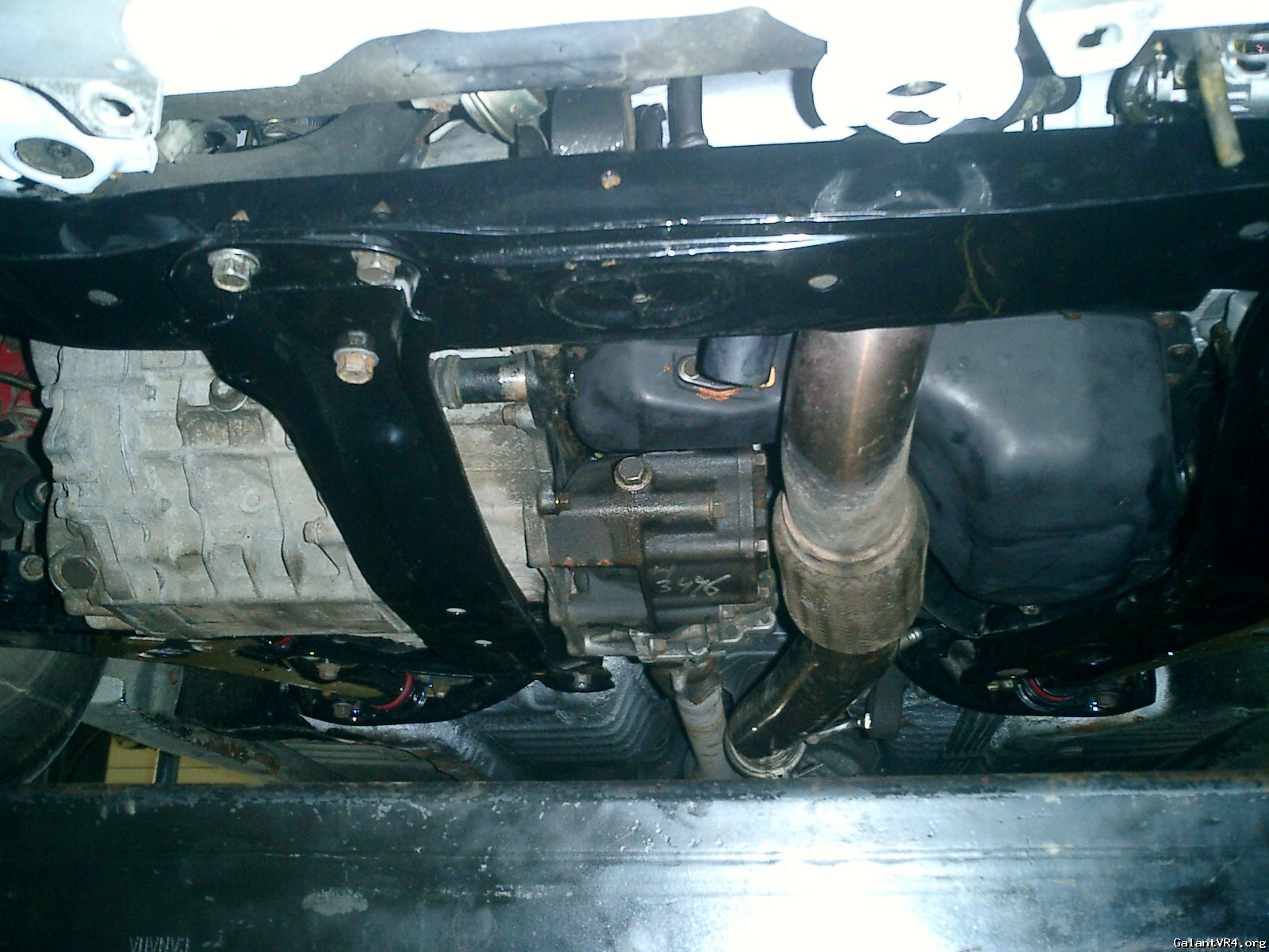

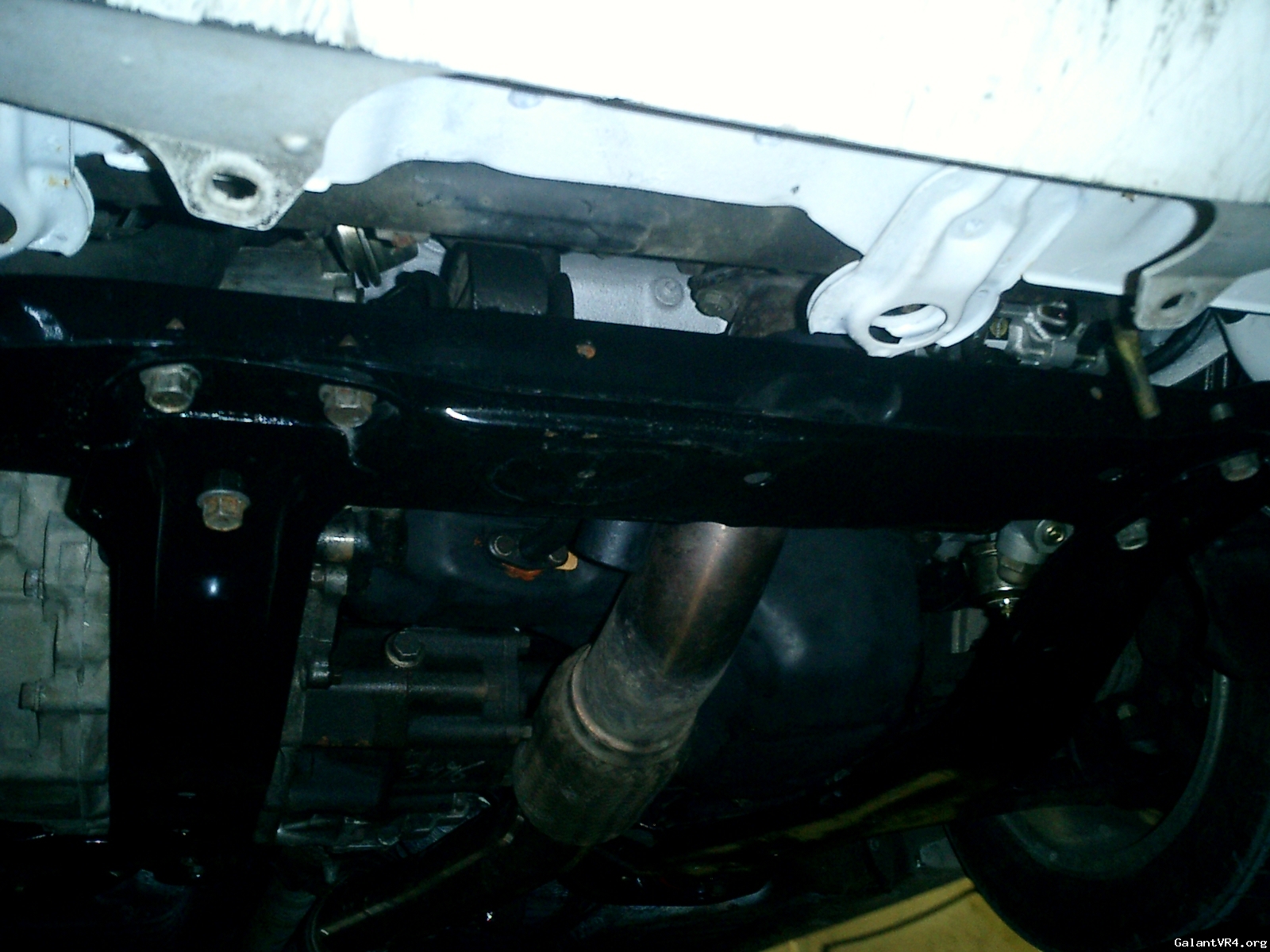

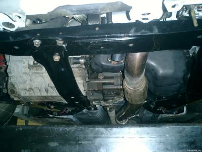

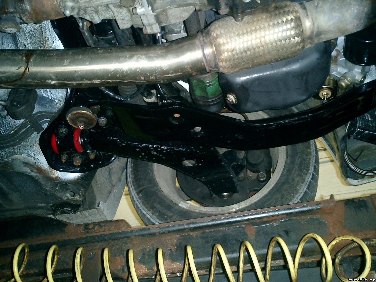

Where did these two bushings come from, I need them.

DAAAAAAMN!! Your engine bay looks like a robot from hell (great looking)! I like what you have accomplished! THUMBS UP!!!!

Quoting 14u2nV:
Believe it or not when I bought the car they came with it. Sorry. /ubbthreads/images/graemlins/frown.gif
