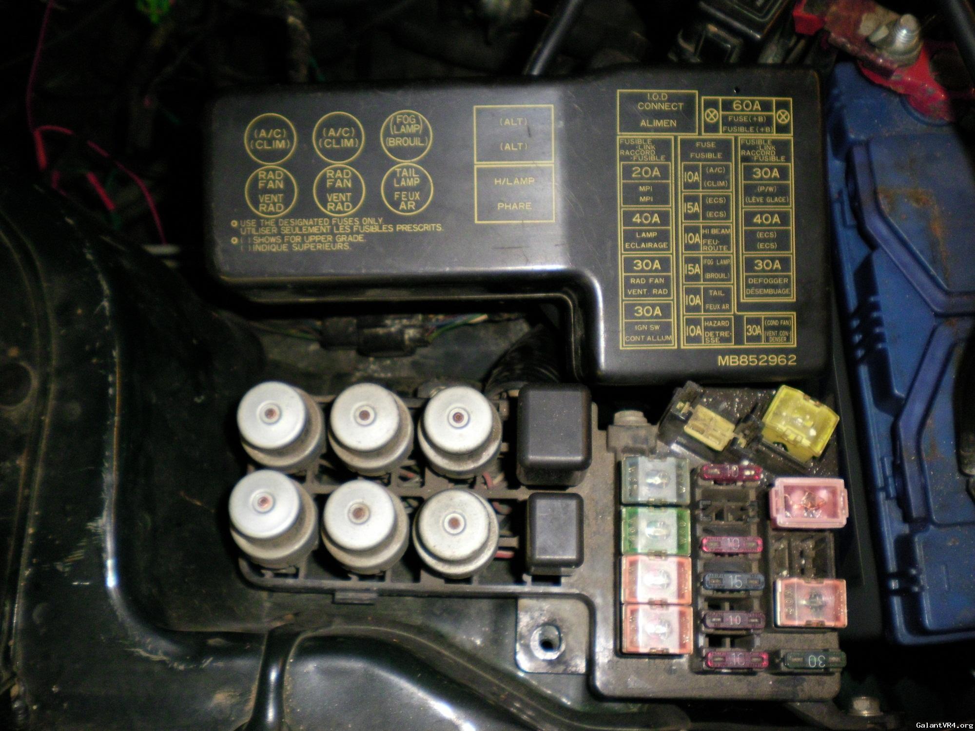

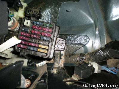

Ok as you can see in the picture, the fuse under the hood is actually the ones looking newest.
Can there be a plug somewhere thats disconnected?
Or anything missing on the pictures?

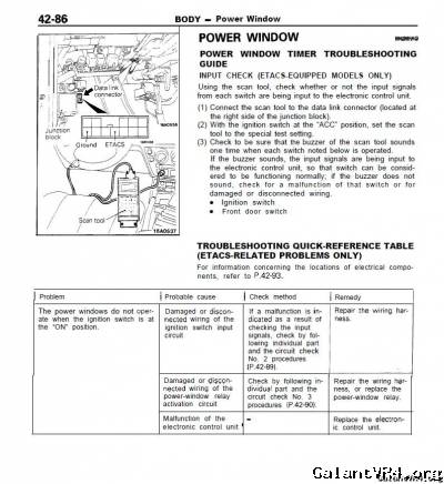

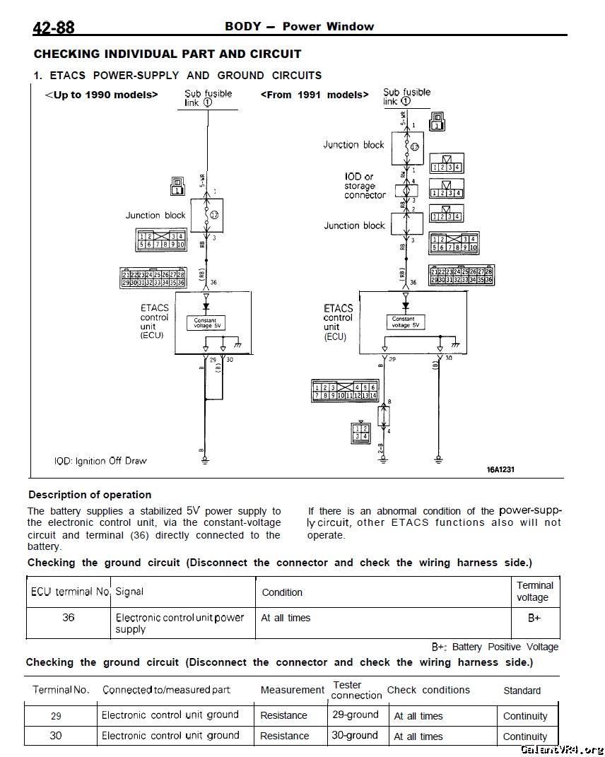

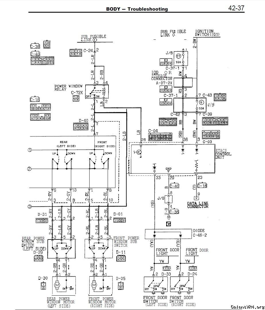

According to the diagram there should be a relay somewhere, but a diagram is rather confusing for me, maybe it makes more sense for you?

I want to say to check for power for the control of the relay by the ETACS unit. C-04 pin 28.
ETACS must received a low control side signal from the switch assembly when you select a window up or down.
They way it is pictured it would control nothing, but it usually doesn't show the way it is all incorporated.
So, if you have control/power going to the Pin at the ETACS, I would also check ground locations as well.

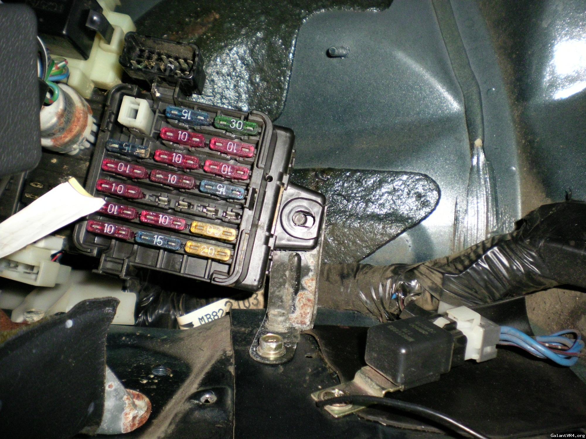

I would check your relay. Must be under the dash near the column if this is anything like most cars.
Interior fuses and relays, near the column or under the dash or console. Relays are sometimes tucked into
a junction block under/around the column.

Possibly just above those fuses.

Acoording to the scematic, pin 28 at the ETACS is power and 29 is ground, so if I plug my testlamp into those 2 it should light up right?

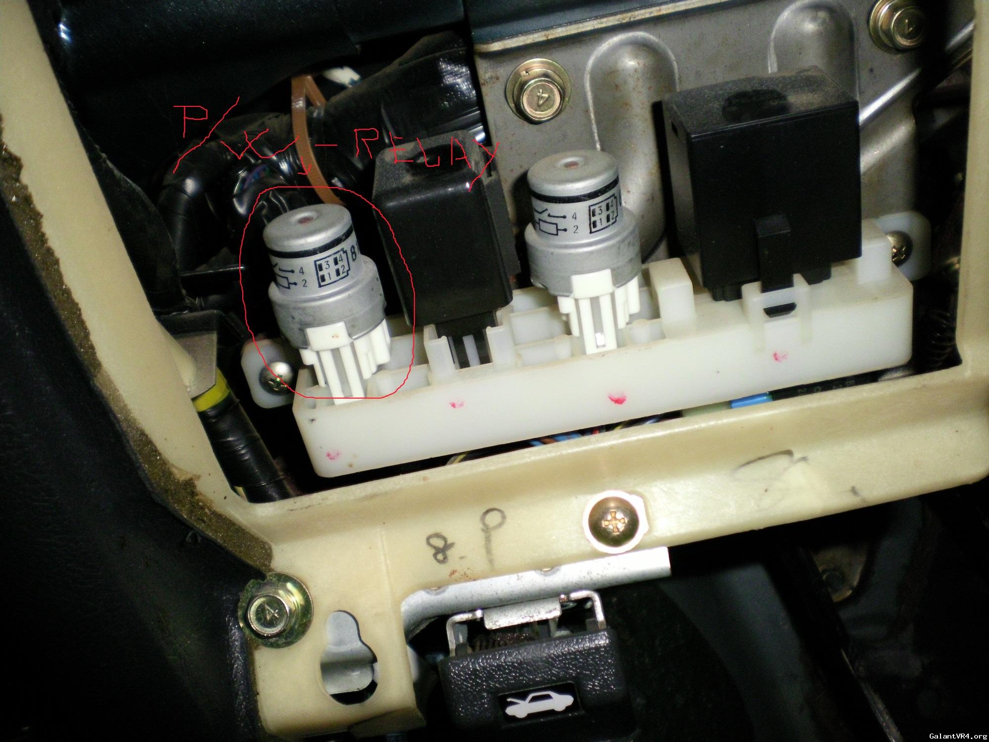

This should be the relay as far as I have been able to find out.
I tried swapping it though, no change.
Another point also as far as I can read, the voltage on the ETACS is only 5v, Can we agree on that my test lamp is 12v and I cant use it for that?

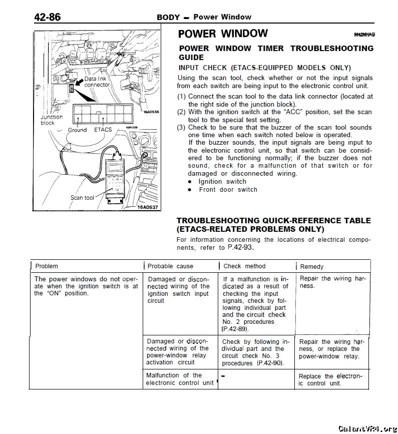

Btw the manual say something about using the scan tool and check if the ETACS get the signals from the different switches.
Can I use my Palm logger instead of the Scan Tool?

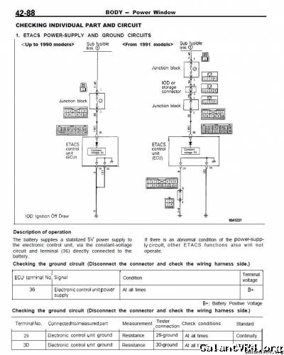

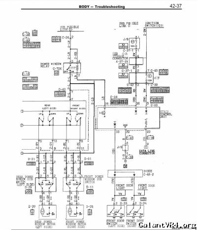

Here is the test scematic for the Etacs. I tried plugging my testlamp in pin 36 and other end on ground. There was no power
But it also say it gets 5v power, so its a bit confusing for me to figure out I must admid.
